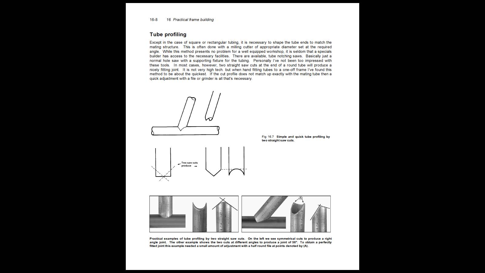

    I missed this post when it was made but I have had to notch thousands of joints. In the 70s and 80s when I had a business making motorcycle chassis. Unless the wall is thick compared to the diameter then 2 straight saw cuts will get you very close to a well fitting joint. The cuts can be made with hacksaw, cutoff wheel in an angle grinder as Tuomas did or a full size cutoff saw.
    This method works for 90 deg joints but also for those at different angles. For one off and for the first frame of a new design I would use a hacksaw, which was generally the fastest way. For production frames I had a list of cutoff saw angle settings so that unskilled helpers could take care of the work.
    Here is a page from my book Motorcycle Handling and Chassis Design
    90 degree tube notching method without a drill press.-tubeprofiling.jpg Click for full size.
    Also on my website in the freeware section there is some software "TubeMiter" which prints out templates for tube notching which handles tubes of different diameters and angles. I don't use it but only because the two cut method above works so well for me.
    PS. I must mention that not everybody has success with the two cut method, you have to have a good eye for the angles and distance from the end to cut. I have a friend who has built some motorcycle chassis and he has never had success with the method.
