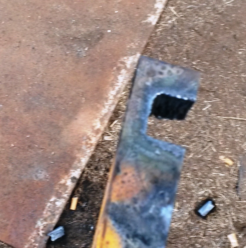

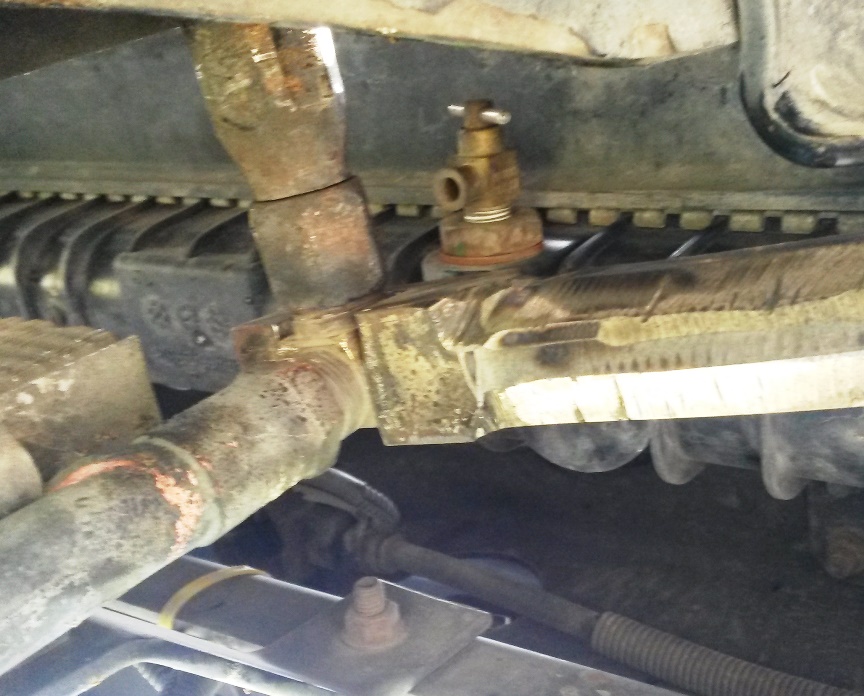

    Yesterday I needed such a tool to remove a hose from a brass fitting on an oil cooler any twisting motion will result in a cooler tube being broken

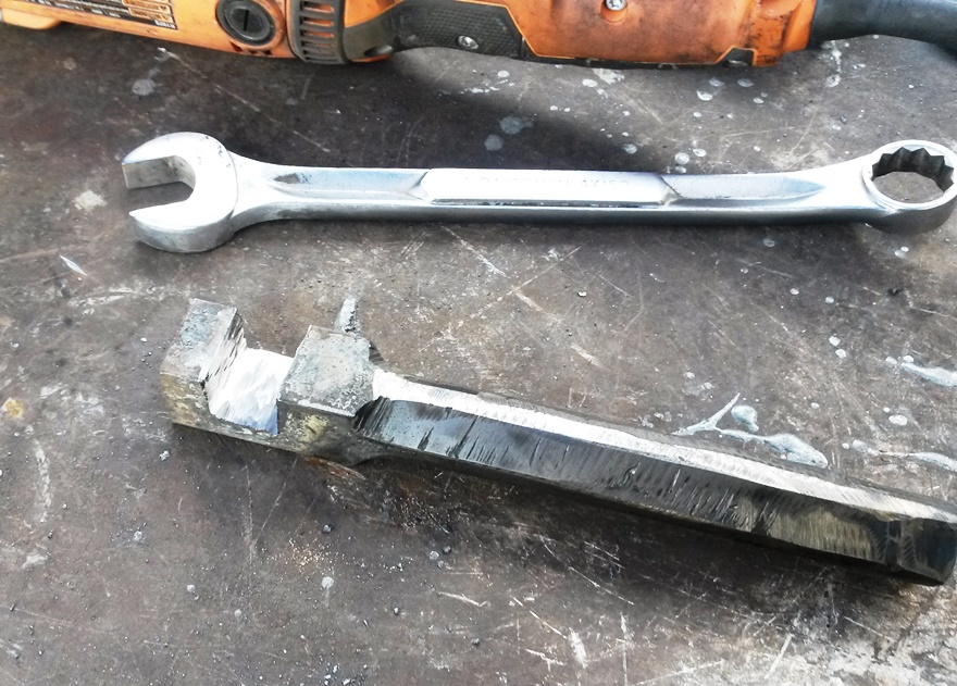

    I tried using a regular open end wench but there was little surface area to use it so I made a special hook over wrench to hold the fitting with
    I call it my 10 minute 15/16" 90° fitting wrench. First I thought I would set up my mill to cut the hook portion of the wrench to fit the fitting but I didn't want to have to spend an hour or more setting up then milling with a customer standing around waiting.
    quickest solution a few quick cuts with a torch a few minutes with an angle grinder just to knock off the rough and make the notch fit job done

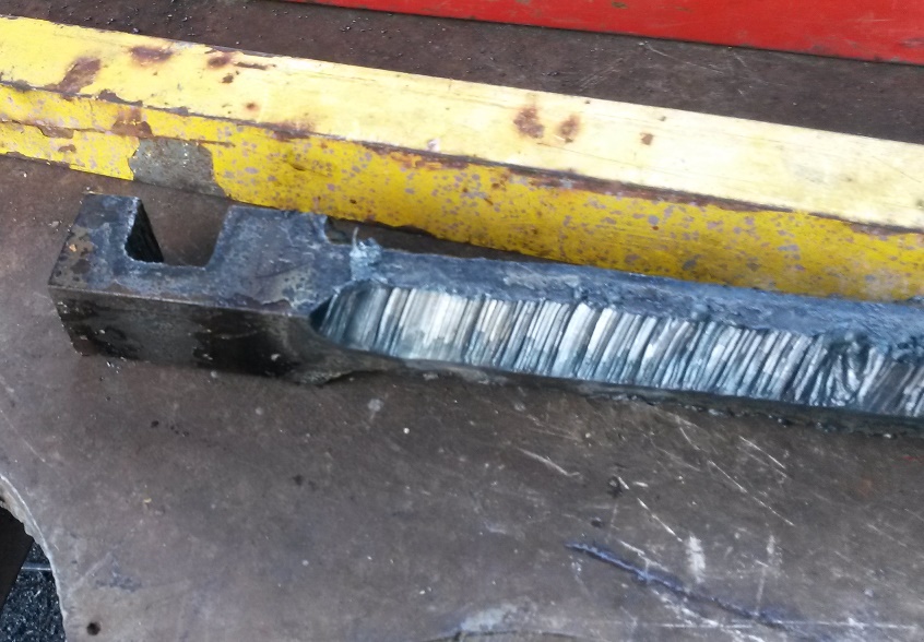

    This picture shows how well the wrench fits the fitting
