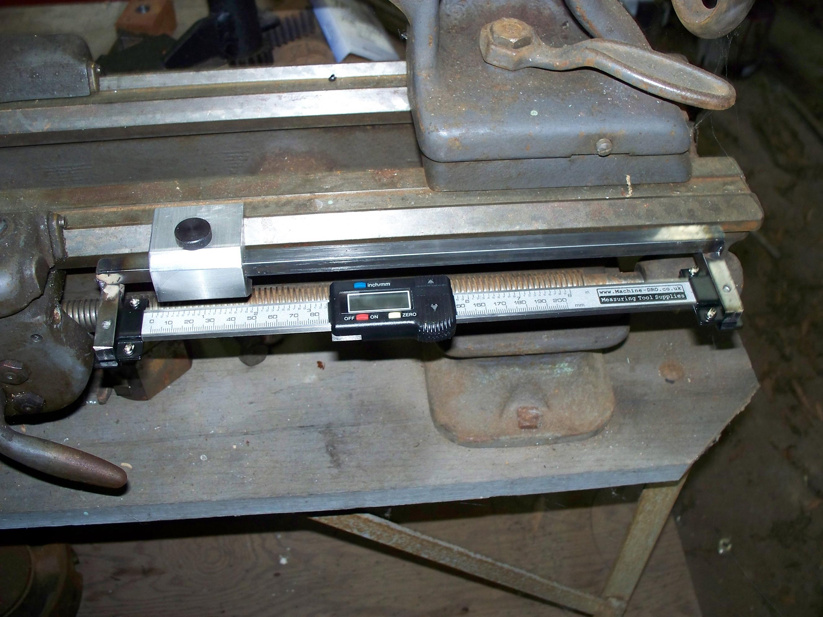

    My project here is an 8" linear DRO scale for my Atlas 12" lathe An aluminum block clamps to the bed lip. The scale mounts to a sliding bar and is attached to the lathe saddle by a 3/16" rod with ball rod ends. It works great for precision machining.
    That works so well I decided to make one for my South Bend 9 lathe. There's a little more work to be done, like connecting the scale slider to the carriage.Be ready soon.8" linear DRO scale for my Atlas lathe.-100_1922.jpg

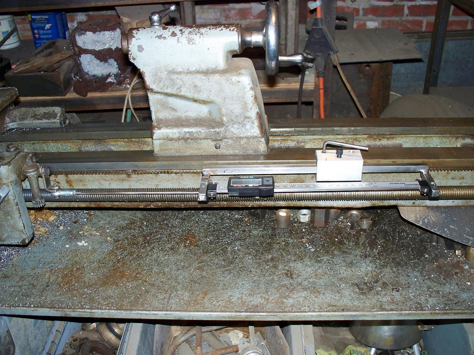

    8" linear DRO scale for my Atlas lathe.-100_1899.jpgFinally got the pic size right.

    Nice idea, very simple design, nice job. Thanks for posting.

    Very clever. I like it.

    I put one on my lathe, but I used neo magnets from a harddrive for the read out and a smaller neo magnet on the end that follows the carriage. if I go in either direction too far in just gives. Seems to be working fine and accurate. I am waiting for a usb adaptor and I will be hooking it up to my Yuriy's bluetooth dro readout I had on an old mill. I just did the same thing for the X axis I think is called on the carriage for the depth of cut and I hope the bluetooth set up will do actual removal amount for depth of cut, will se.
