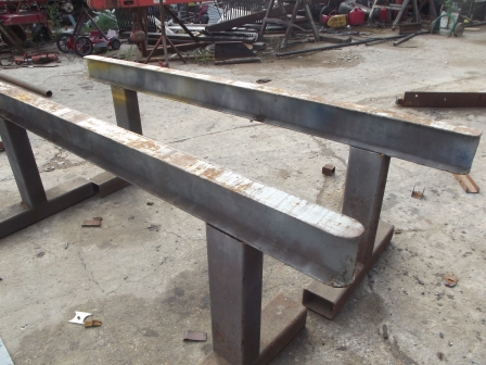

    8 ft long work horses
    At one time I had 10 or 12 of these work stands some of them were made out of 10" "H" beam and as much as 20' long. the only 2 I have left are made out of WF 6x13 beam which means 6" height with a 4" flange the legs are made from 4x6" 1/4" wall tubing each stand weighs about 110 lbs
    I made these over 35 years ago

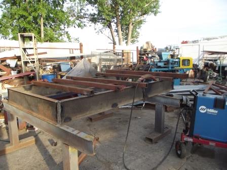

    Very handy for making small trailers
