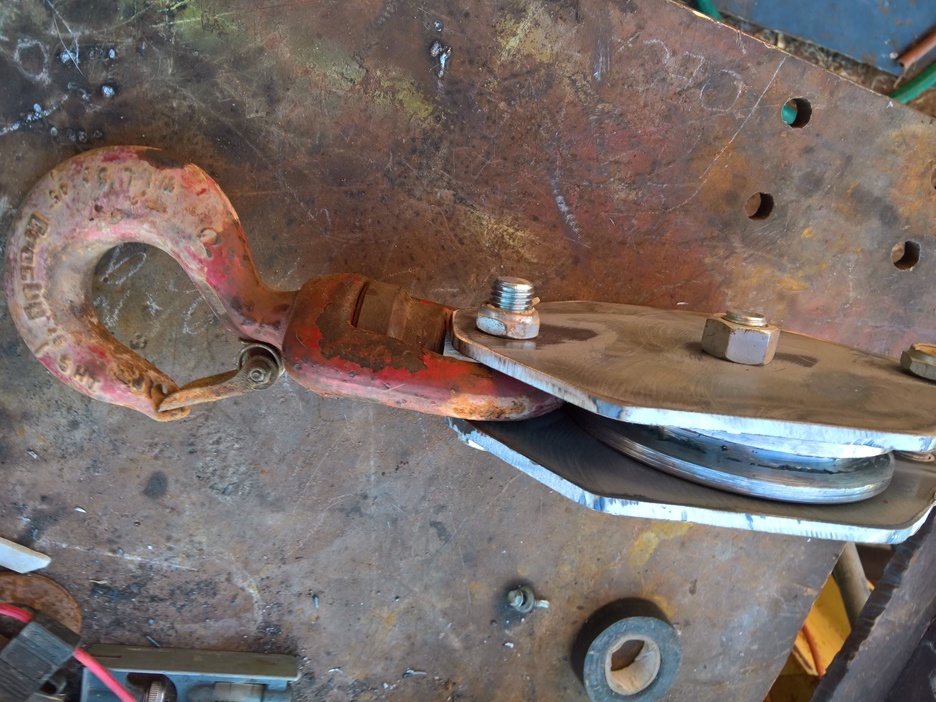

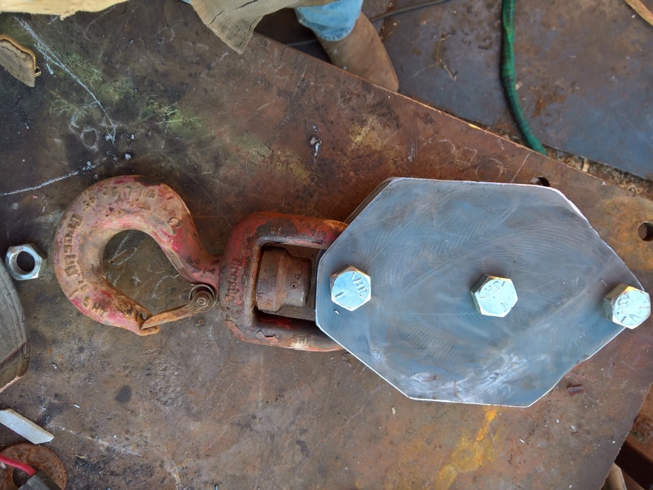

Thanks Frank S! We've added your Snatch Block with Hook to our Jacks and Lifts category,
