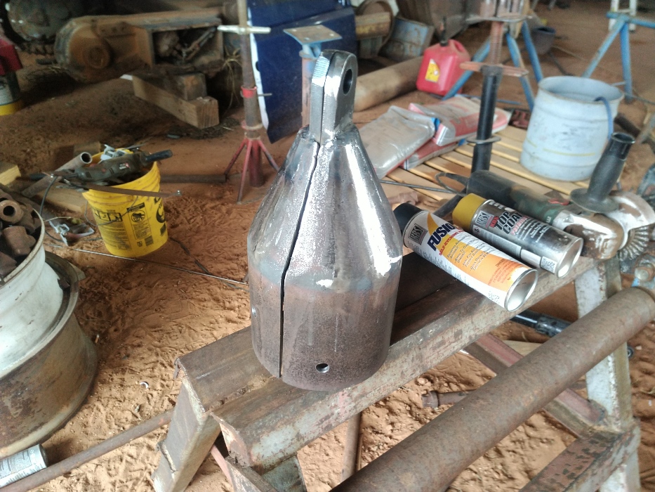

    A guy from the construction company who has been working in my area installing fiber optic lines ot replace our copper telephone lines asked me to make him a puller so he could drag a 6" pipe through a bore hole. This is what I made for him.

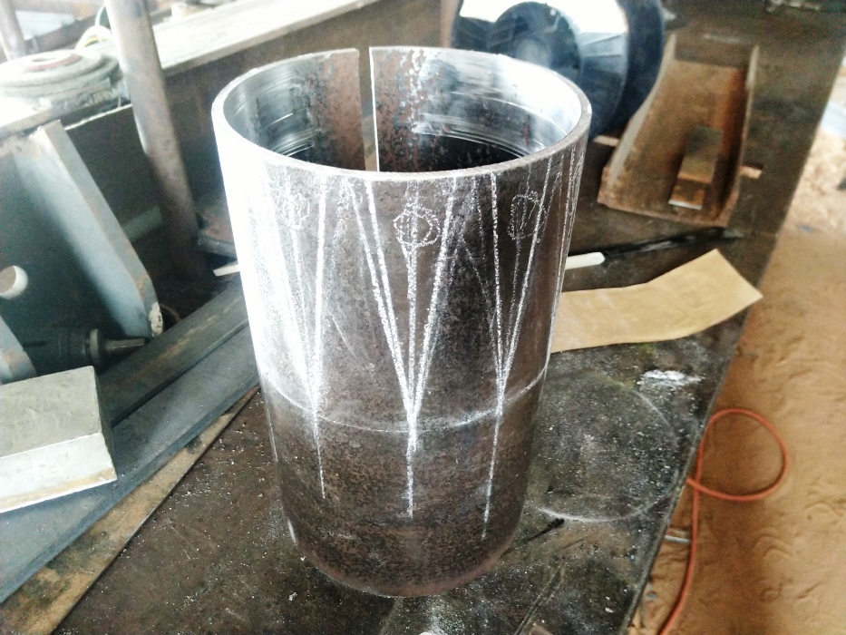

    First I laid out a cut pattern for reducing the OD of a piece of scrap 7" casing pipe I had laying around
    6" casing puller for horizontal drilling operation-img_20220809_144219poo.jpg

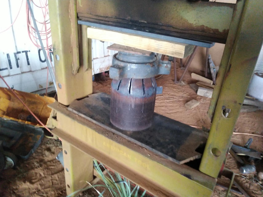

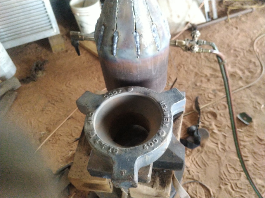

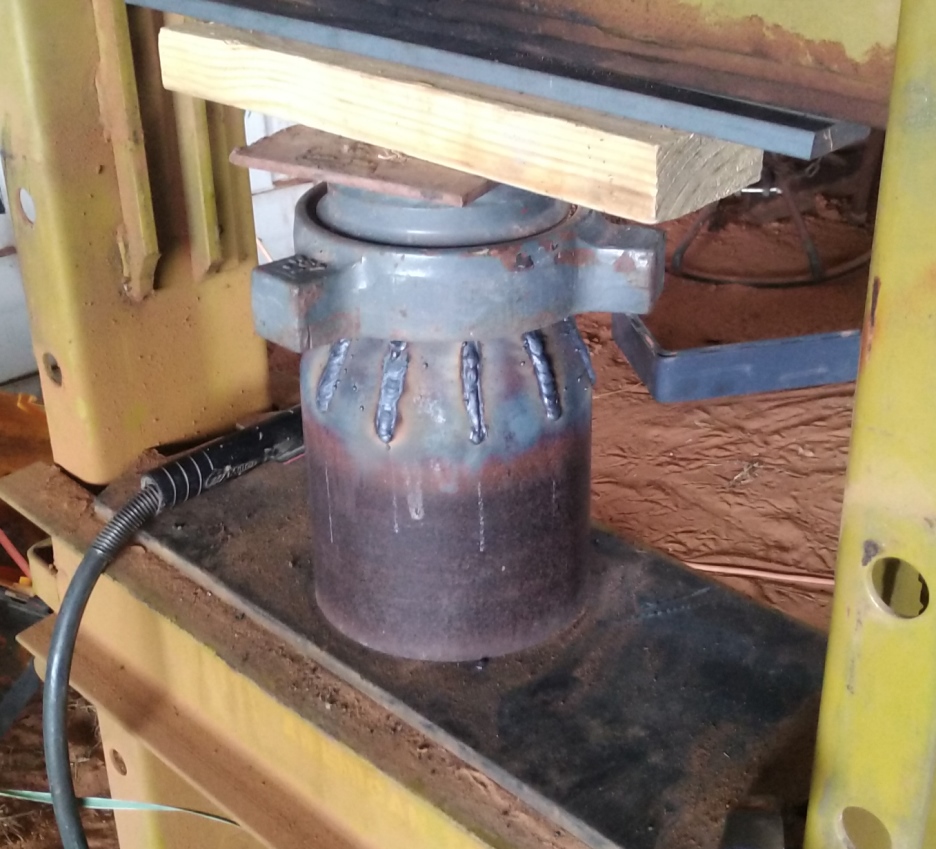

    Next after heating and bending the finger cuts over to start the tapered OD I used half of a 4" pipe union as a forming die and my shop press to close the fingers completing the taper before welding the cuts
    6" casing puller for horizontal drilling operation-img_20220809_154255poo.jpg
    6" casing puller for horizontal drilling operation-img_20220809_155323opp.jpg
    6" casing puller for horizontal drilling operation-img_20220809_155509poo.jpg

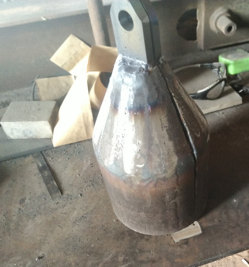

    After welding up the cuts I made a pair of Pad eyes and welded them into the reduced opening so a clevis and swivel could be attached for pulling, the pad eyes extend inside the cone a couple inches and are welded from inside as well they align up with the slot in the puller to allow for it being spread open to fit over the pipe
    6" casing puller for horizontal drilling operation-img_20220809_172753poo.jpg

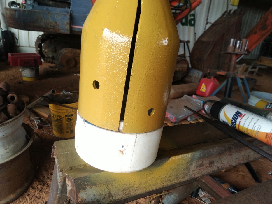

    Finally holes were cross drilled to allow a couple bolts to be inserted through the pipe and to clamp the puller to tighten it on the pipe
    6" casing puller for horizontal drilling operation-img_20220810_092334poo.jpg.
    A piece of 6" PVC used to demonstrate how the puller must be slightly spread open demonstrating the snugness of the fit the paint is done with KBS fusion primer and KBS moisture cured topcoat I only painted it so the workers might figure it as a tool to be kept and maybe not just considered of a piece of scrap iron after the job is done
    6" casing puller for horizontal drilling operation-img_20220810_120137poo.jpg

    Most contractors I have known are more interested in completing their job than competing with movie producers. A video of that thing would be pretty boring just connect it to the pipe attach the clevis and swivel remove the drill bit from the end of the drill stem attach the swivel to the end of the drill stem and begin backing out of the hole not much that could be seen other than that, but when he comes to pick up another item I am making for him I'll ask.

    He did say though the way I made it worked out far better than any of the other pullers he had, had made, since it had to be spread open slightly to insert the pipe instead of a loose fit made everything seem to go a lot smoother, They pulled the 100 foot string of 6" PVC through the first time without a hitch
