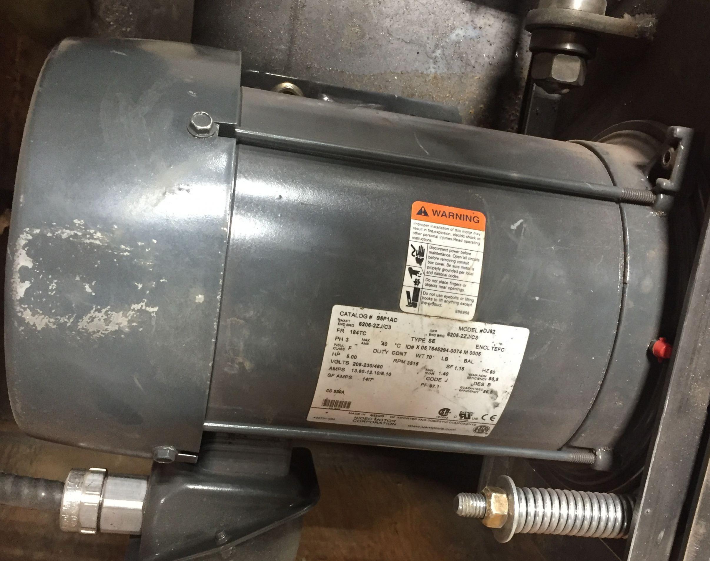

    Here is my newest Project
    6 by 89 5hp VFD Belt Grinder / Tube Notcher
    5HP VFD Belt Grinder/Notcher-5-hp-6-inch-steel-ripper.jpg
    5hp 3 Phase Motor
    5HP VFD Belt Grinder/Notcher-5-hp-3-phase-motor.jpg

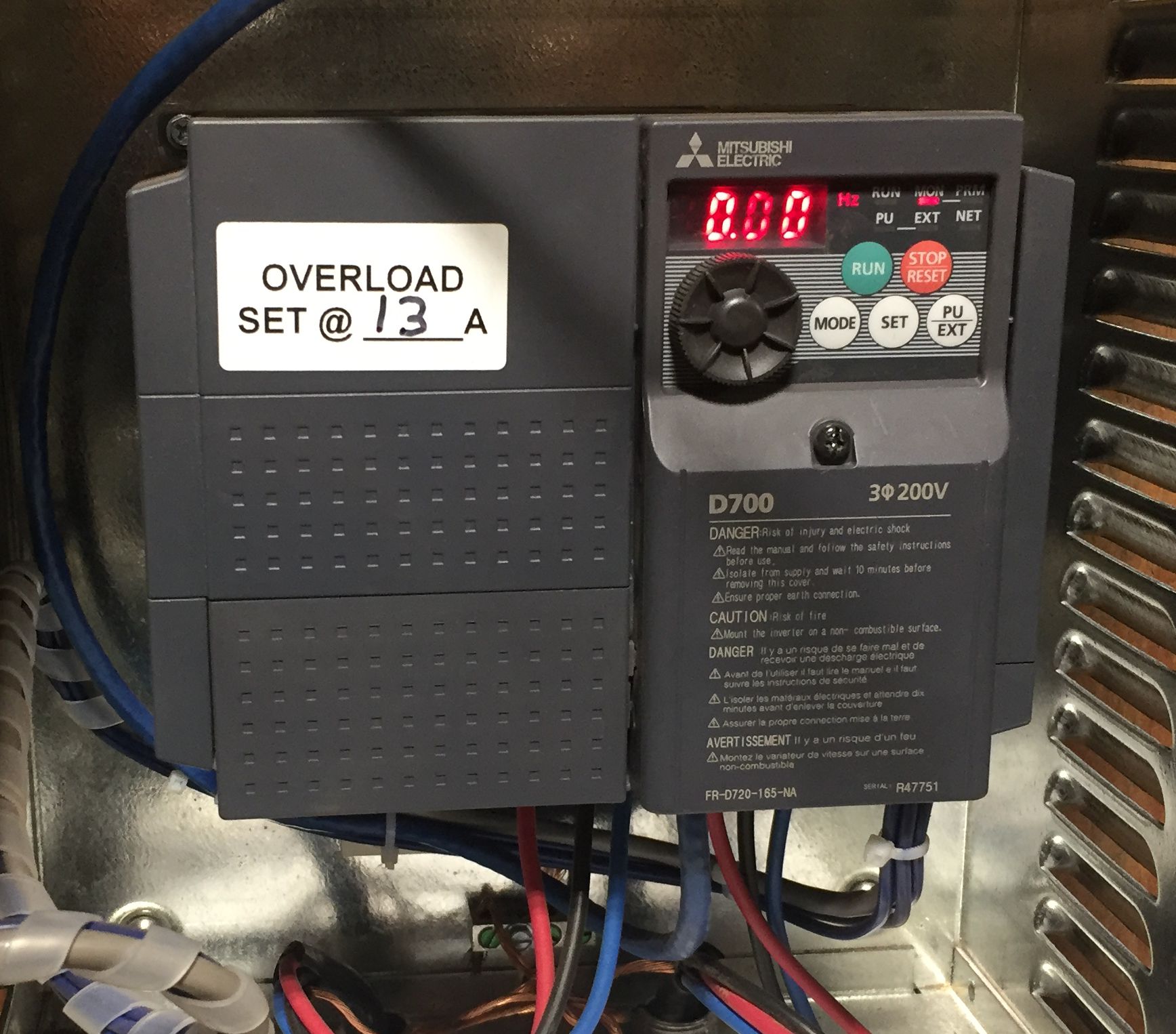

    Variable Frequency Drive
    5HP VFD Belt Grinder/Notcher-vfd.jpg

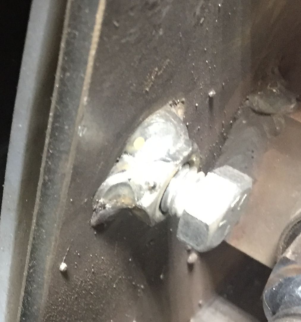

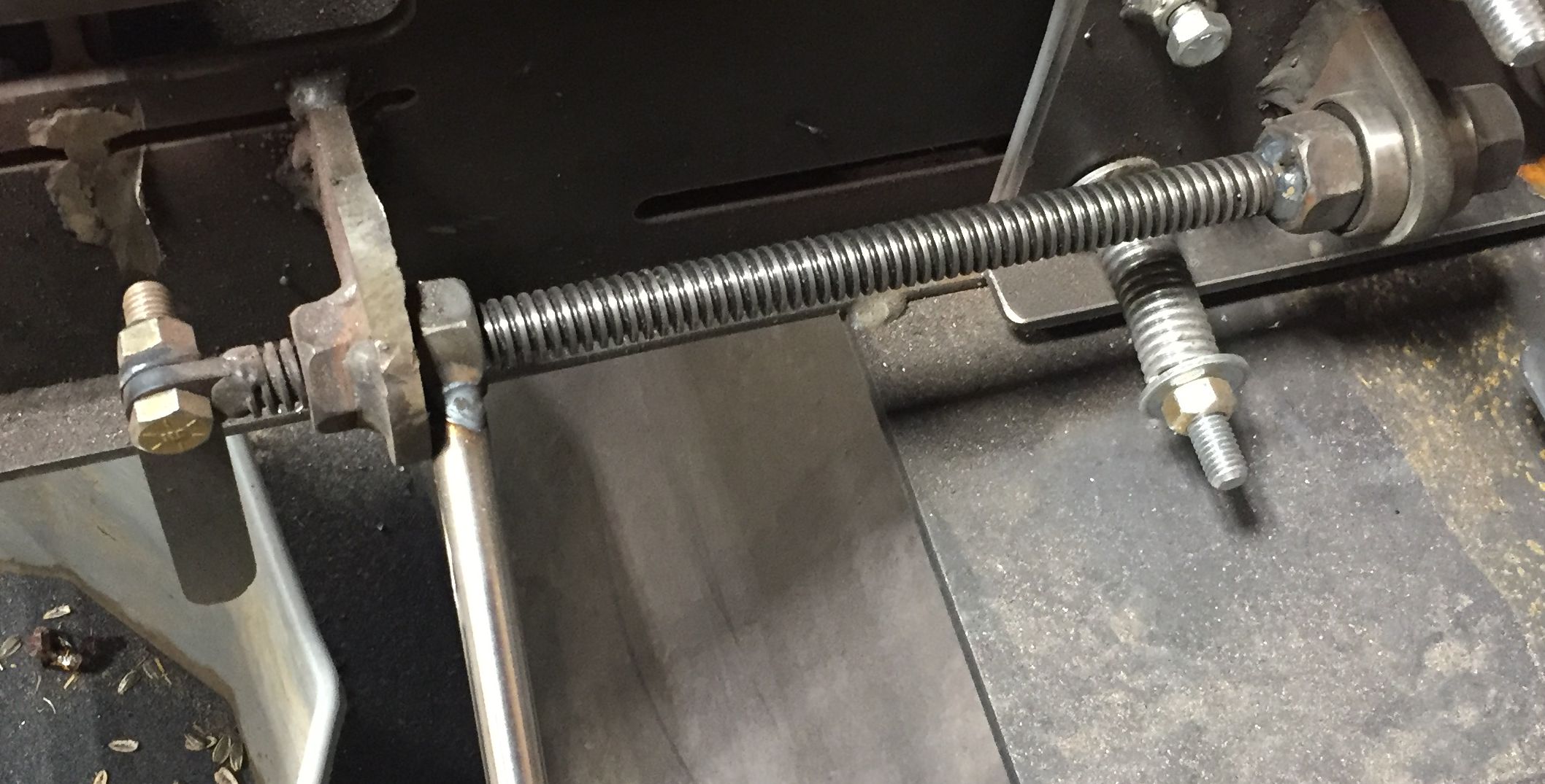

    .75 acme rod Tightening Mechanism
    5HP VFD Belt Grinder/Notcher-tighening-mechanism.jpg

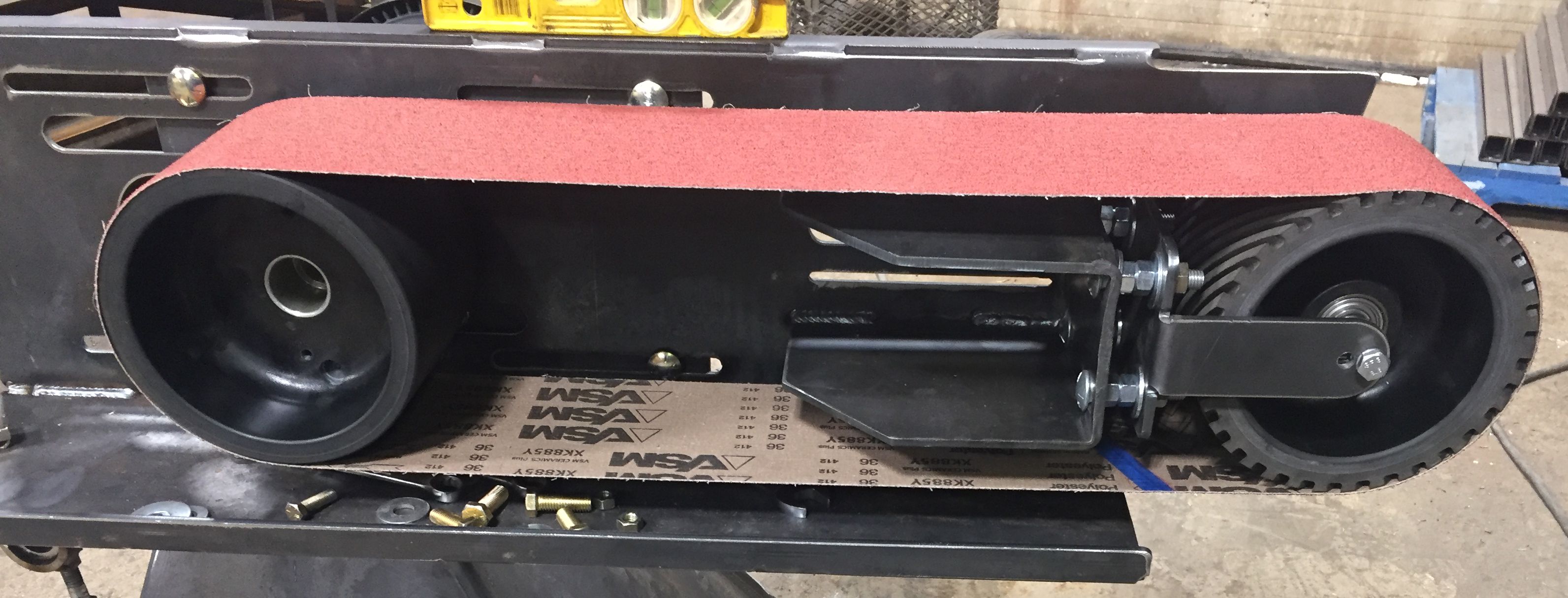

    Simple Tracking Mechanism
    5HP VFD Belt Grinder/Notcher-tracking-adjustor.jpg

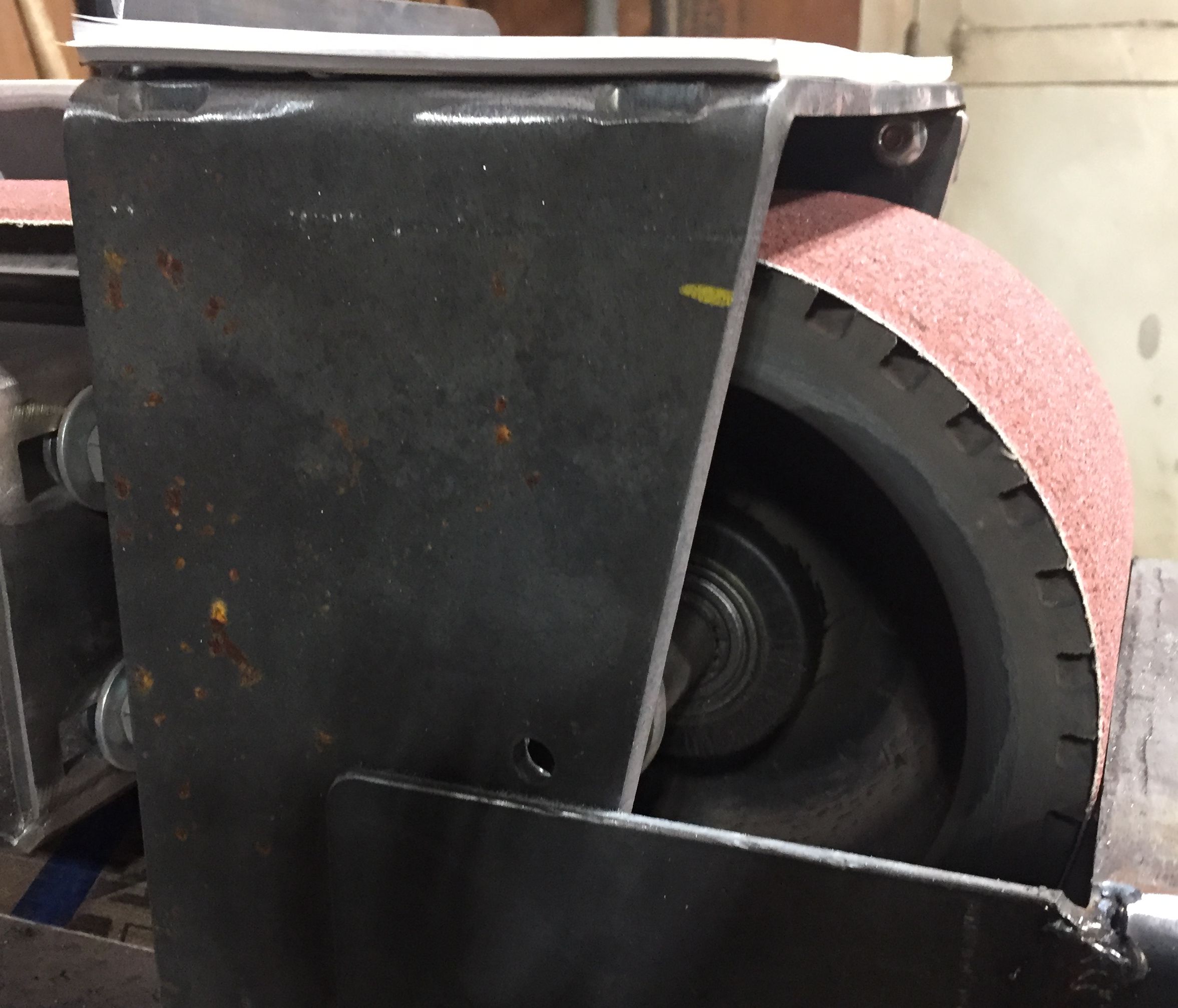

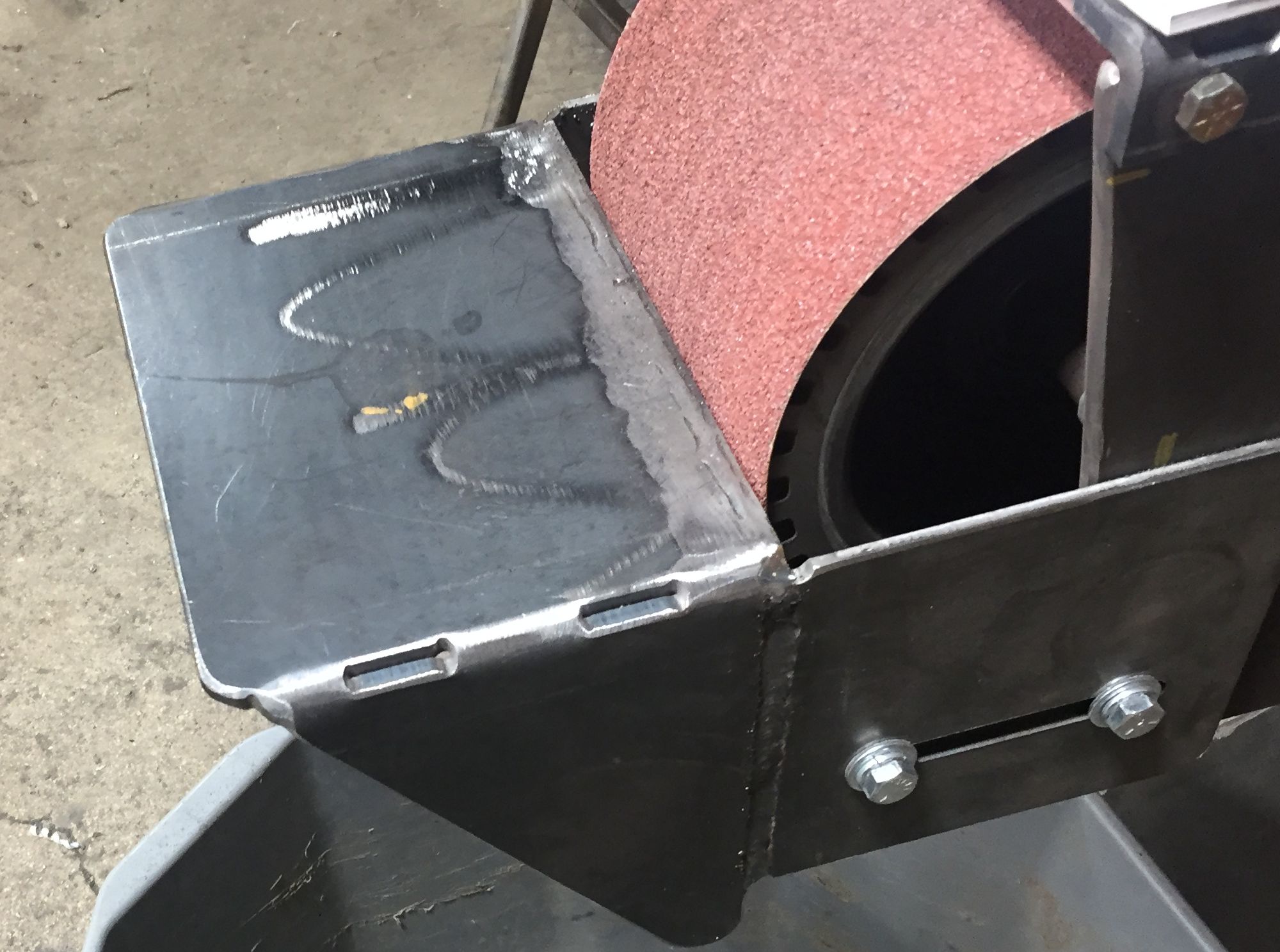

    Work Rest
    5HP VFD Belt Grinder/Notcher-work-rest.jpg

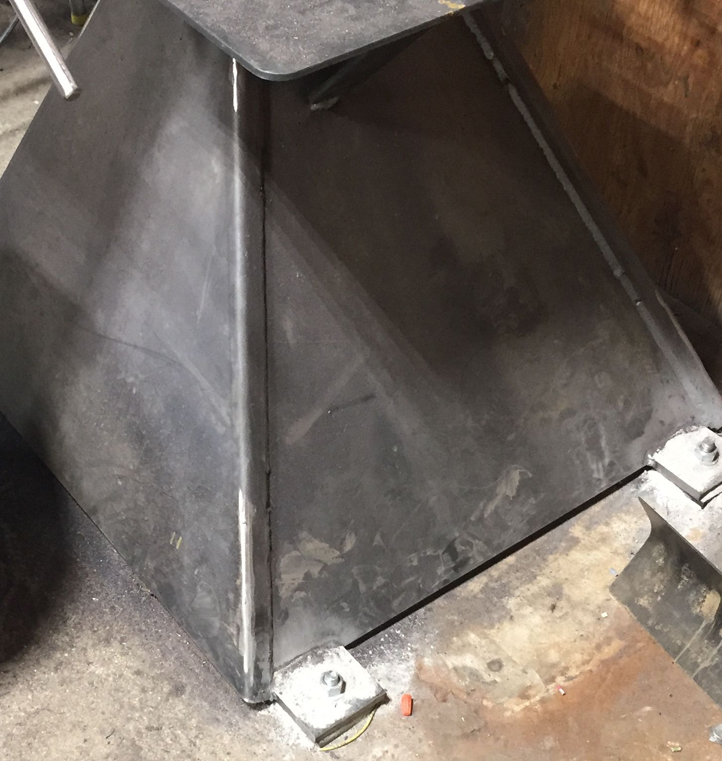

    36 Inch .25 Steel Base
    5HP VFD Belt Grinder/Notcher-base.jpg

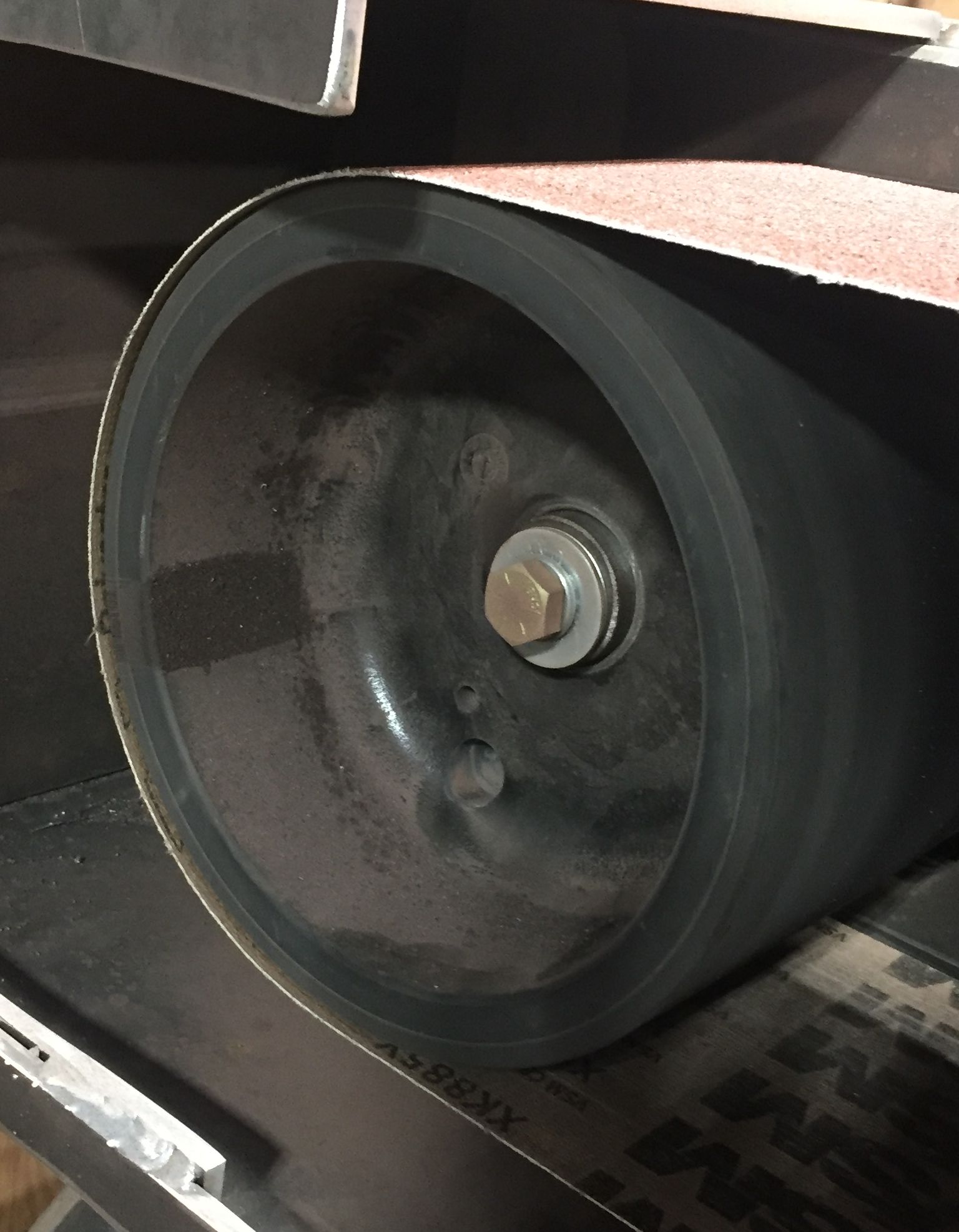

    8" Rubber Contact wheel purchased from Fein Canada (Told them i am repairing one of their machines. LOL)
    5HP VFD Belt Grinder/Notcher-8-inch-rubber-coated-contact-wheel.jpg
    8" Rubber/Teflon Coated Tapered Drive wheel (Also from Fein Canada)
    5HP VFD Belt Grinder/Notcher-8-inch-tapered-drive-wheel.jpg

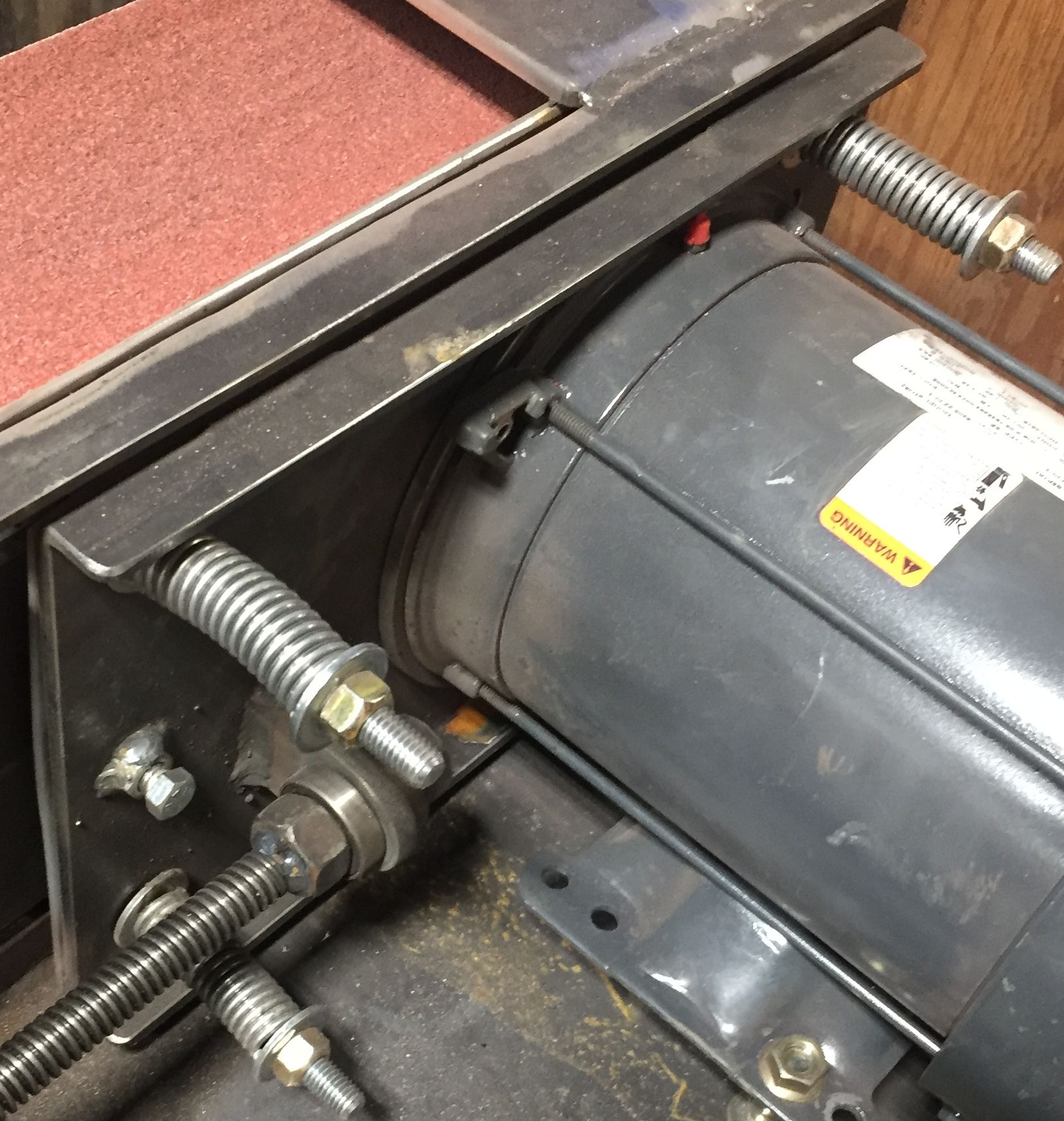

    Spring Motor Mount
    5HP VFD Belt Grinder/Notcher-motor-mount.jpg
