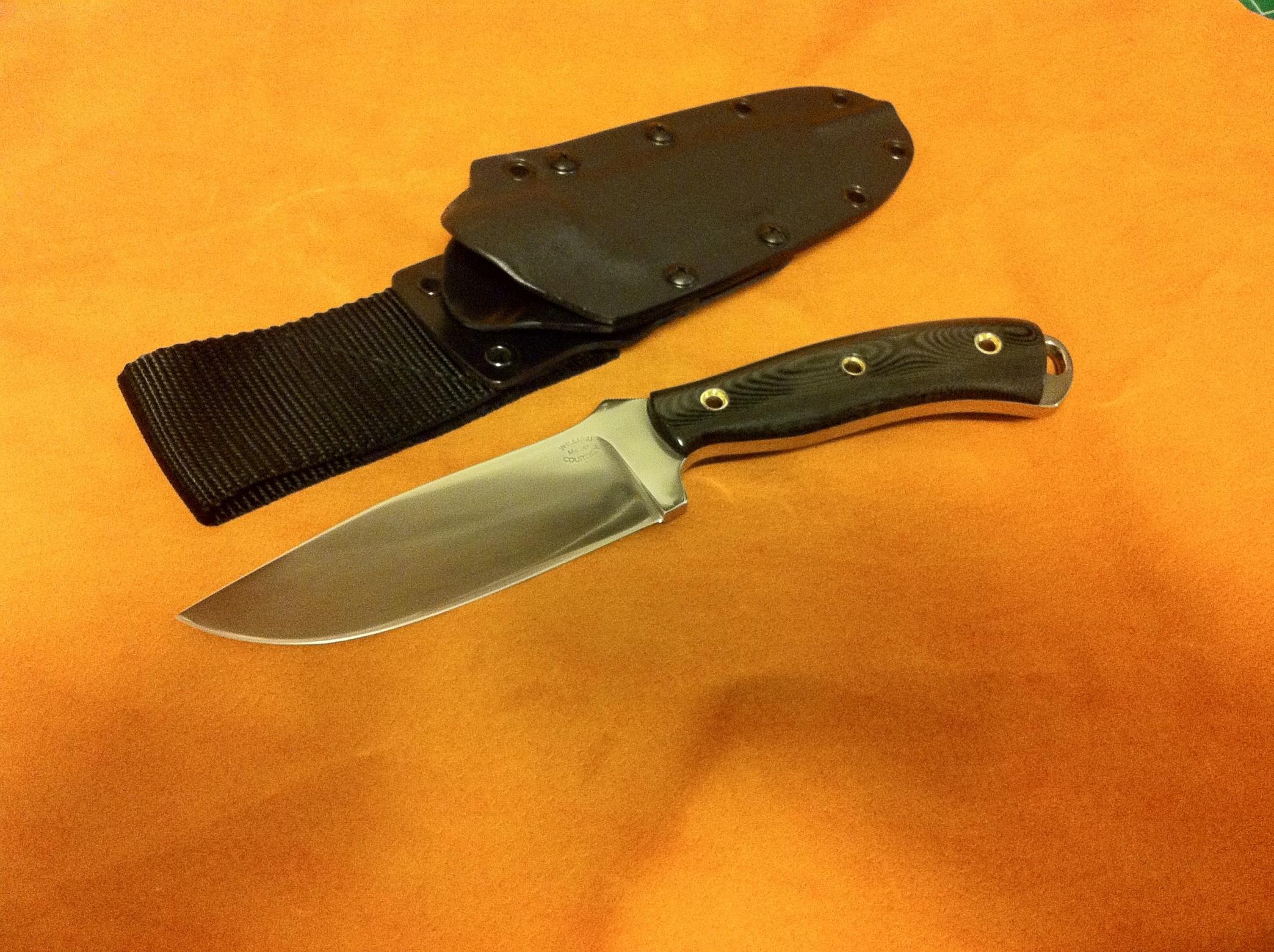

    Latest knife, forged from 52100 roller bearing, black linen mycarta handle scales, swaged brass thong tube pins, kydex sheath with nylon strap drop loop. 4 3/4" cutting edge, flat ground with convex edge, 10 3/8" overall.

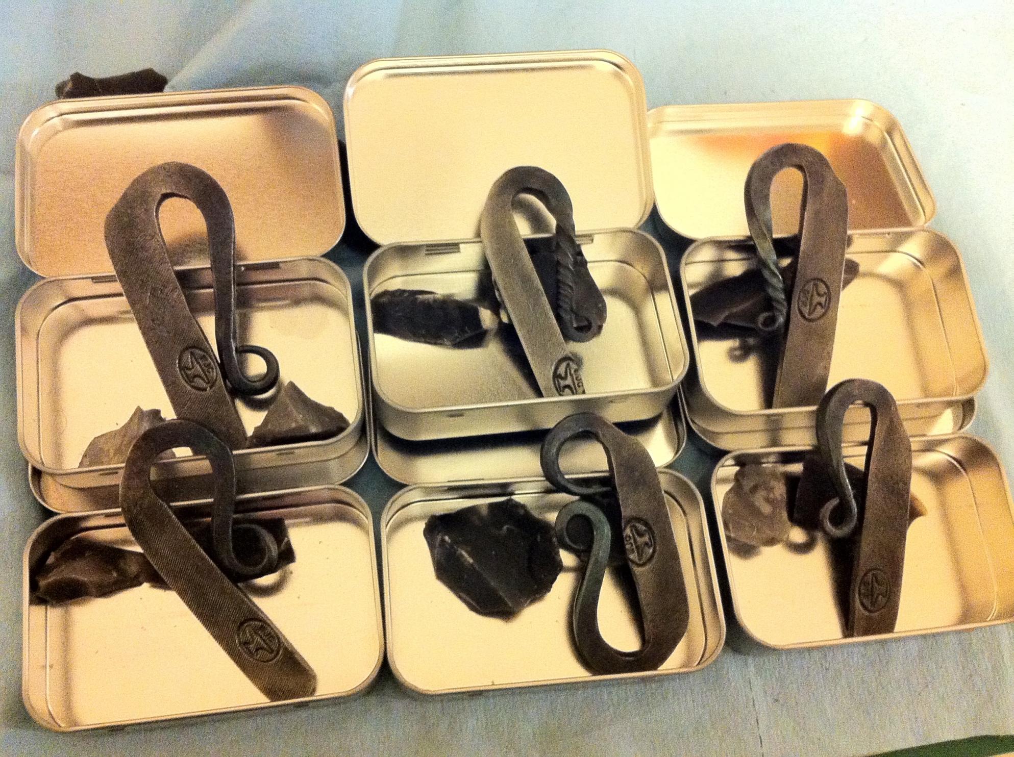

    The latest batch of flint strikers, these are already gone, someone wanted them as Christmas gifts, got to get busy and make some more. Forged from old files, with a tin and English black flint shards. Since old files are getting hard to find I'll likely be switching to W1 for future strikers.
