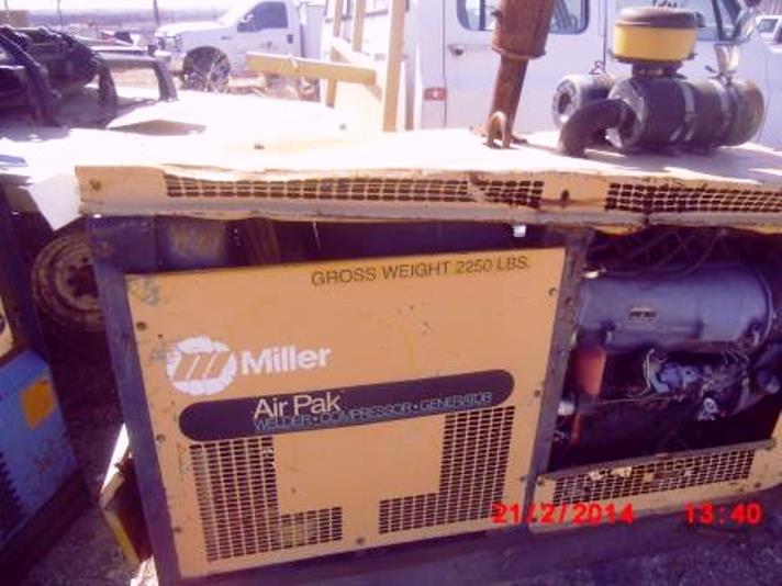

    It's been a while since I did this on ebut I thought I would share.

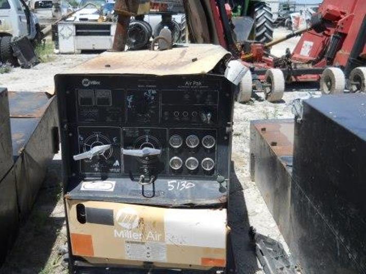

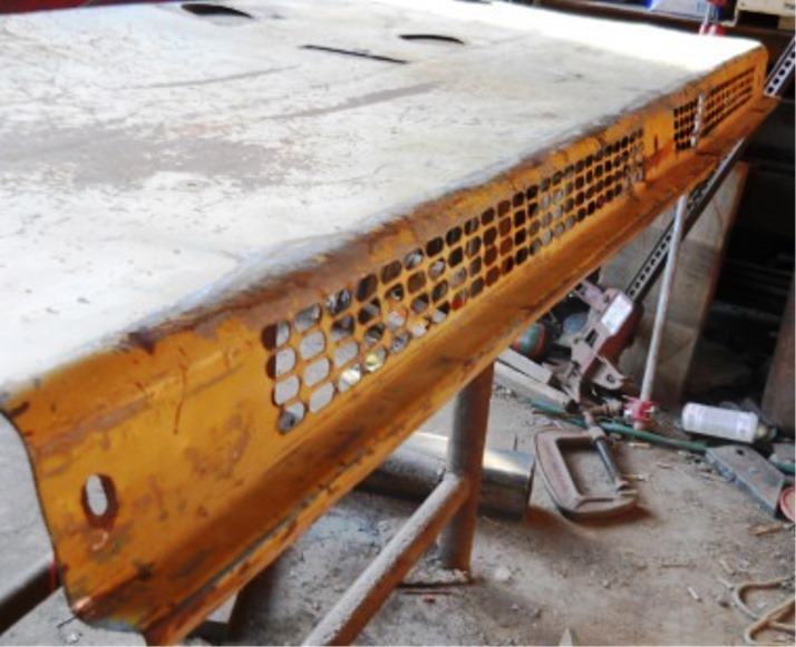

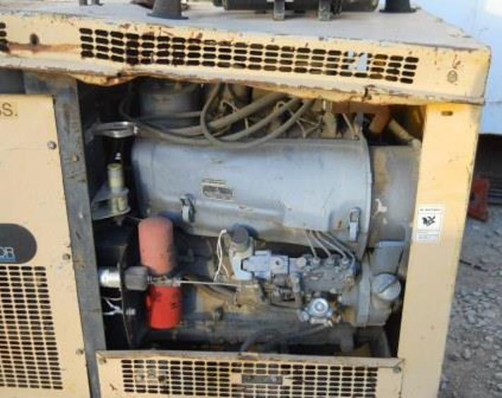

    This is a 500 Amp Miller Air pac with a 12 KW 3 ph option it was in pretty sad shape after being used by the railroad for many years, but it still ran and all systems functioned as they should so that made it worth rebuilding

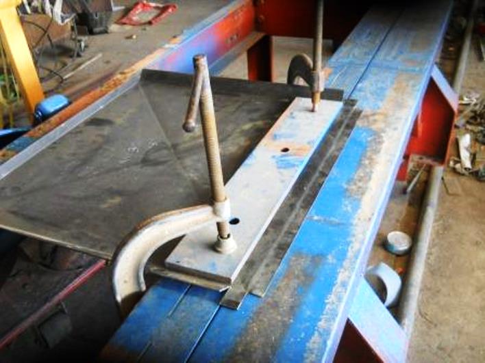

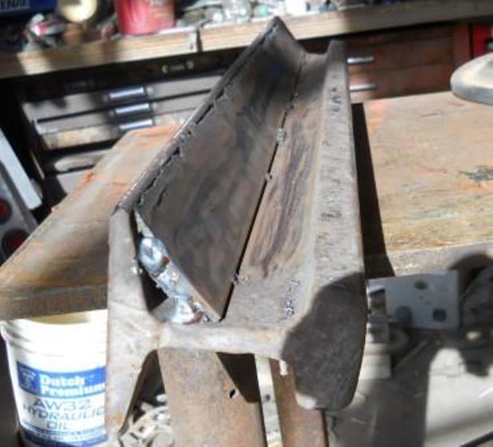

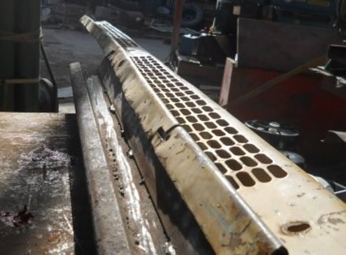

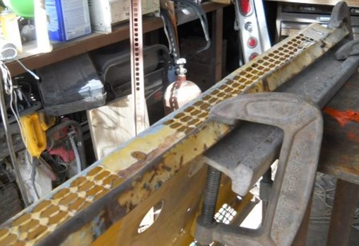

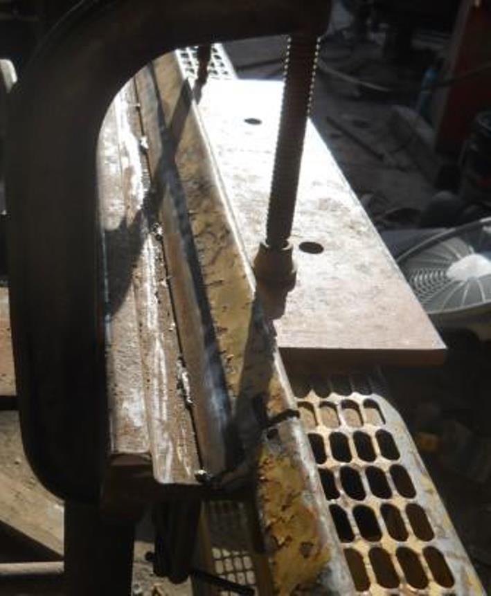

    Railroad track Forming anvil die I welded a strip of flat bar to one side of the rr track so I could have a different forming anvil shape for straightening the top and side covers

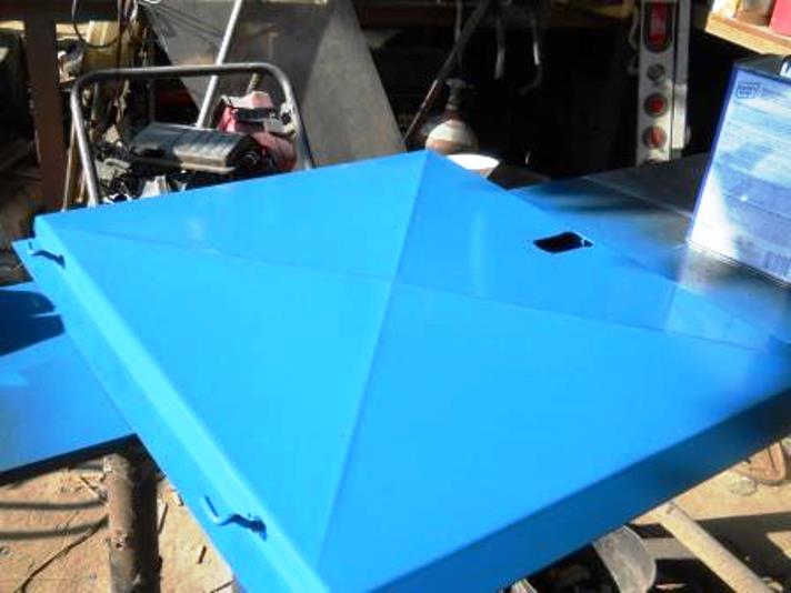

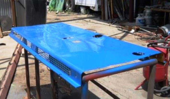

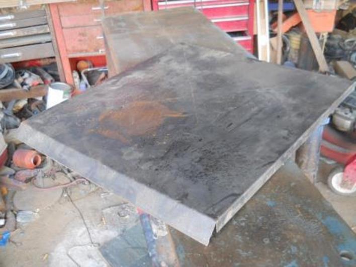

    Some covers were missing so I had to hand make them

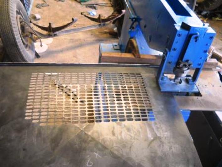

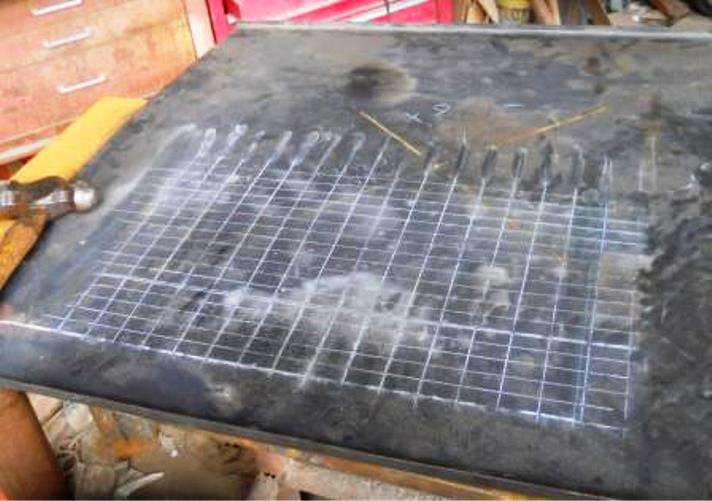

    Laying out for perforation punching

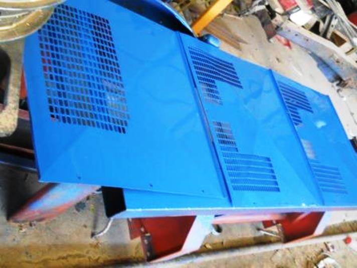

    Using my Roper Whitney 8 ton manual punch with a special ground die to make the oval perforations the Die and punch were bought from Cincinnati punch works
    Splash on a little paint and good as new. Almost impossible to tel which panels were straightened and which were hand made

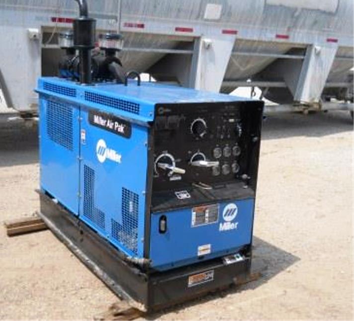

    add a few decals and that is how you take a $800.00 salvaged machine to being sold for $15,000.00

    This welder is huge!
    Thank you .
    Yes it is the engine is a 68 HP 4 cylinder air cooled Deutch the #1 cylinder has an air compressor head on it to the tune of something like 46 CFM @90 PSI
    The welder will burn 1/2" gouge carbons all day long and not complain and the 46 CFM air will blow the slag 20 feet. I rebuilt it for a customer who turned down the $15,000.00 offer. I know this for a fact because I am the one who offered that amount after he had paid me to restore it
    He uses it every day to power his truck repair shop. He says they can run all of the shop electrical requirements off of the regular 110/220 receptacles even while welding using 3/16 or even 1/4" rods or when he needs to use the 3ph he still has the 110/220 Plus the air to run impacts or for tire repair
