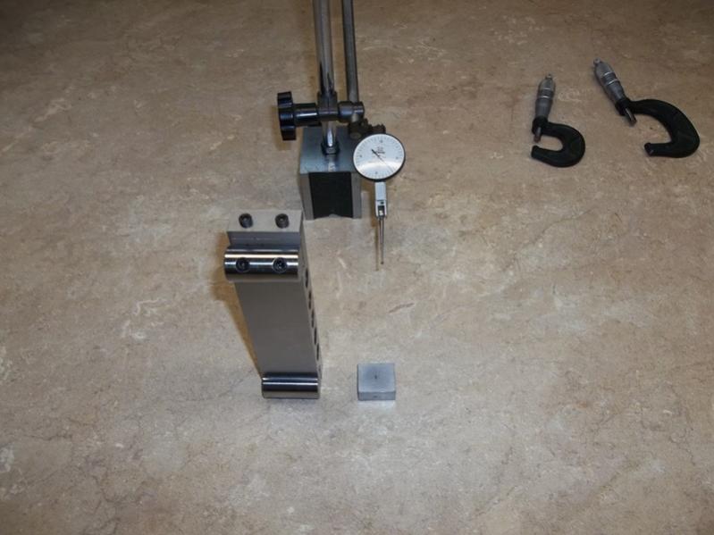

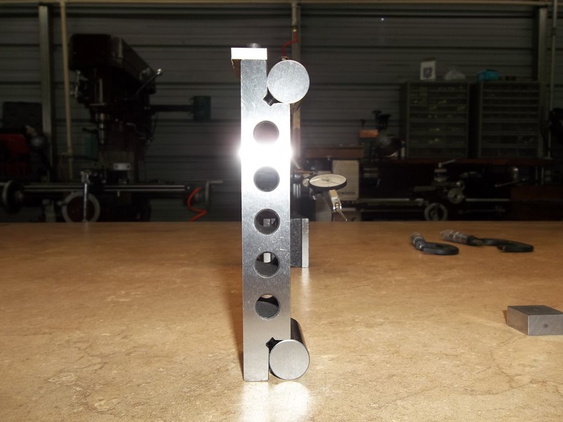

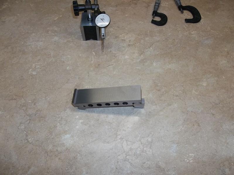

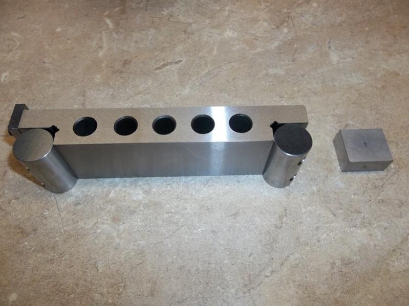

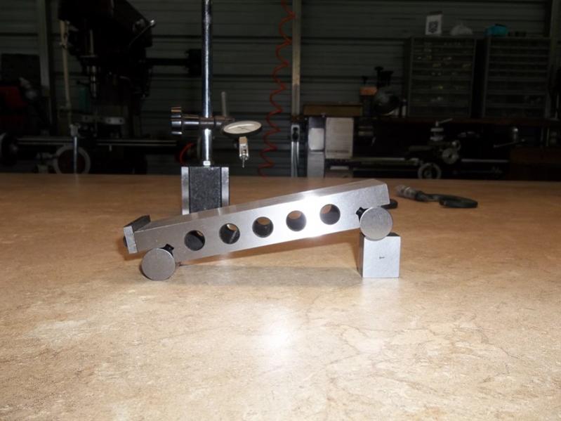

    I was going to buy one of these off e-bay, there really cheap, around $30.00 or so, the real good ones are any where from $80.00 -$300.00.
    The cheaper ones aren't that accurate, a friend of mine got one and checked it and it was within .002-.004 all over, not very accurate if you ask me, but I guess for some people that might be just fine, But for me that wasn't good enough, And I wasn't going to pay big bucks for one either so I decided to make my own.
    I started with a piece of 1.00" X 1.50" X 5.81" O1 tool steel, Milled it all over to it's basic geometry to within about .015" of the finished size, Then I took a piece of .750" O1 drill rod and made the two cylinders, I sawed a thin piece of the 1 x 1.5 flat stock 1/4" long for the stop, Milled it to within about .015 of it's finished size as well.
    Then came the heat treating process, I hardened everything to maximum hardness then tempered them, I would say there around 55 RC, A file just glides over the parts.
    Meanwhile the bearings in the surface grinder are warming up, I ground the sine bar and the stop all over flat parallel and square except for the two shoulders the cylinders seat on, I sat the bar vertical in my Brown and Sharpe 3" tool makers vise and ground one shoulder and end, I stacked up my gage blocks to 4.2540" then set the one tenth indicator up in the surface gage, put it on top of the blocks and zeroed it in. I very carefully ground and checked, ground and checked until I was +.0001 TIR. I then ground the end of the bar and it was finished !
    I ground carefully the two cylinders to .7460" - .7459" I installed the two cylinders on the bar with four 8-32 SHCS
    Then I sat the bar on it's cylinders onto the magnetic chuck and ground the top of the bar one more time, Installed the stop and it was finished.
    Below are some photos
    Thanks for looking and happy machining
    Doug
