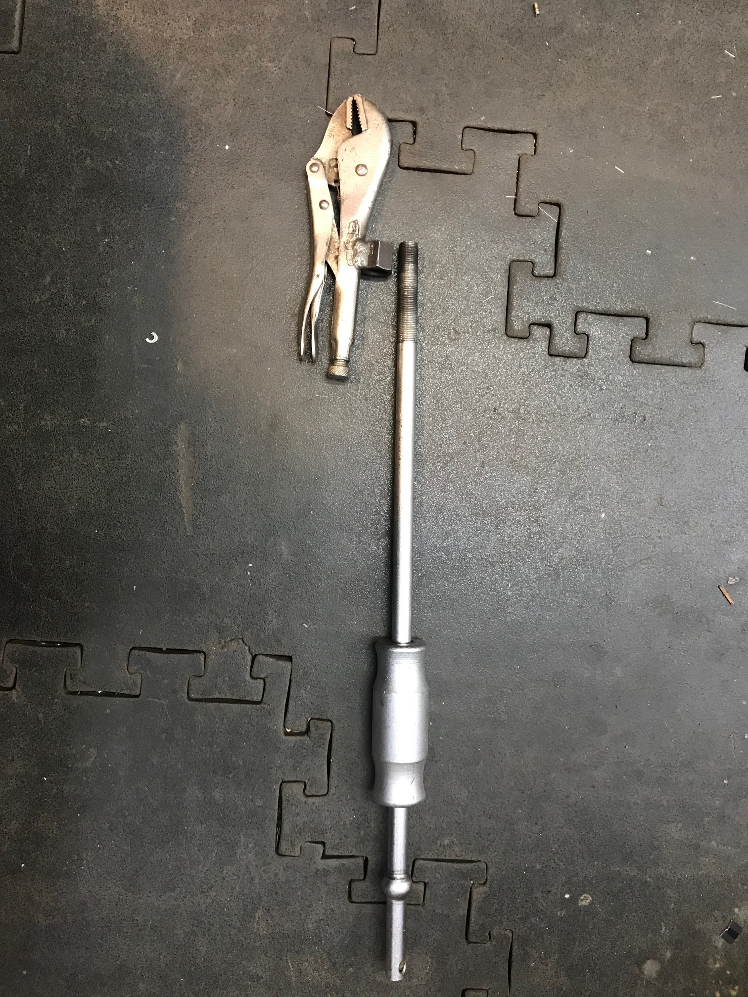

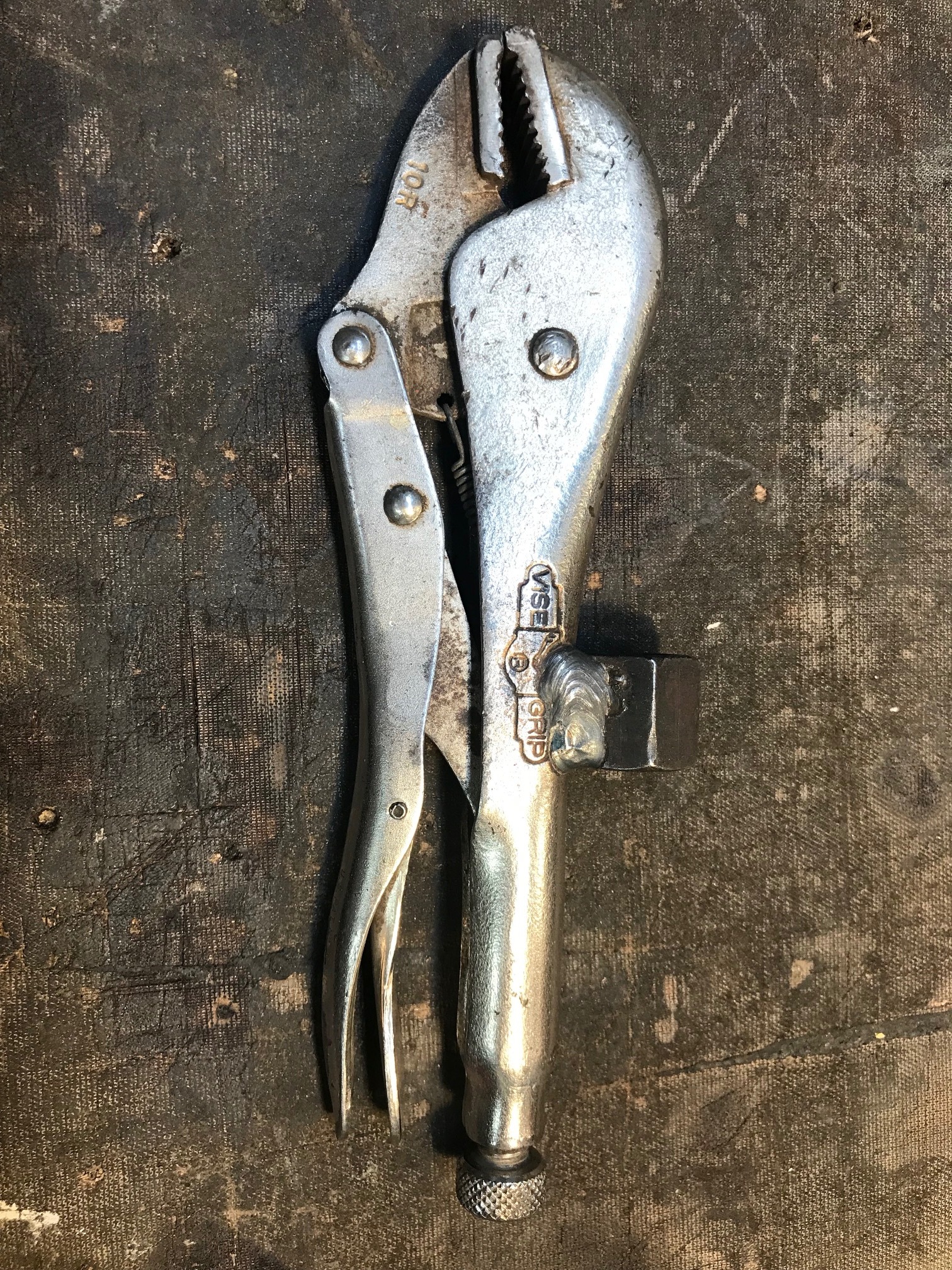

    And you can weld a nut on your Vice Grips and use them with a slide hammer...

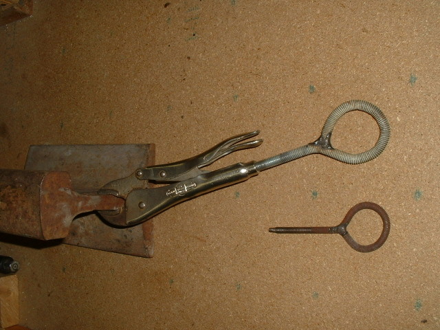

    Another way to use a slide hammer w/visegrips:
    Attached Thumbnails Attached Thumbnails 5 modified vise-grips - video-visegrip-eyebolts-1.jpg
