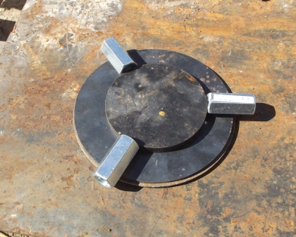

    I needed a small steady rest for an up coming project I am wanting to build so the first step was to make one.
    I started out with a couple of 8" dia. 3/16" thick disc that were picked up at the local scrap metal yard. then bought 3 3/4" coupling nuts and a piece of all thread. All thread is not ideal for making the adjustable guides but suitable for a light duty rest.

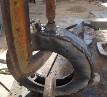

    After welding the coupling nuts and discs together I bored out the center
    next I welded a 1/8" thick strap around the perimeter
    5 inch steady rest for Leblond 19 lathe-dscf6893c.jpg 5 inch steady rest for Leblond 19 lathe-dscf6896c.jpg

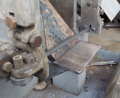

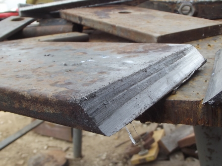

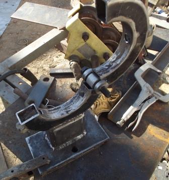

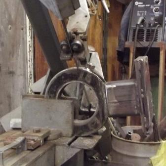

    not wanting to try and make a hodge podge set up to mill a "V" grove in the base I elected to simply saw off the end of the sub base with my band saw

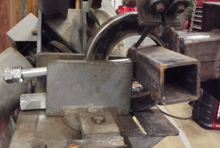

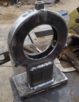

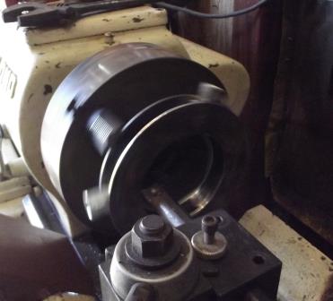

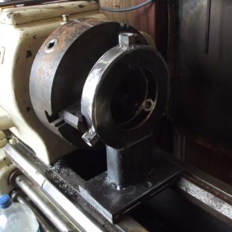

    Next I chucked the rest in the lathe and tacked the base and stand to it

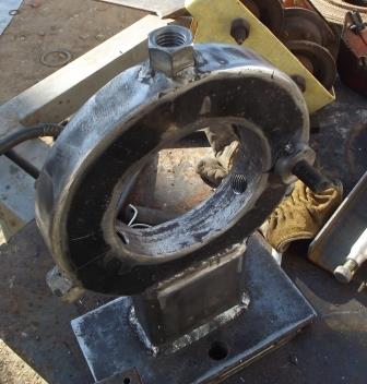

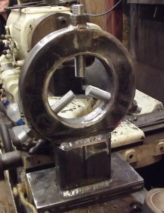

    After welding I did a trial fit of the guides
    5 inch steady rest for Leblond 19 lathe-dscf6914c.jpg 5 inch steady rest for Leblond 19 lathe-dscf6917c.jpg

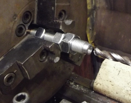

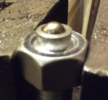

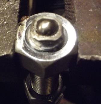

    Then I machined one end of the guides and drilled a hole deep enough to accommodate a 10 mm bearing ball
    then I slightly struck the guides in 4 places around the ball to secure it in place, the ball still rolls freely in its socket.

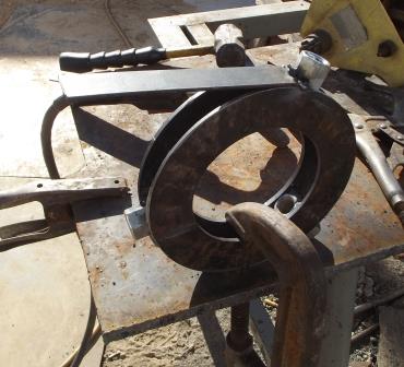

    Next I cut the rest in two once the blade had cut nearly all the way through the first side the saw cut closed up binding the blade to free it I simply used a long piece of all thread and a piece of tubing to spread the rest open enough to free the blade
    5 inch steady rest for Leblond 19 lathe-dscf6922c.jpg 5 inch steady rest for Leblond 19 lathe-dscf6923c.jpg

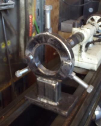

    After separating the 2 parts and trimming one for the hinge I tacked the hinge in place then welded it and the hold down lock tabs to the opposite side
    5 inch steady rest for Leblond 19 lathe-dscf6926c.jpg 5 inch steady rest for Leblond 19 lathe-dscf6927c.jpg
    ready to use as soon as I drill 1 hole and clamp it down to the lathe
    Some day when I have the time I may paint it

    Thanks TM51 I wound up an painted the steady as you have probably noticed in the thread where I used it in conjunction with the long boring bar and the wood blocks to line bore locations on a part I was repairing http://www.homemadetools.net/forum/q...1971#post95223
    I have used the steady many times its light weight being made from mostly 10ga & 3/16" steel is actually another plus I can easily store it in a cabinet high up on the wall without having to strain a gut reaching for it
    I am not as satisfied with the single bearing balls making contact with a rotating shaft as I would like but they do roll freely enough and so far have not caused a problem I keep a lot of lube on them just as if I were using brass buttons so that helps.I have a pair of rings to make a 10" steady just haven't had time to make it yet. only this one since the turning parts will be much larger diameters I will use full bearings for the rollers.

    Bearing balls made me think, a lot of + & - factors.
    + Near zero play; - tiny surface contact. + Easily replaceable, - unsure new ones be same grade. + Many common sizes, - do ball endmills cut real spheres? I'd probably ball cut where a pilot drill removes 20 something percent area of center contact. 'Floating' in high pressure lube and well sized pocket, running good material like shafting might be.
    Full bearings are common sure enough, wonder if anyone's run bare rollers from bearings compared to bearing balls?

    Well one thing I found as part of the (-) is the small contact area a way I have compensated for that on a few occasions was to machine a sleeve to slip fit the stock being turned with an OD that pressed fit into the 65 mm ID of the inner race of the bearing the balls came out of. I am thinking about one day replacing the balls with a needle or roller bearing assembly or a cam follower held in place with slotted arms keeping the same adjuster screws. but before I do that I need to make a follow steady
