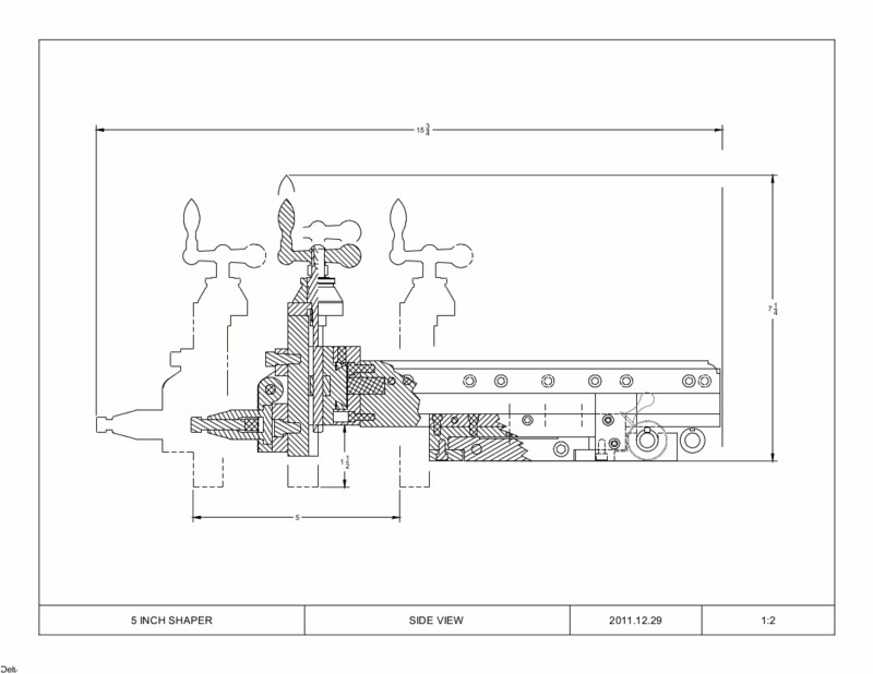

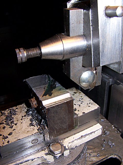

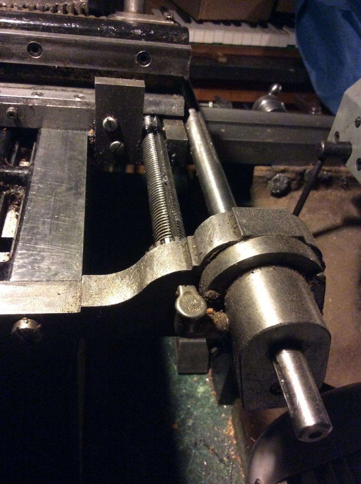

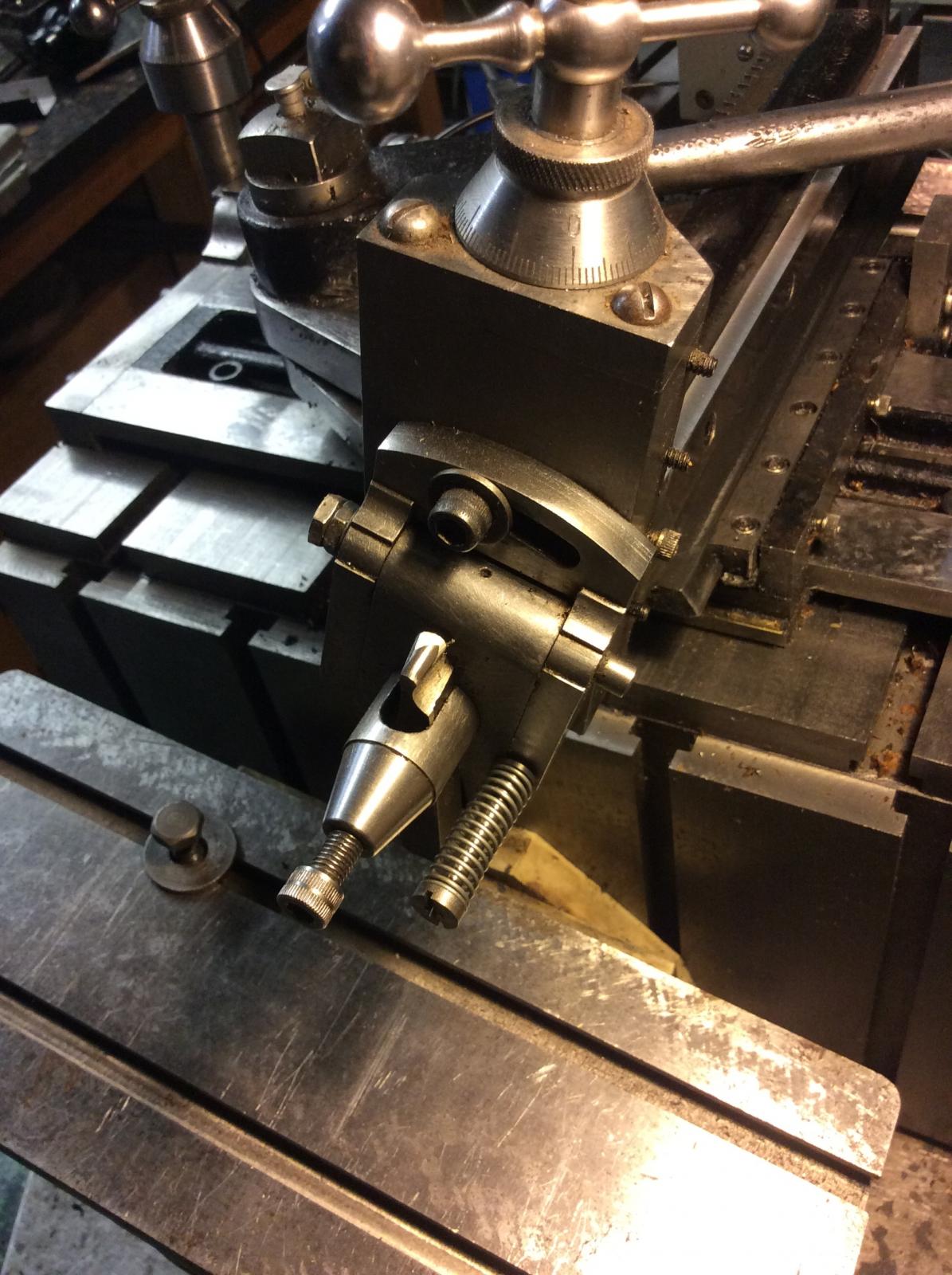

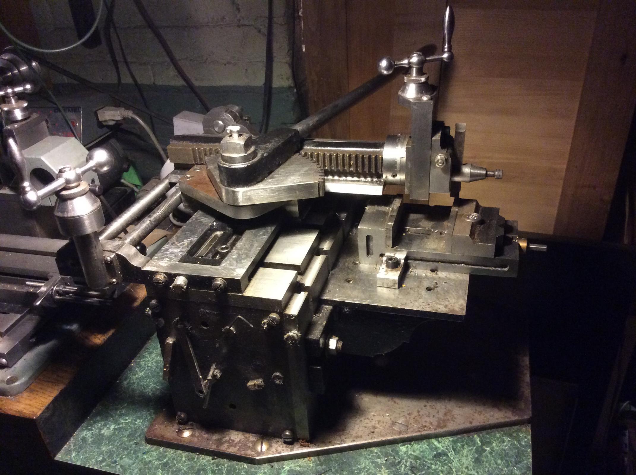

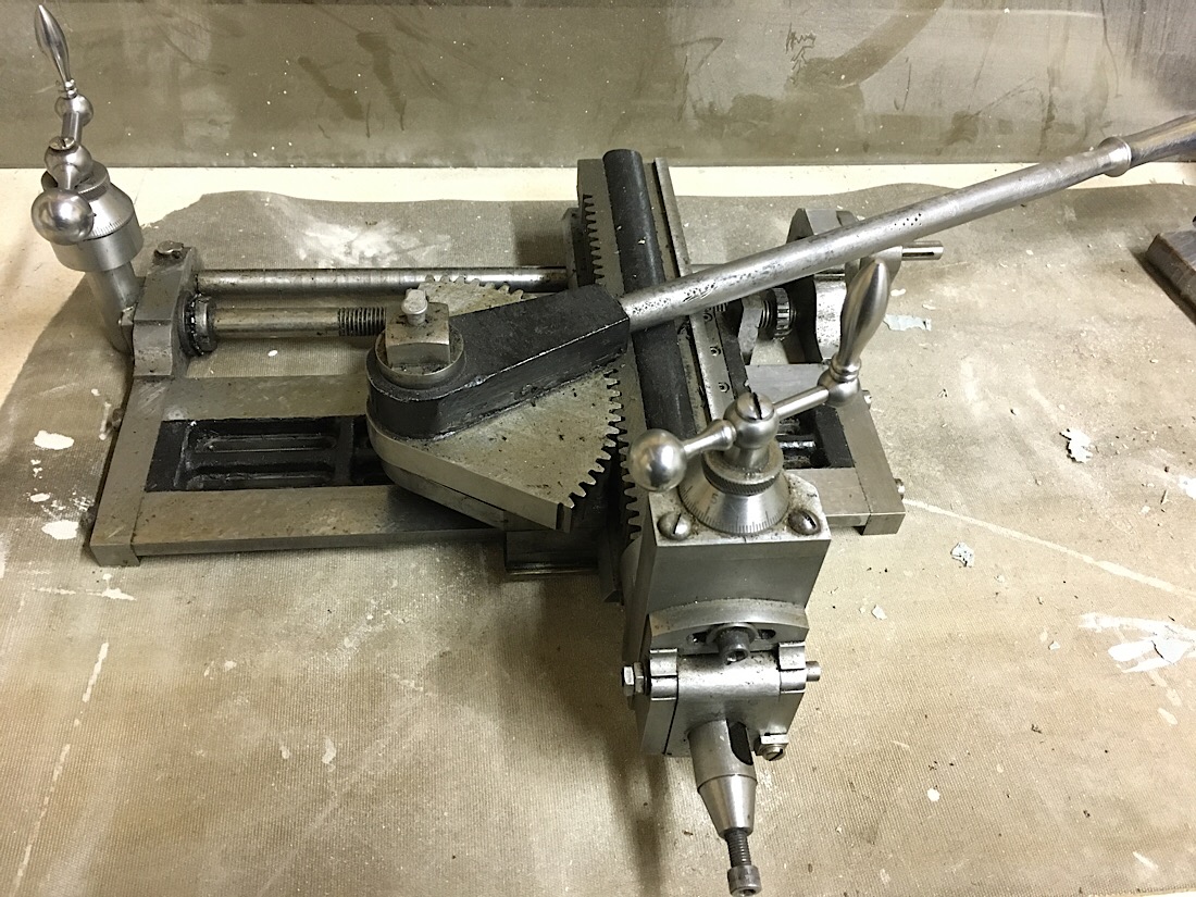

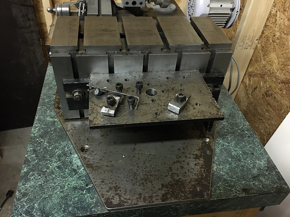

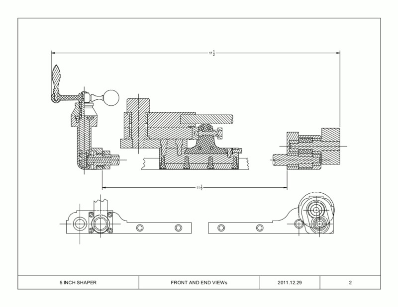

    This is my little hand powered traveling head shaper. I copied many details from small machines like Perfecto, Adept, and Bradley, but also from some old full size shapers.
    I changed the arrangement to make it more compact and portable, with the feed handle higher up and the feed screw farther back than on those. The heavy rectangular base has t-slots on the front and on the top and the whole working part can be repositioned or removed as easily as the two tables I have for it, so that the machine can be mounted directly onto work. I built it planning to add automatic feed and a motor drive as I needed them, but haven’t done either yet.
    It takes a pretty good cut! But that depends on the “motor,” too. It has about 8” cross feed and 1-1/2” down feed, and the overall size is about 16x16x16”. I think it weighs a little over 100lbs.

    Thanks, Subtlehustle - thanks, Dick - it’s been a good little worker and I can do things with it that I can’t do with other tools.
    One thing, the way it’s arranged, overalls - or a bib! - are pretty much required using it.

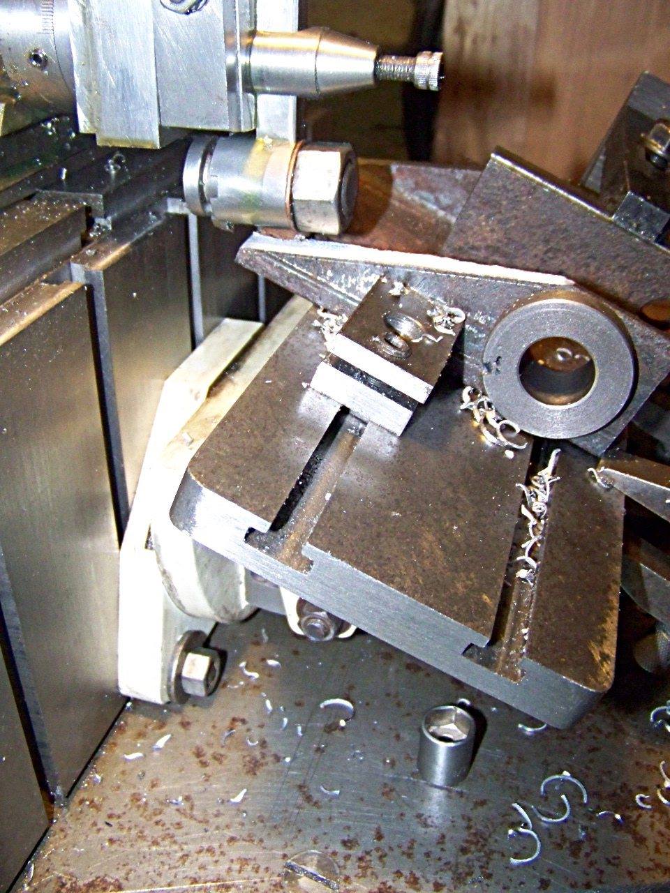

    It was an interesting project that really pushed the limits of my skills and of my tools - it’s really not much smaller than those - but it’s satisfying to use and has really surprised me what I can do with it.
    A lot of the machining was done with a Unimat headstock strapped to my Atlas mill.
