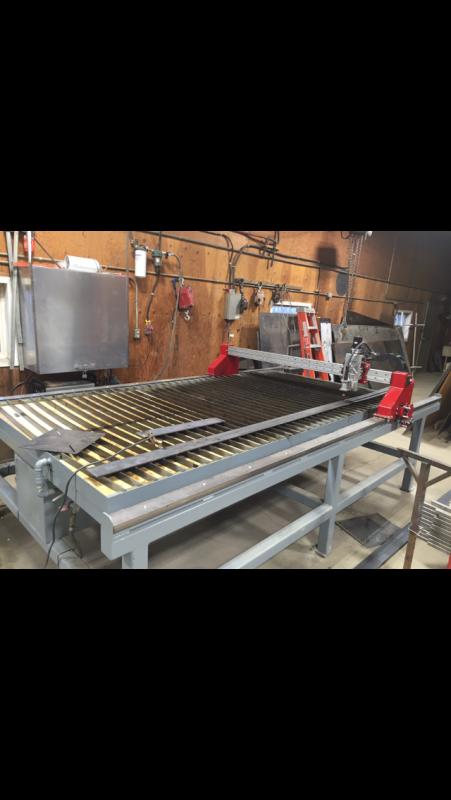

    5 by 10 cnc plasma
    Precision plasma gantry
    Candcnc electronics
    Homemade water table

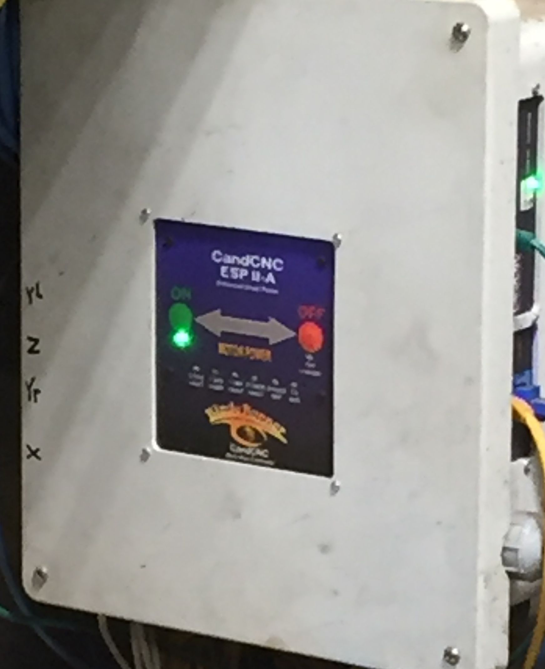

    More Info on 5 by 10 Plasma Table
    First of all i have to say i Built the table portion of this machine and i bought the Gantry and Gearing Kit from Ron at Precision Plasma (Awesome Guy ), and the steppers and electronics and Controllers,computer from CandCNC Plasma out of Texas. ( Very good service and support )
    Linux Xubuntu Command CNC Software from CandCNC Plasma out of Texas

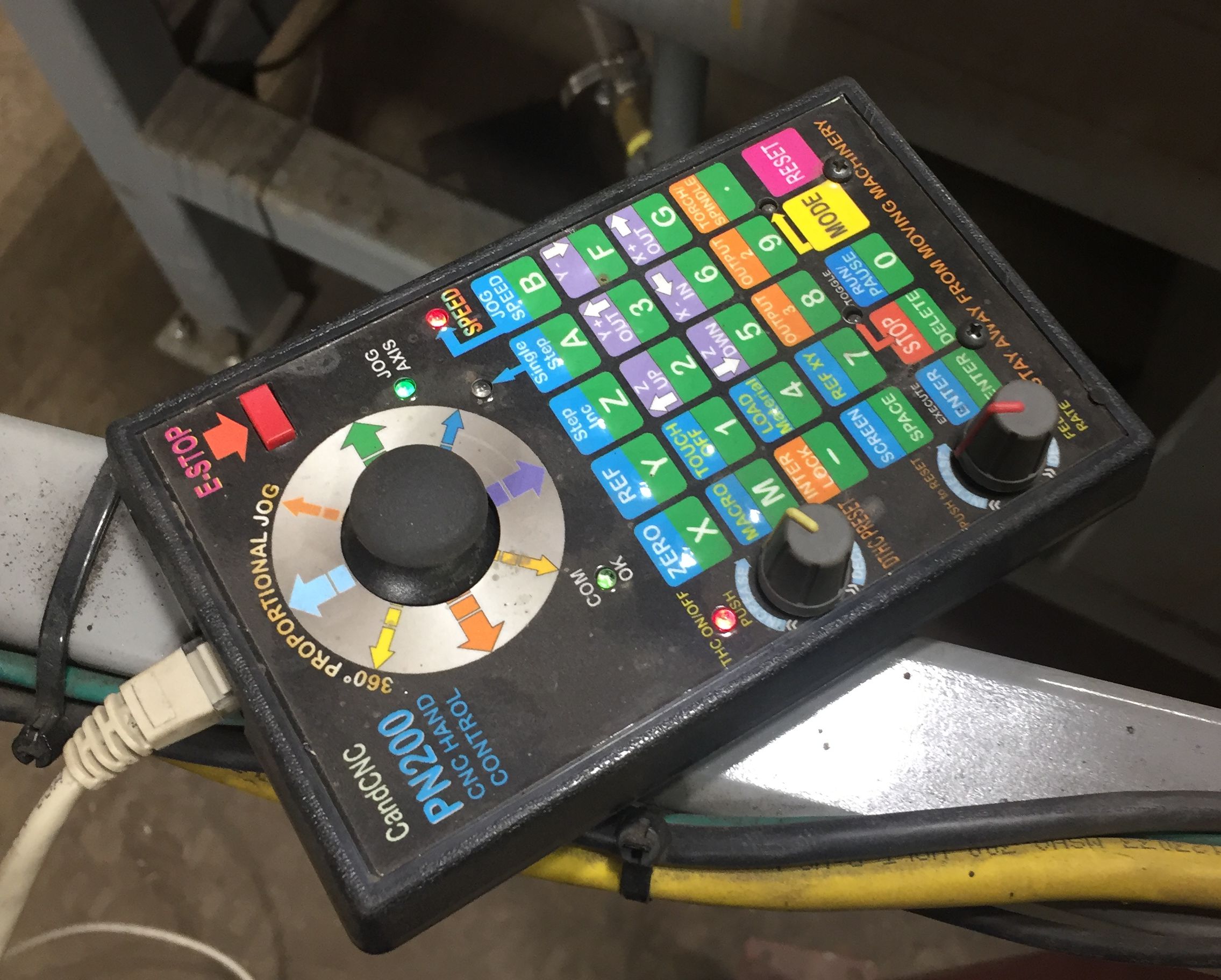

    PN200 Remote control Pendant
    Bladerunner Controller

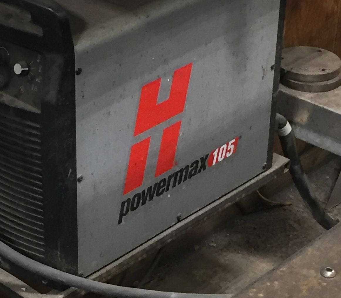

    Hypertherm Powermax 105 Plasma

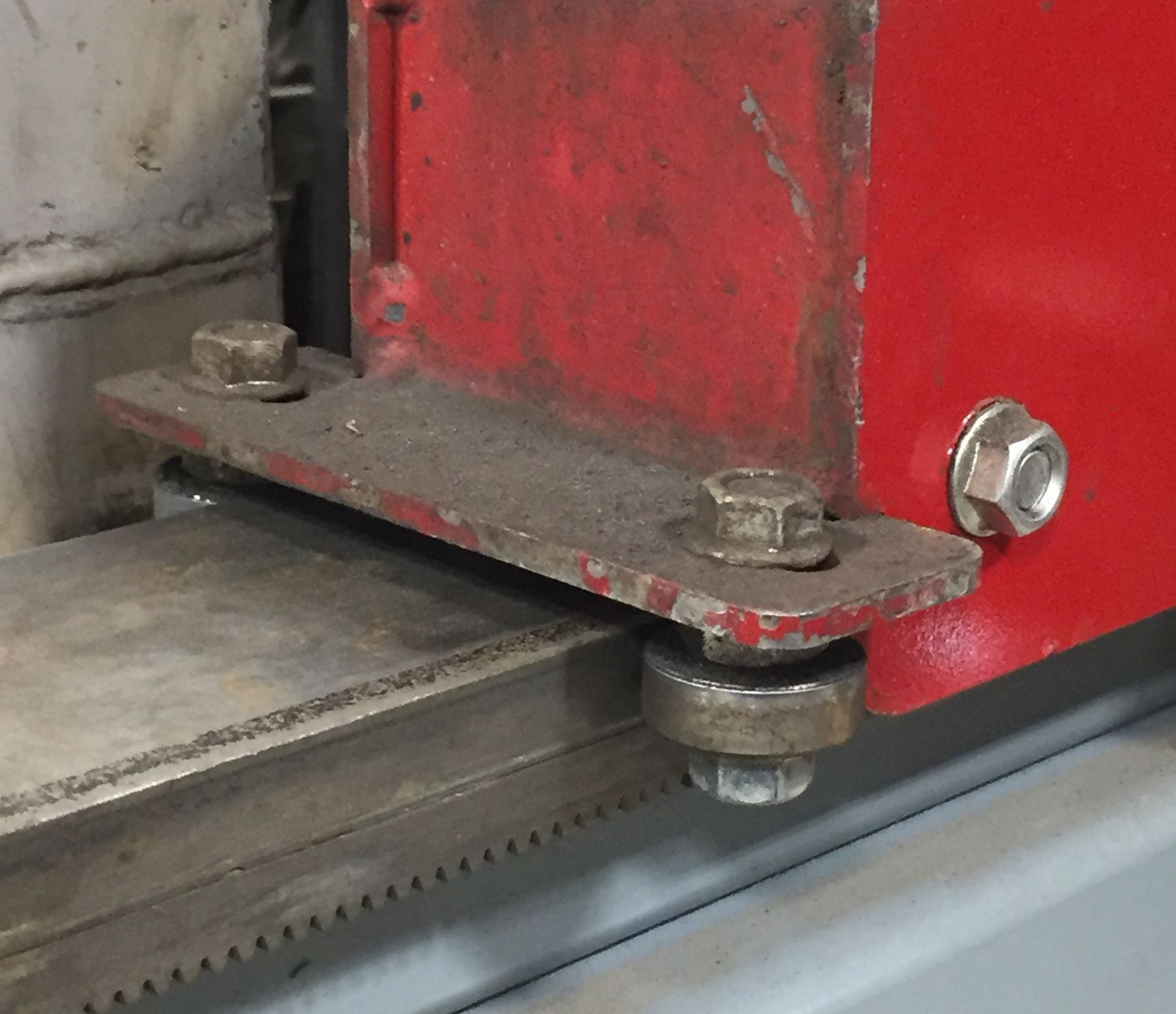

    CRS Linear flatbar Rails

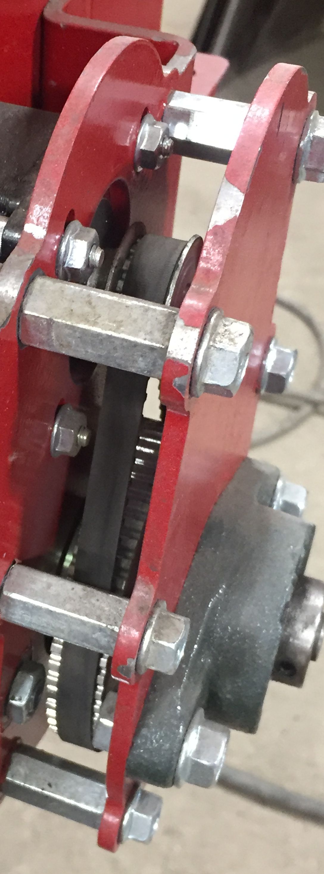

    3 to 1 Belt Reduction Drive

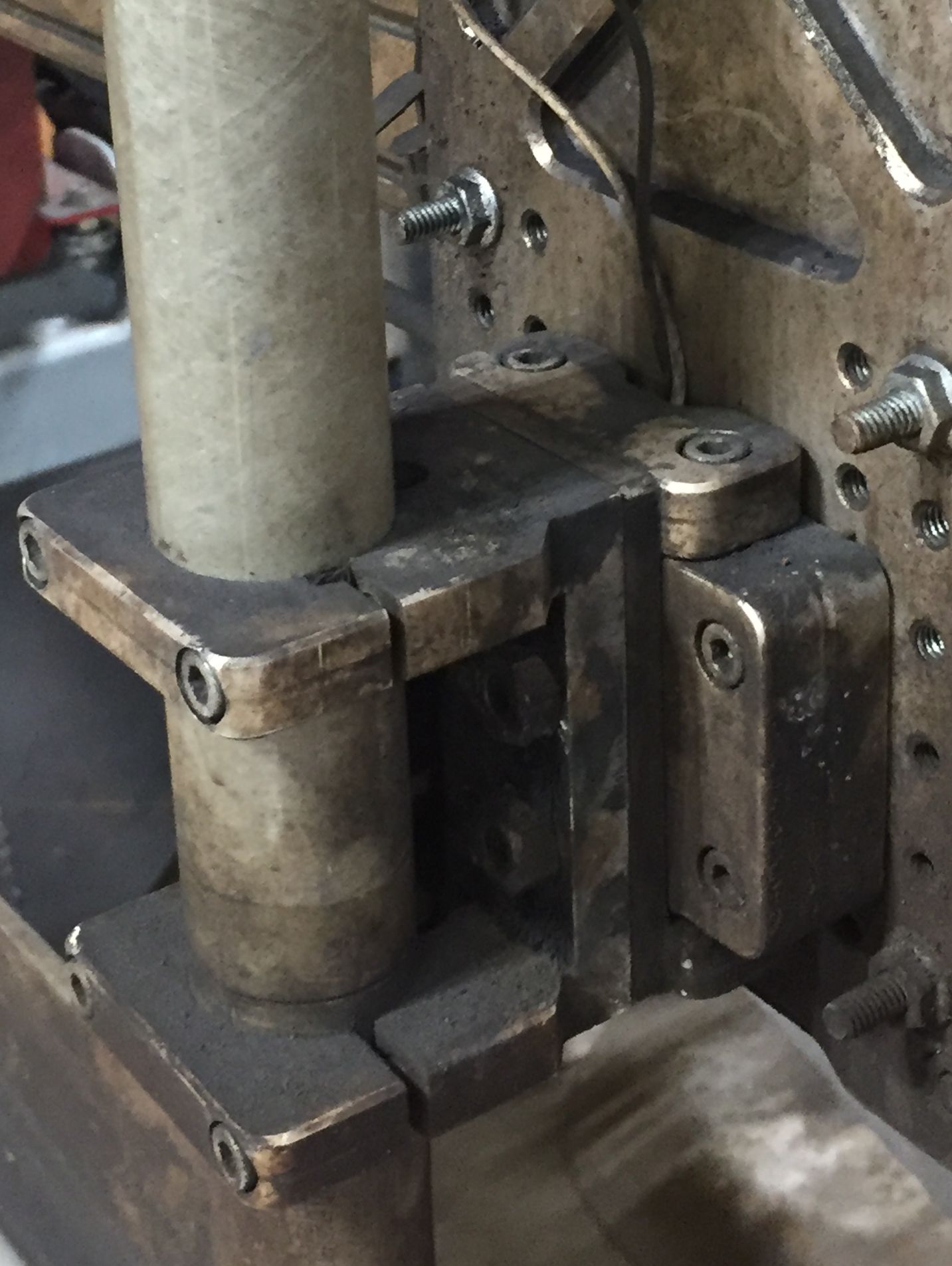

    Velox MagMount Torch holder on z-Axis

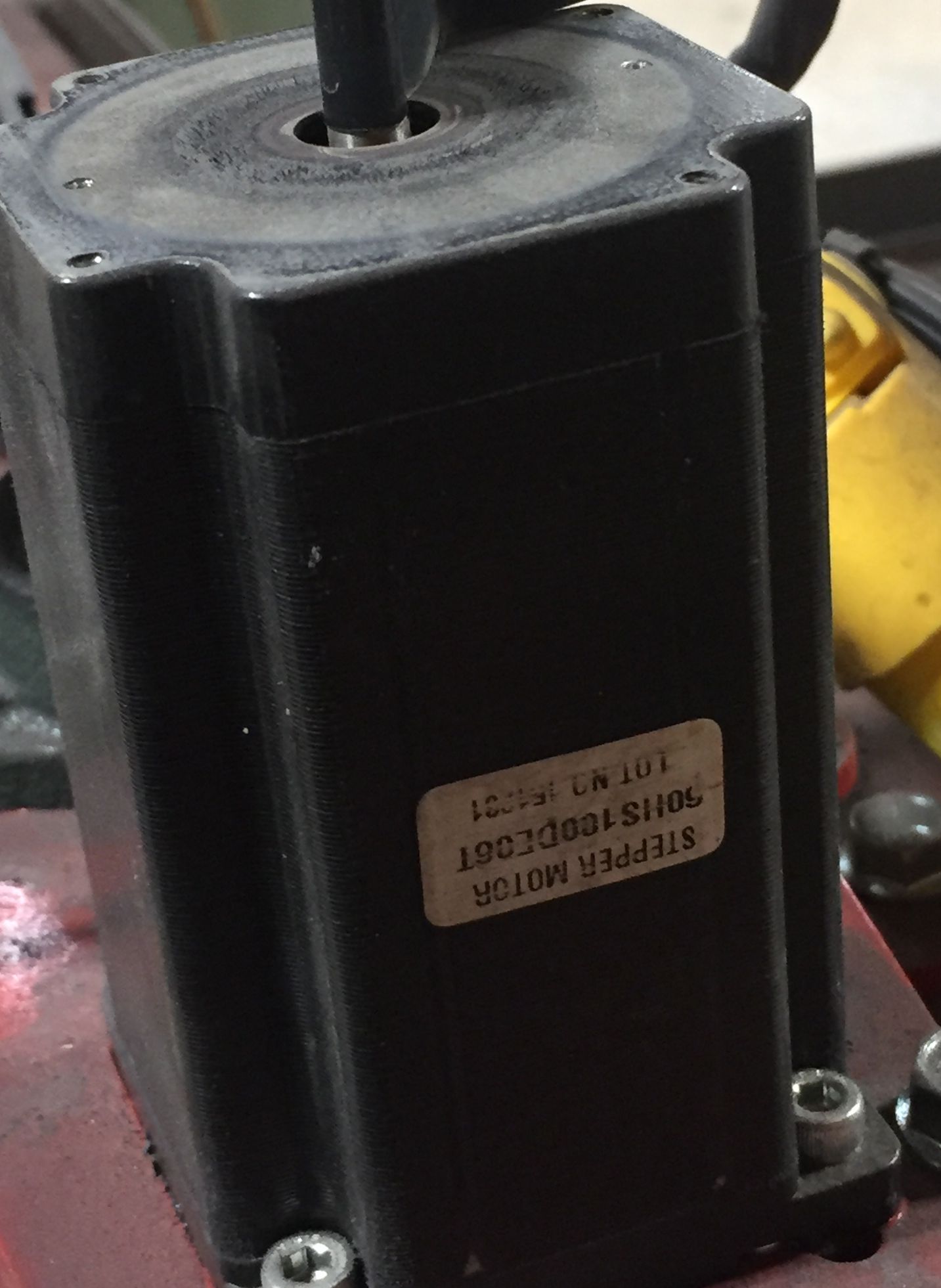

    620 OZ/Inch Steppers

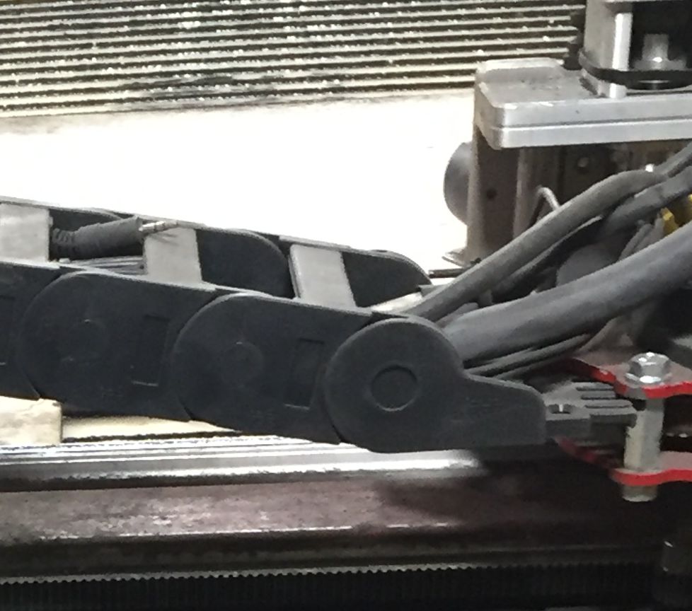

    Igus Cable Carriers

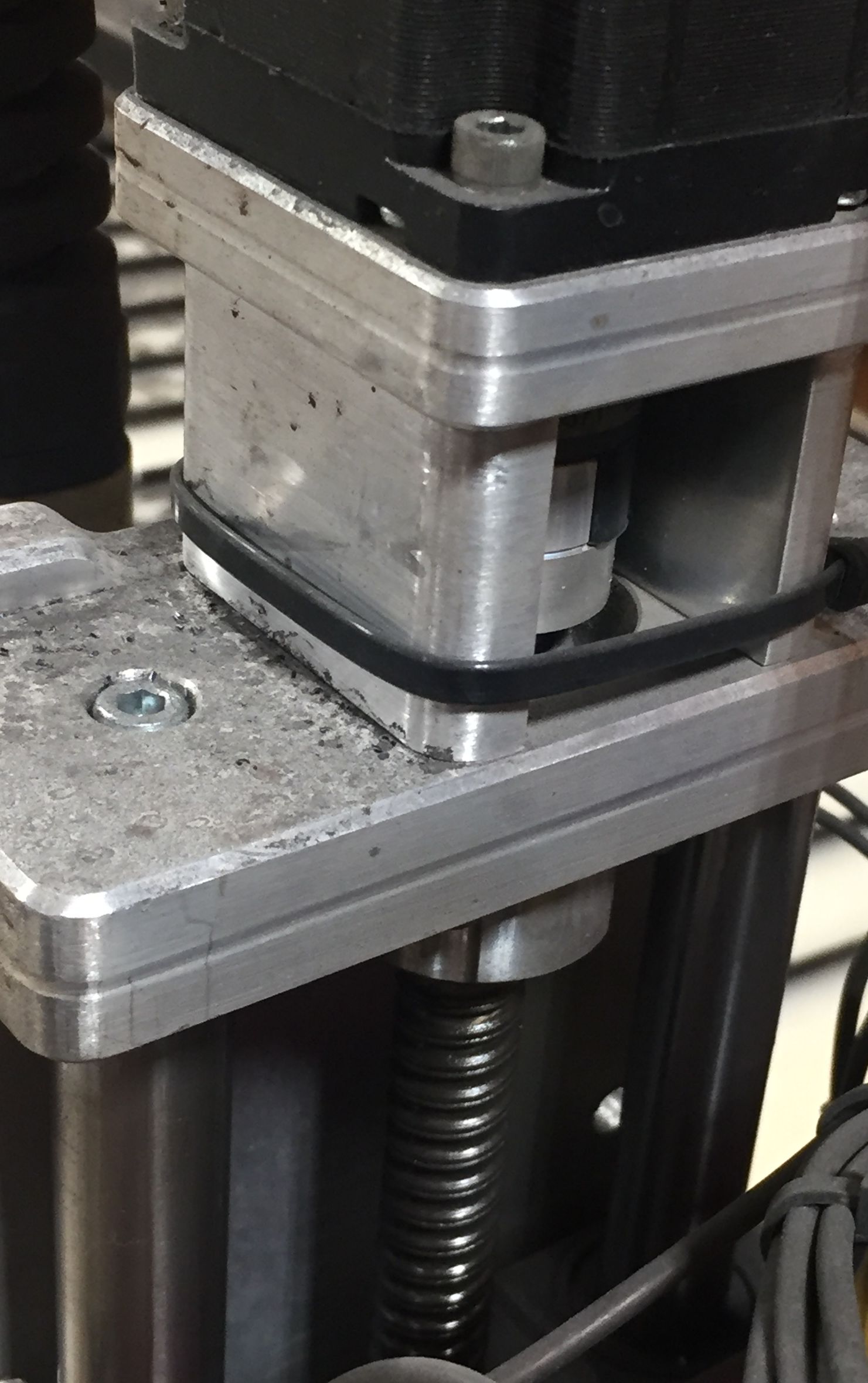

    5 TPI Leadscrew on Z-Axis

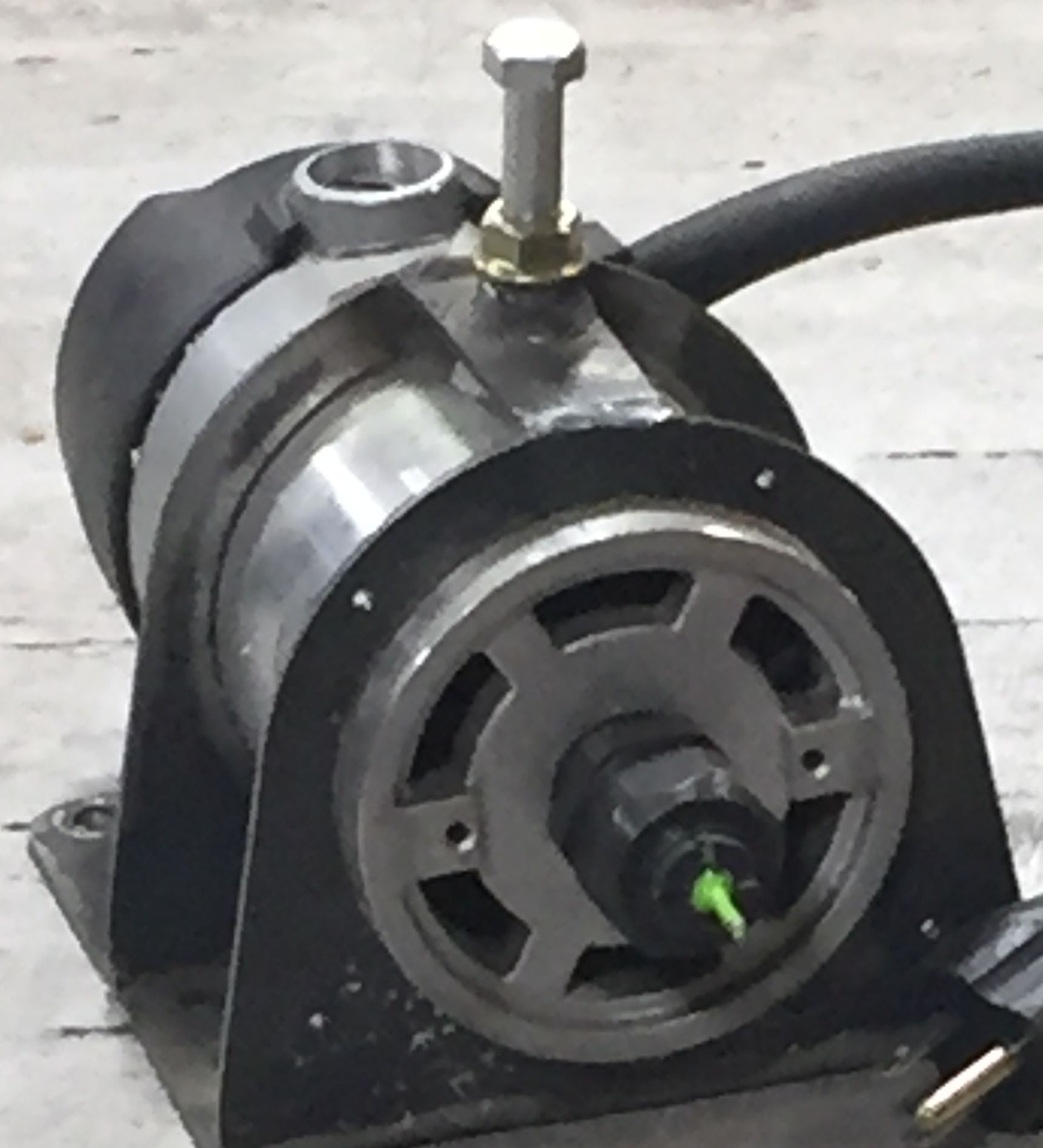

    Router Mount

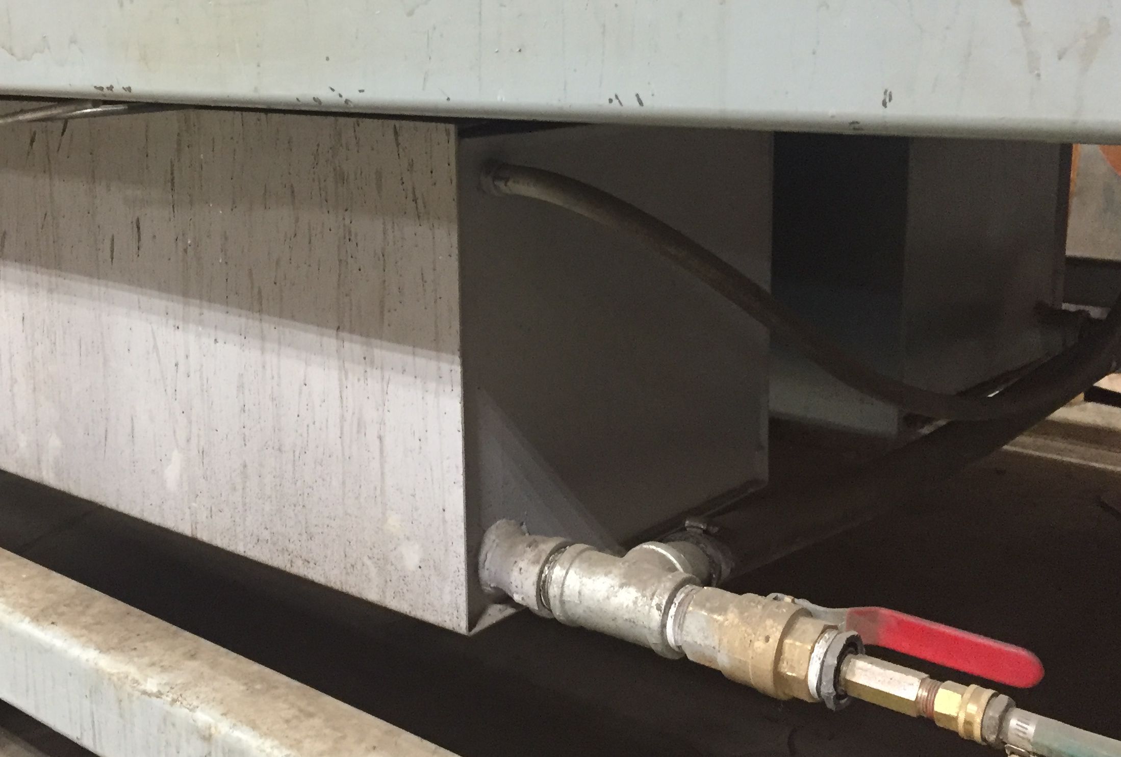

    200 Gallons of Water storage
  5. The Following 4 Users Say Thank You to PWelder For This Useful Post:
    Jon (Feb 16, 2017), Paul Jones (Feb 23, 2017), PJs (Feb 14, 2017), Woodgeezr (Feb 21, 2017)
    26,599
    8,154
    Thanked 40,542 Times in 11,844 Posts
    Very nice. Is it complete?
  7. #6
    PWelder's Avatar
    Dec 2015
    19
    Thanked 21 Times in 4 Posts
    PWelder's Tools
    Yes it is complete
