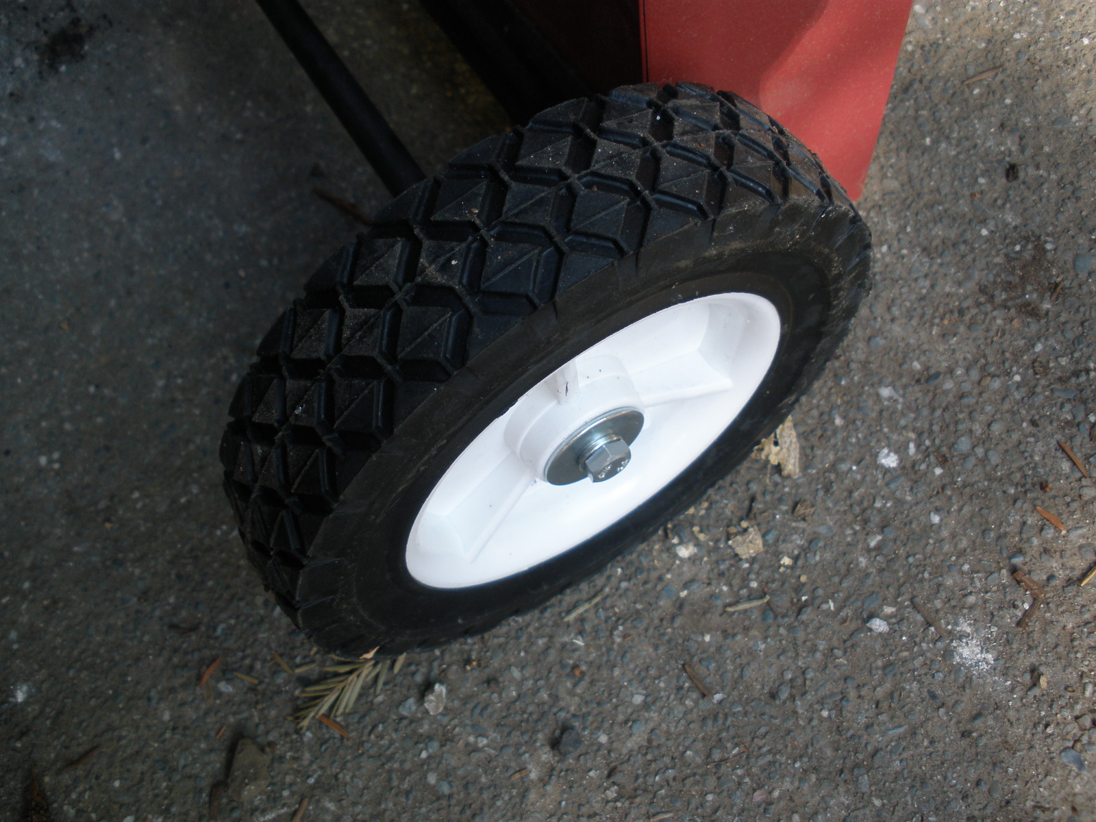

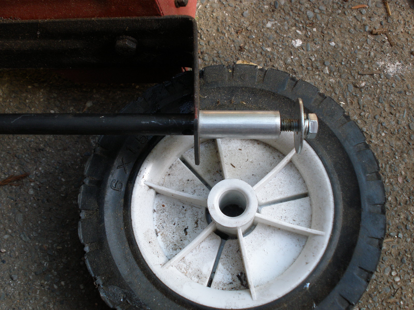

    I did these mods some time ago but just realized I should share them here. The saw is a Harbor Freight "4x6" bandsaw.
    One of the first things was new wheels to make it more stable. The bushings are made on a lathe.

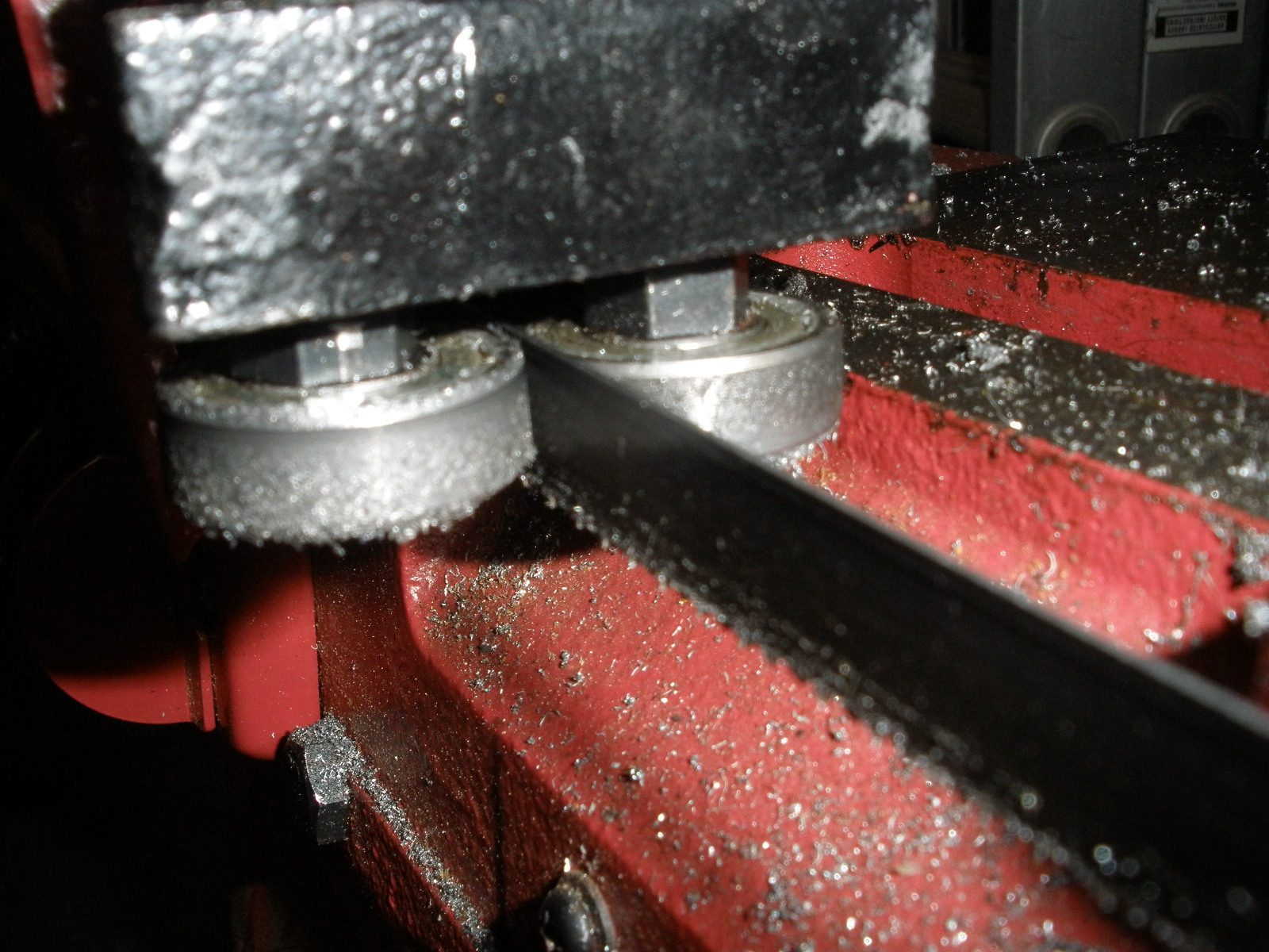

    The next was to move the outer guide bearings up a bit to reduce jamming from swarf and to help make the blade vertical. I get REALLY nice cuts out of this saw. I simply chucked the guides in the lathe and made the hex part thinner.

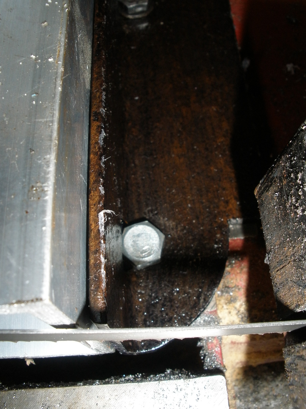

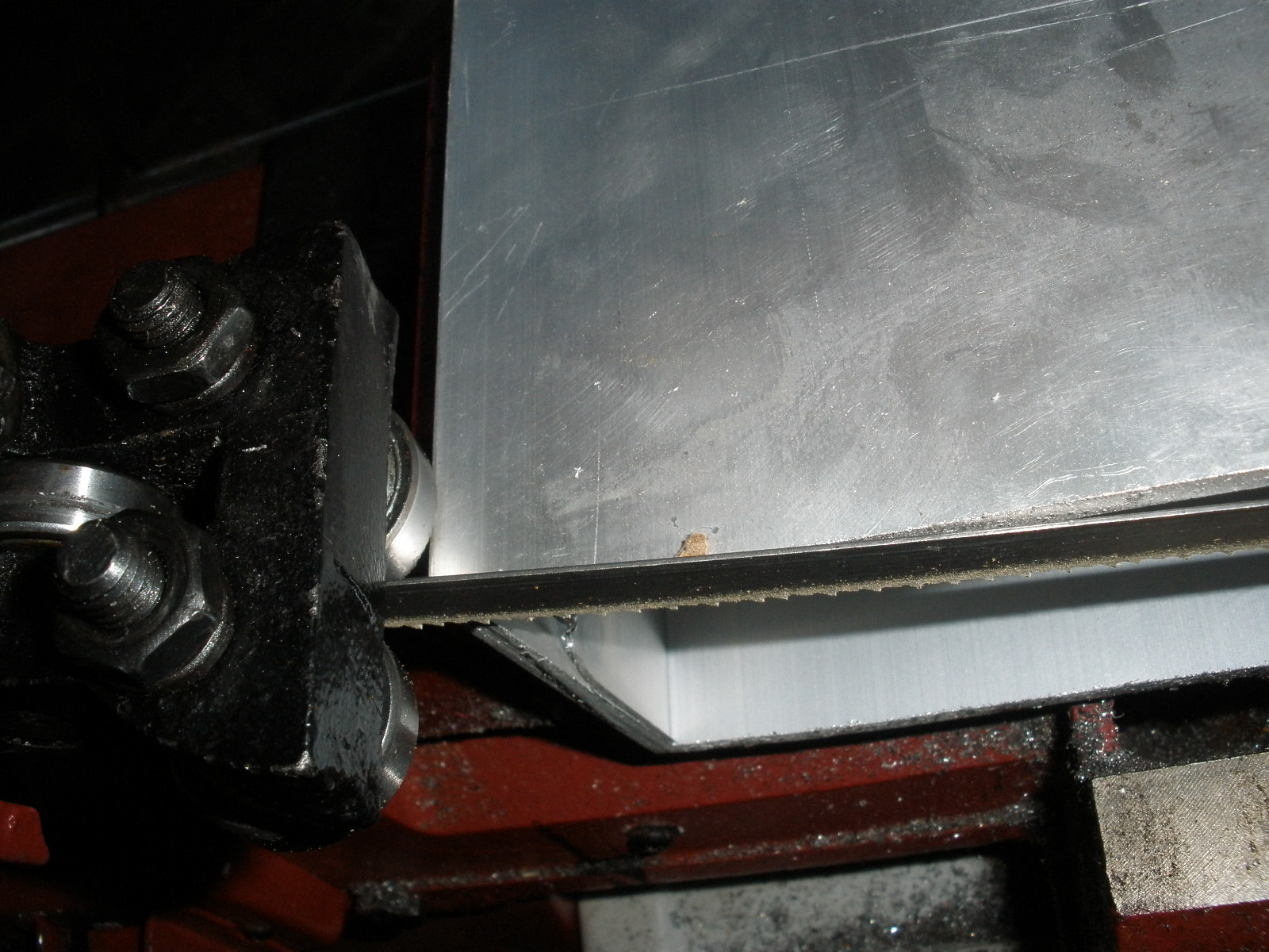

    Then I got what was to be the first of a number of orders for custom lighting dimmers for a circus group in Canada. One part of the design needed sections of 3 inch x 6 inch aluminum tube (used to make hanging brackets). Well, I have a 4x6 saw, what could go wrong?

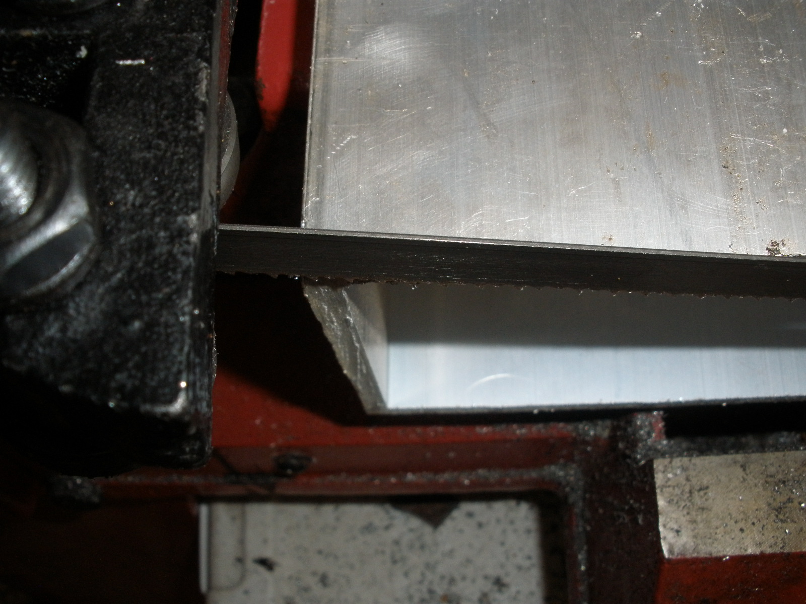

    Some settling must have occurred during shipping a the guide bearings hit the tube. Insert bad words here.
    The bearing guide was all the way back and the tube was all the way against the right hand stop.

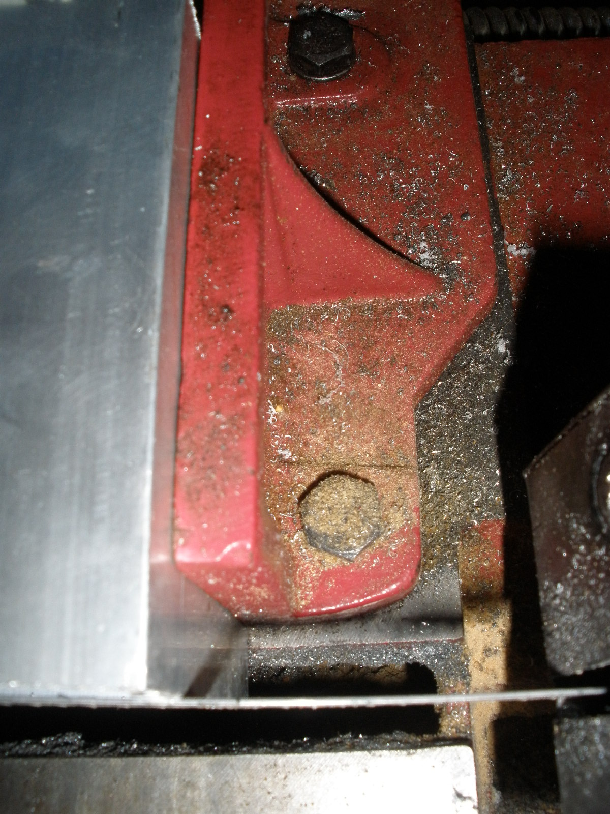

    So, grab some scrap... err ... not currently used steel angle with a nice rust... err ... aged finish and make a new right hand stop. While at it, bring it right up to the blade for cutting smaller items.
    Presto, I can now cut things larger than 6 inches!

    There's several things that can keep it from cutting straight. Clamp a large machinists square in the vise making sure it's flat on the bed and just barely touching the blade. Raise and lower the blade and see if it tracks along the square. If not, use your favorite swear words and check the pivot for the cutting head. Usually there's no adjustment, which means you either have to make an off-center bushing or easier, put a wedge under the work to make it cut straight.
    Assuming it tracks ok, then check the blade for tilt, you may have to tweak the guide bearings a little or a lot. See my bearing mod that might help.
    Make sure your tension is good, you should get a nice boing sound from plucking the blade.

    The best tip to keep the cuts straight is to get a name brand, bi-metal blade. The teeth on a cheap blade can wear more on the side that contacts the wheels and that, uneven wear will cause the saw to cut crooked. I have the same bi-metal blade on mine (a Grizzly) for the past 10 years and it is still going just fine.
    You pay about two or three times the cost of a cheap, import blade, but they last between five to twenty times longer so you spend less in the long run. I found that not only did the cheap blades not cut straight, but they also tended to break from fatigue after some months of use. That's months, not years!
