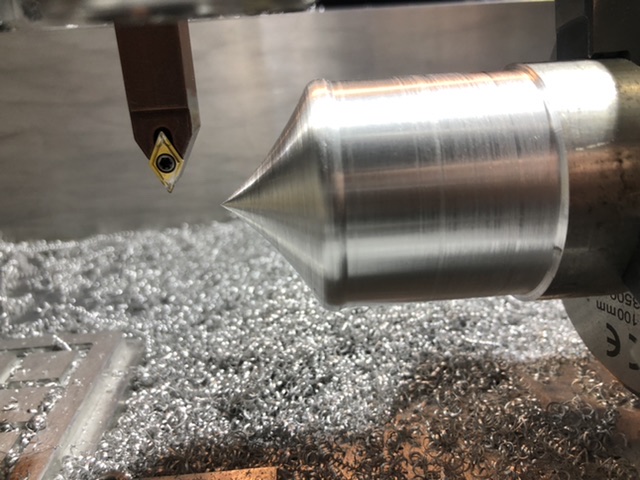

    I bought a pre-cooked version of this off of fleabay a few years ago. I put an Arduino and a little LCD display on there for setting angles. Yours is more robust.

    Quote Originally Posted by wizard69 View Post
    Will this be stepper or servo driven? I ask because I'm wondering what the top speed will be and if it will be suitable for use as a lathe. Think wood working and other relatively higher speeds.
    I have one that's stepper driven. Top speed is super slow, just a few RPM. A few years ago I tried to use it as a lathe. You can badly approximate a lathe if you have it installed on a mill. Crank the speed of your end mill and slowly rotate the workpiece. It works... kinda. It takes a long time and the result is lumpy. The problem is that end mills are not actually flat on the bottom. It doesn't replace a lathe.

    Hello,
    At the moment it is stepper operated because I had one lying around. The top speed is not that bad at all I think that I almost come to 2000 rpm turned aluminum for the first time yesterday and the power at higher speeds is also sufficient. Sure a servo would be better, but a stepper motor is also possible. You just can't feed several mm but 0.5mm with aluminum at about 1000rpm worked well. if you are interested you can see a short video on my instagram account (_markgyver_) or you can wait if i post the next video on youtube in about 2 weeks.

    Quote Originally Posted by nova_robotics View Post
    Hello,
    This is not true it works well as a lathe. Then you have the wrong stepper motor or wrong settings.
