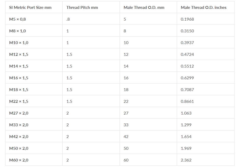

    Today's task is repair the horrible fright parts washer. The outlet pump tube just flops. I found they did a weld from a hose barb to the sheet metal box the pump is in, which was horrible in quality, and broke, This then stressed the pump, and it broke its plastic mount. So I fabbed an aluminum mount. And I was going to use a lock nut on the threaded end of the hose barb where an elbow is fitted that then connects the flexible tube that delivers the solvent. Pipe thread, right? Thread pitch is 1.25mm, and straight (not tapered) threads 12.8mm diameter. WTF is this? 1/4 male pipe fitting will start on it, but wrong thread pitch. So now I need to fab this as single point on the lathe. I don't want to weld it again, but that may be easier. I don't stock any metric pipe taps or dies in my tools.....yet.
    So 12.8mm 1.25mm pitch, what is even close in this chart?;
    So it's some sort of Frankenstein bastard thread. And the chart is incomplete as the taper angle is not specified.
    It's looking like a weld will be done.
    Or I should just break down and buy a better parts washer. After this truck, then I have a 1924 model TT 1ton with a Ruckstell rear axle.
Name:	Metric pipe threads.jpg
    From your description of the thread this sounds more like an SAE-5 fitting size. is there a 45° beveled land at the face of the hole? If so then the fitting would also require an O ring for the seal. Do you have a 1/2" fine thread bolt laying around? If so see if it will screw into the hole
    1.25 mm pitch equals 20.32 TPI pretty easy to confuse a metric thread with UNF at that size.

    It is China made junk from 30 years ago when their quality was half of what it is now. I'm sure this is all bastard thread, at least to the world, but maybe an old standard that China had.
    There is an elbow that threads onto the hose barb fitting. No there is no bevel for an Oring.
    The elbow did tighten up as if the fitting were tapered.
    They used hose clamps that were for much larger hose diameter, so they just clipped the excess band length off. The problem is it was made from too thick of material for the 5/8" ID hose, and it would not tighten down to that small of a diameter, so one of the clamps was stripped. Clearly someone made decisions to produce them this way.
    A short piece of hose connected the pump outlet to the hose barb fitting. The weld failure of the hose barb to the case of the pump, then caused the pump mount fitting and its failure. I did re-weld it in place, this time instead of a tack, I got 180 degree around the fitting. Other then touching the filler rod to the electrode a few times , the weld looks pretty good. I like TIG as you can go back over your weld and make it look better, but my welds don't look as good as they used too. I had forgotten that I have special prescription lens for just welding, once I put them on, everything was in focus. I like welding about 18" from my eyes, so I had the optician set me up for that distance of focal length. My tri-focals are set up for distance, computer (out stretched arm length) and reading (too close for welding). I just have to remember to put them on.
    So one of the goals was to get the pump to sit on the bottom of the tank. The pump is in a box, with an solvent filter. Many years ago, I fixed a problem where the hole the electric box came in on the side of the tank, had a large rectangular hole that let solvent evaporate. So I cut out a piece of aluminum larger then the hole and marked the mounting holes and electric feed through to the pump. This fixed the evaporation problem, but raised the pump about an inch off the bottom. I had to always put in more then 5 gallons of solvent to keep it pumping.
    HF is still selling this same parts cleaner, I'll have to see if they fixed this original design defect. Seems I'm always fixing those.

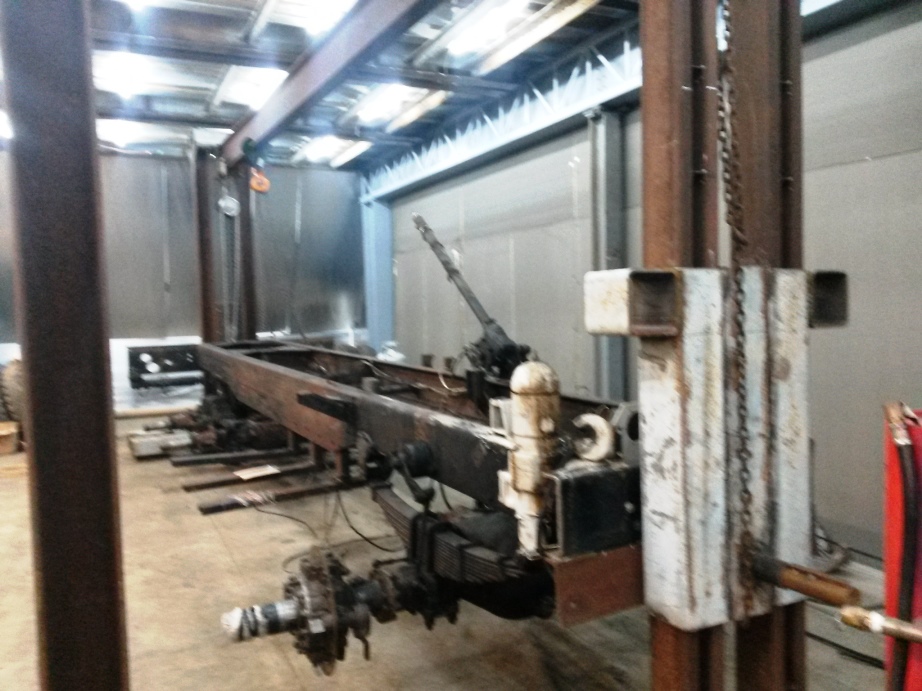

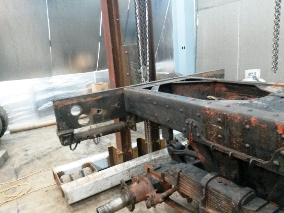

    the air tanks are for the air brake system Sterling had air brakes when many other manufactures were still running vacuum hydraulics But the truck in question could be a 37 not 27 he has maybe 20 of them in various states of disrepair some are so old they have wooden frames and some have a composite of wood and steel.
    these are the only pictures of it since the cab had been sent to Canada to be dipped.
    He built a rotisserie to work on the frame

    That is one heck of a project, and to build a rotisserie to work the machine. And to collect a family of their truck designs.
    And then you, building a custom sheet roller to make a very specific part. They had to have clever people to design air brakes and such. Making controllable flow valves and producing them took some ingenuity.
