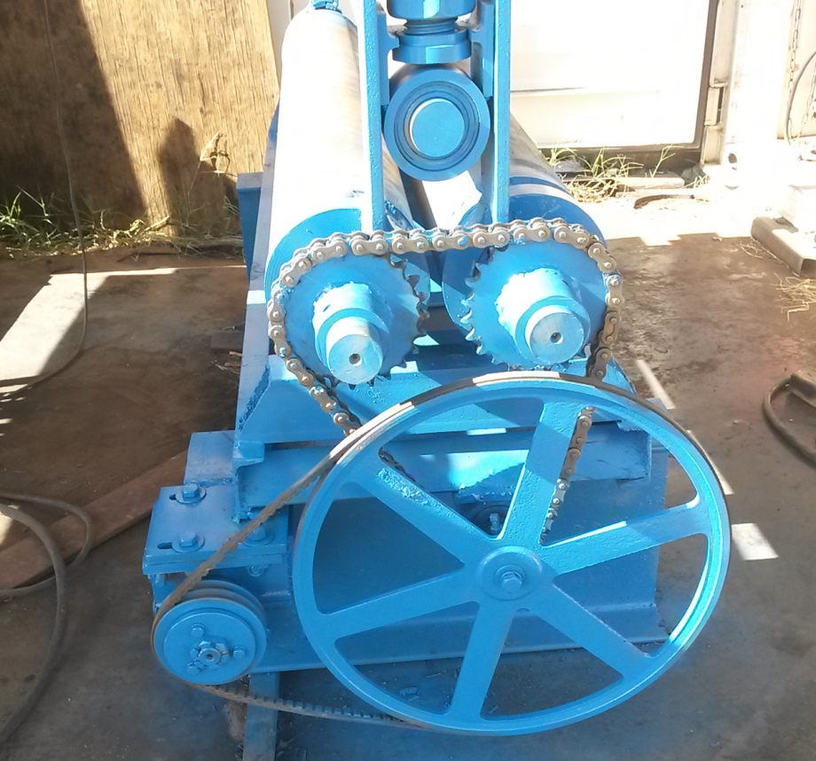

    For quite a while now I have been working on my 54" 10ga plate roll
    it has 6" pipe main rollers and 3 1/2" solid bar top roll
    Computer keeps crashing so more pics and explanation in next post.

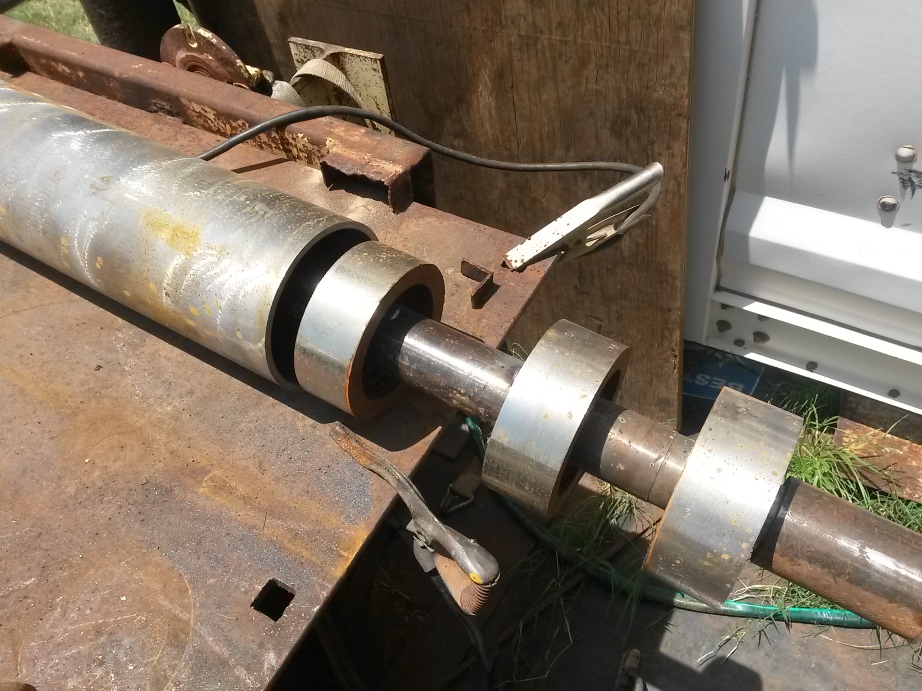

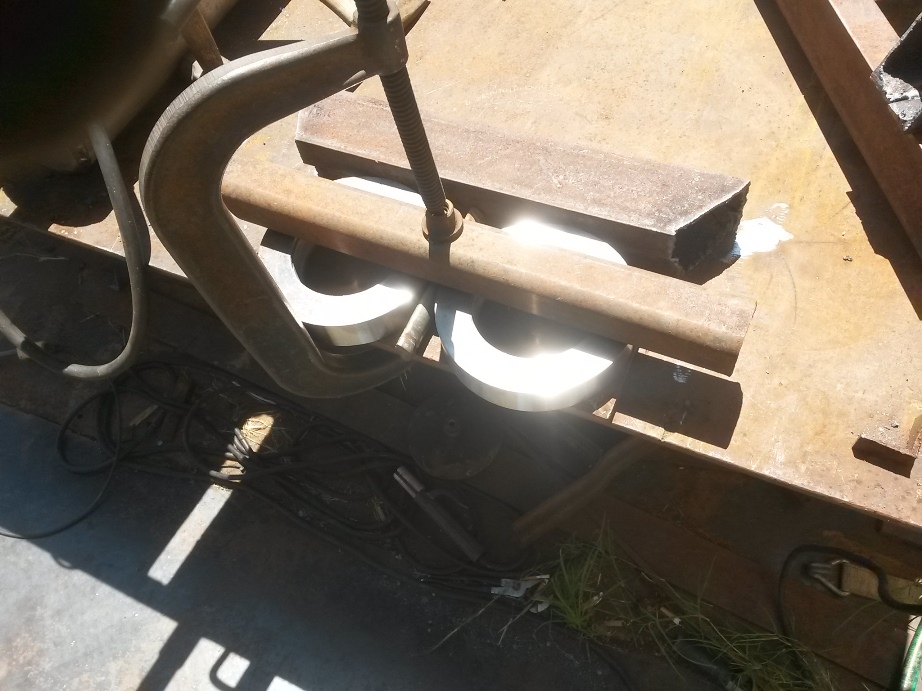

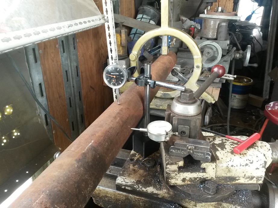

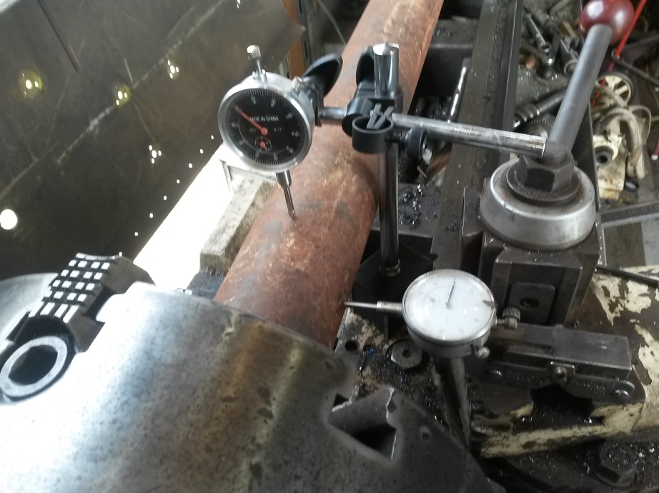

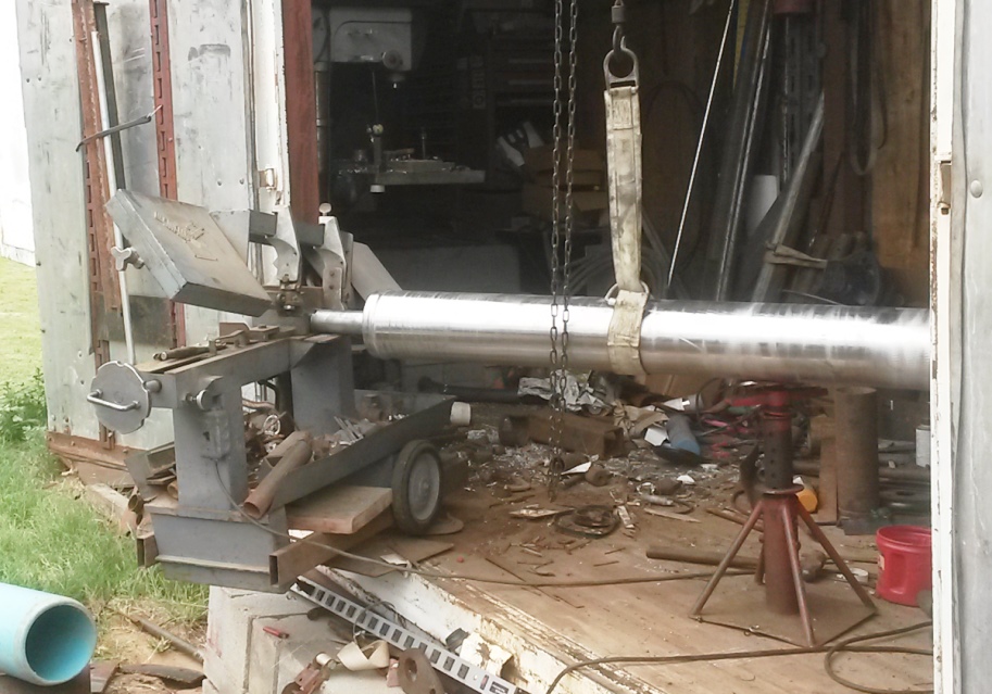

    Started off with 6" seamless Sch 40 pipe that had 1 end already on it just had to trim off 50 lbs of steel then turn the pipes

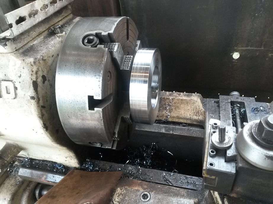

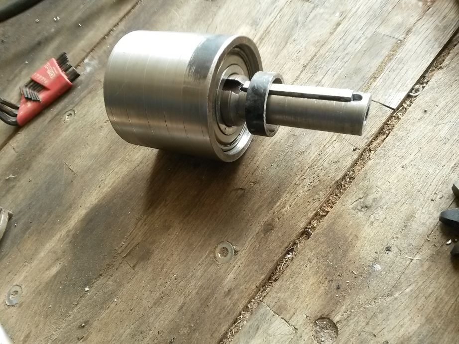

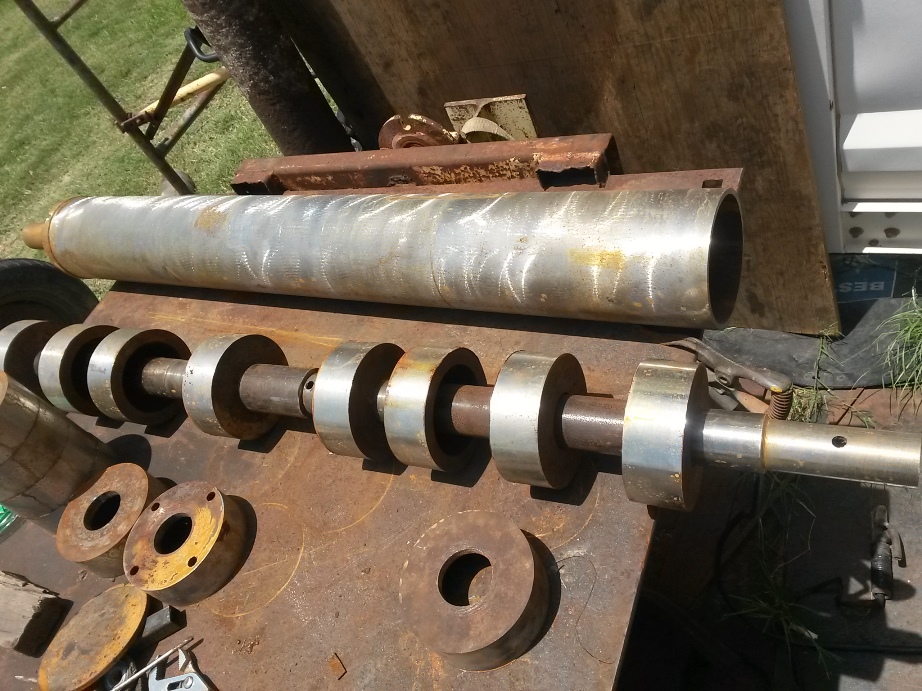

    Then machined 16 2 1/4" thick disks to go inside and a center shaft to stiffen the main rollers

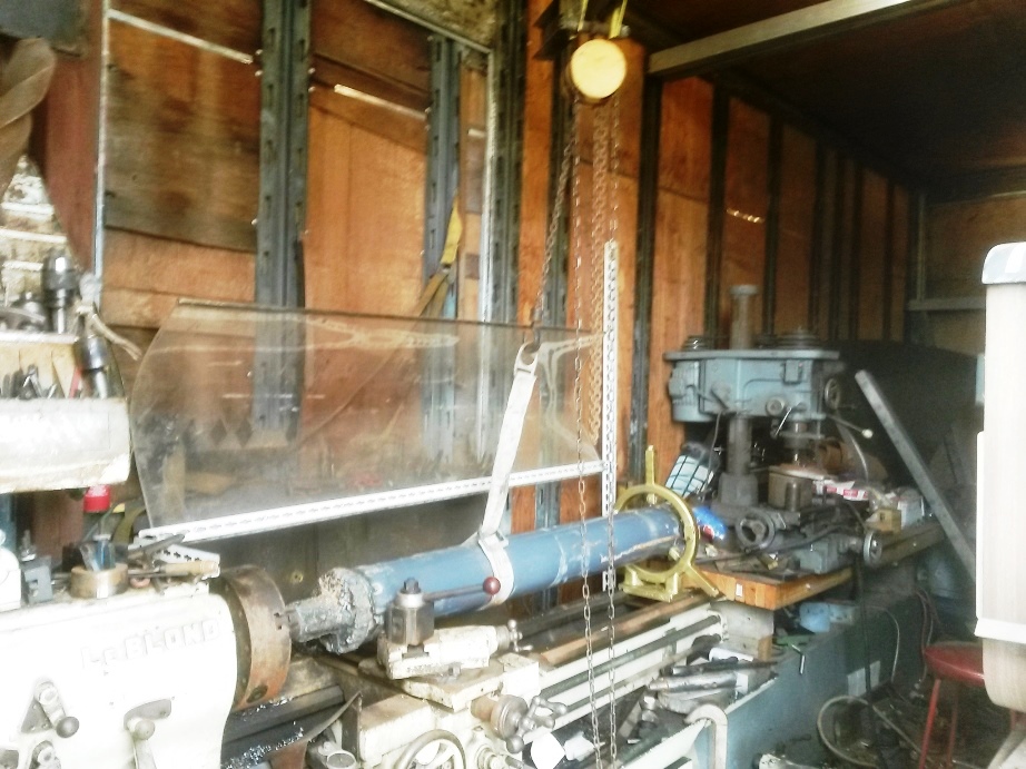

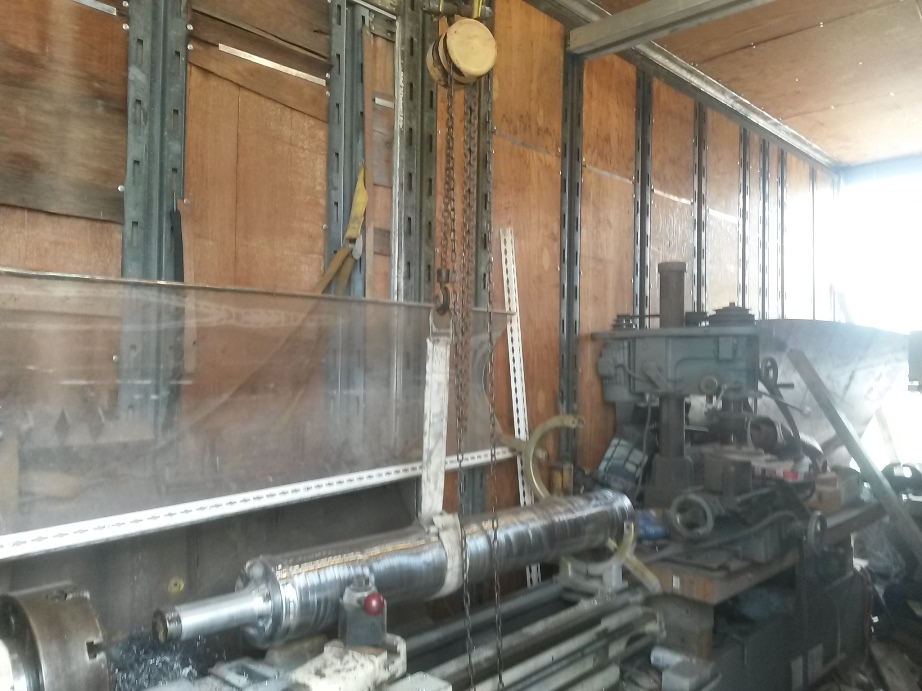

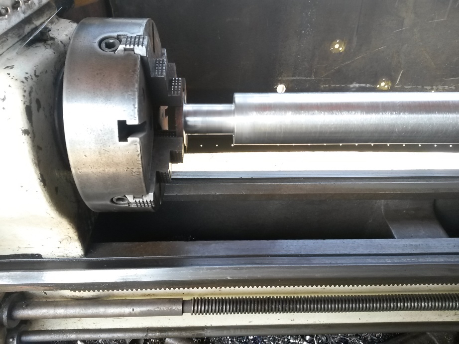

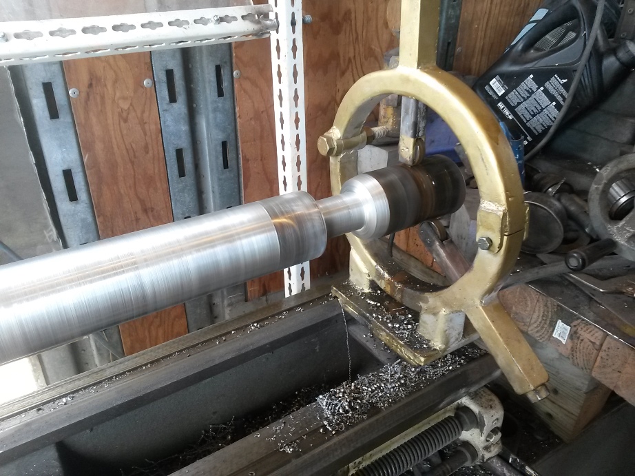

    Then I had to machine both bearing ends on the top roll blind since my lathe is barely long enough to hold the shaft.
    That and once I had it dialed to "0" "0" O didn't want toe move it

    I just cut the ends off in the band saw for the pipes and the top roll

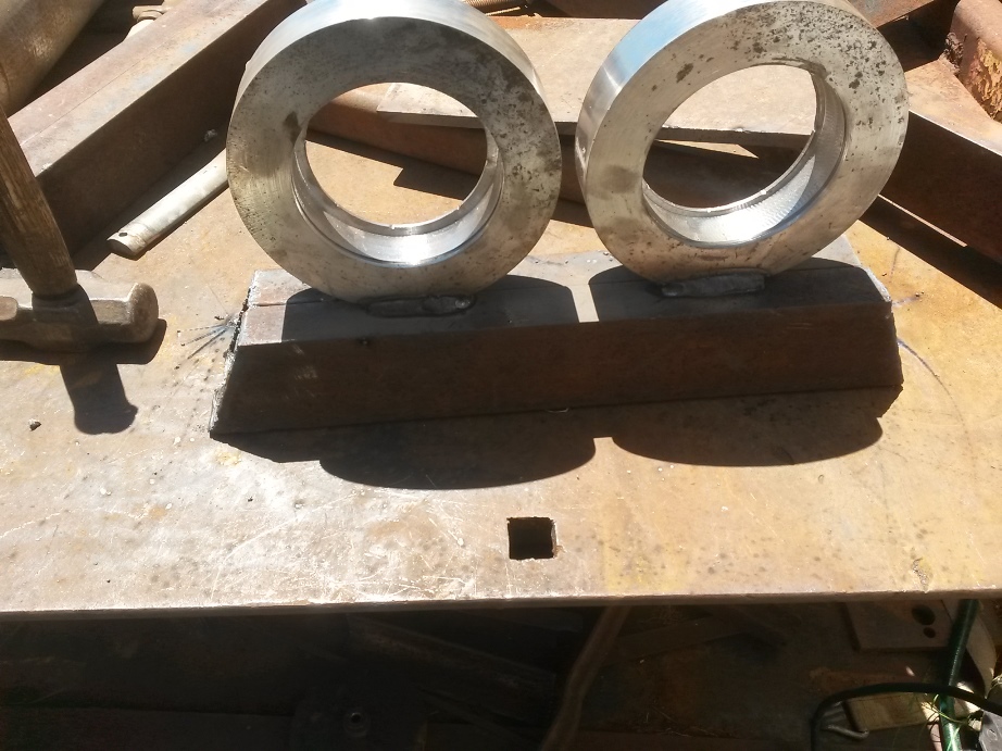

    Next I made my bearing housings

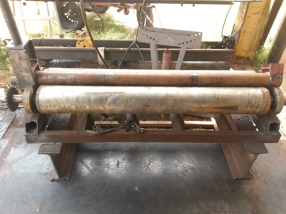

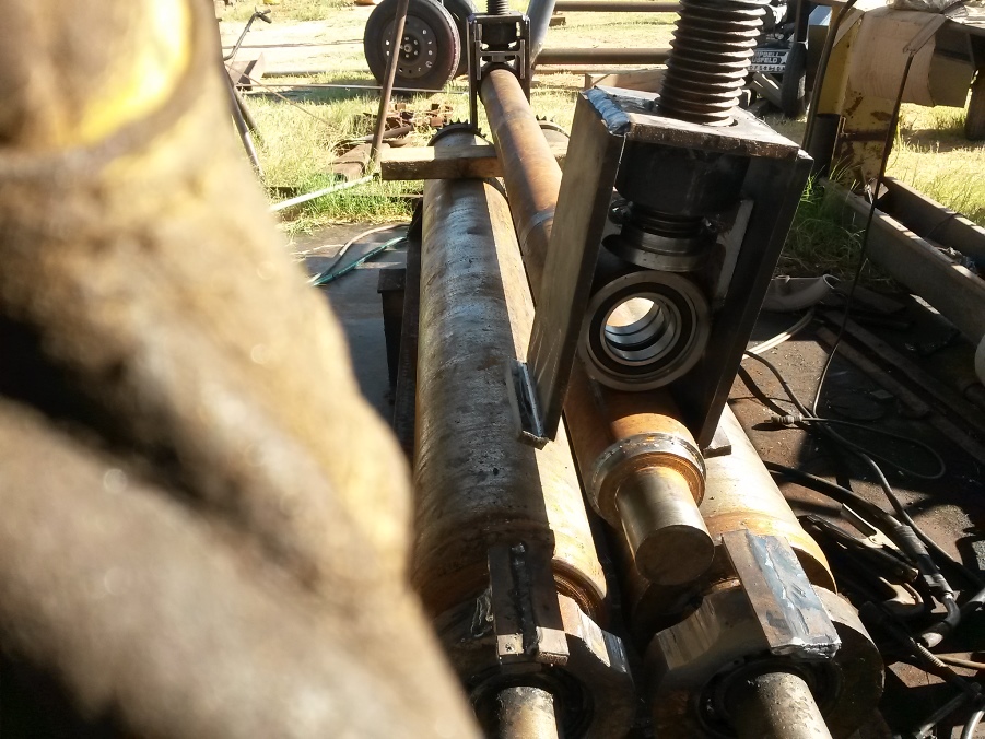

    next I started assembling
    the frame is an old trailer ramp with 12" I beam for the legs

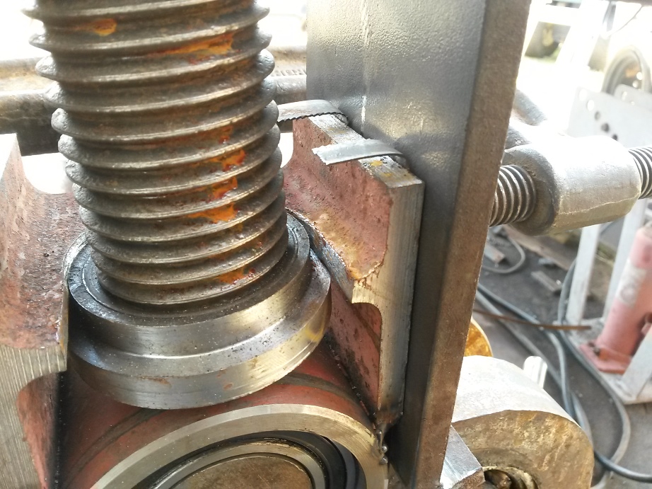

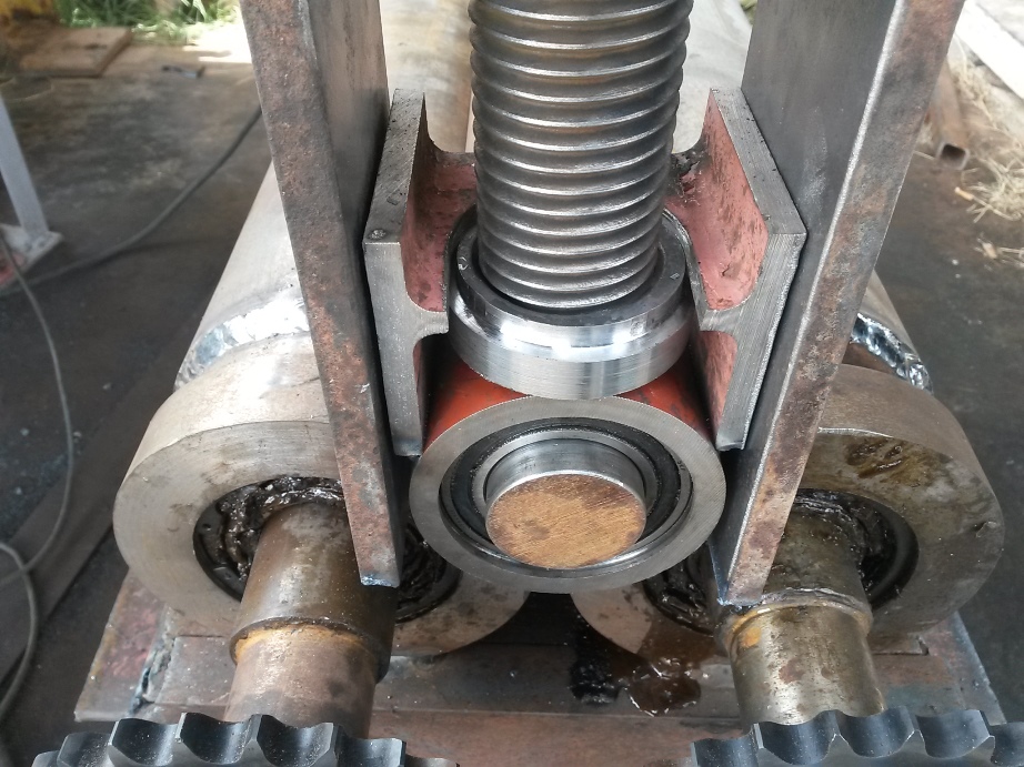

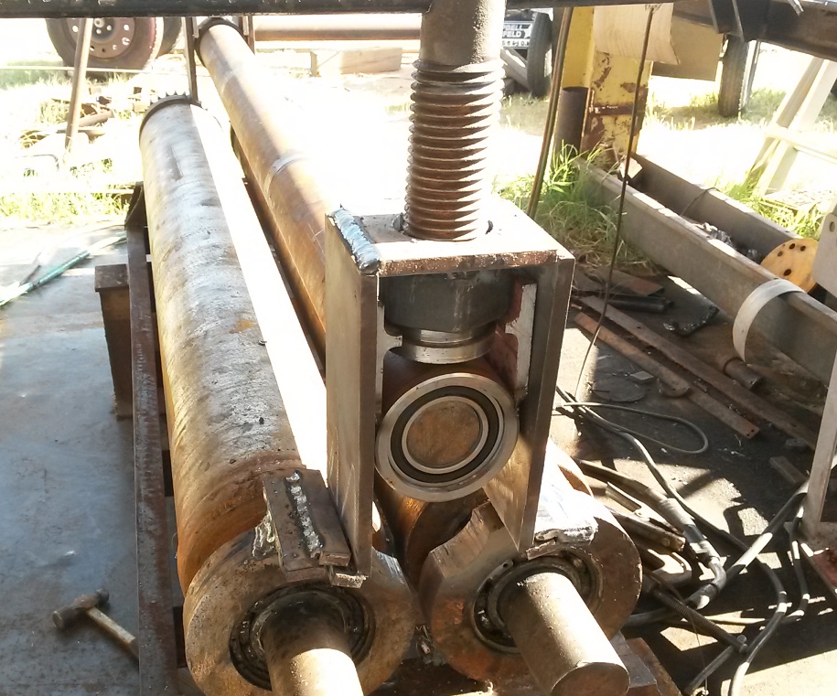

    Next is the top roll mounts
    I used a couple pieces of a brolen bandsaw blade to set a clearance for the bearing housings to slid up and down
    The down force screws are 2" B7 stud grade all thread. I turned 1 nut then split it to serve as the stop collar to raise and apply down force to the top roll The bearing housings are just some scrap cylinder stock I had
    One end is made so I can slip it off when rolling complete cylinders
    the slides are angled so as to cause the force to keep them held tight and not spread

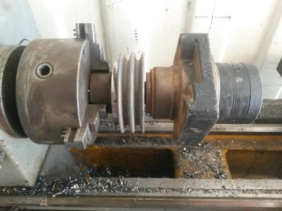

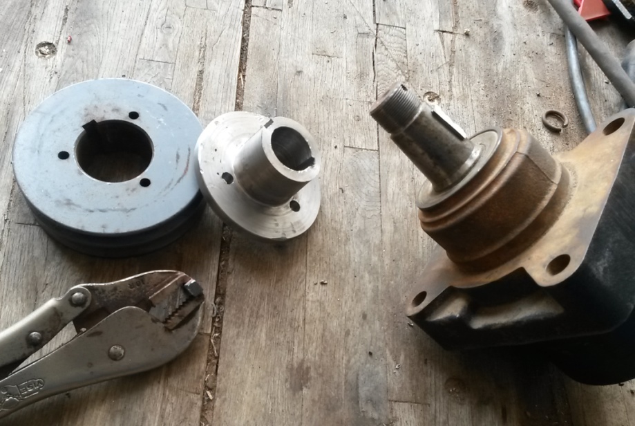

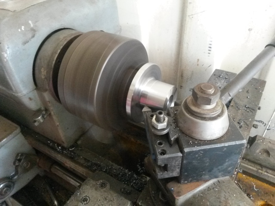

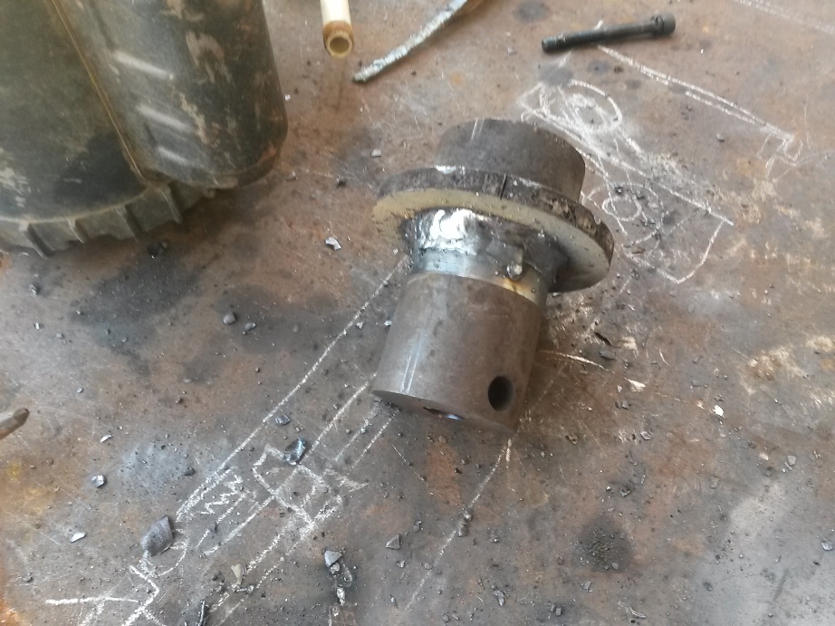

    Then I had to make a drive adapter for the hydraulic motor to mount the pulley on
    I started out by welding a round plate to a cylinder and tacked a sacrificial piece on the opposite side this way all machining could be done without removing the work piece

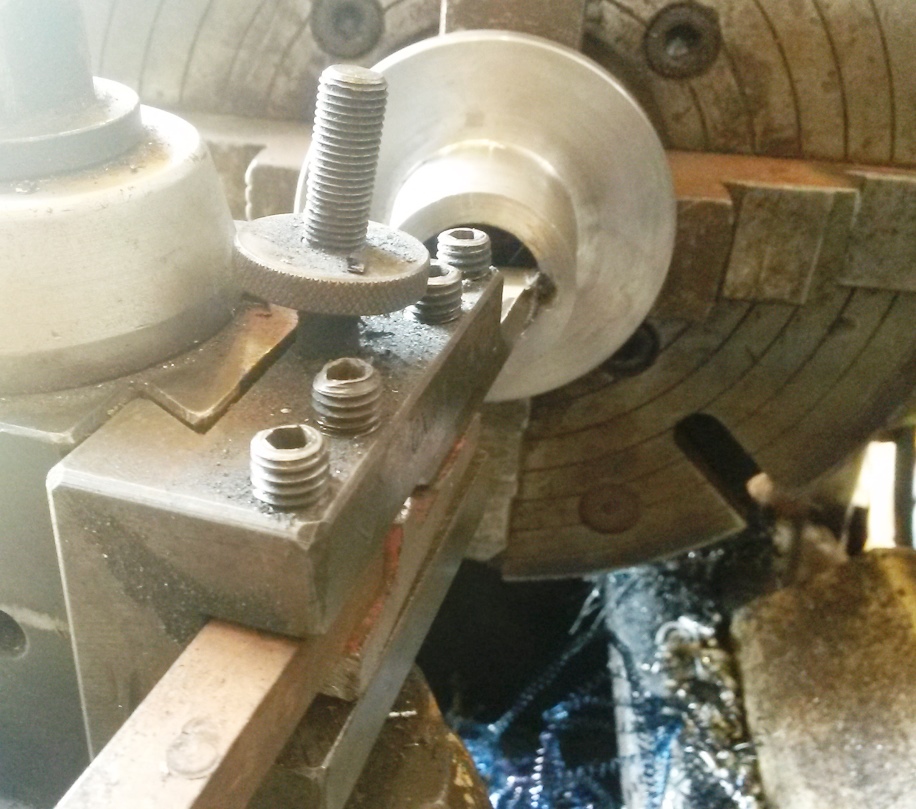

    The machining was done on my little Sheldon 12x36 lathe
    there is a taper to the inside and a taper on the outside 1 fits the pulley the other the motor shaft
    To make the keyways I milled the outer one then chucked the piece in my Leblond 17x54 I used the tool post and carriage as a shaper to broach the keyway

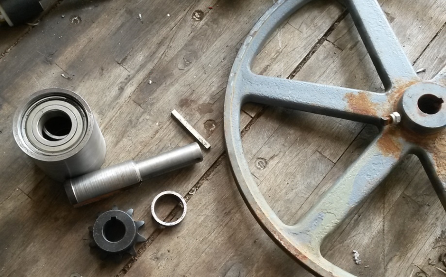

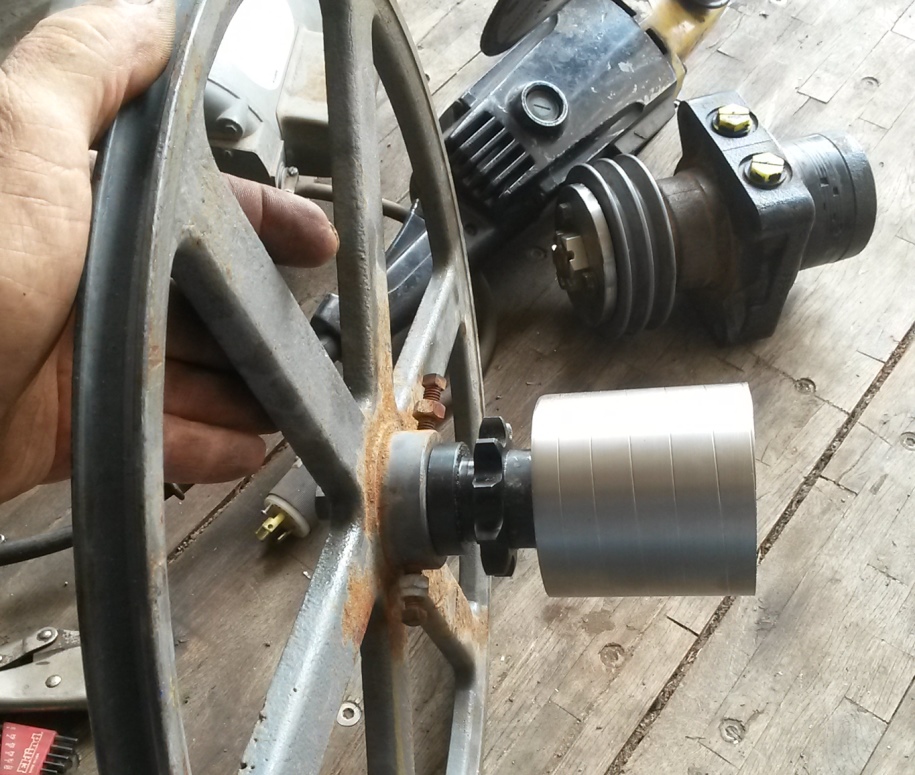

    Next I made a jackshaft and bearing housing for the pulley to sprocket transition
    It has a zero space stack up so no movement side to side is possible

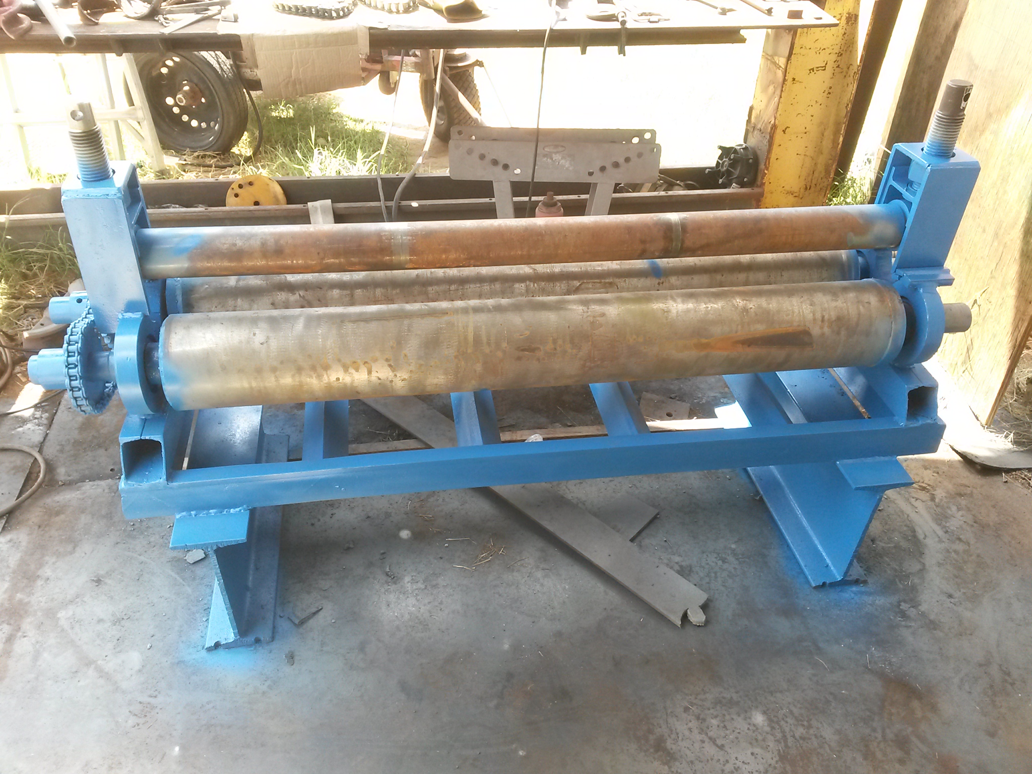

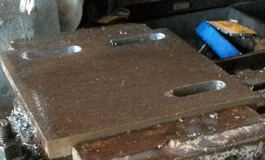

    Next I had to make an adjuster plate to mount the hydraulic motor on
    The roll is ready now b ut the power unit I had planned on using is AWOL either that or it is buried all the way to the front of one of two trailers so now I have to make a power unit or wait until Bob shows up and plug into his truck before I can use it
    Anyway a little about the specs of the roll
    54" max sheet width the main rolls are on 8" centers so this is going to limit the gage thickness of rolling a 4 ft sheet to around 10 ga possibly 3'16" if I want to roll back and forth many times.
    the 2" down force screws can develop 30 tons of force each but that would mean having to use a long cheater bar on them.
    the top roll is mill shaft out of an old cotton mill so I have no idea tis grade other than it was hard and free machining similar to stress proof or 4130.
