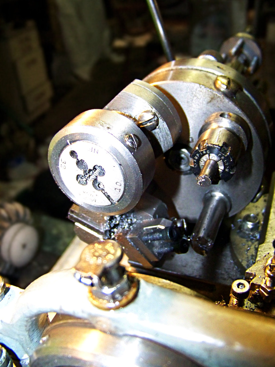

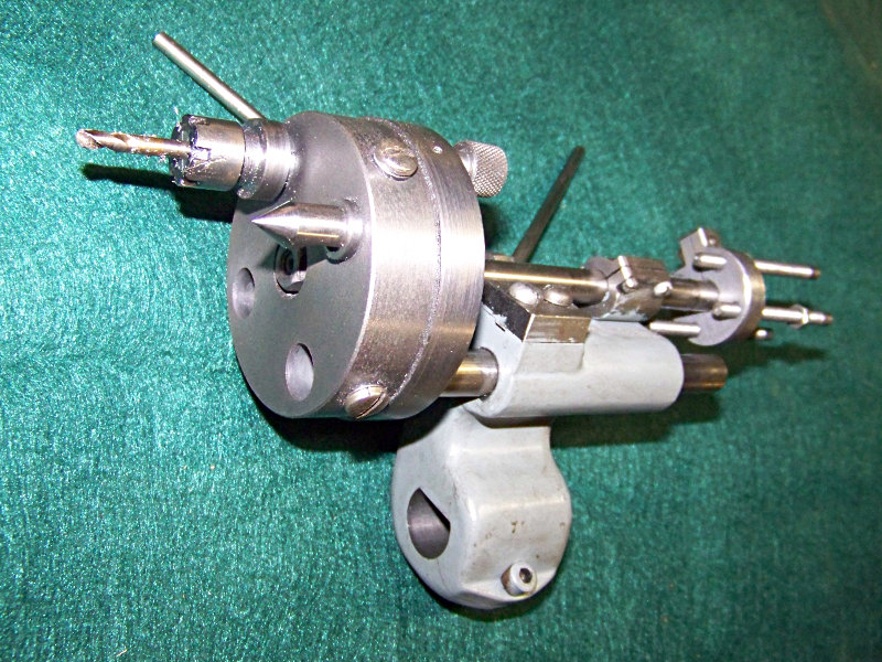

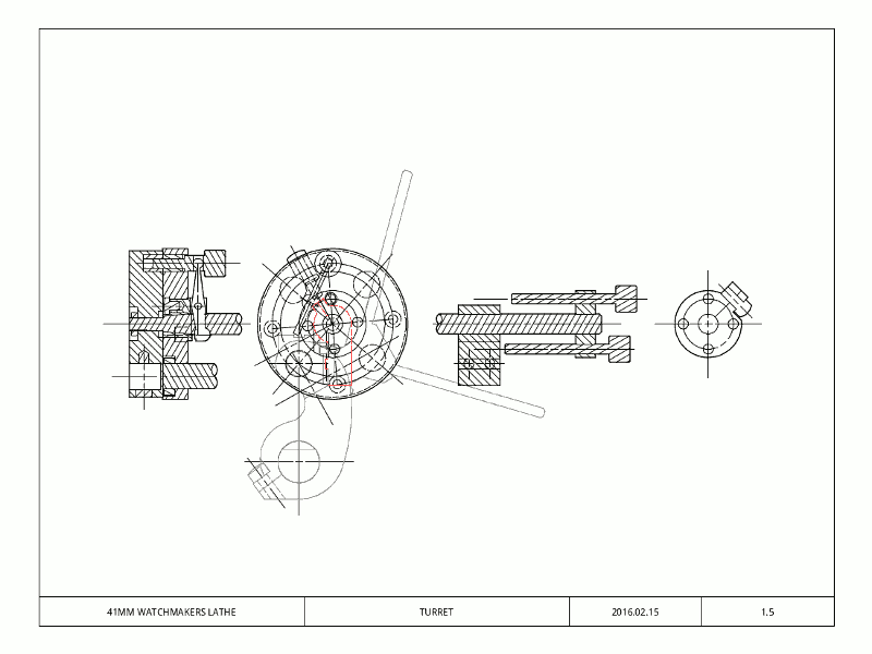

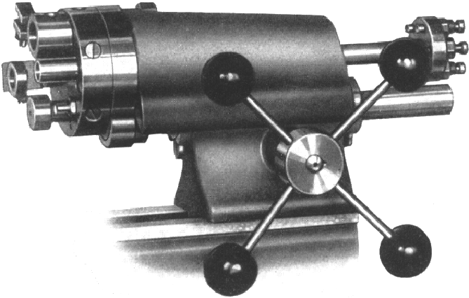

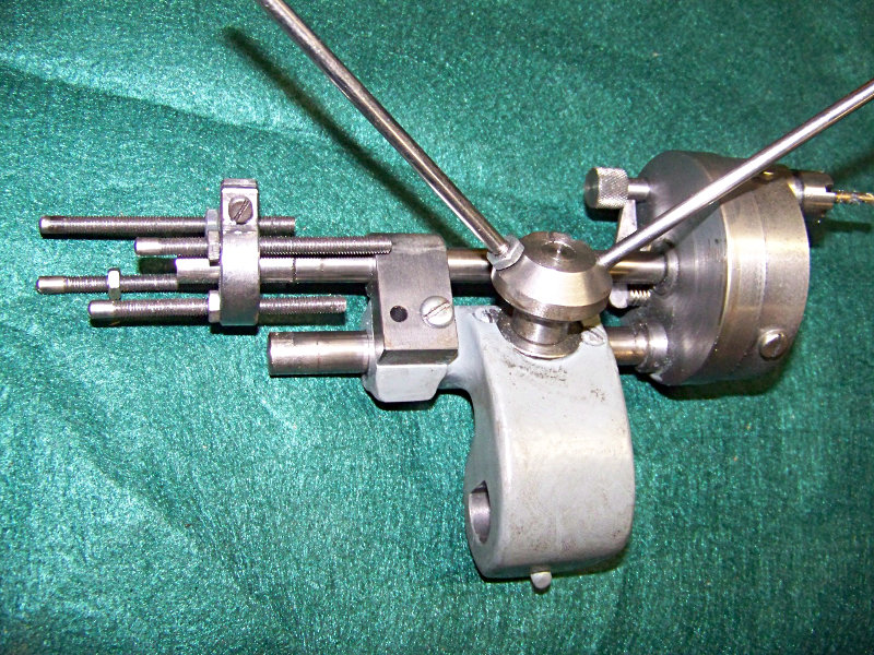

    This is an attachment for the bigger tailstock on my watchmaker lathe. I mostly copied a Schaublin accessory, but added features from a more complete Lorch turret tailstock.

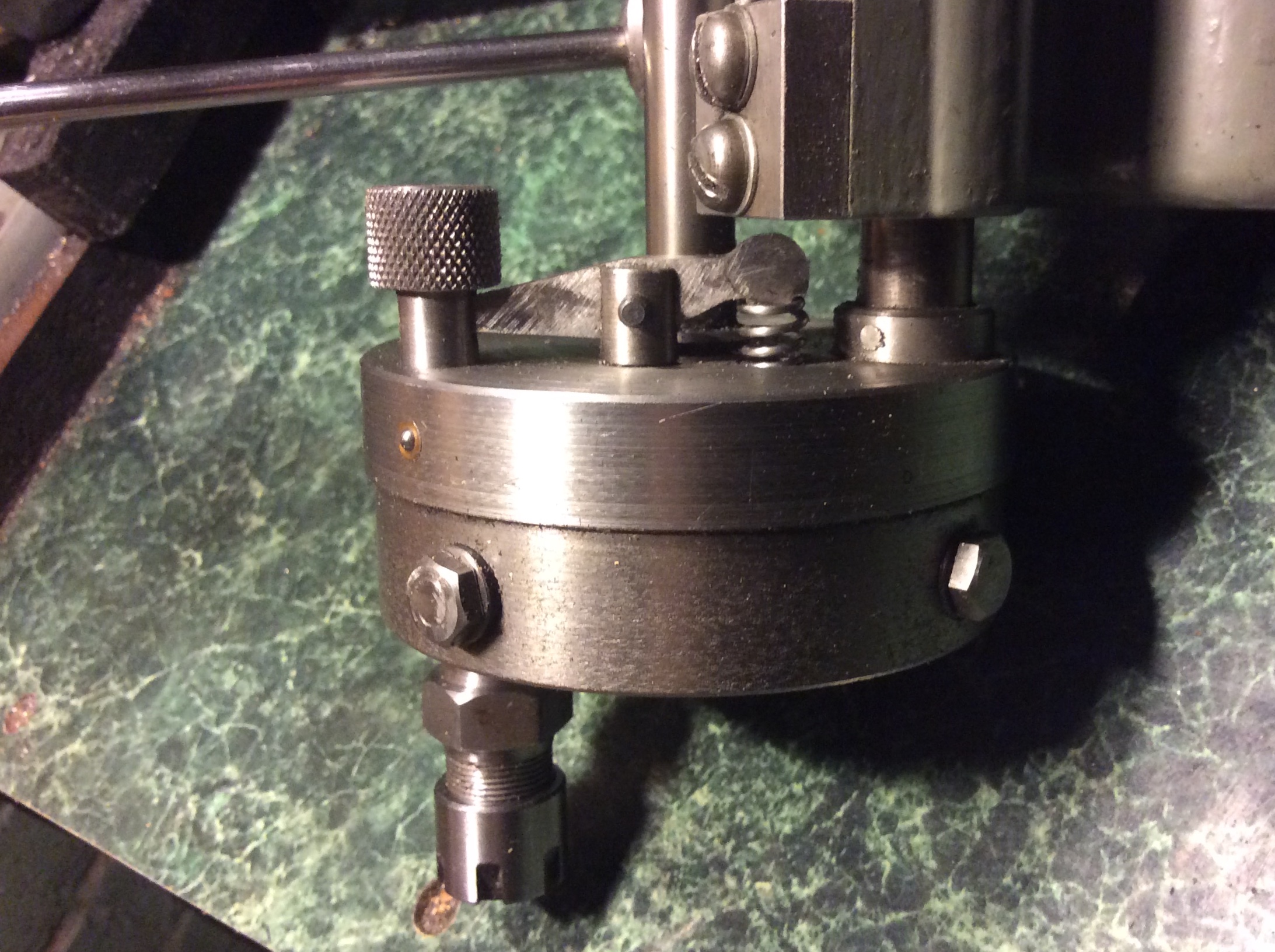

    It just advances by hand but the stop shaft rotates with the turret, and fully retracting the ram disengages the indexing pin which then resets with a spring when it advances.
    The sockets are 1/2”.

    Thanks, Doug - I’m still learning how to set it up and use it, but it works, and hopefully it’ll be durable. I made the stop shaft journal and bearing tapered so they can be adjusted, and a lot of the parts in it are hardened, including drill bushing inserts in the indexing holes.

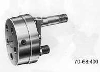

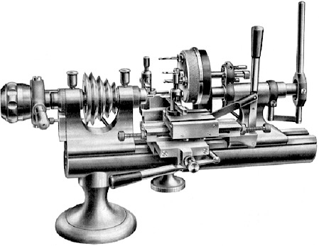

    A Boley I hadn’t seen before, with a more compact stop arrangement.
    From Watchmakers Lathes at lathes.co.uk
