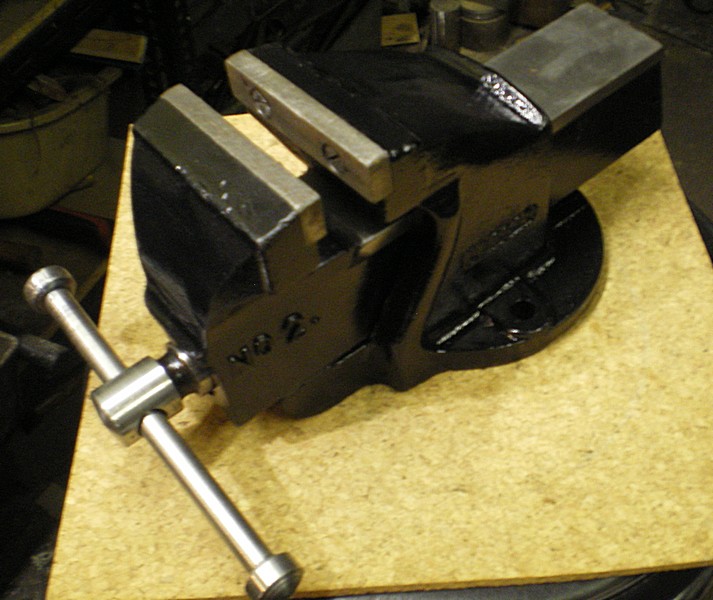

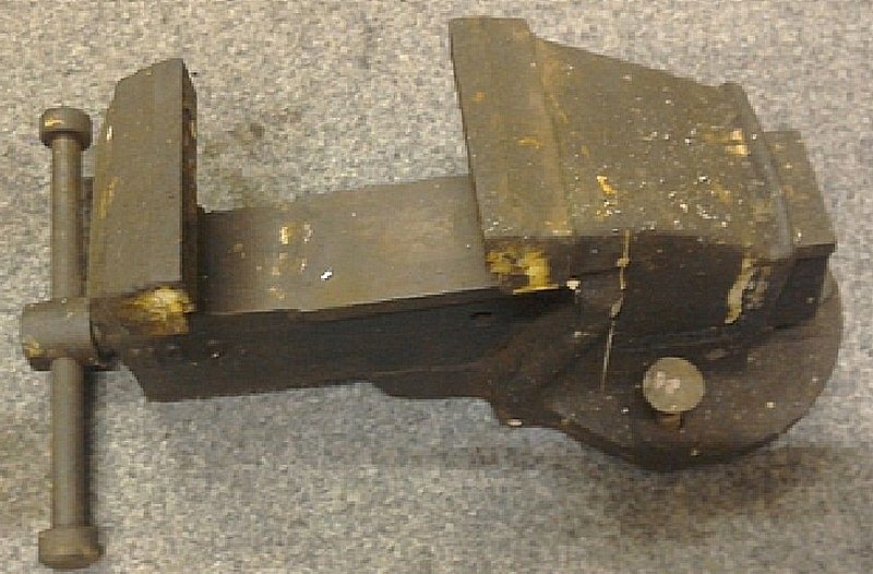

    The house next door was sold for refurbishment and after looking in the builders skip for anything useful I noticed a piece of steel poking out of the rubble, pulling it out I was amazed to find it to be an old bench vice that had been thrown out, I just had to rescue the poor thing as to many vices get miss treated these days. It had not been used much, just left in a leaking garage and very rusty so an electrolysis bath and a strip down was the first step. The strip down proved to be difficult as I could not shift the acme nut in the body as it was dovetailed, peened over and pinned into the fixed part of the vice, determined to separate the two halves I had to make a cut out in the rear of the sliding jaw to clear the nut, as this would normally limit the opening of the jaws I would have to provide some other means to replace this function, tapping the end of the screw for a stop washer sorted that out.
    After cleaning and two coats of paint I now had a good as new vice. It took about a week of spare time but I enjoy this kind of thing.
    I have found a rotating base handy in the past and I have a steel plate that I had planned to make a 3 point steady for my lathe no longer needed, so when I find it I will complete the job and it will replace my long suffering 3 inch one that will get the same refurb treatment.

    I too enjoy 'tuning' vises. Probably sold off/ traded 80% of them over the years, maybe 40 total. My favorite peeves; backlash where the jaw doesn't retract with rotation of the screw, and the screw + handle with too much clearance to hold it's setting while loading or re-positioning a part. I like a bench vise to work like a mill vise.
    Fixing those is usually easy; sometimes.
    First, insure the screw is straight.
    Sleeve the pilot to fit the slide bore, flanged with a washer of thickness equal to the backlash - minus a couple thousandths. I've had bronze and a thin steel shim washer, hard copper or just solid mild steel. Avoid materials that gall like stainless steel.
    Before assembling, find a sturdy coil spring with ID that fits screw OD, short enough to fit between stationary jaw and inside of slide with bushing in place.
    Lube with bearing grease and assemble. Moving jaw will now advance or retract with barest rotation of screw AND hold any position you leave it in
    Maybe a half dozen times, slide face not machined square [a spotface, more or less] enough to operate well with reduced clearance. You'll need a good sized 4 jaw, or mill & facing head, or rotary table & angle plate to correct it.
    Again another facet of Toolmaking; measure and engineer processes to remedy unsatisfactory mechanical action.

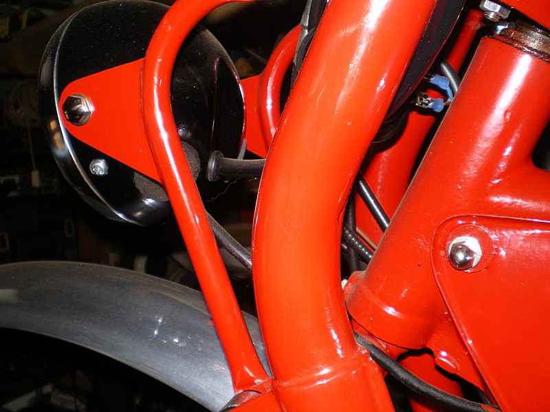

    After using every type of paint over the years I have settled on a synthetic enamel from Paragon Paints from https://www.stationaryengineparts.com/Paragon-Paints/. Never been a fan of spray cans, they are so wasteful so I brush paint most of my motorcycle parts with this stuff.
    It flows beautifully with no brush marks and dries nicely hard. RAL colours too.
