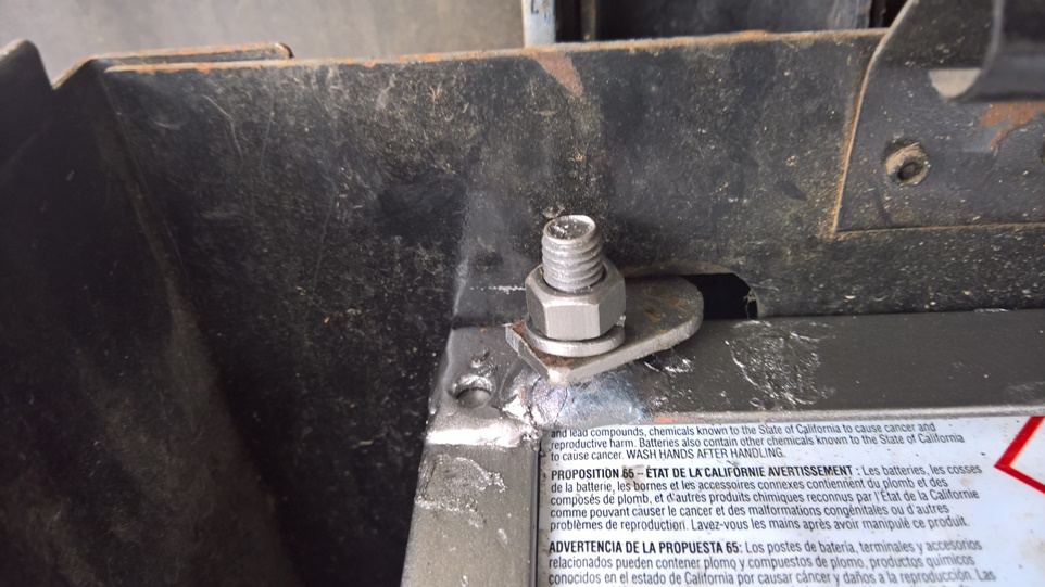

    A while back we mounted an auxiliary power unit on the truck to provide 120v AC/ keep the batteries charged and other things We have a roof top RV air-conditioner / heater, microwave TV, refrigerator laptop/ scanner-printer-fax machine plus other accessories so the generator runs quite often when the truck is parked and has to run to power the 120v equipment so to counter this a little we decided to add a 3000/6000 watt inverter but this would put a lot of strain on the existing batteries in the truck So I added a battery box to hold 4 additional duel purpose batteries but there was no hold down so yesterday I made a hold down so we could install the batteries

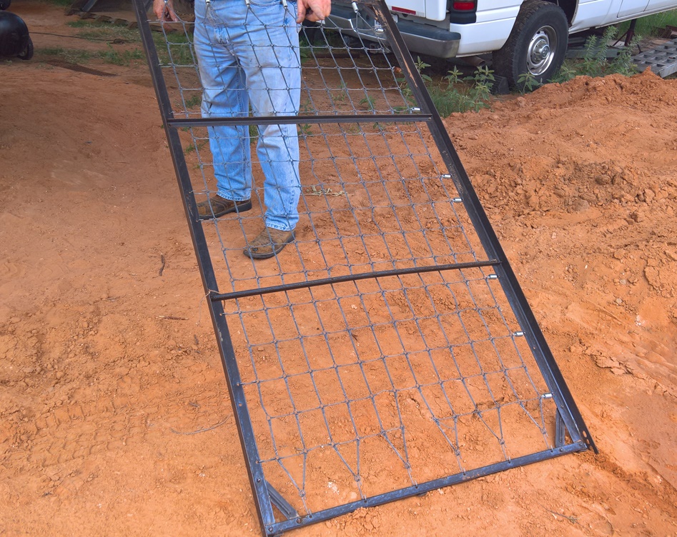

    I started out with an old bed frame for the materials to make the hold down out of

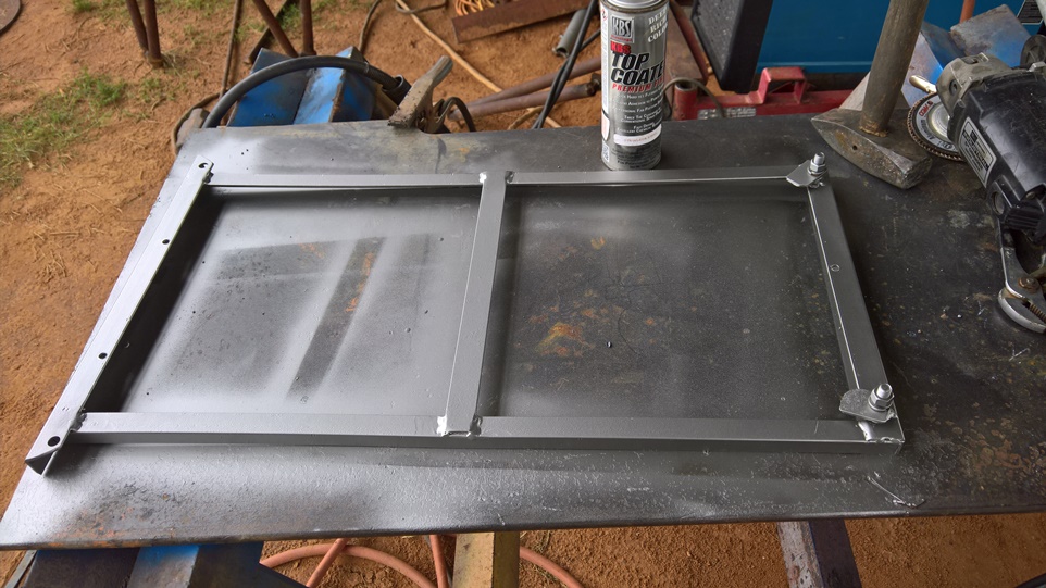

    This is what I came up with then painted it with KBS stainless steel top coat spray paint

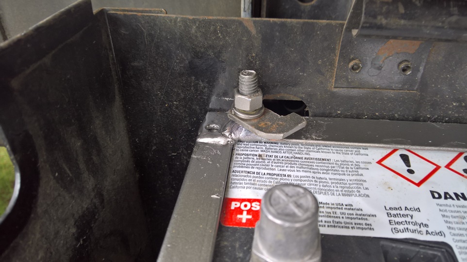

    the rear lock downs open
    and closed

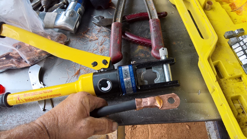

    having the right tools to makeup cables is a must for me

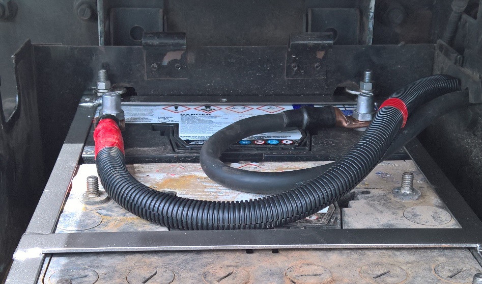

    then protecting them from arcing/ wear and sealing out moisture with shrink tubing insures long life
    All he has to do now is buy 3 more new batteries and he will be nearly set

    I've always been a big fan of using bed frame angle iron for many jobs. And it's always free...

    I've found the hydraulic crimpers make a nice little press if you take the dies out. Mine has a C shape, one die attached to the top of the C and the other to the piston with magnets.
    11,729
    2,238
    I have one of the C type as well but it is way larger than the little 16 ton unit I used
