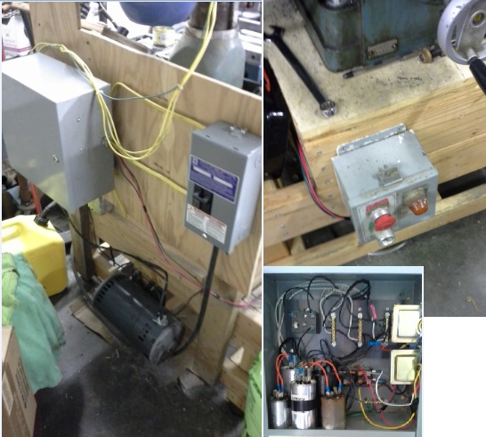

    3HP 3PH Rotary Converter with Auto-start circuit
    I needed 3 phase power, to drive the motor on my Asian Mill-Drill. A friend that is in the HVAC business, gave me most of the parts used in the construction of my 'new' 3 HP rotary converter. Nearly all of the parts, were salvaged from old decommissioned commercial HVAC units; which translates to huge cost savings!
    It uses a 'potential relay' to automatically remove the starting capacitor from the circuit, once the 3HP idler motor is up to speed. Very handy and convenient! The start/stop buttons (and box), were salvaged from an old department store cardboard compactor...
