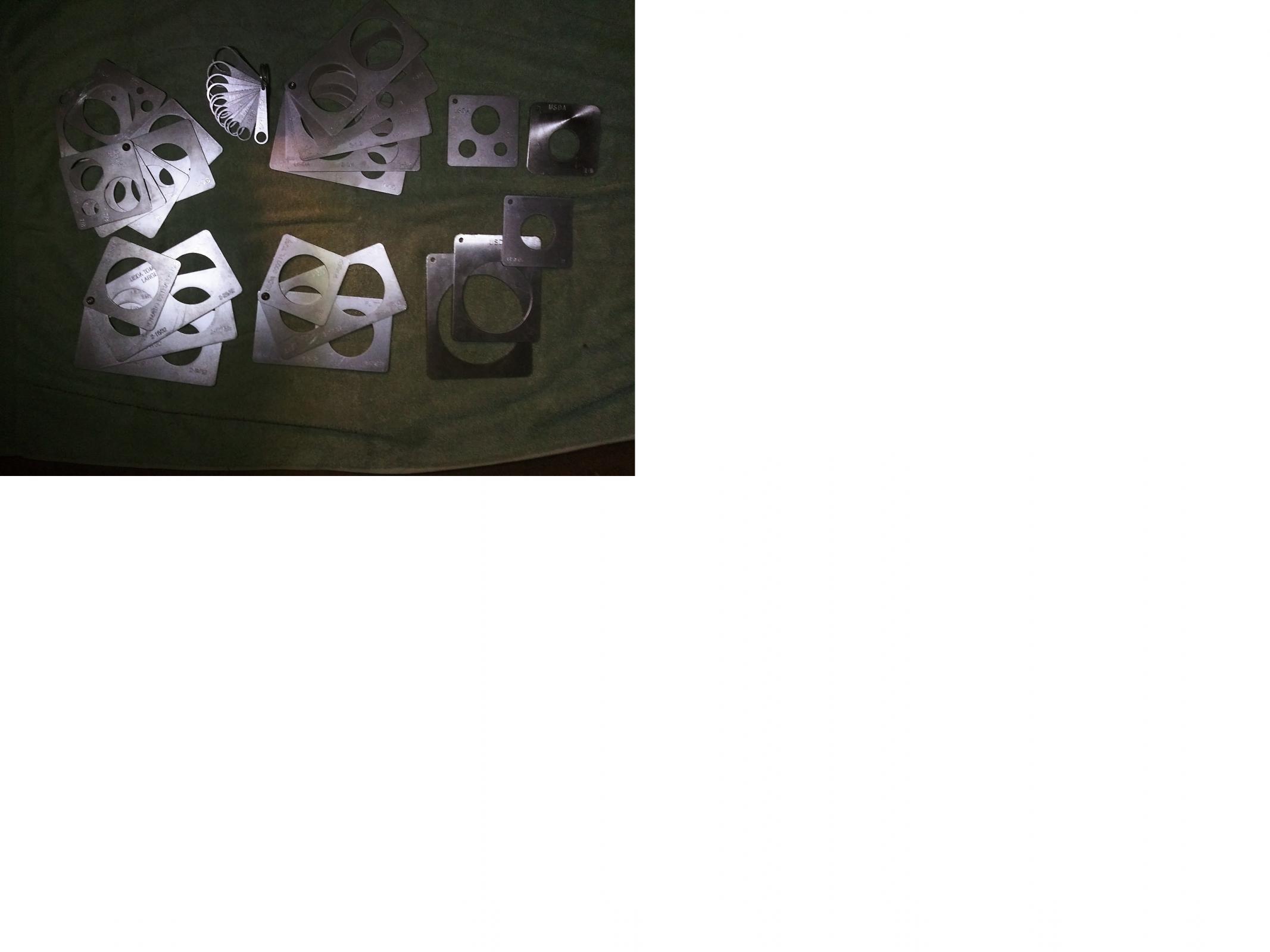

    Sizing is not sorting; related but not same. I know jack about growing vegetables, this customer was specific. Apparently sizing is first, as whether ready to pick. These were to be toted along in the field.
    No question; automation easier than these genuine USDA produce gauges. About 67 of them, many cover tomatoes. Sized fractionally starting with inches, increments of 1/16, 1/8, 1/4, 1/2, 3/4; some in 1/32! Who knew? Understandably, in larger sizes a small diameter difference significantly increases volume.
