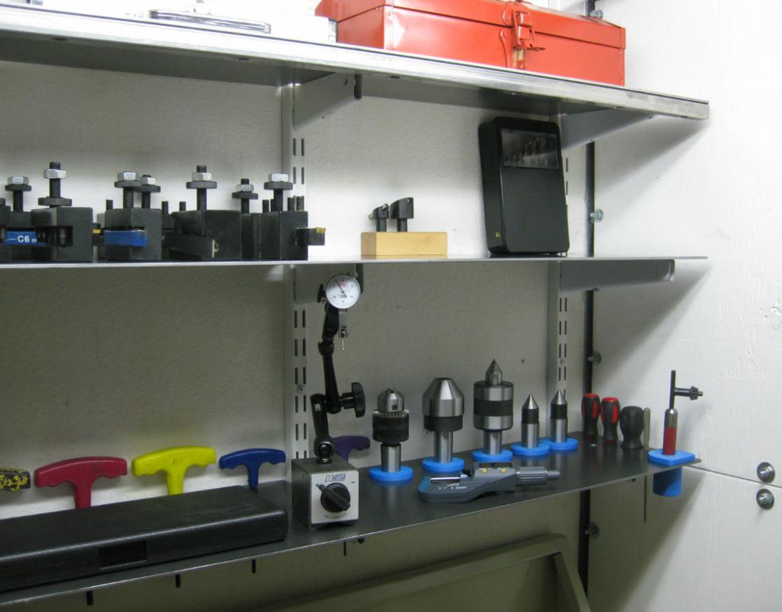

    Built some new metal shelves for the Lathe area and needed a way to hold the new Lathe’s (Morse Taper) MT-3 tooling secure.
    3D-printed ABS plastic inserts seemed like a solution …
    I could have used rubber Grommets ... but where is the fun in that?

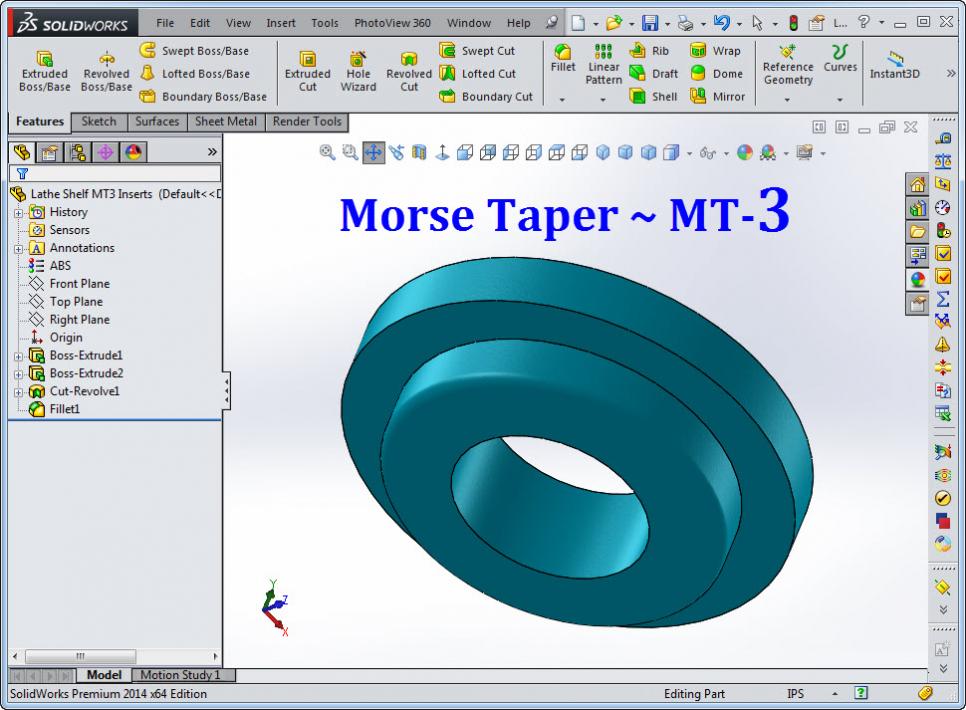

    Designed the ABS plastic inserts using SolidWorks CAD Software ~ The inner hole has the same 1.4377 degree taper from center line as the MT-3 Tooling.

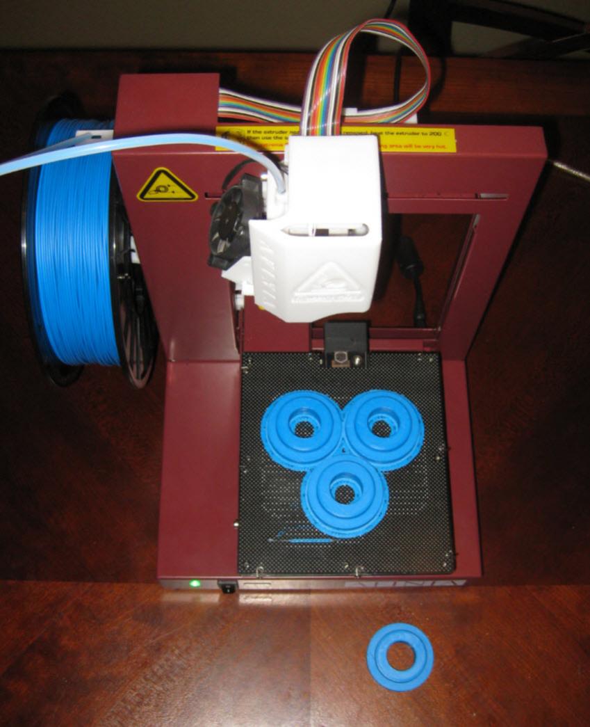

    Converted the SolidWorks CAD file into a 3D-Printing STL file and started the 3D-Printer ...
    3D-Printed MT-3 (Morse Taper) Shelf Inserts-3d-printing-mt-3-abs-inserts.jpg

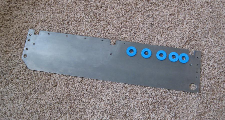

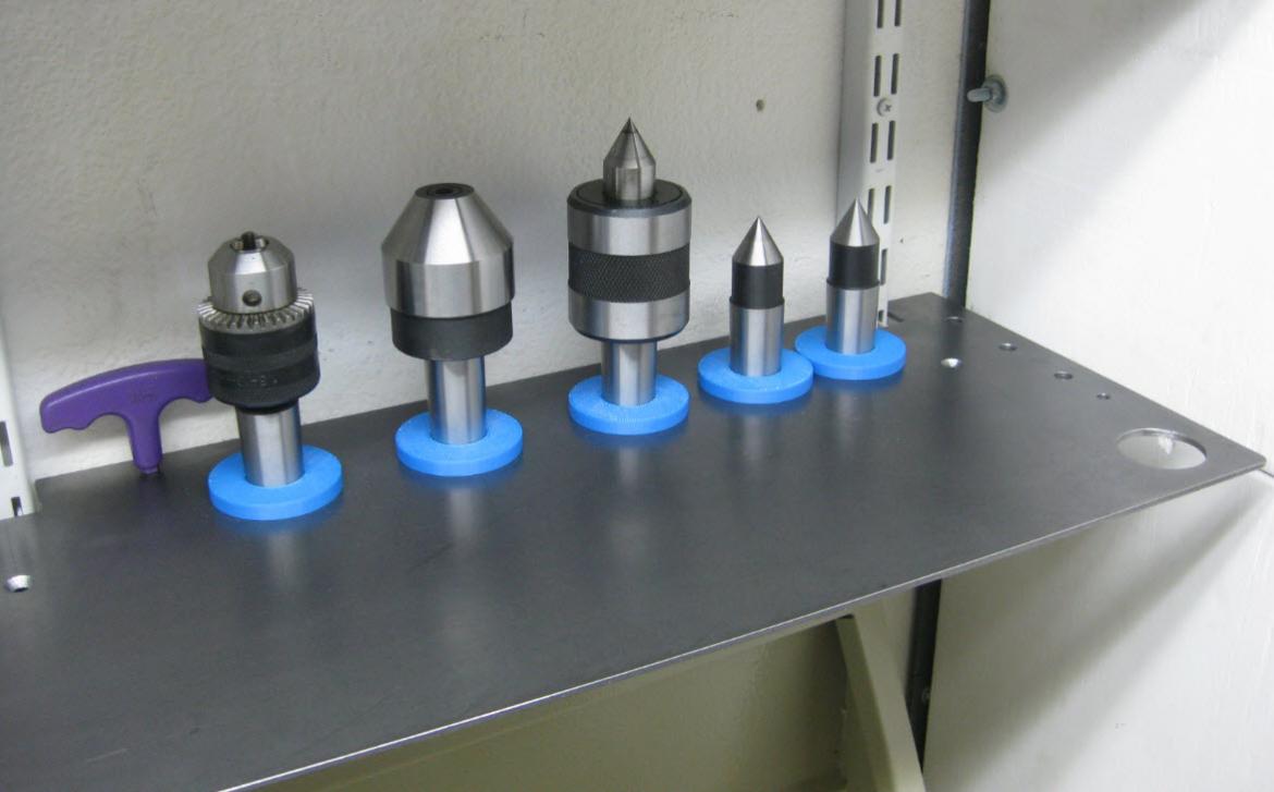

    The finished 3D-Printed ABS plastic inserts pressed into the 1.5″ diameter holes I cut in the sheet metal shelf using a hole-saw on the drill press.

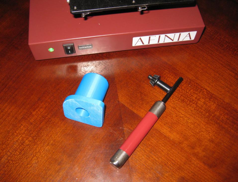

    Once the MT-3 Tooling was secure in the 3D-Printed inserts … Decided to make a ‘quick access’ 3D-Printed ‘Cup Holder’ for the drill chuck key.
    3D-Printed MT-3 (Morse Taper) Shelf Inserts-close-up-view-3d-printed-cup.jpg
    Found some scrap 5/8″ round-stock steel and used the lathe to bore a hole in it the same size as the chuck key handle diameter … Then pressed the chuck key into the round stock creating a comfortable handle chuck key unit.
    Wanted it easy to use the Chuck Key so designed the 3D-Printed ‘Cup Holder’ type design about 1.875″ deep with a loose fitting diameter of 0.700″.
    The best part is while I kept working in the Workshop, the 3D-Printer was making the ABS plastic inserts in the house … Felt like getting twice the work done!!
    Sometimes the simplest of items can be very helpful.
