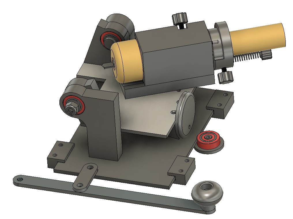

    I've been working with John to create a 3D printed version of his well known four facet sharpener design.
    Using 3D printing for the majority of the parts makes this a readily reproduceable design and the 3D prints don't undermine the basic concept or functionality. It also makes the undertaking of this project more attractive to a wider audience.
    I've created a ZIP file download that contains (hopefully) all you need to reproduce the design. This includes a full write up, the original Fusion 360 files, STEP files for the 3D parts and 2D PDF drawings of the remaining metalwork parts. See the link below.
    https://www.altrish.co.uk/2022/09/08/3d-printed-four-facet-sharpener/

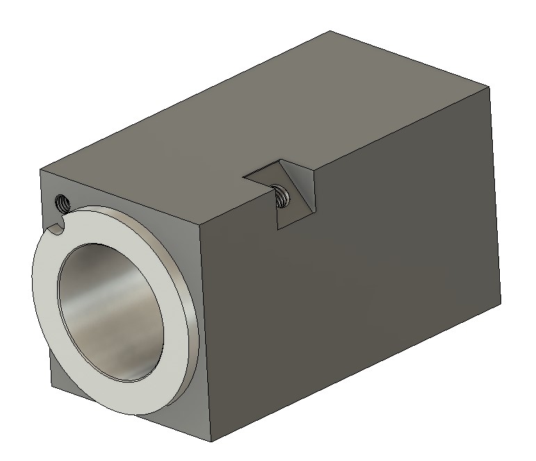

    I've hand some early feedback that looks to relate to the print quality of the collet holder mounting block. The feedback indicated that the shank of the collet holder does not slide smoothly in the block and the depth adjuster screw has a similar problem with the roughness of the end face of the block. A resin printer might not create these issues.
    Following this feedback I have done an update with a new print of the collet block with a larger through bore into which slides a flanged aluminium or steel sleeve. This appears to solve both these issues. I have posted an additional ZIP file with the new block SLA and the PDF drawing of the sleeve on the same link as above. The sleeve is a simple lathe activity and the new block is still easier to print than make from solid metal.
