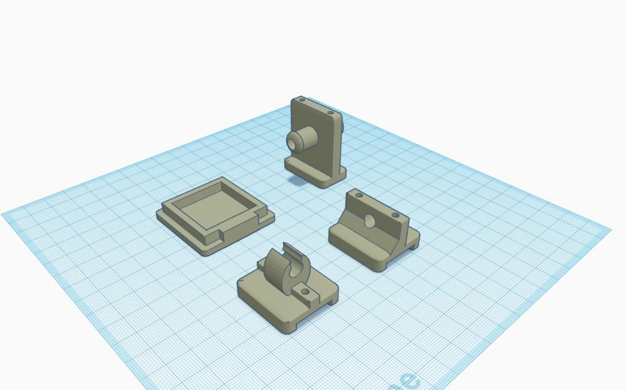

    Decided to make channel rail system to my shop, for the lights and powerplugs..
    Also it should be strong enough for hanging tools, if needed.

    vrey nice, adding threaded rod was a good idea
    Thanks Frank! I think this will come out nicely, after i have printed all parts for the longer system.

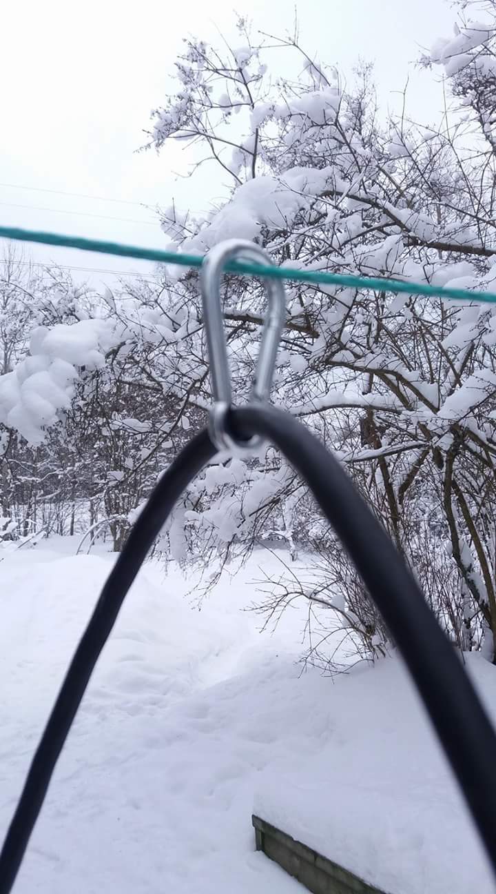

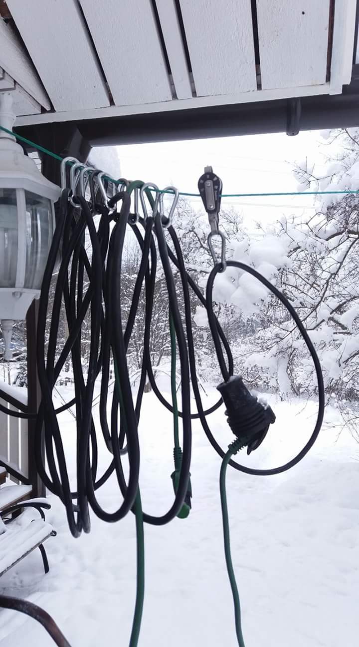

    This version i use outdoors.
    Bonus is that its easy to dissassemble if needed.
