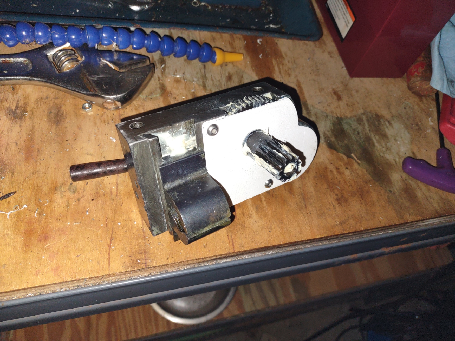

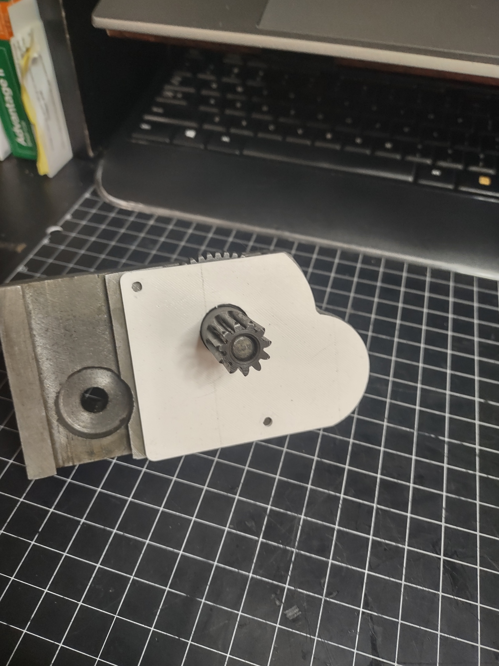

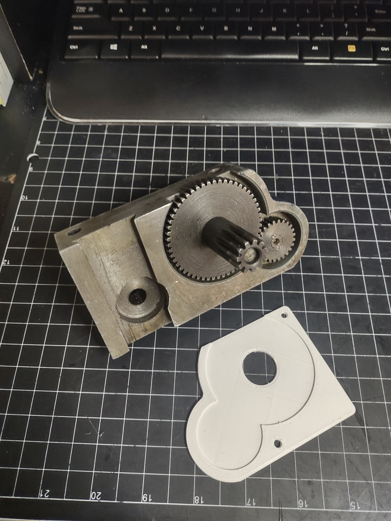

    I pulled my lathe apron apart for maintenance and made this 3-D printable cover for the gears in the apron.
    3D-Printable cover for 7x10/14/16 Minilathe Apron Gears-img_20230222_170618747_hdr.jpg
    3D-Printable cover for 7x10/14/16 Minilathe Apron Gears-img_20230222_170649499_hdr.jpg
    3D-Printable cover for 7x10/14/16 Minilathe Apron Gears-img_20230225_164239012.jpg
    I put the download up on Thingiverse.
    https://www.thingiverse.com/thing:5871566
    Anyone that needs one and doesn't have a 3d printer, PM me. I'd be happy to print you one.
    Question: How do I know how much clearance to put around a screw hole when designing a part? I've read about press fits and slip fits in the Machinery's handbook, but I'm struggling to connect that hypothetical knowledge with real-world designs. Specifically, this part uses M4 screws for mounting and I added (I think) 15% of the diameter for clearance around the fastener. Still, I had to drill out the cover get the screw to fit. What am I missing?
    I can (and will) brute-force the problem by printing an array of holes of various sizes for my next project, but I'd like to understand the "right" answer too.
    Thanks all.

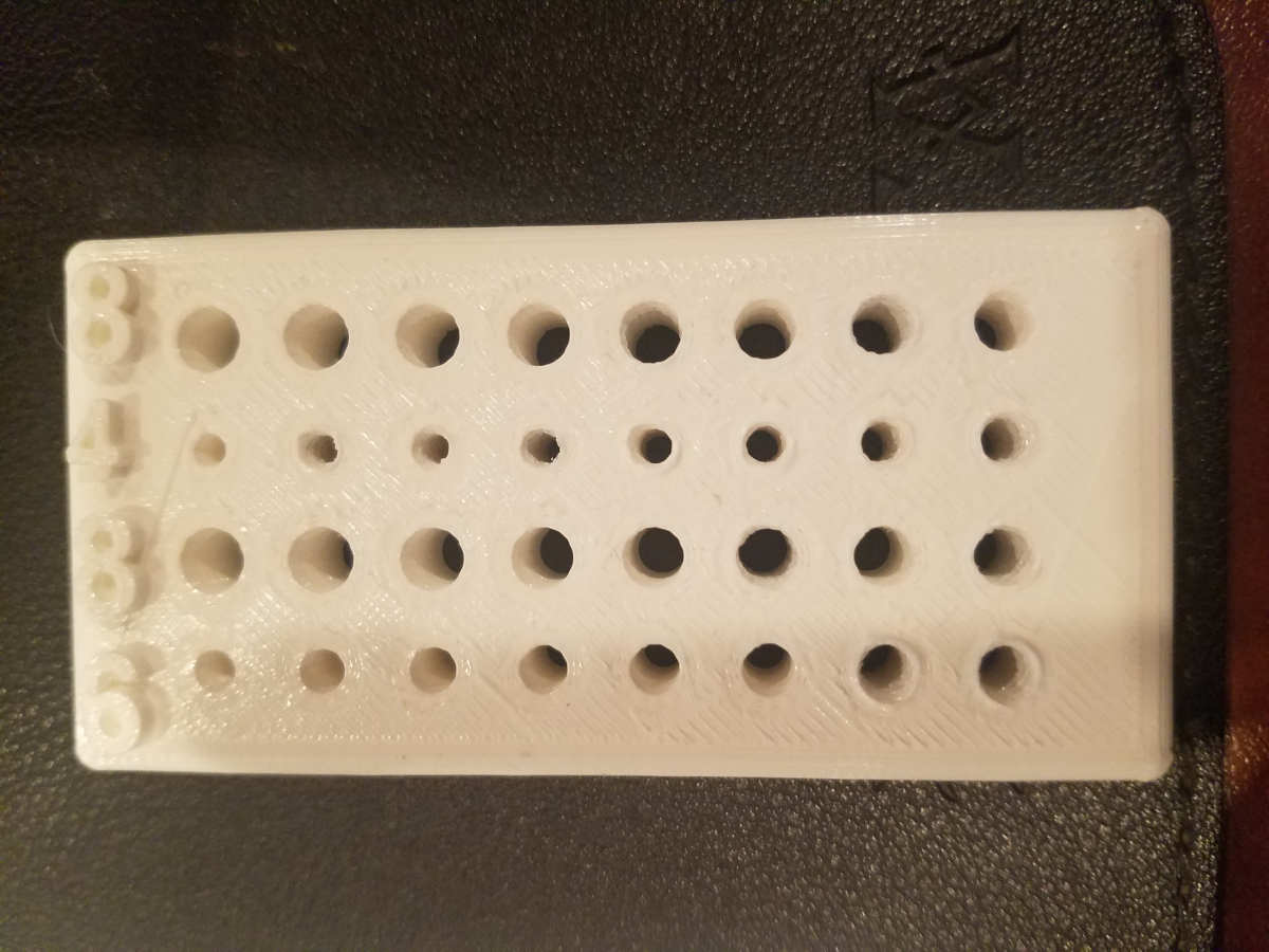

    I have made a few of these:
    3D-Printable cover for 7x10/14/16 Minilathe Apron Gears-20230228_211807.jpg
    which have holes of different sizes that I can test the screws with. This was one that I did for PLASTITE screws (from McMaster - torx plastic screws) and I was trying to figure out the best hole for #4, #6, and #8 screws.
    Also, I have made screw holes be hexagonal rather than circular - thought it might help. But - also, I can print hexagons on their side as well, does not violate overhang angles.

    I just printed your gear cover and the settings produced 4mm holes with clearance. Nice cover. Thanks.
  10. #9
    Nov 2017
    414
    40
    Thanked 216 Times in 121 Posts
    Elizabeth Greene's Tools
    Quote Originally Posted by Biggus1942 View Post
    Awesome! Glad it worked. If you install it on your lathe, note that you don't have to disassemble the half-nut and gib assembly. I did because I needed to clean out the half-nuts. If you do pop them off, they have a preferred orientation so mark which one goes on top. I didn't do plan for that and had to do it twice.
