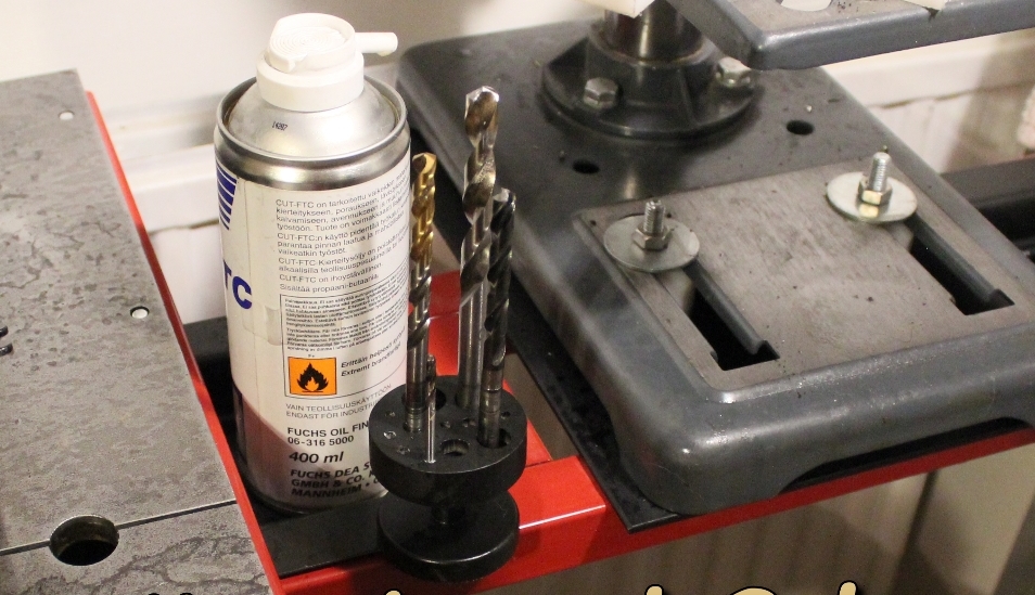

    Made this holder for dremel and drill bits.
    3D-print dremel / drill bit holde...-hold.jpg
    Its for keeping near those bits that im currently using.
    Magnet hold bits on their place even upsidedown.
    Faster bit changing.
    Materials:
    3D-print "hat" and two magnets. Magnets connected together with cut M6 bolt.
    Magnets was 2.5€ each.
    Design in tinkercad: https://www.tinkercad.com/things/llD...or-50mm-magnet

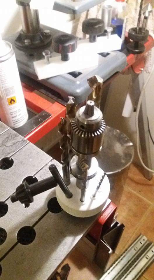

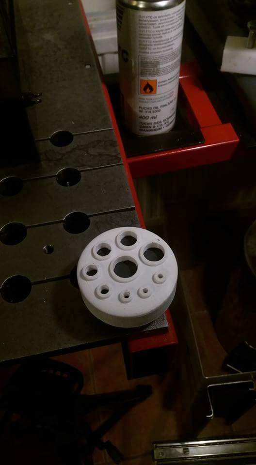

    Made a little bigger and little better looking version from 65mm magnet.
    Bigger magnet is strong enough to stand by itself, without second magnet as a stand.
