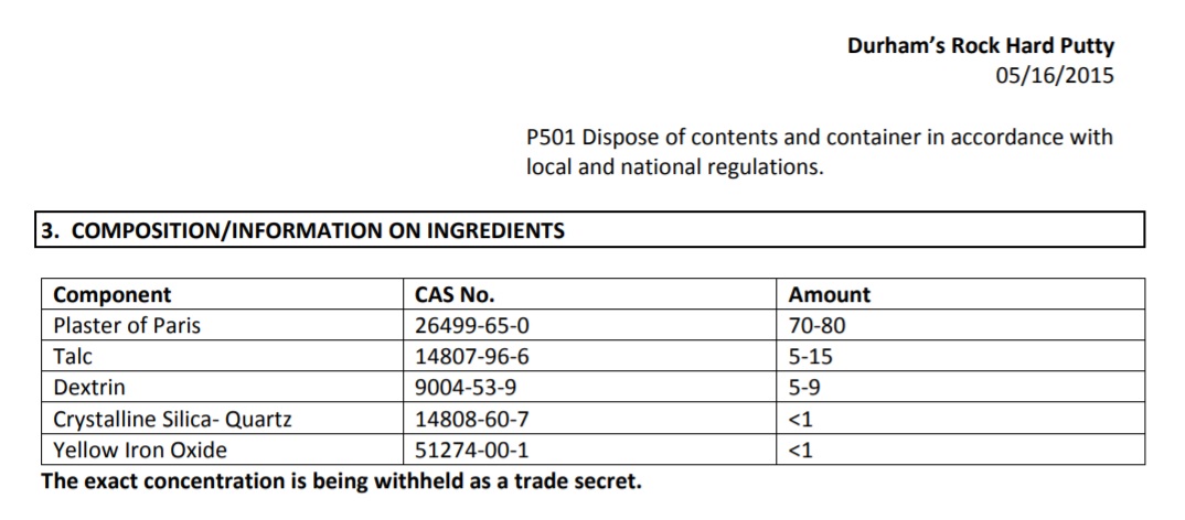

    To mount the vial in it's tube...Rock Hard Water Putty. Looks exactly like what is in there.
    I've used it for years to bond new brass necks onto glass oil lamp bodies.
    It's literally, as the name states, hard as a rock, and sets with out any shrinkage.Name:  Water Putty.png

    Thanks for the tip, Uncle Fuzzy - I'll check out whether that or some equivalent is available over here!
    Your suggestion is right up my alley.
    OTOH...
    The Swedish Cheapskate's 1st Commandment:
    -Thou shalt not BUY, what you can wing together thyself, by reading the MSDS!
    AFAIK: The dextrin (sugar), quartz and iron oxide content is probably for it to keep its powdery property and ease of mixing.
    Seems to be of too low percentage as to have any bearing on final hardness - that's what the talcum's for.
    Snag is: Plaster's pretty hygroscopic, and could deteriorate in hi humidity environments...
    My first thought on fixing with Plaster of Paris was to add talcum and/ or bentonite clay up to, say 25%, add some water.
    "pour" and let that set, then finally and forever fix that putty with 50/50 water glass/water mix (for optimal penetration).
    Nope- you can't mix plaster (nor any other cement) with water glass directly - it'll become "Insta-set" in the bucket.
    (My home-brewed El Cheapo refractory mix was 7% bentonite (ball) clay, 93% (of weight) silica sand, add water glass to taste.
    30-40% Perlite could be added to that mix for better insulation. Held up just fine up to app 730 deg C in my old aluminum foundry.)

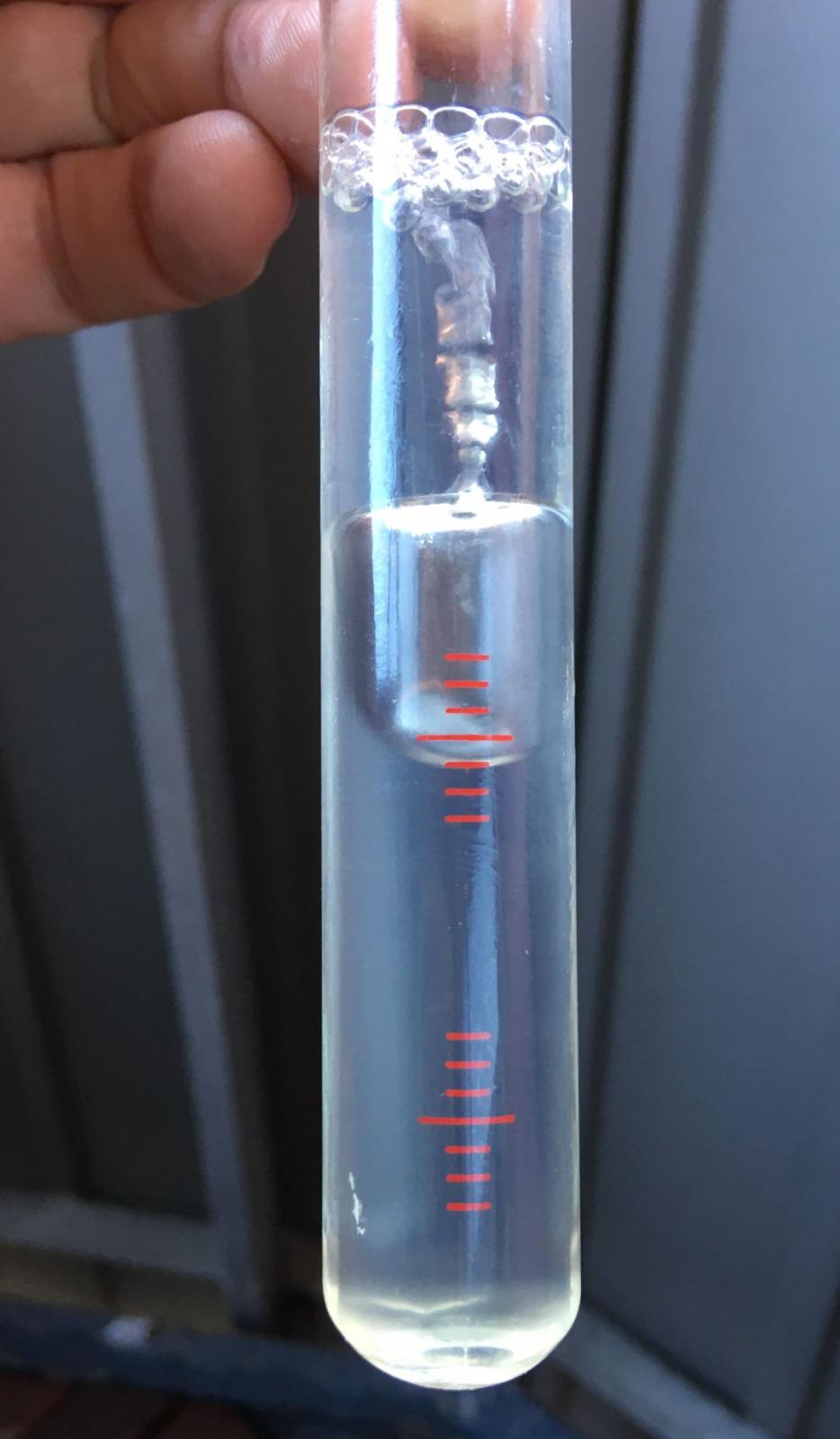

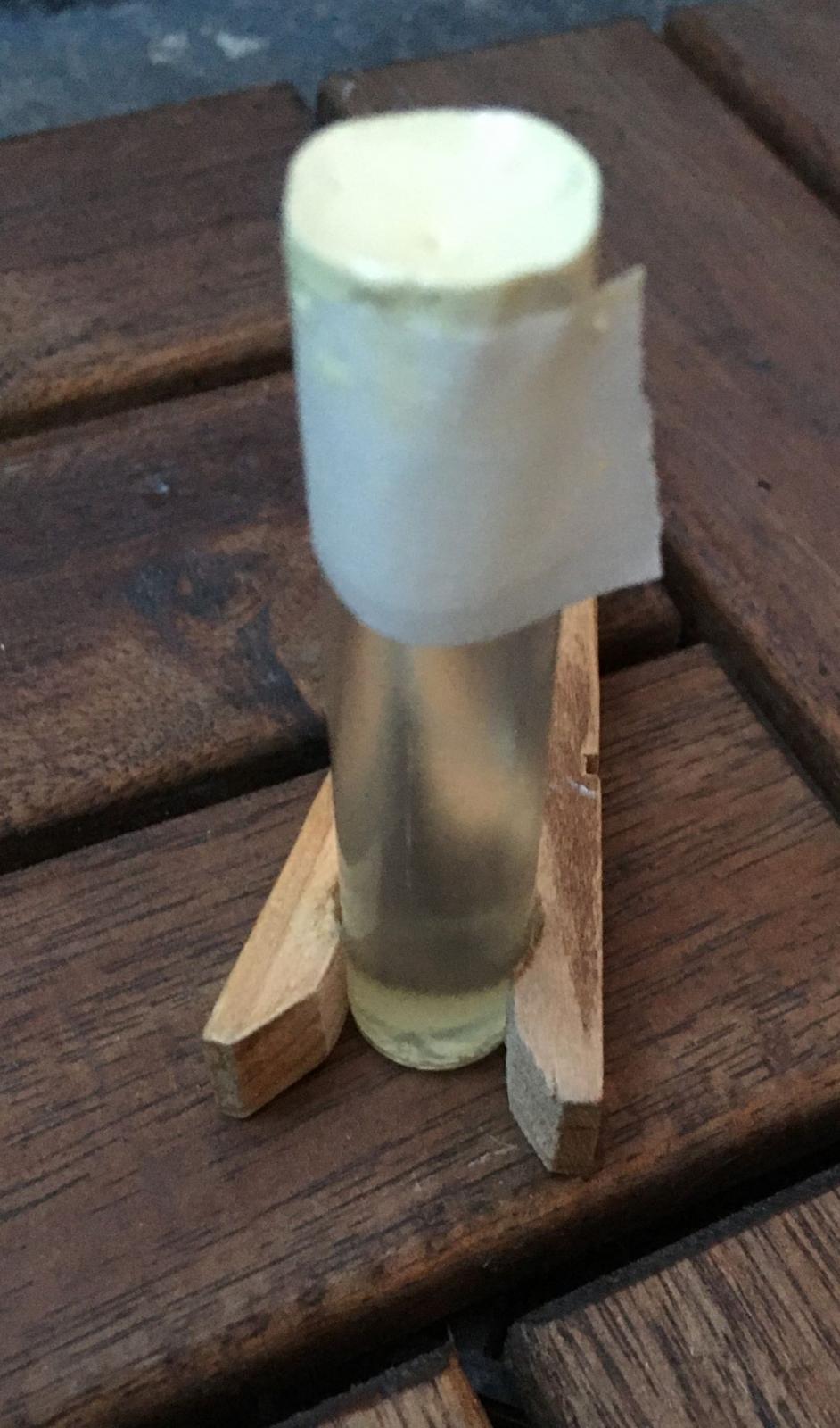

  9. #19
    May 2019
    Stockholm, Sweden...
    634
    417
    Thanked 805 Times in 319 Posts
    DIYSwede's Tools
    -Well, at least I tried...
    35 buck Chinese Machinist's Level overhaul and cralibation (!)-vial-filling.jpg
    Starter fluid in test tube - came out way below freezing, so I had to wait for the drive gas to boil off,
    then dropped the vial in and let it fill up - a mere walk in the park - no thermo-cycling even needed.
    When filled, let some ether mix out by hand warming the vial for a proper-sized bubble,
    then thoroughly cleaning the roughened neck (as there was some oily residue from the fluid),
    tape off a ridge for the epoxy to sit within, mix it and fill - let cure (-Ahem):
    35 buck Chinese Machinist's Level overhaul and cralibation (!)-vial-curing.jpg
    This morning I figured out that only one of infinitely possible outcomes had actually happened:
    The ether in fact stopped the epoxy from hardening at all, it was just a gooey mess,
    and the previously "perfect bubble" inside hade become bigger, and thus totally useless for its purpose.
    Tore the mess off, emptied the vial by warming it, and cleaned it for Round #2 ... Off to work.
    Conclusion to y'a all: Epoxy IS resistant to all sorta liquids, but only when properly cured!
    My hypothesis: Ether is very volatile with a pretty high vapor pressure at room temperatures,
    that prevented the epoxy from hardening.
    So: "Rinse and repeat" for yours truly - next time sealing with a droplet of waterglass, instantly set by a shot from a CO2 extinguisher.
    Then, with vial properly sealed off - some quick setting "steel epoxy" for ruggedness.
    Given the levels of my knowledge and wiseness (humbleness aside) today - I thought I've already done all mistakes possible!
    The fun never ends for a cheap walk-in closet machinist.
