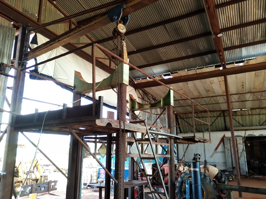

    This is probably one of my larger builds that is not a building even though it will have an enclosure which will be a pump and filtration shack
    3 years ago I bought a 3000 gallon pressure tank that was used as water storage the tank was rated to 60 PSI about 6 months back I finally had it hauled to my place and dropped off in front of my shop and I have been wanting to put it to use ever since so over the past couple of weeks I repaired the clean out man hole should be called the child hole because no one over the age of say 10 years old would ever be able to fit through an 8 by 14inch opening anyway.
    Then I set about to add some ports nipples and valves for future use One end I just removed the cap that was on the coupling and installed a 3 inch gate valve the other end is where I did most of the work it had a 3" nipple sticking out which I welded on 2 2'pipe nipples and a 3/4" coupling then at the open end of the 3 inch nipple I welded a 3/8" thick washer with a 1 1/2" 12 ft long pipe in the center which extends almost to the other end of the tank internally this will be the out take for the water to be piped to the water tower at my house. the reason for this was I will be filling and removing the water from the same end but I wanted the out flow to be from the far end it is all about my planned circulation and continuous filtration flow scheme
    the stand for the tank or tower if your will is just over 10 ft tall with a mezzanine just over 6 ft from what the floor level will wind up being this gives me a 5 ft by 8 ft floor area located about 4 ft below the bottom of the tank which will be the location of at least 1 possibly 2 35 to 50 gallon filter arrangements and several pumps
    On both ends of the stand I mounted platforms for accessibility to the valves and piping without having to stand on a dang ladder I added a narrow catwalk along 1 side to access either end and a ladder stair up to 1 of the platforms
    The tank is situated about 5 or 6 feet away from the well since I plan on constructing a windmill over the well
    I will probably also have an electric pump for when there is no wind I have my 1.1 KW solar system that I may install on the tower later as well but I have a 50 amp 240v supply at the pile next to the stand. So wind solar or grid the means of getting water out of the ground circulated through filters and pumped to the house will have that problem covered
    the tank is also high enough that it will gravity flow to the water tower at the house but not up into the tower I will be able to have non pressured flow to the garden or the yard
    As with the existing water tower I have the capability to pump water into the storage tank from a truck tank or to refill the tank of a forest service fire truck but with the 3000 gallon storage I also have a 3 inch drop line as well as a 2 inch drop line.

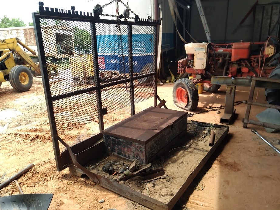

    This old truck headache rack with drome will be perfect for the mezzanine and 1 platform

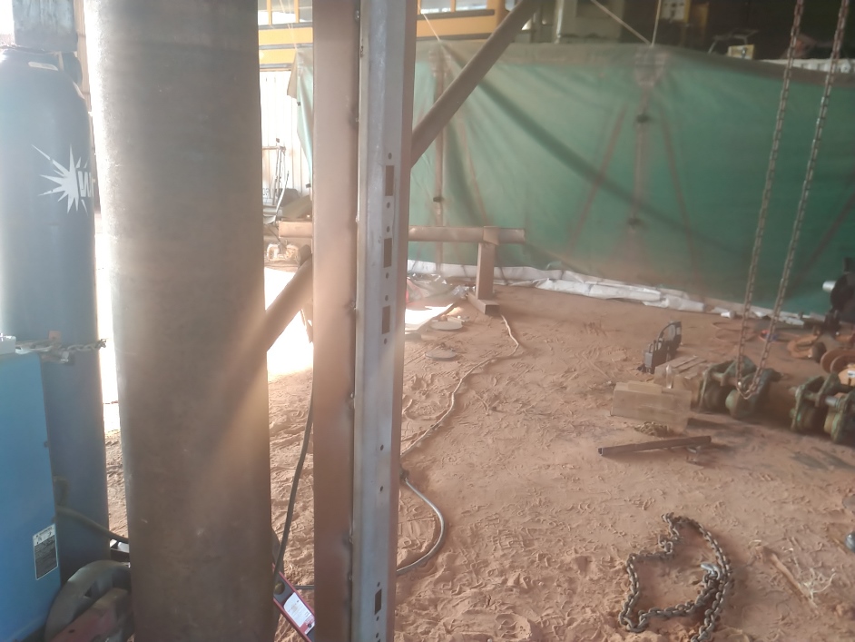

    What better way of making a door jamb than to make it out of a 4" C purlin and a piece of garage door track

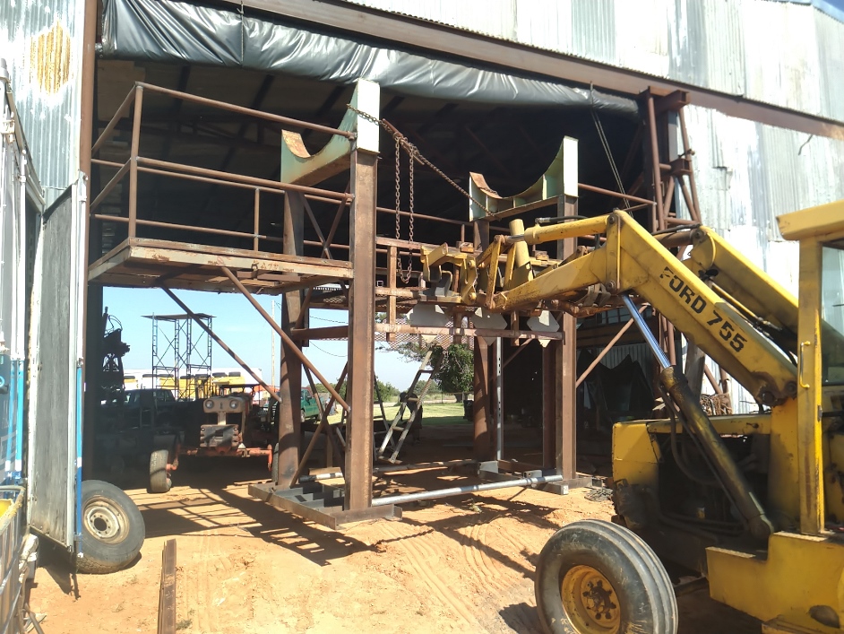

    The jib crane came in real handy for installing the long handrail pipe for the catwalk
    Projects like these are the real reasoning behind my wanting oversized door openings

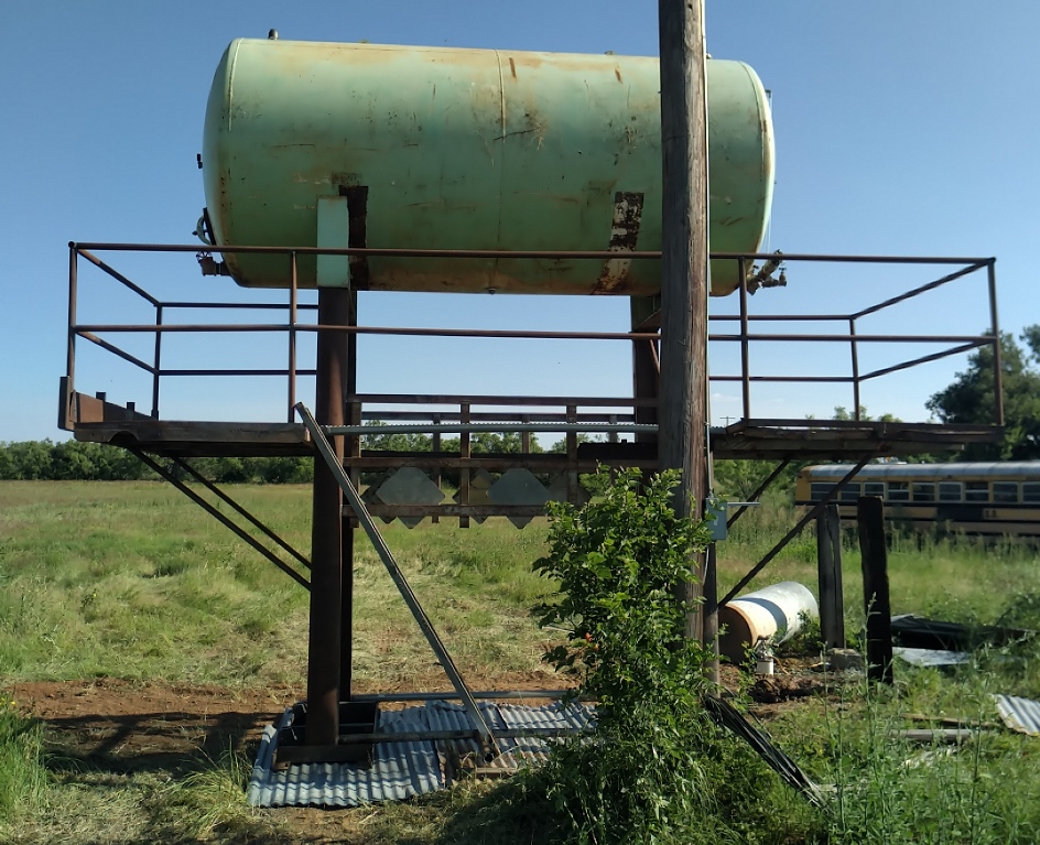

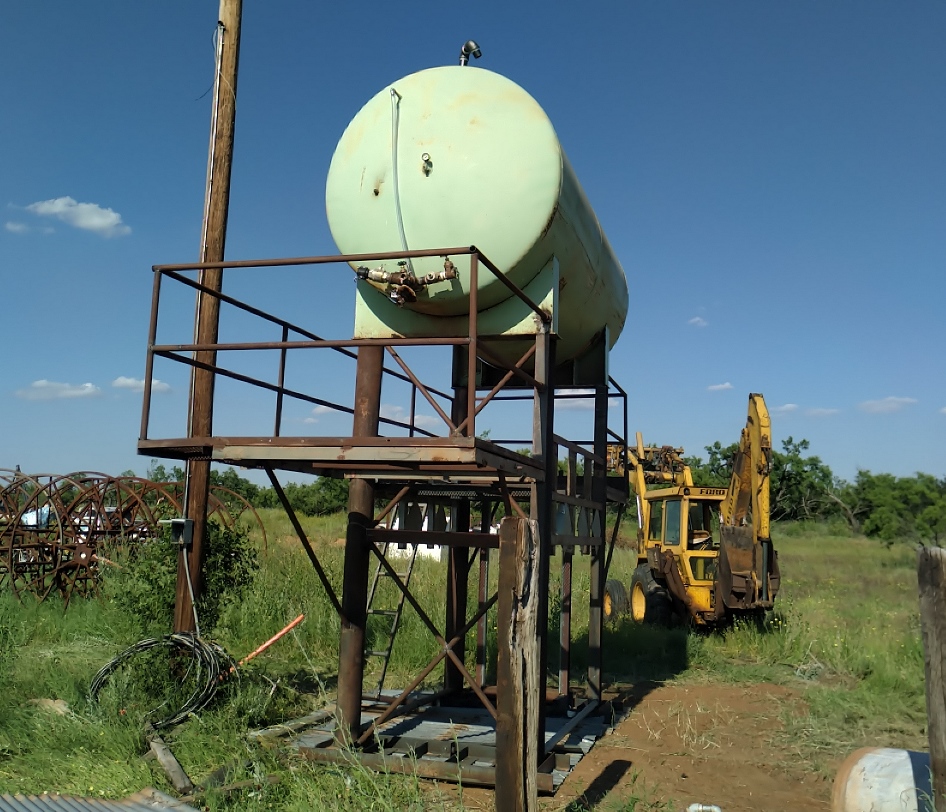

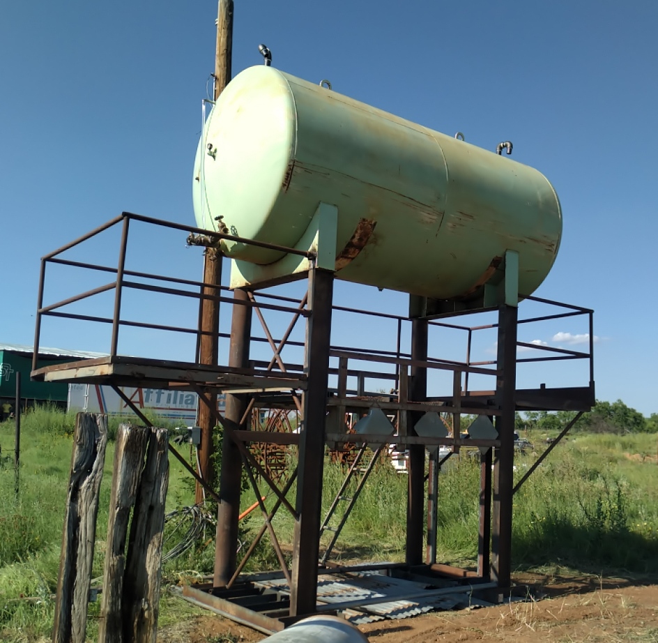

    Site leveled sheet metal laid on the ground stand and tank on top the sheet metal will keep grass and weeds from growing up around it I may dump gravel over it or pour a slab on it later

    Here is a partial list of the materials for the tower stand
    to start off with I had made a leveling drag back when we were working on the shop floor it was made of 2 8" wide flange beams and the angle iron frame work left over from a scorpion safety stinger I had scrapped for the aluminum in it
    these frames made out of mostly 3 1/2"x 3 1/2" by 1/2" thick angle iron welded together to make a 2ft by 6 ft frame
    the Legs of the tower are made of the beams from the leveling drag and 2 8 inch diameter pipes
    the X bracing and the hand rails are made out of 1 1/2" sch 40 sprinkler pipe I used about 150 ft total
    the cradles for the tank came with the tank which I paid about $150.00 for several years ago the headache rack I made for my Freightliner back in 1991 a lot of it was used material back then so this time is the 2nd up cycle for that material at least
    the cat walk was new old stock bought in an auction several years ago the 2nd platform is made out of the floor frame from a salvaged deer stand the rest of the deer stand was up cycled last year into a small trailer .
    I did have to buy about $500.00 worth of brass valves 2 &3" pipe nipples but managed to re use several SS steel nipples and fittings and 1 2" stainless ball valve that I had bought in an auction years ago otherwise I probably would have had to spend another couple hundred bucks. I will probably have to spend another $1000.00 on plumbing supplies before the tank is fully connected to the well the house tower all of the pumps and filters
    the tank weighs 5000 lbs and the tower stand is about 2500 lbs
