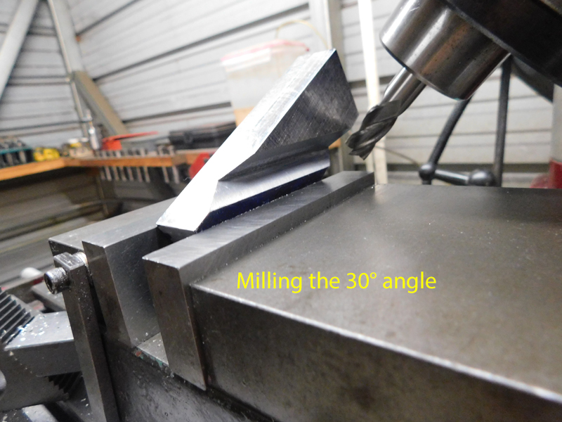

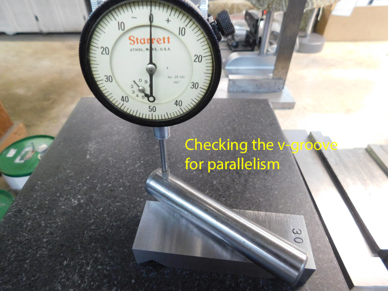

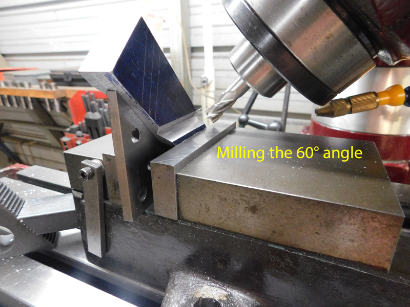

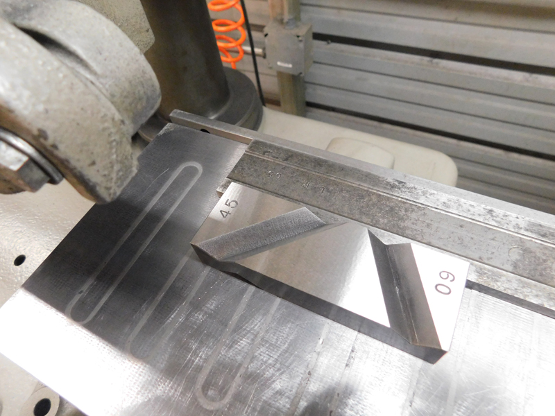

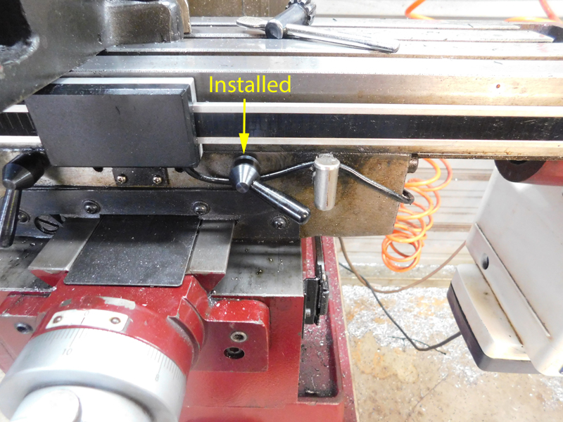

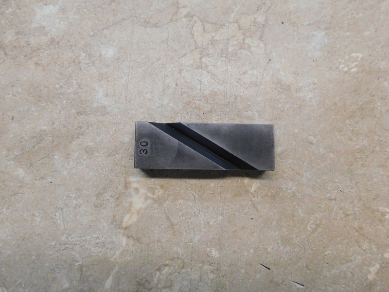

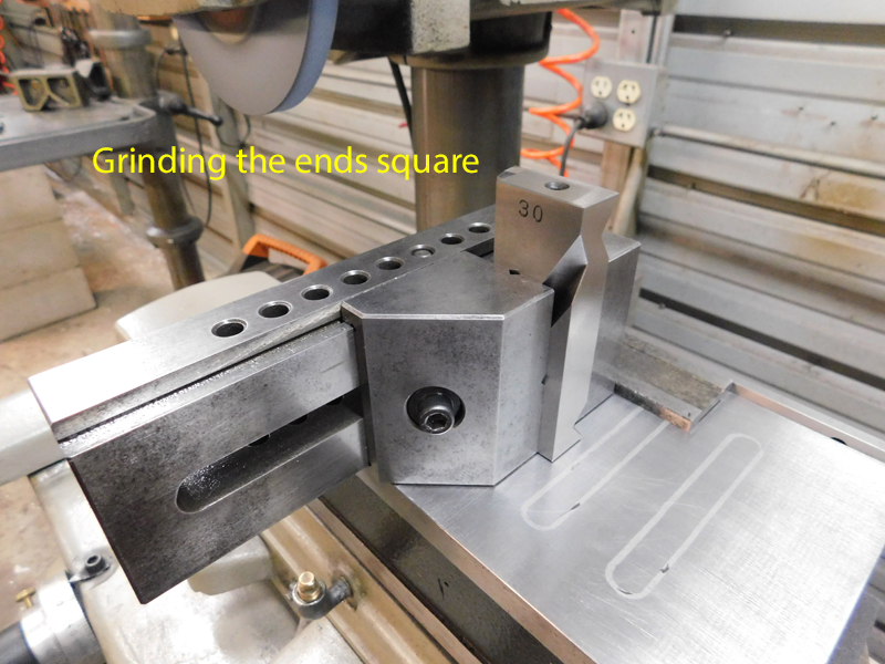

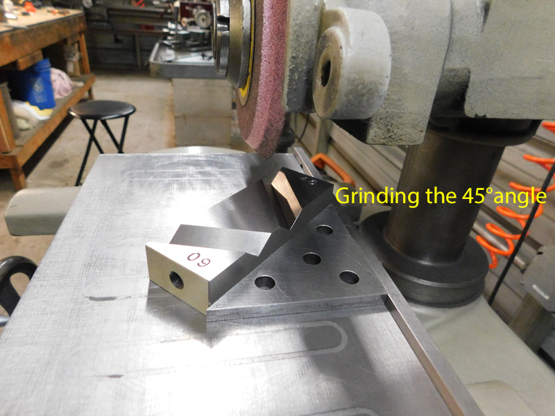

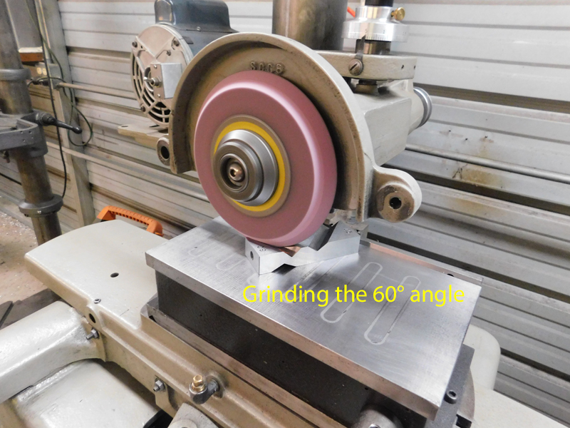

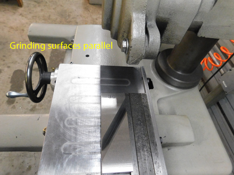

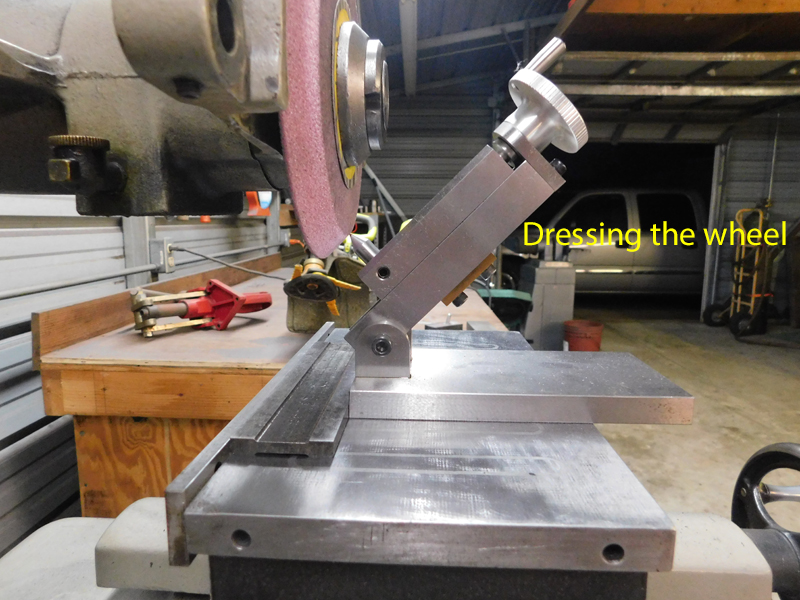

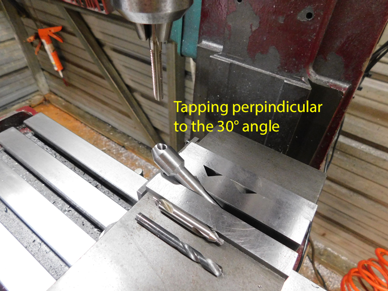

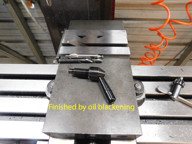

    I was making some new locking handles for the table and cross feed on my mill the other day and had a brain storm, these handles I’m making have a locking lever that requires a tapped hole at 30° to the axis of the handles screw, drilling and tapping these holes at that angle is not a problem if you had just the right size v-block with an angle plate under it, they could also be tapped with just an angle plate under them or a dividing head and several other ways, the jaws on the mill vise are only 1-3/8” tall so it was a toss up to make just the right size v-block with an angle plate under it or just make a v-block with some common angles machined into it, so I decided to go with a v-block with three different angles milled into both faces, one side of the v-block has a 30° angle milled into it and the other side has a 45° and a 60°, the v-block is ground to the same height as the jaws on my vise making it easy to setup, the degree marks are clearly stamped to their corresponding angles, I had thought about making one of these some time ago but never got around to it nor had I the need for it until now, just another little quick setup fixture.

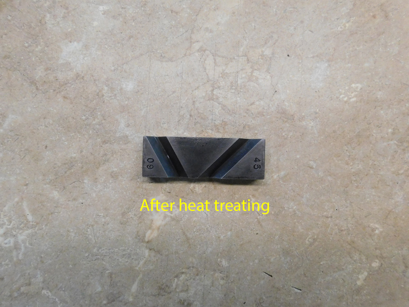

    This block is made from O-1 steel hardened and precision ground flat, square and parallel on all six sides, the vees were then precision ground true to the adjacent sides.
    I have included some photos of the machining and grinding processes and some photos of the block being used.
    As always thanks for looking and happy machining
    Doug

    Thanks for the shot of the head cranked over for the V groove.

    This is not a criticism, but a curiosity. I have a nagging concern over your surface grinder placement. Maybe you have defining reasoning that I can't know for placing your grinder like it is, but I saw that and it made me hesitate. It's common practice to turn the surface grinder so there's a backstop behind the wheel. That's so any broken wheels or thrown parts don't fly across the room and hit someone or something, but into a solid stop, like a wall. I've been using surface grinders for 20 years (before my wreck), ending my career working from a Jung CNC profile grinder making one-off and short run parts (it's most commonly used for jet engine turbine blades). I've knocked away parts and broken wheels a few times, and there's a lot power behind the projectiles. Your thin metal wall could be reinforced with an alternate material directly behind the grinder.
