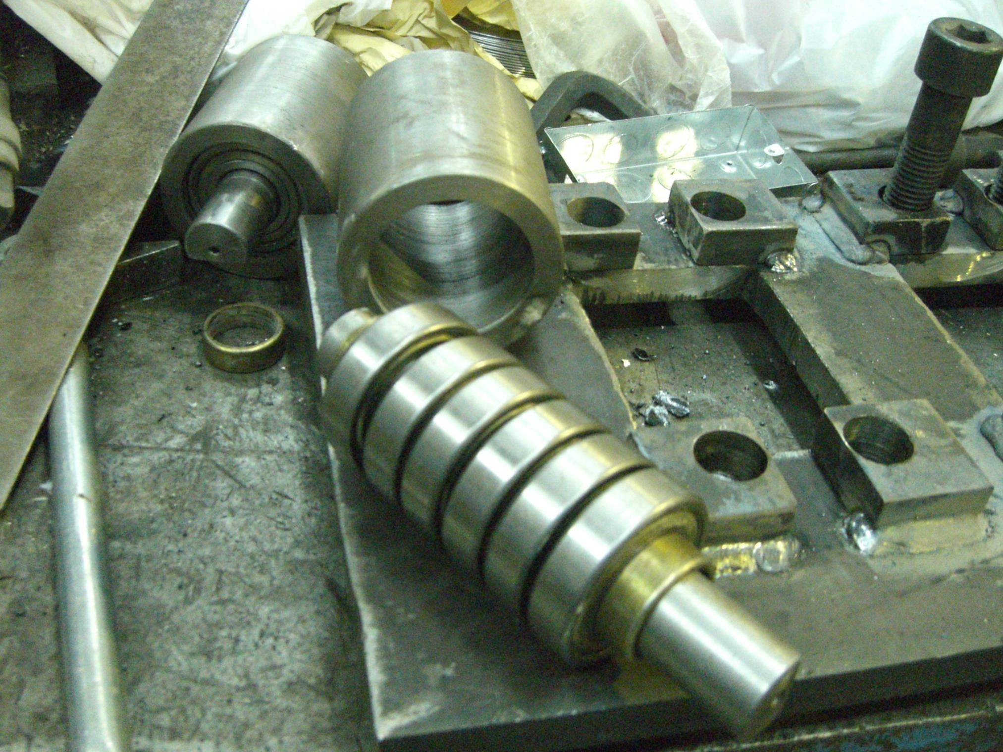

    Ok actually if you were to install a 7 ton hoist on it and loaded it all the way out to the end of the boom the crane would have still be safe and stable I built this for a maintenance facility that repaired vehicles for the US Army so the rating had to be graded according to Government standards
    the bottom bearings

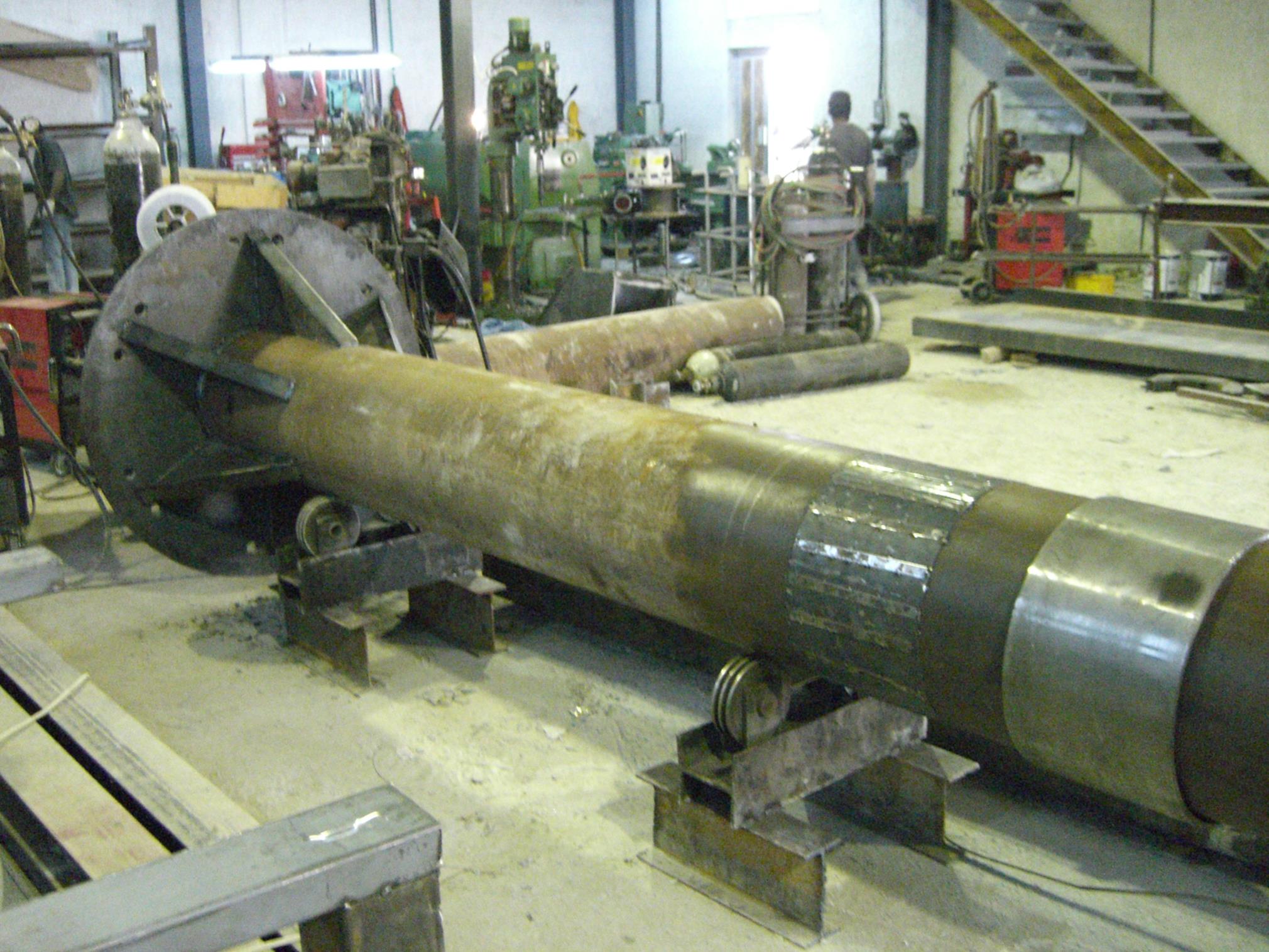

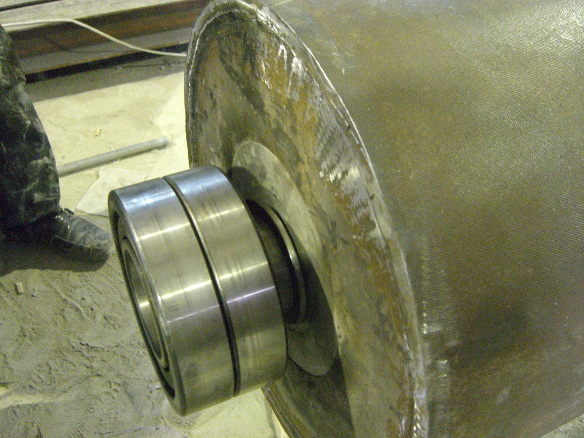

    the crane leg 18" sch 160 pipe

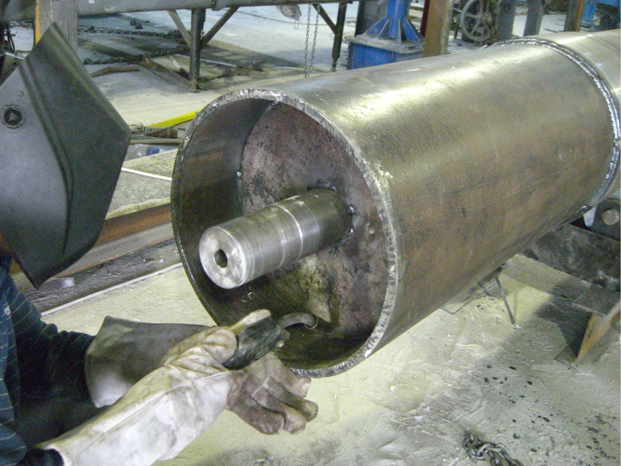

    the bottom bearings before assembly into the outer shell

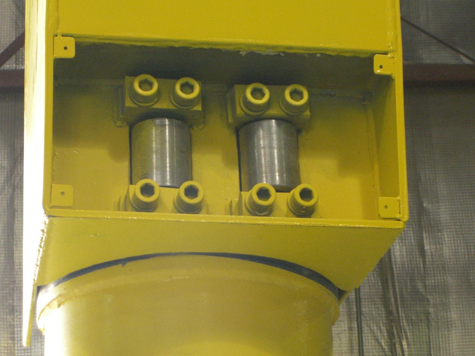

    top bearings on the 3 1/2" top pivot shaft

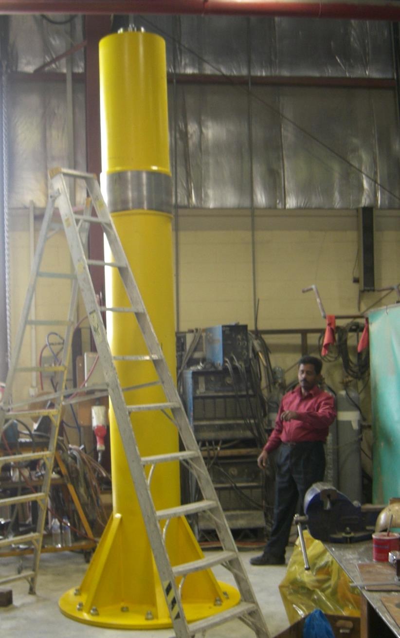

    crane leg machined, fabricated and ready for paint

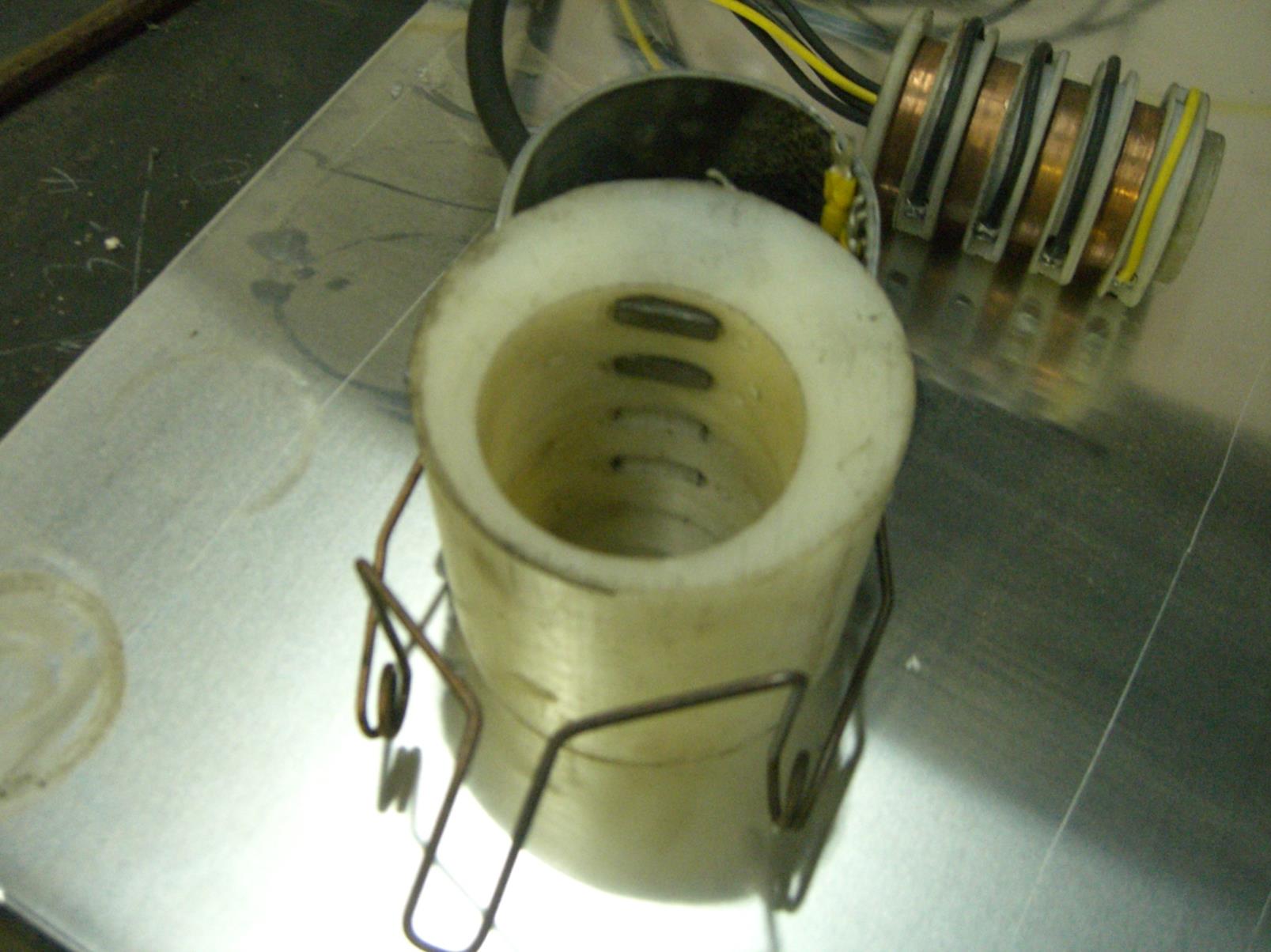

    Home made carbon brush swivel for 3 ph with ground 3/8 by 1 1/2" brushes

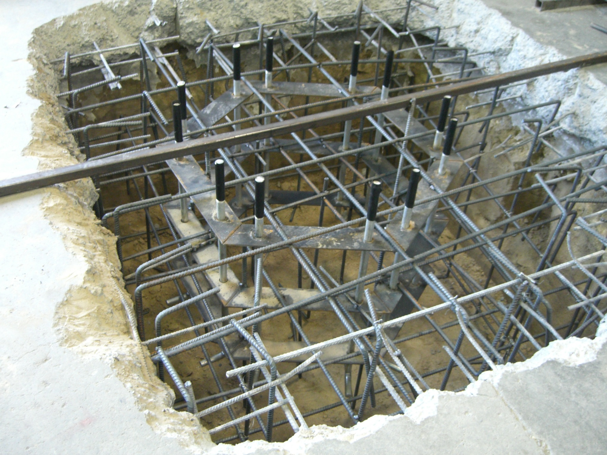

    Anchor bolt assembly for mounting of the crane the pit was dug 6 ft deep 10 feet wide by 10 feet long

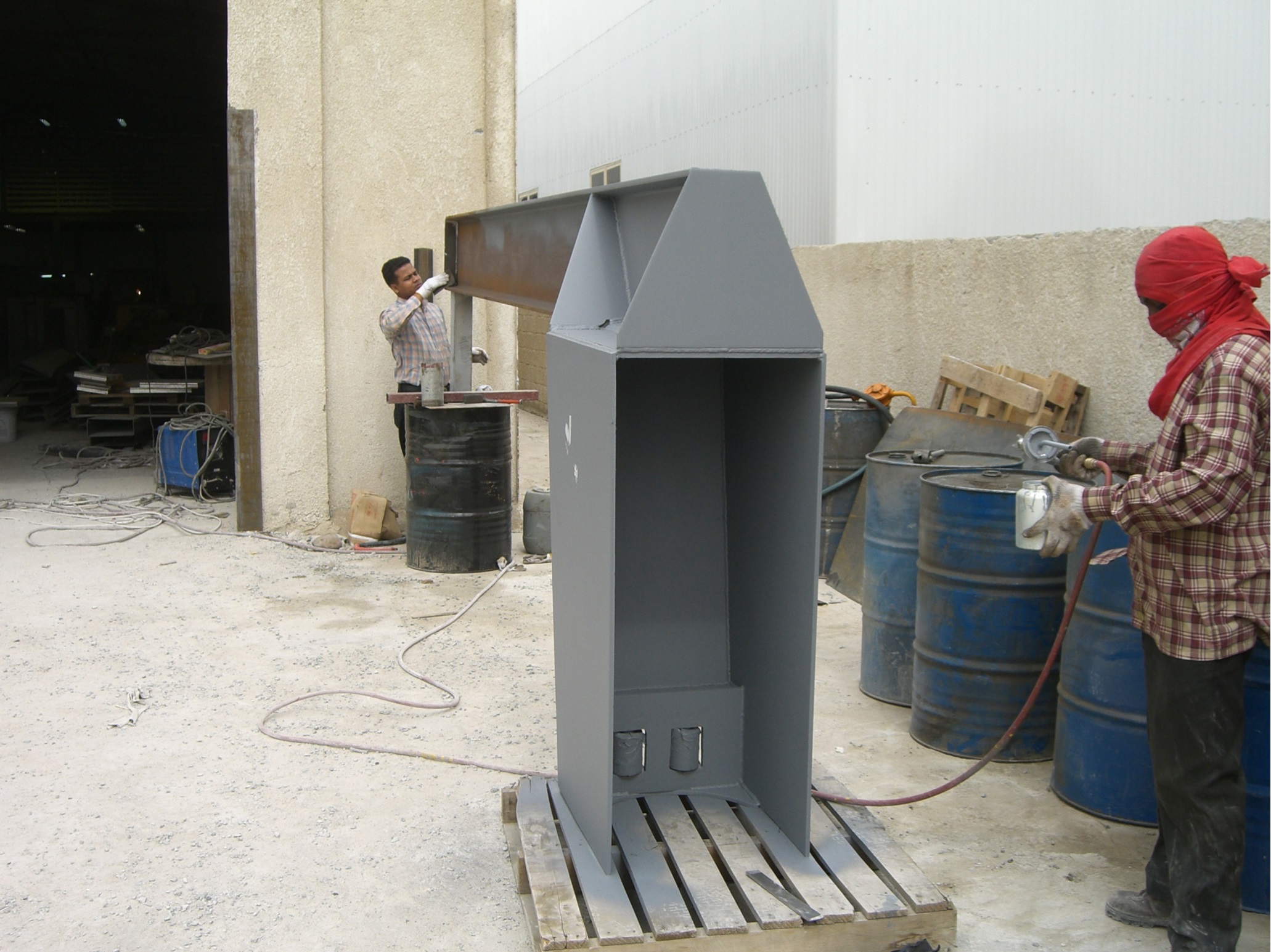

    crane boom ready for paint

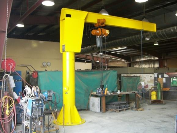

    installed and ready for use
