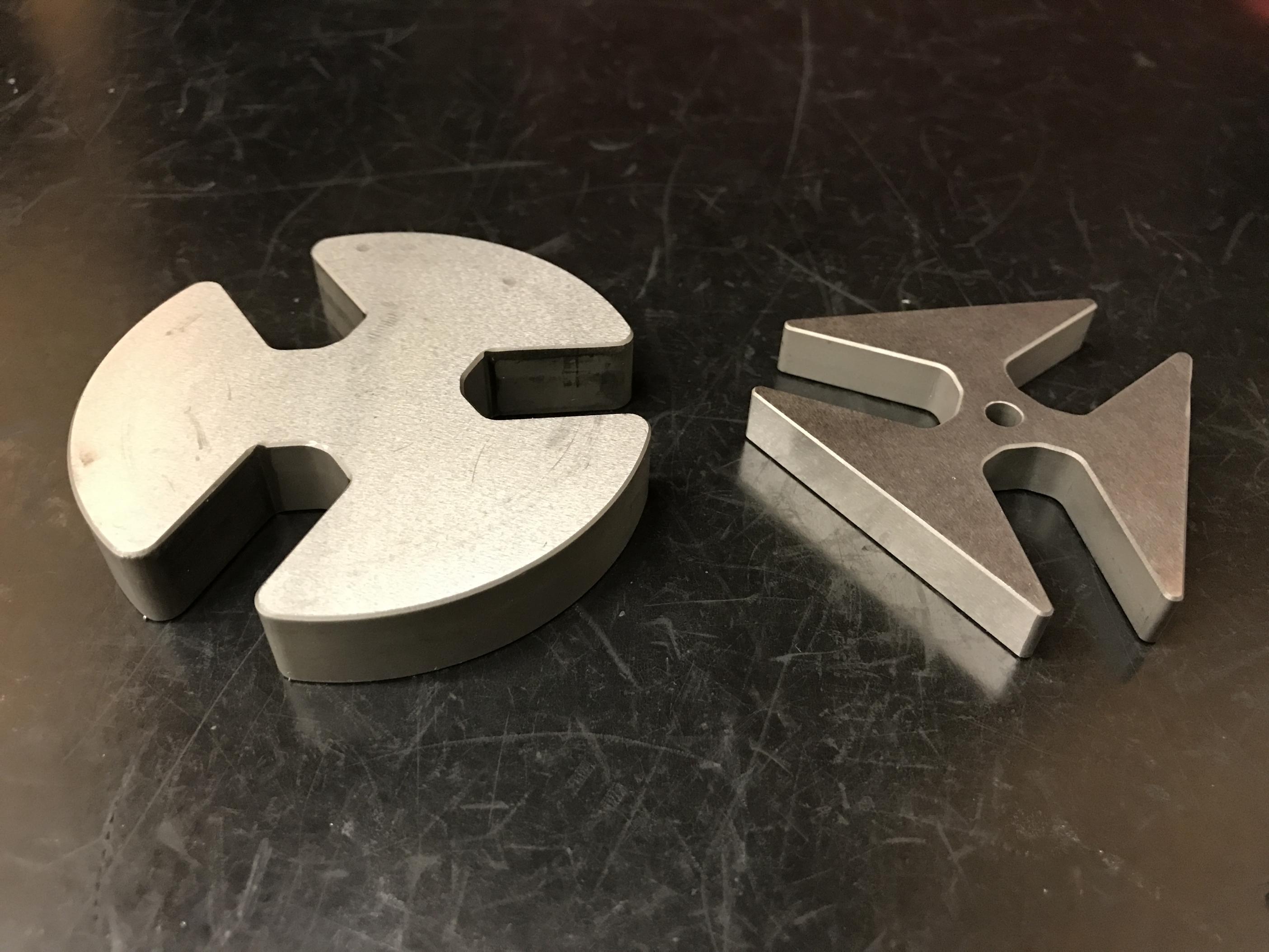

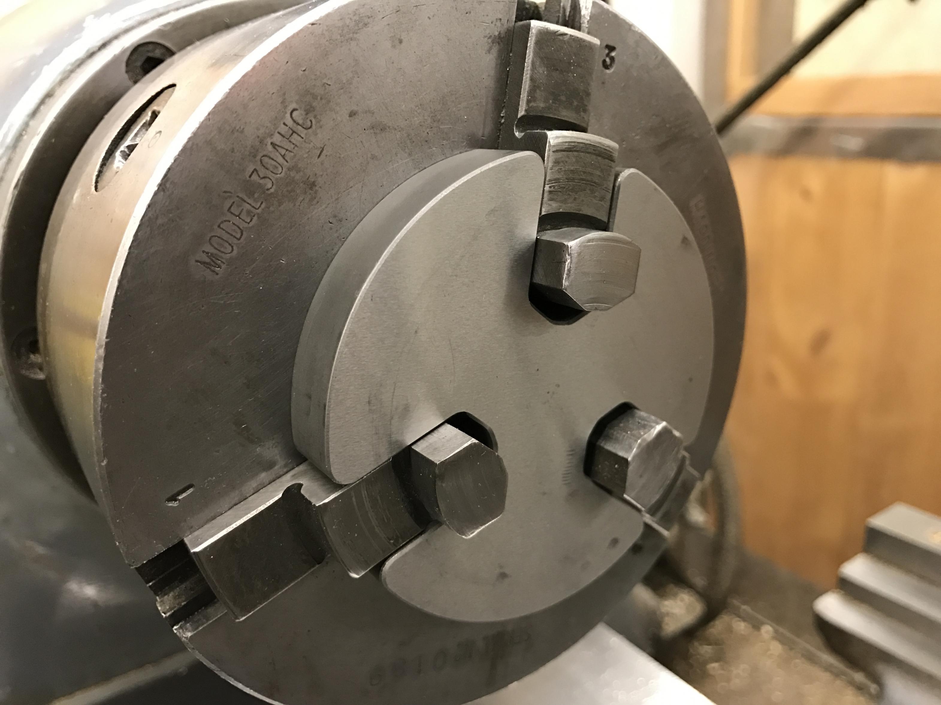

    Here's a couple of spacers/parallels I made for the 3-jaw. Much more convenient than using 3 hands to hold a conventional parallel in place, and you can leave it in place while you turn. Only drawback is a limit to how small a diameter you can hold.

    If you put three holes in the webs of the spacers, you can make spacer plugs to allow you to accommodate workpieces of various thicknesses. See my version in this post...
    http://www.homemadetools.net/forum/shop-gadgets-26297
    for a picture.
    Regards, Marv

    Thanks, that will be a chuck update that I will be doing. Did you have them laser cut?
    All the best David

    Quote Originally Posted by djhart View Post
    All the best David
    No, they were done the old-fashioned way...lay out, drill, mill.
    Regards, Marv
