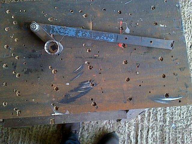

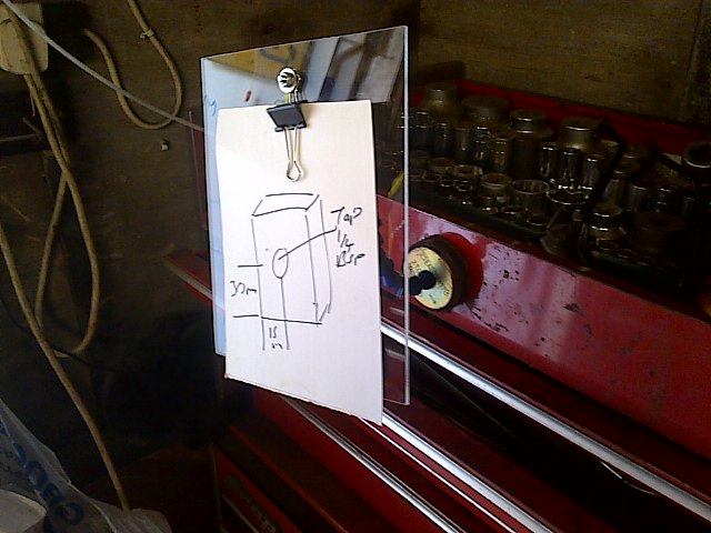

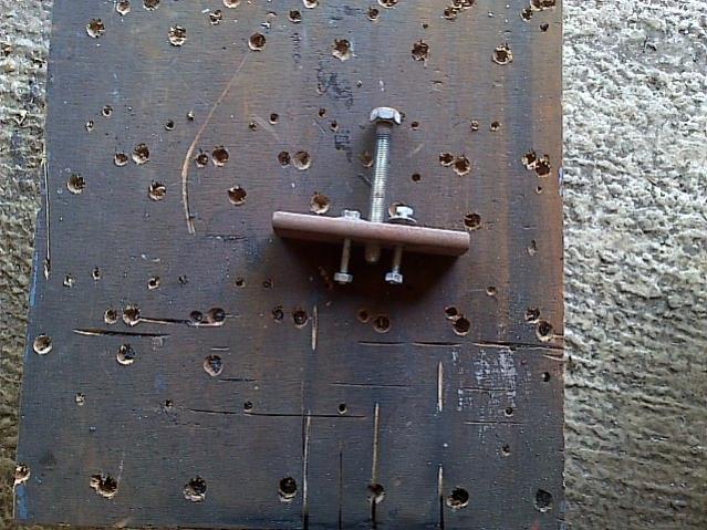

    3 bits
    3 more bits.
    1 is magnetic note holder as tired of getting notes greasy working on the machines.
    2 is steering wheel puller for landrover defender.
    3 is whacker bar made from 1/4" x 1and1/4" flat bar with centre from 1/2" ratchet welded to small pce that pivots.
    allows long pce to be hit with hammer and shock stubborn crank nuts free3 bits-phone-pics-102.jpg3 bits-phone-pics-103.jpg3 bits-phone-pics-104.jpg
