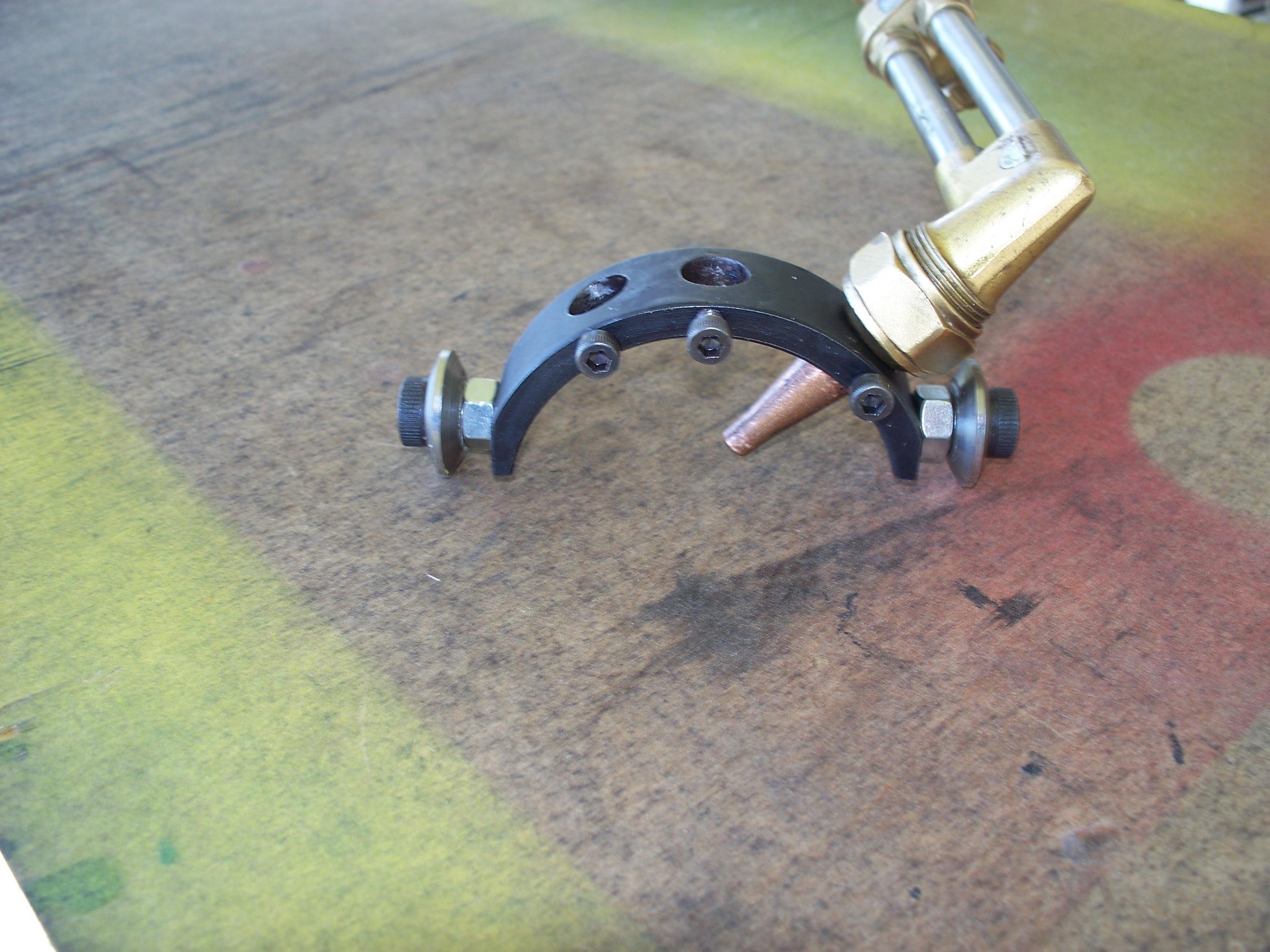

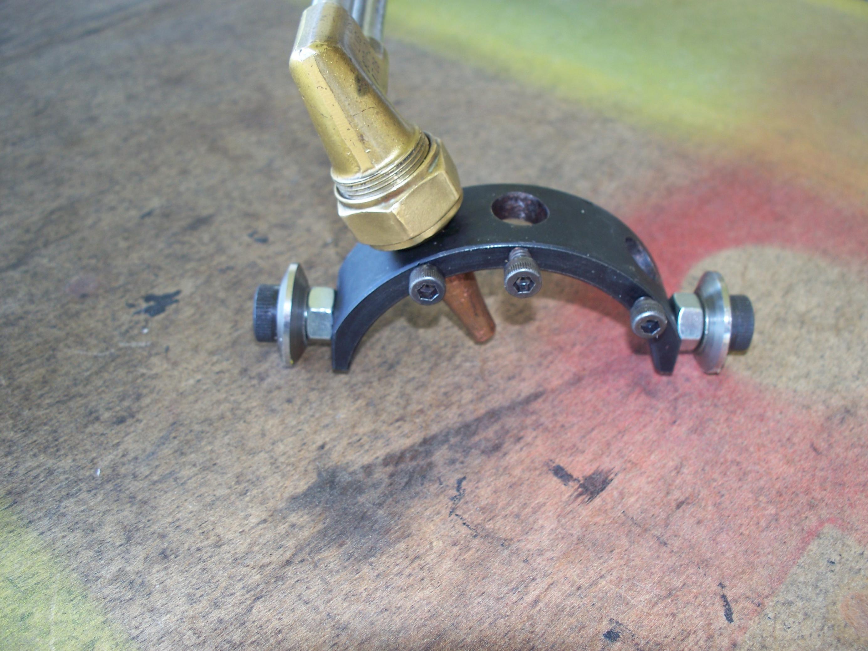

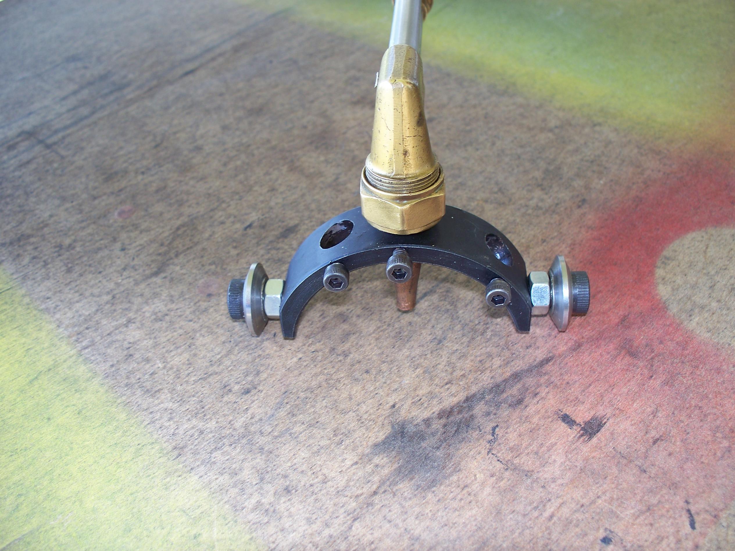

    3 angle bevel attach for Victor 1350 torch
    If you use a Victor 1350 torch, this may interest you. When cutting bevel cuts like 30-45-60 degrees, clamp it on the torch and use a length of angle iron as a straight edge. Works great3 angle bevel attach for Victor 1350 torch-100_2027.jpg3 angle bevel attach for Victor 1350 torch-100_2026.jpg3 angle bevel attach for Victor 1350 torch-100_2028.jpg

    Now that is the nicest angle attachment I have seen. Thanks for posting.
    I'd like to see the angle iron straight edge.
    Ralph

    That's a good design. We have those ones with the sliding adjustments at work. Those allways get loose in use and angle changes, then you tighten the screw ( when its hot ) and next time you use it, its difficult to get that screw opened. This one seems much better.

    Tuomas; I was thinking the same thing I used to have one of those Curv-o-mark guides as well I found them to be fiddly at best The best thing that ever happened for me was when someone borrowed it and never returned it
