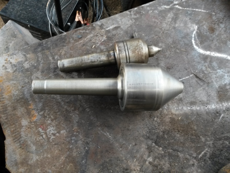

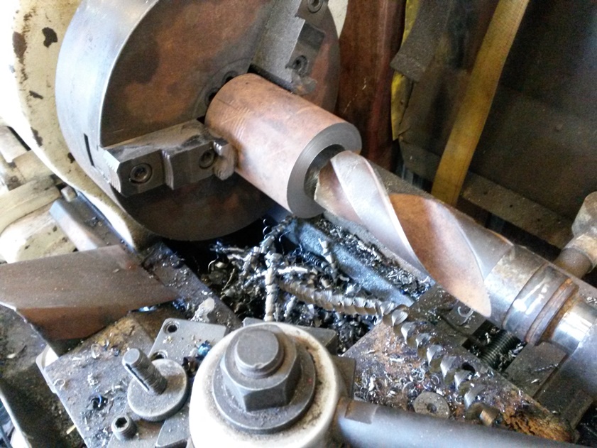

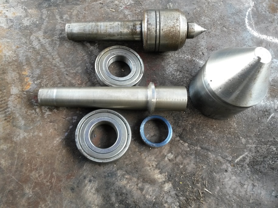

    First I drilled the piece of round stock cut off of a shaft that came out of a cotton gin to 2 " then bored it toe 2.8346 72 mm to accept a pair of 6207 CZ bearings then I machined the cone

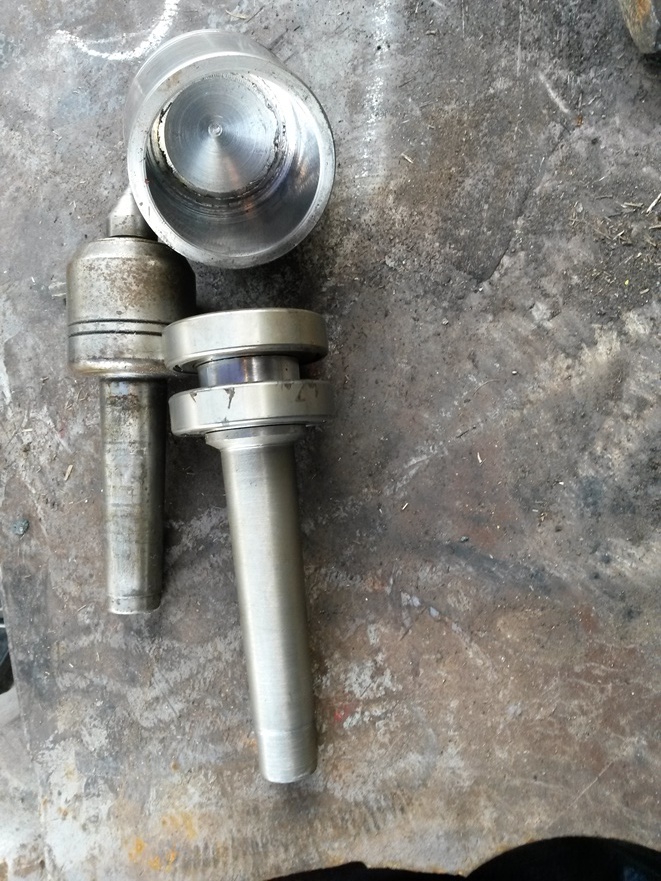

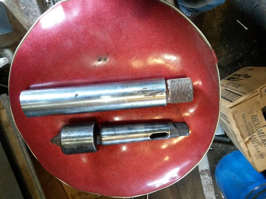

    next I made a mandrel from a piece of 1.75" hydraulic cylinder rod

    I purposely made the mandrel to be easily removed for use in other things of a larger live center cone if need be

    Frank,
    Did you consider using a thrust bearing?
    11,716
    2,228
    12 bolts I had 2 of the 6207s I could swap them out for an angular contact but it would hardly be needed since the size of the bearing are so large 35 mm ID 72 MM OD 14 mm thick with 12 11.1 mm balls No more thrust load that could possibly be placed on them by the tails stock screw there really is no need for a thrust bearing or even an angular contact they have a radial capacity of 31022.750n per bearing and if it were even possible to exert as much as 2224n the bearing life would be 7915 hrs at 1200 RPM
