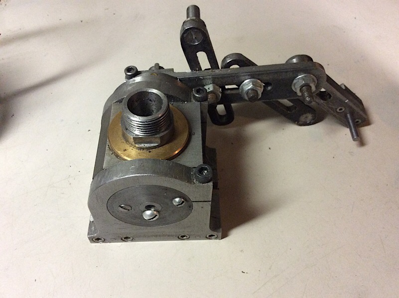

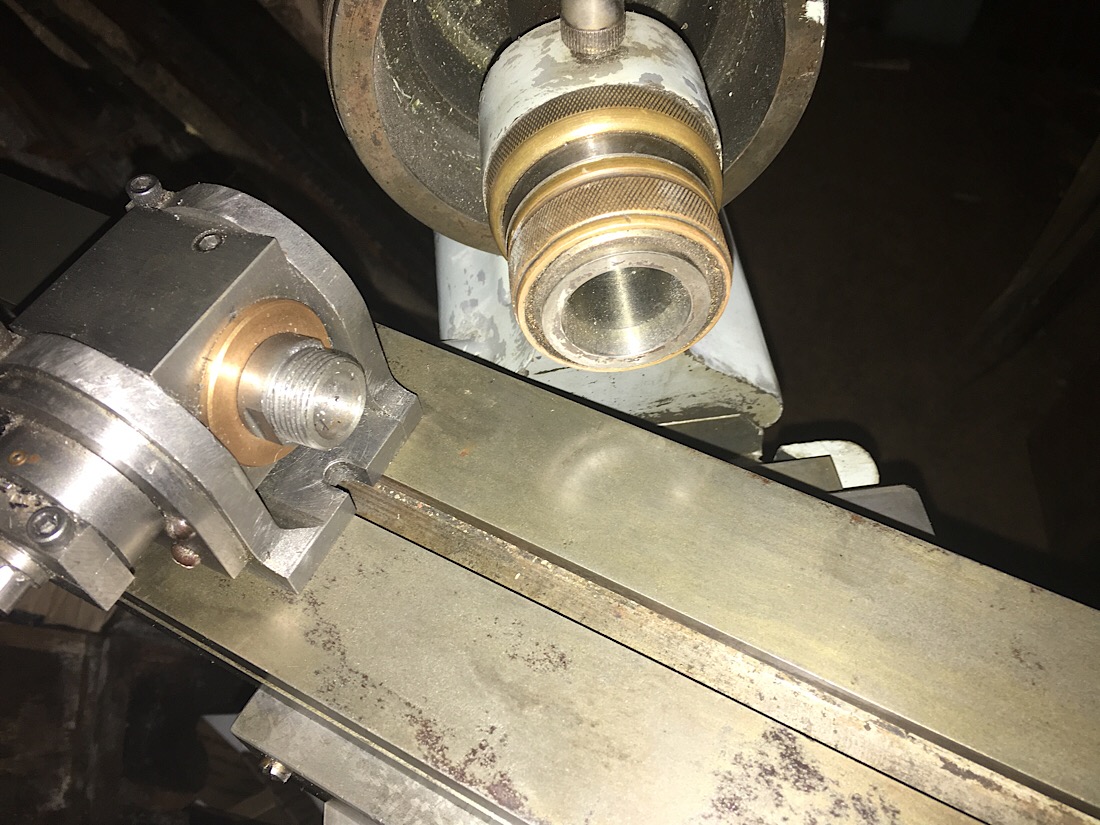

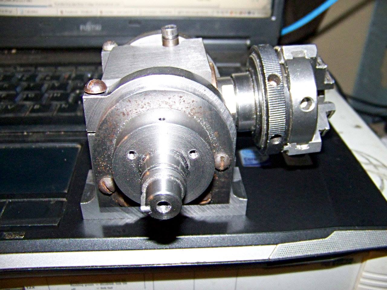

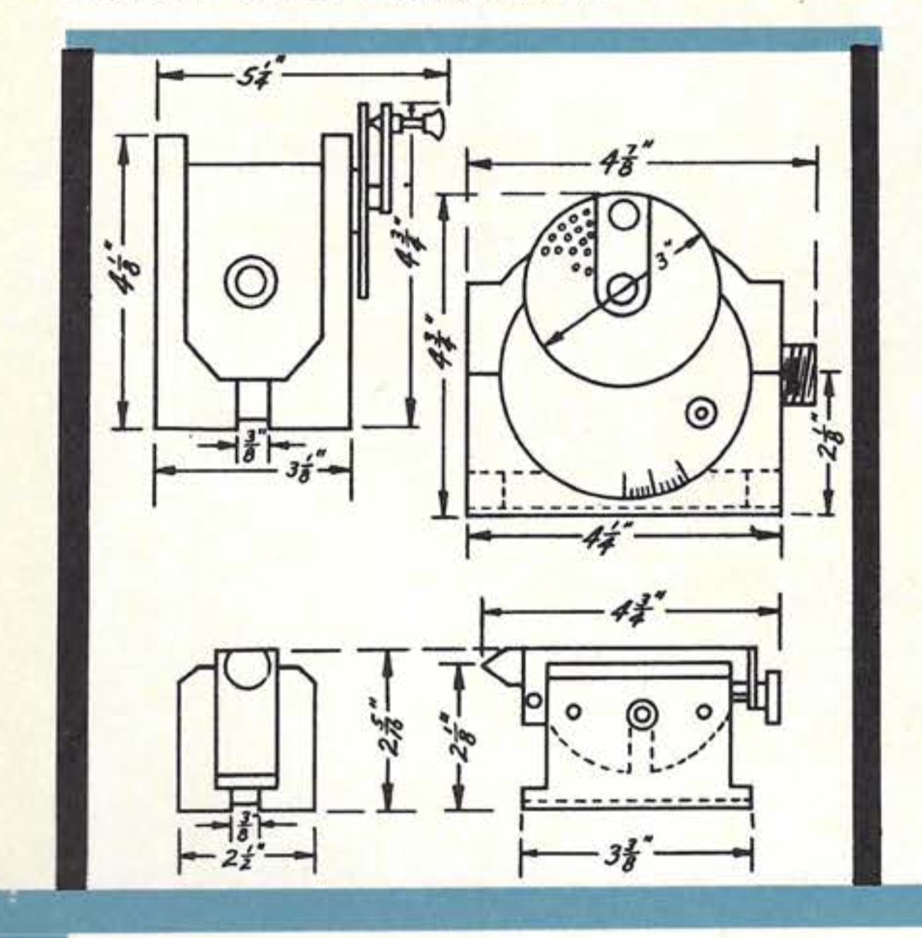

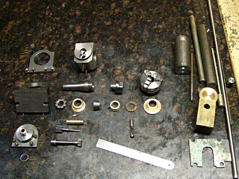

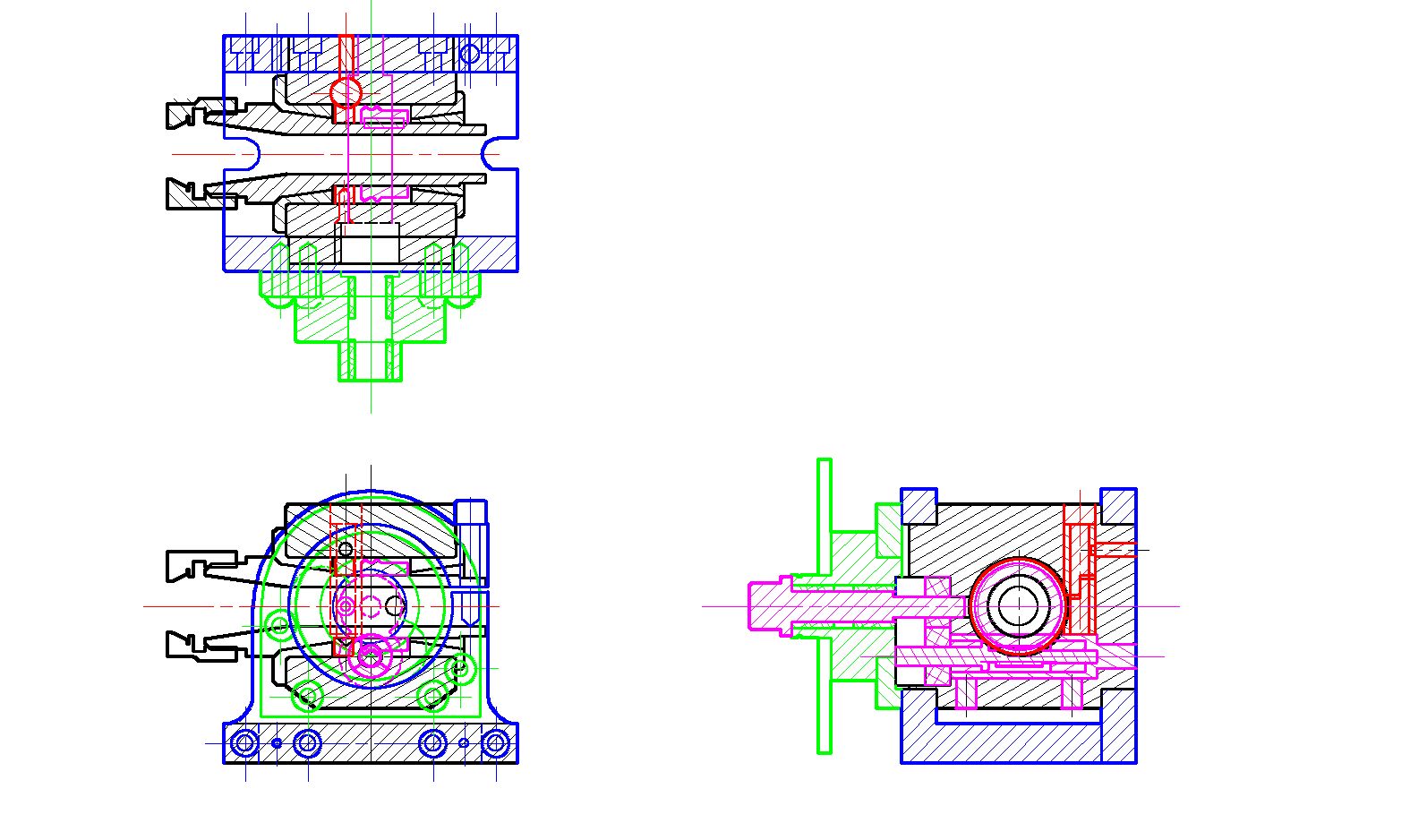

    This dividing head replaces a more delicate one I made from Unimat parts. It combines features from Hardinge and Cincinnati dividing heads but is simpler and a lot smaller.
    Like those, it indexes indirectly, in this case with a 40:1 ratio, or directly by disengaging the worm, and it tilts from about -5° to 90°. It has a brake to lock the spindle, and works with a small adjustable tailstock.
    It’s not universal - the hub for dividing plates is stationary. I mostly just use combinations of change gears to make divisions, though, and figured it will be easier to add stepper motor control than to make tiny parts for a differential feature I might never use.
    It’s about 3 x 3 x 3”. The spindle nose is threaded M22-1.5, with a 16° included taper for ER-16 collets, and has a 3/8” bore. The spindle is prehardened medium carbon steel, and the bearings, worm gear and brake sleeve are bronze; the body from cast iron bar stock, and most of the base is made from a piece of heavy angle iron.

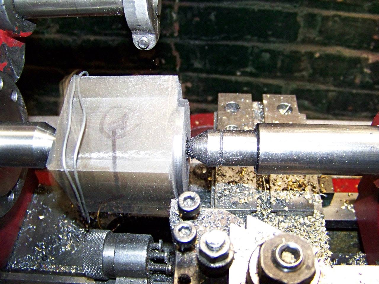

    3-1/4 inch dividing head-dh05_turnbody.jpg 3-1/4 inch dividing head-dh01_cuttingplastic.jpeg
    Turning the hubs between centers, and cutting a timing belt pulley to convert it to stepper drive

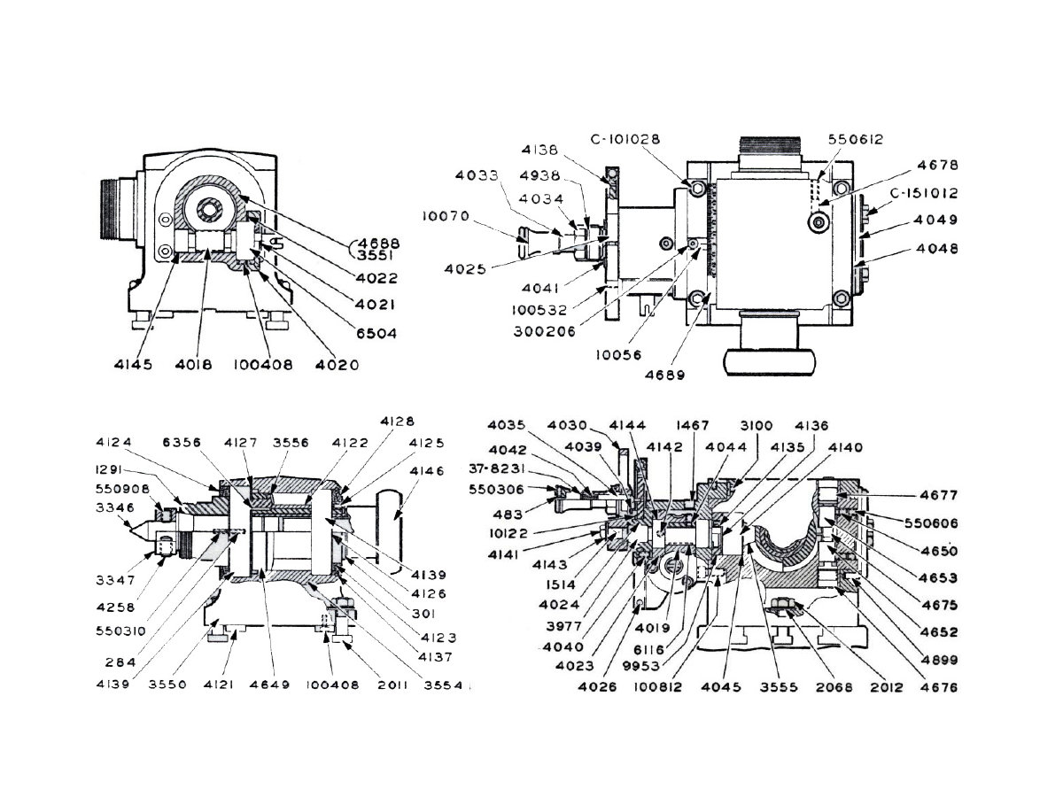

    3-1/4 inch dividing head-dh04_parts.jpg 3-1/4 inch dividing head-dh06_drawing.jpg

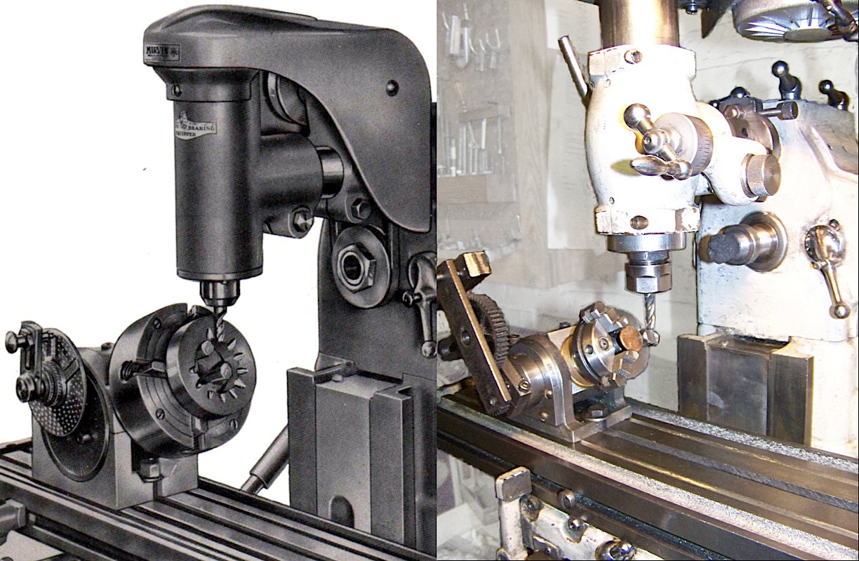

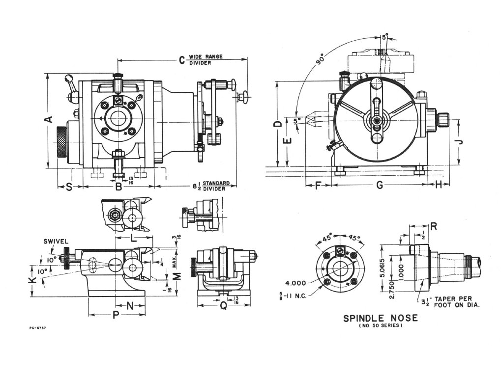

    3-1/4 inch dividing head-dh07_cincinnatidrawing.jpg 3-1/4 inch dividing head-dh08_hardingedrawing.jpg
    Cincinnati, and Hardinge

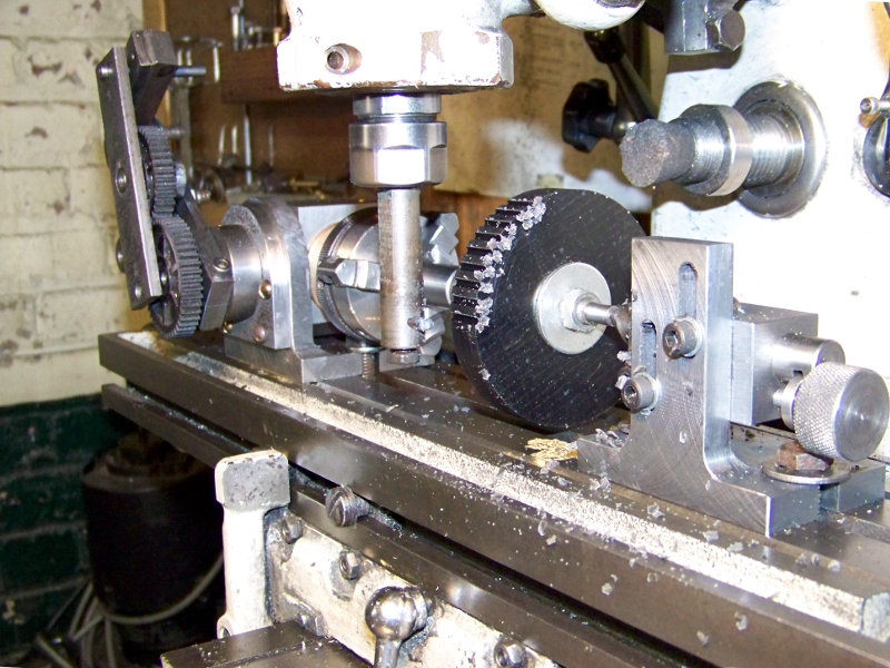

    My guess is if you think it might be too small it probably is.
    ER-16 has been a good match for my underpowered, limited travel machine tools. I use it for holding tools and work, or at least arbors for it. Along with the dividing head and a couple Unimat-compatible quills I made, both the vertical, and horizontal (with a 2MT adapter, and a cork in it, in the action photo above) spindles on my Atlas mill take it. To save even more space I made and modified some accessories like the cheap 3-jaw scroll chuck in the first picture so I can screw them onto the threads.

    I showed this before, but this is what all the weird parts are for in the rear view of the dividing head above.
