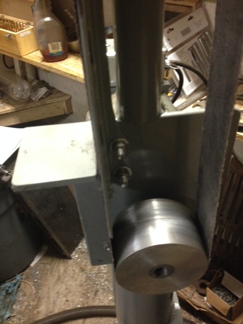

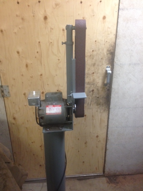

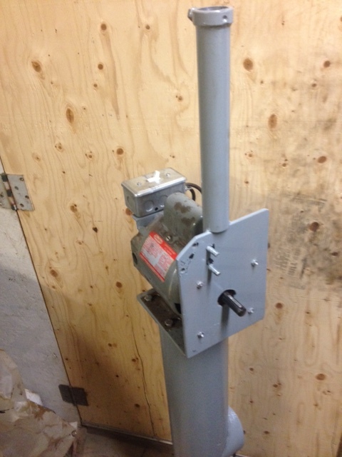

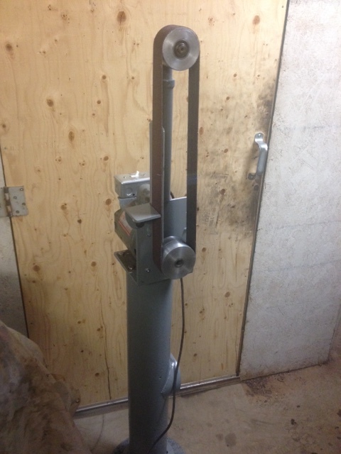

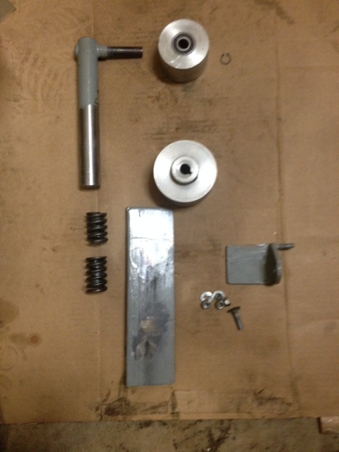

    This is my 2x48" belt sander I just made. The wheels I turned on the lathe from blanks I made from melted down aluminum scrap. The motor I got at an auction for $5.00. I bought the belts on Amazon. Everything else I had in stock.

    I'd love to see more detail.

    Probably a closeup of how you put it together

    I added a couple of photos

    Thanks for the extra images athomp, they explain it nicely.
