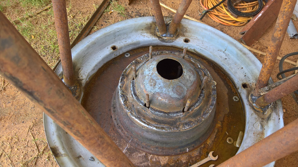

    Ok 28" tractor rim salvaged from my 8n
    the bottom of the forge is a 26" diameter 1/4" plate the previous property owner used as a lid for his burn barrel
    the legs were taken from my stock of 100s of salvaged sprinkler down pipes
    the apron was made out of a piece of auction scrap I bought years ago
    that is the basic list of materials for the forge itself More about the toyere later

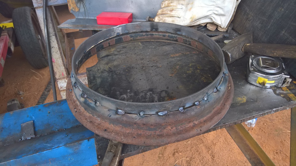

    It seemed like a good idea to remove the rotted out band
    28" wood / coal forge build-wp_20200517_15_50_14_profor.jpg

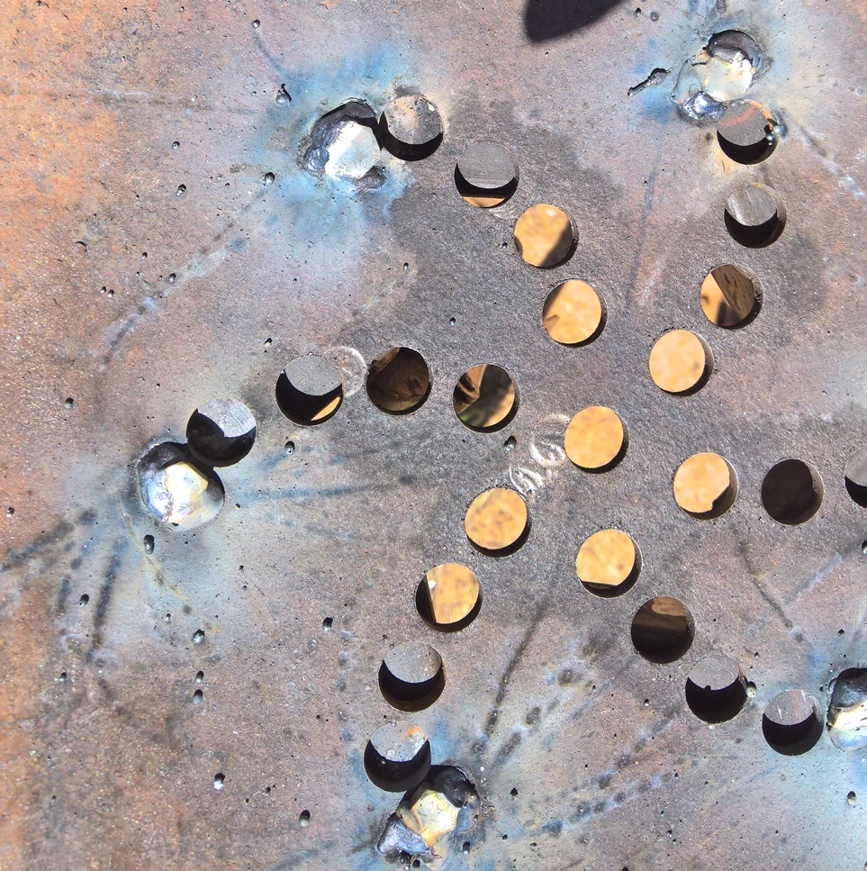

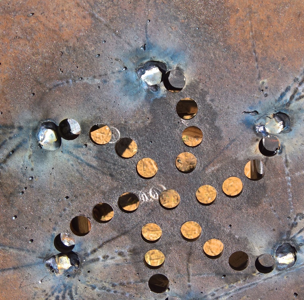

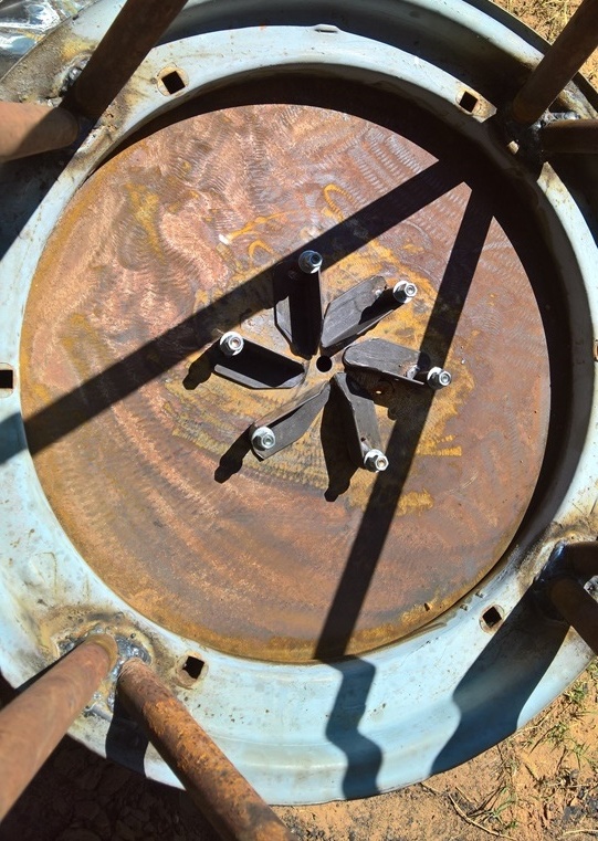

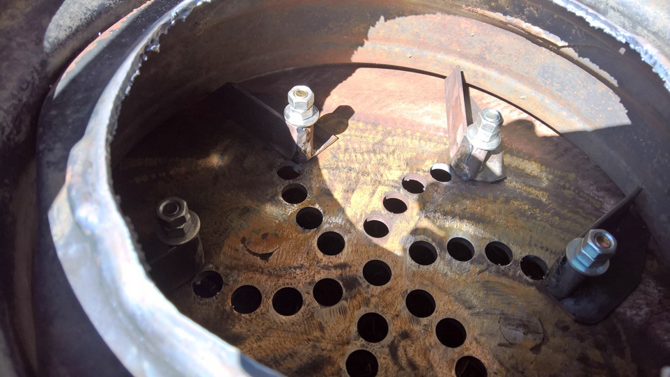

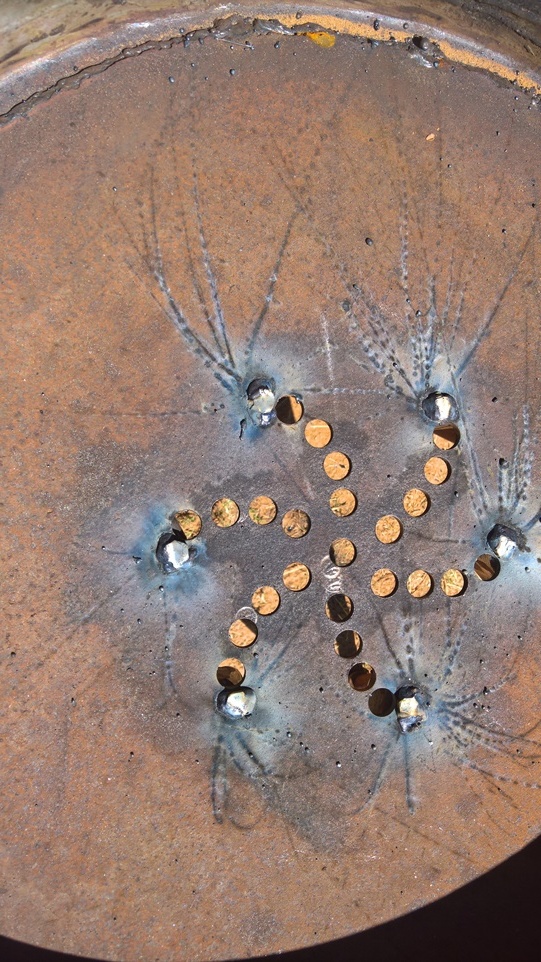

    drilling the air holes for the toyere I decided that I wanted an iris for air control and flame modulation this is why the holes are drilled in a spiral
    28" wood / coal forge build-wp_20200519_12_50_16_profor.jpg
    Shown here the iris is closed leaving only a single hole exposed
    28" wood / coal forge build-wp_20200521_16_01_55_profor.jpg
    Open phase 1
    28" wood / coal forge build-wp_20200521_16_02_29_profor.jpg

    Open phase 2
    28" wood / coal forge build-wp_20200521_16_03_16_profor.jpg
    open phase 3
    28" wood / coal forge build-wp_20200521_16_04_03_profor.jpg
    full open
    28" wood / coal forge build-wp_20200521_16_04_58_profor.jpg
    the blades of the iris are made from bed frame angle left over from the battery box hold down project
    28" wood / coal forge build-wp_20200521_16_26_08_profor.jpg

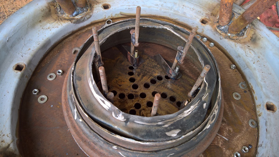

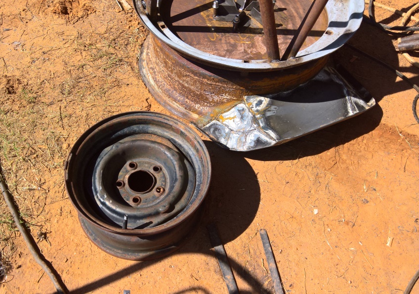

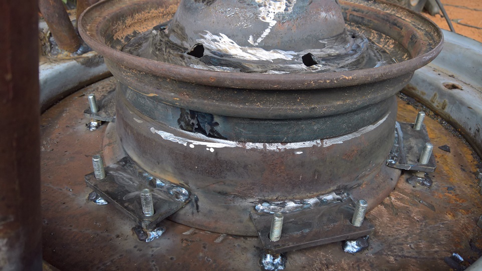

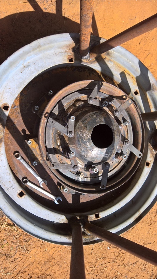

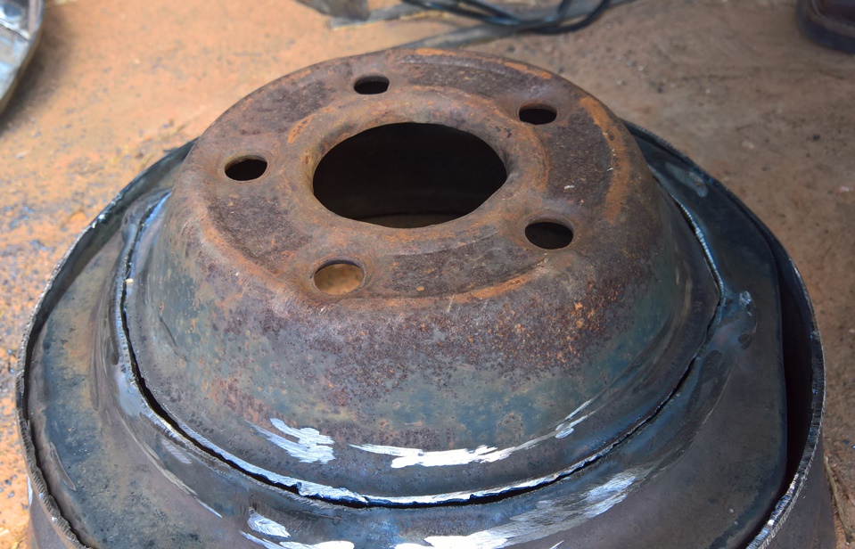

    The main body of the toyere will be this 14" car rim
    28" wood / coal forge build-wp_20200521_16_36_13_profor.jpg

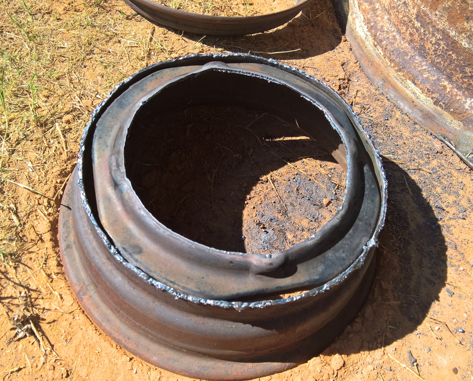

    with the center removed the iris blades open all the way to the edge of the rim when fully opened
    28" wood / coal forge build-wp_20200521_16_41_03_profor.jpg
    I really should clean the torch tip shown here the second bead of the rim is removed
    28" wood / coal forge build-wp_20200521_16_47_40_profor.jpg

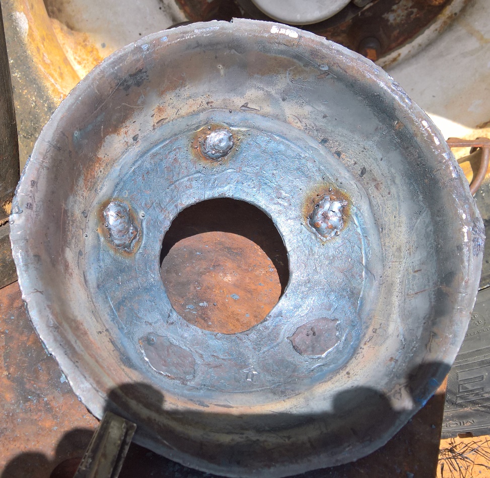

    the center is placed upside down
    28" wood / coal forge build-wp_20200522_15_34_20_profor.jpg

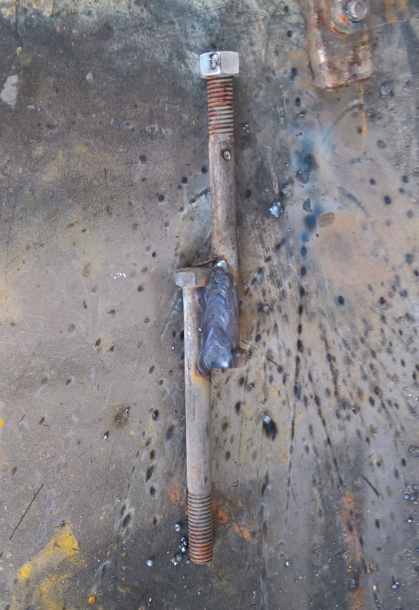

    Requiring a way to open and close the iris blades I selected these used bolts and welded them together to give me the offset I needed to make them center over the pivot of the blades
    28" wood / coal forge build-wp_20200523_11_05_46_profor.jpg
    showing the control rods welded to the iris blades
    28" wood / coal forge build-wp_20200523_12_19_39_profor.jpg

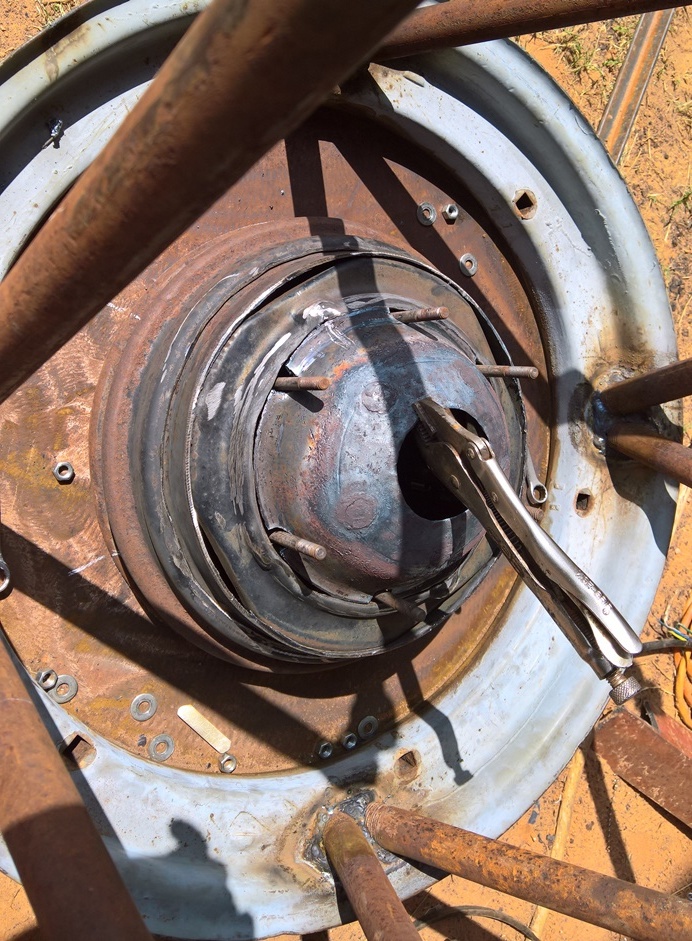

    showing how the center is going to be fitted over the control rods
    28" wood / coal forge build-wp_20200523_12_21_02_profor.jpg

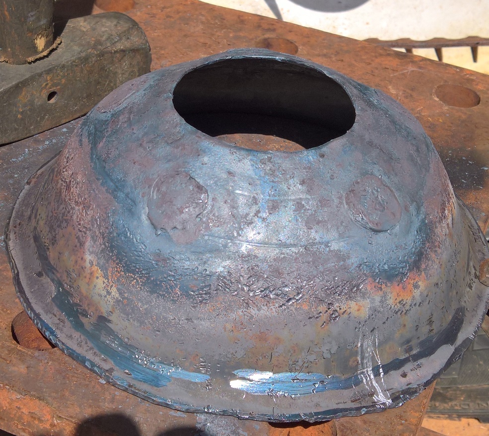

    Hammering out the center on Moilneer (Thor's hammer) the name given to what I use for an anvil by my wife
    28" wood / coal forge build-wp_20200523_12_43_36_profor.jpg

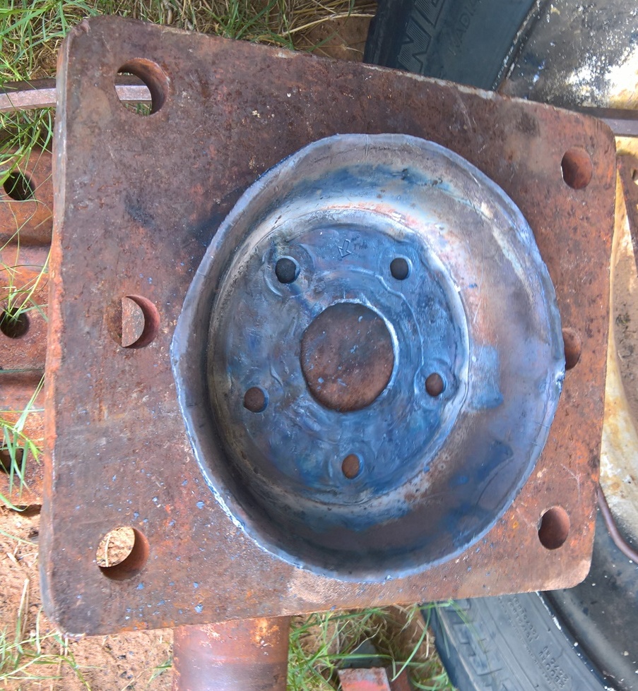

    the lug hole welded up and the cone shape started for the center of the toyere
    28" wood / coal forge build-wp_20200523_15_51_25_profor.jpg
    final shape
    28" wood / coal forge build-wp_20200523_16_00_26_profor.jpg

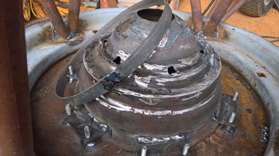

    So far not getting much done today

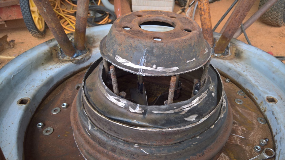

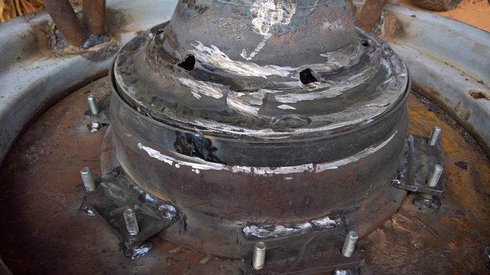

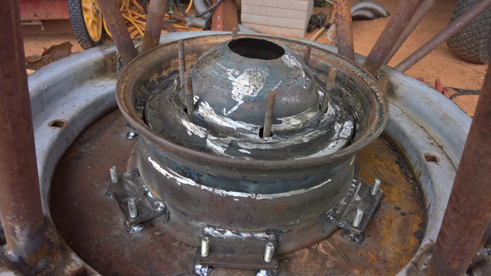

    Have the cone welded to the toyere housing and the slots of the rim welded up where the center piece was riveted to it. Everything is roughed together and before I can go further to tube around the iris blade control stems I need to make the bolting clamps to hold things in place then it is all about some much needed clean up to the welds
    Initial fit up
    28" wood / coal forge build-wp_20200523_16_12_05_profor.jpg
    welded up
    28" wood / coal forge build-wp_20200524_11_24_34_profor.jpg

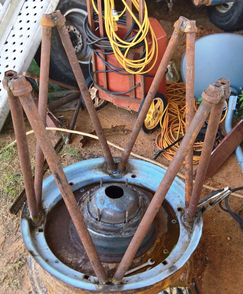

    this pic shows a better view of the legs there will be some bracing but this can not be done until I have completed the toyere and the iris controls
    28" wood / coal forge build-wp_20200524_11_24_43_profor.jpg

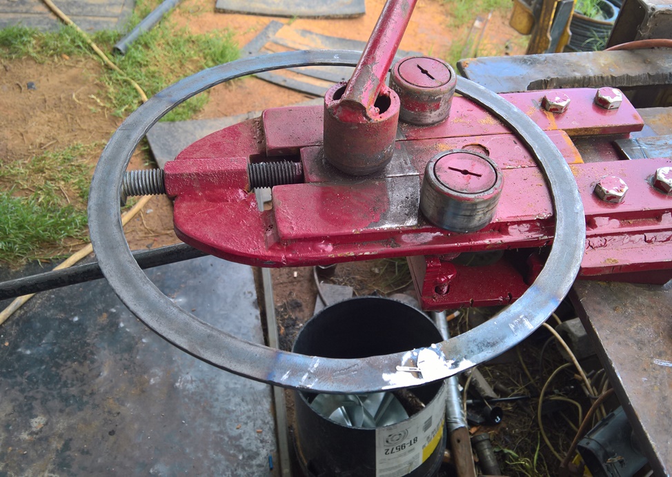

    quite a bit of progress today all things considered

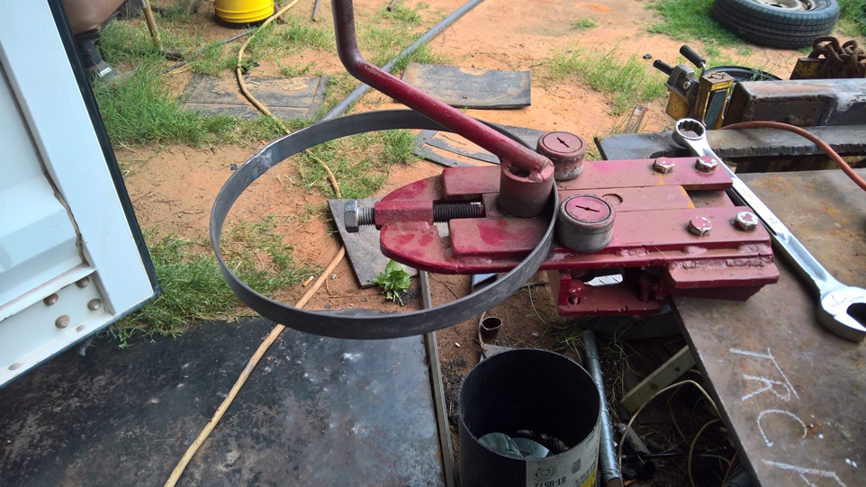

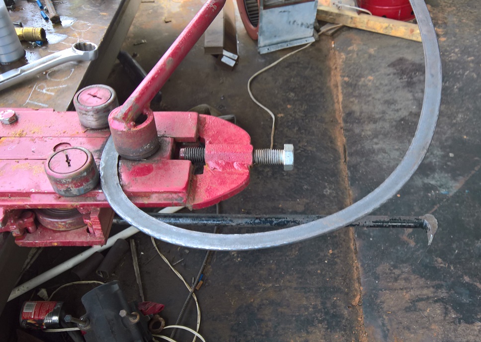

    First off I had to make a retaining ring for the iris blade control disk
    the retaining ring is 1/8 by 3/4" flat bar bent the hardway. I used my bender roller to accomplish this
    Bender roller combo
    28" wood / coal forge build-wp_20200525_10_15_38_profor.jpg
    28" wood / coal forge build-wp_20200525_11_02_57_profor.jpg

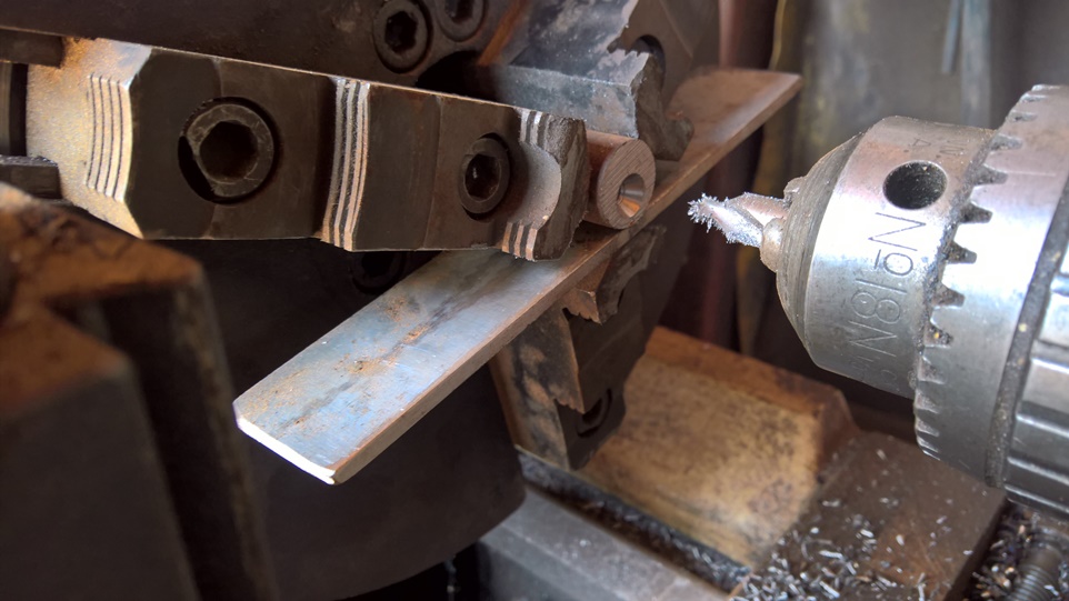

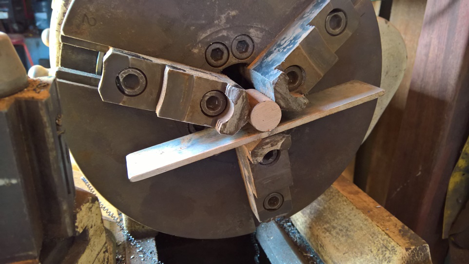

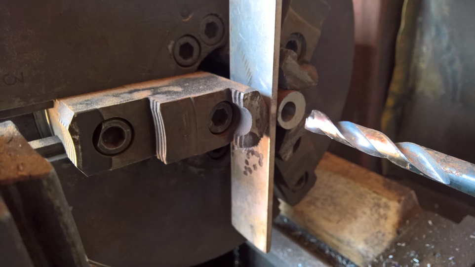

    setting up for offset drilling of the iris blade stem support sleeve
    28" wood / coal forge build-wp_20200525_12_58_14_profor.jpg
    28" wood / coal forge build-wp_20200525_12_59_11_profor.jpg
    28" wood / coal forge build-wp_20200525_13_00_32_profor.jpg
    the retaining ring the stem supports and the control linkages are now in place
    I just have to weld on some bolts to the control disk then make a flange and "T" for the air supply and the cleanout of the toyere then the underside will be pretty much done
