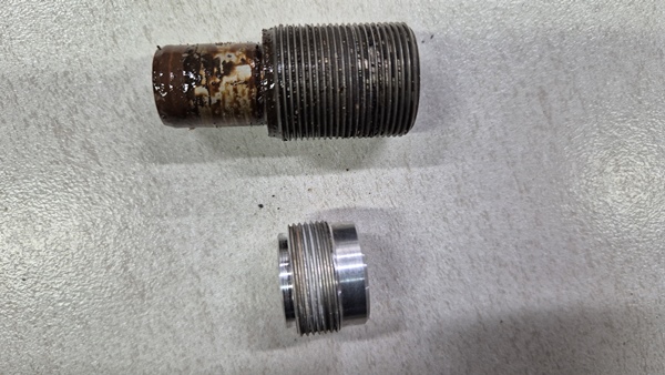

    I repair motorcycles for a living, and recently has to remove a gearbox from a BMW R1150GS. The swingarm, which houses the driveshaft, pivots inside the aluminium gearbox casing. Unfortunately, whilst removing the pivots, one of them went threadbound and ripped the thread in the casing.
    This necessitated making a 27mm 1.25Pitch tap, and a jig to make sure the repair was straight and inline with the opposite side. I started off with a 30mm piece of EN36.

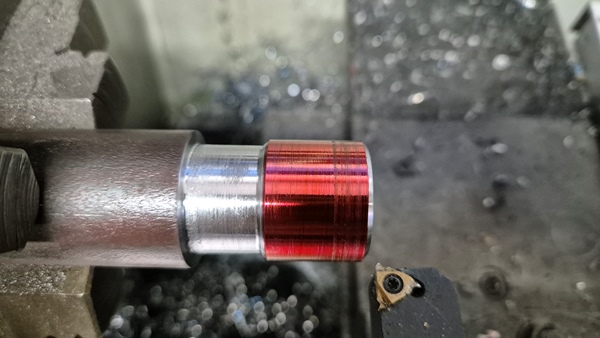

    Added some marking dye

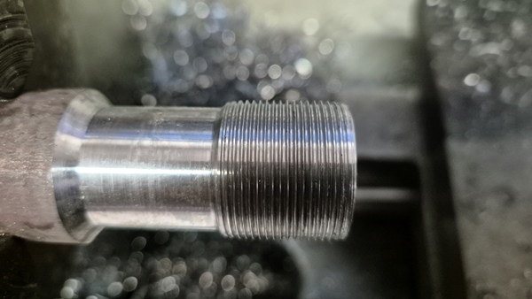

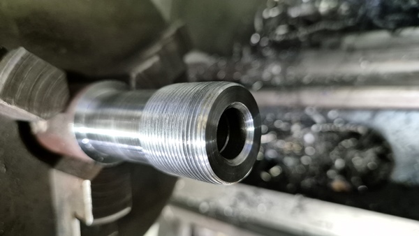

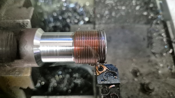

    And single pointed a 1.25mm pitch thread.

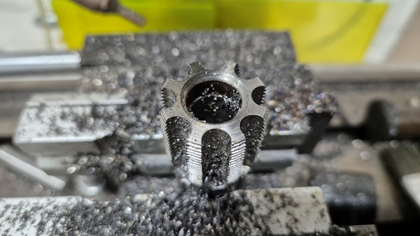

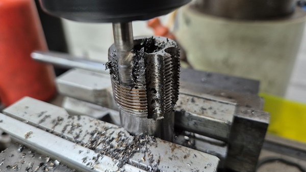

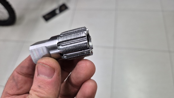

    Then took it over to the milling machine for a few flutes.
    8 in total

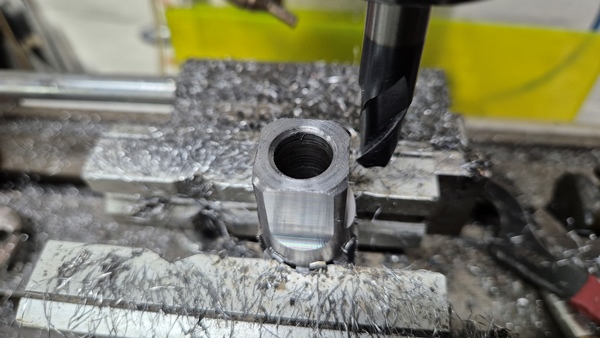

    Then flipped it over to cut a square on the back end

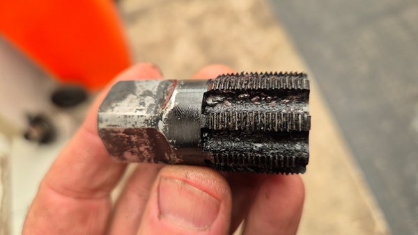

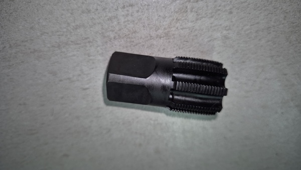

    Done
    Looks a bit messy after the heat treat, but nothing a scotchbright wheel cannot solve

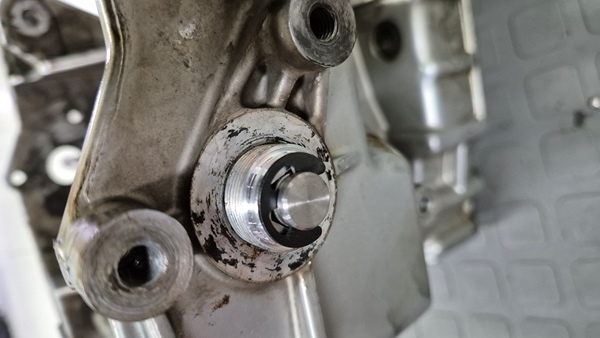

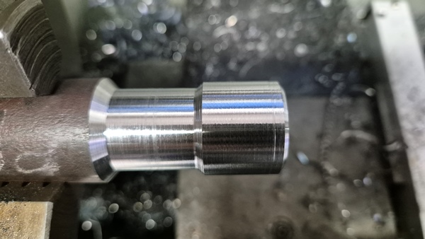

    Then made a small guide adapter for the opposite side from and old buggered pivot
    And finished of with a 12mm stainless guide shaft.

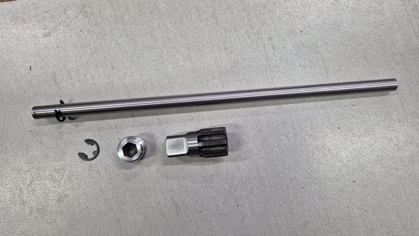

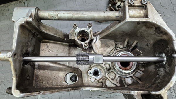

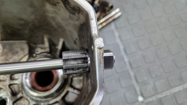

    So it works like this
    The guide adapter screws into the LHS pivot hole and accommodates one end of the 12mm shaft

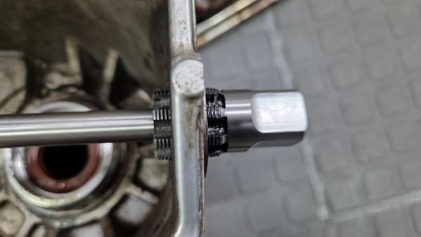

    The newly made tap slides on the guide rod and is used backwards and exits the hole on the RHS, repairing the thread as it goes. This ensures that the thread is exactly in line and there is no chance of cross threading it, which is very easy with such a large (26mm) tap.
    And with a little black added.
