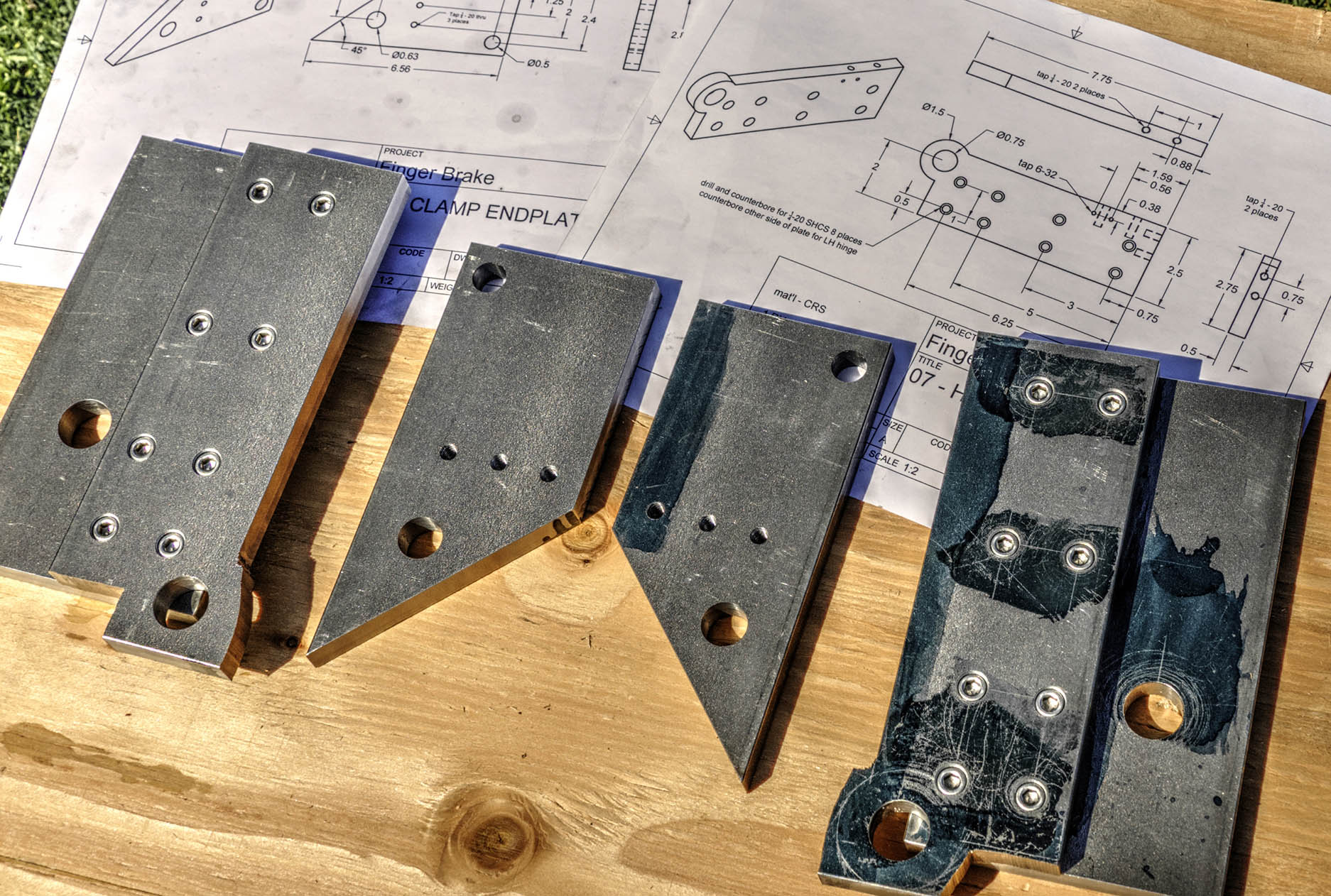

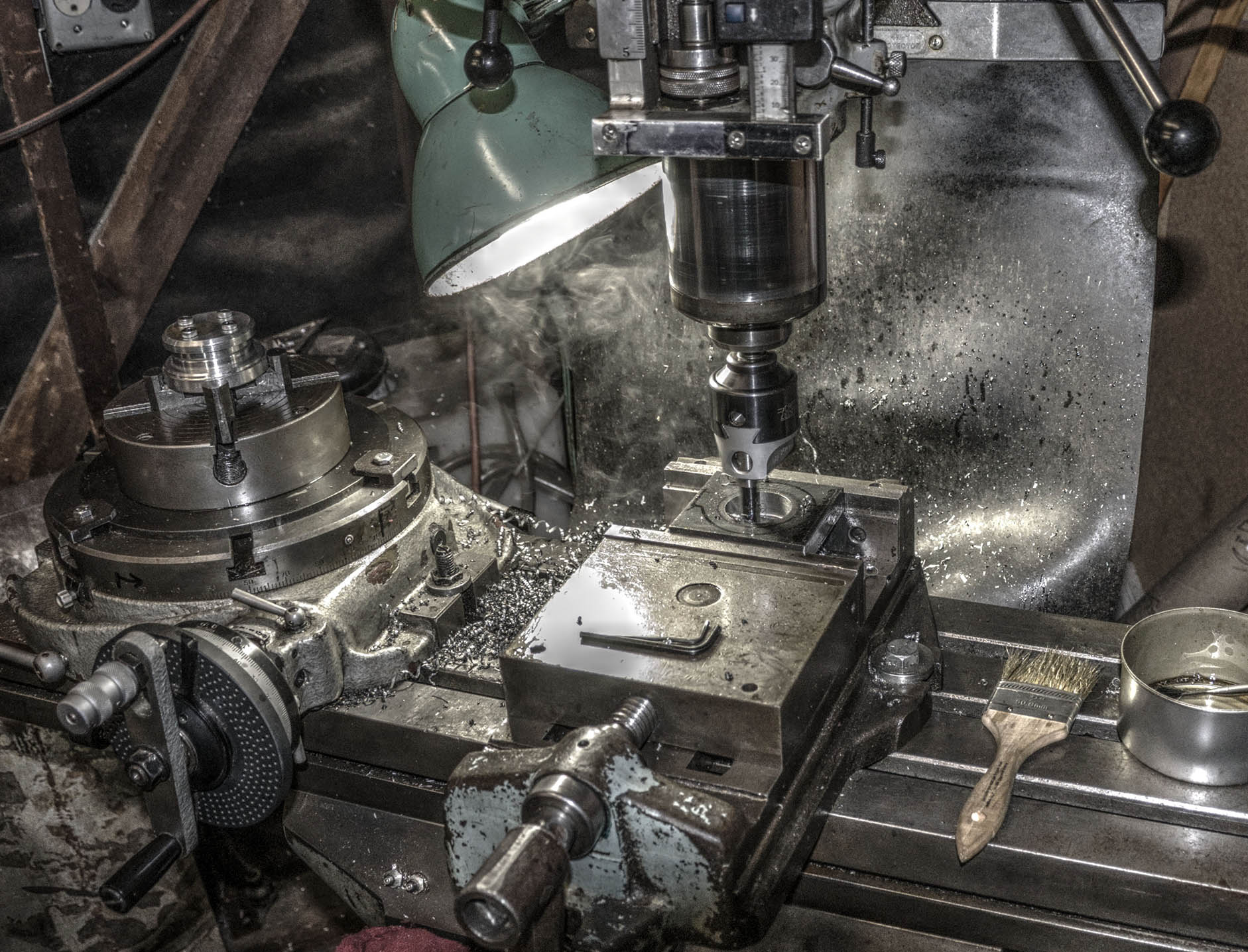

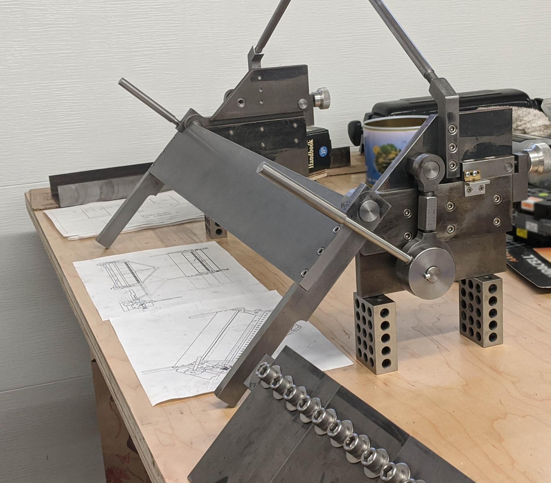

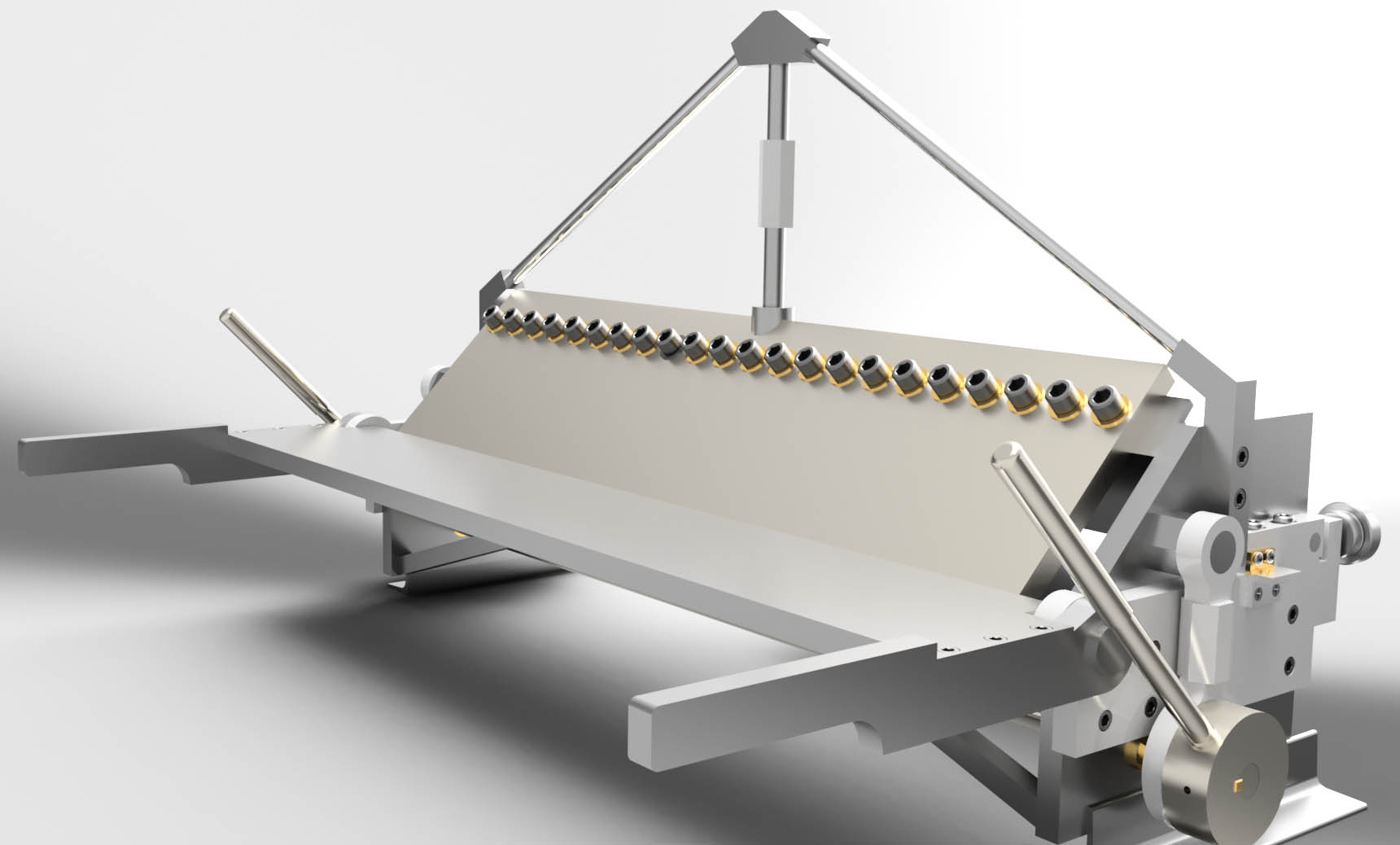

    I found a few build photos for this project.
    Matt

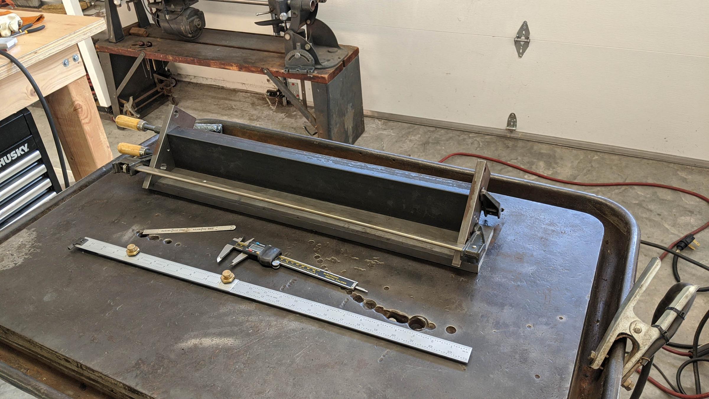

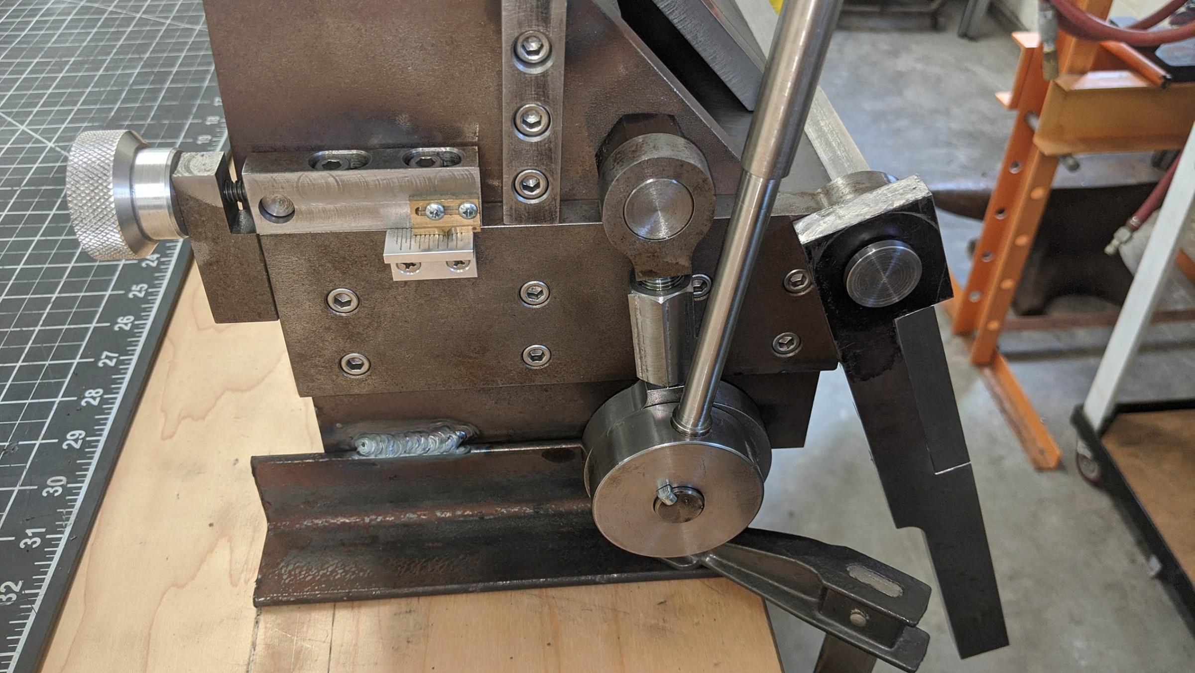

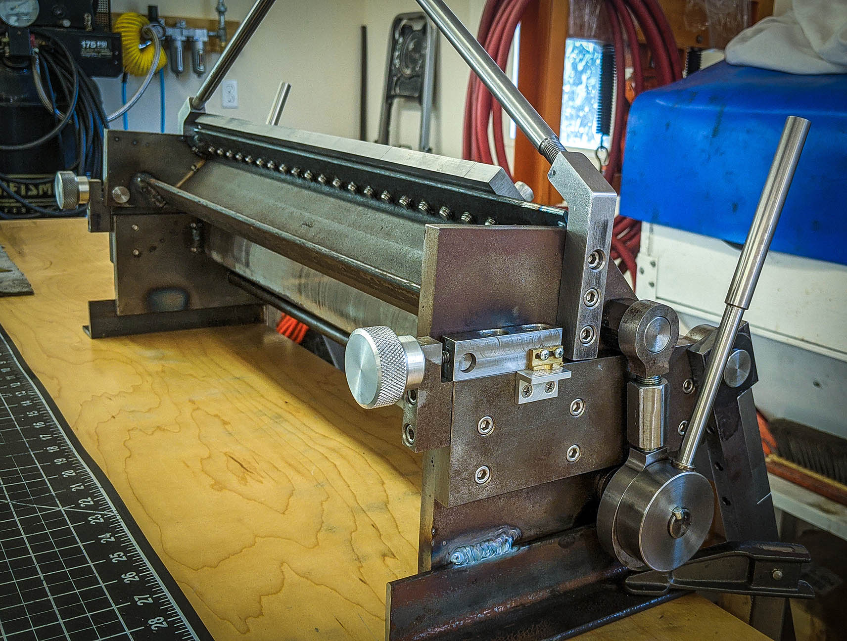

    Here are a couple more...

    I just fell short of submitting as next of kin to be added as beneficiary to your estate; seeing that 24" hook scale..
    Until stair gauges holding TWO rules together became apparent .
    Did you notice the HF calipers wrapped with electrical tape?
    Matt

    Quote Originally Posted by Inflight View Post
    Matt
    Well, noticed of course. But nondescript compared to world's only 24" hook rule.
    I was all ready to send a fat check. In today's liberal climate, I've adopted an identity of a millionaire. However, my bank statements disagree...
    No joke. Something happened, long narrow [1/4"] tape measures used to be common. I have a little side gig working in a pump shop. When boring and facing shaft or bearing sleeves, lengths aren't so critical. A nice scale or tape marked in 32''nds is ideal, most are called out to + or - 1/64th. And a hook rule unhooks easier in a narrow bore!

    Just looking at the brake design, the truss tensioner appears to act directly on one of the fingers... is that correct? If so, I would think the design could be improved by adjusting that so the truss acted on the mounting plate for the fingers, and the fingers were shorter at the top and located against a raised ledge (either a machined step, or a piece of 10x10mm bar welded to the mount).
    or am I overthinking it?
