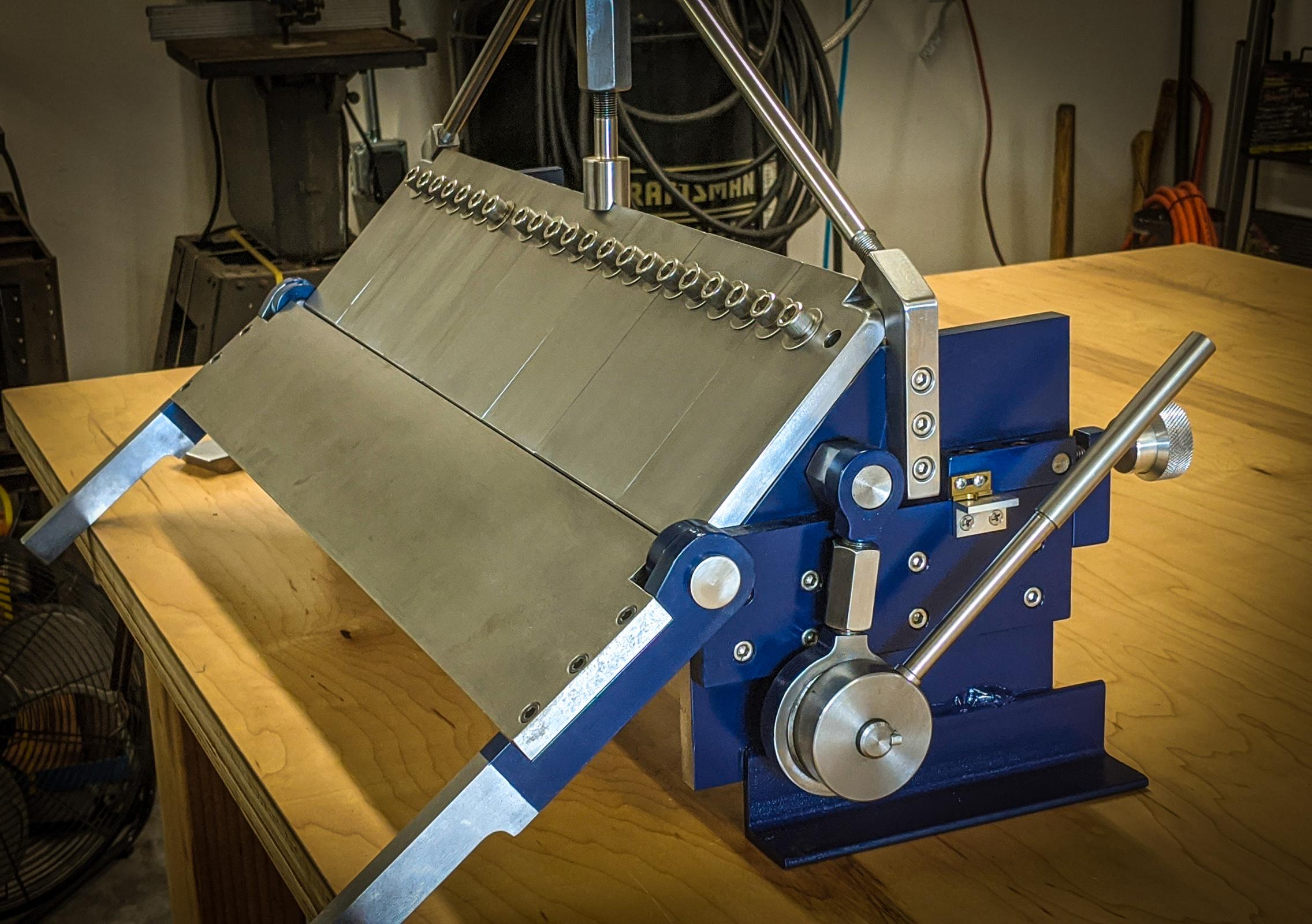

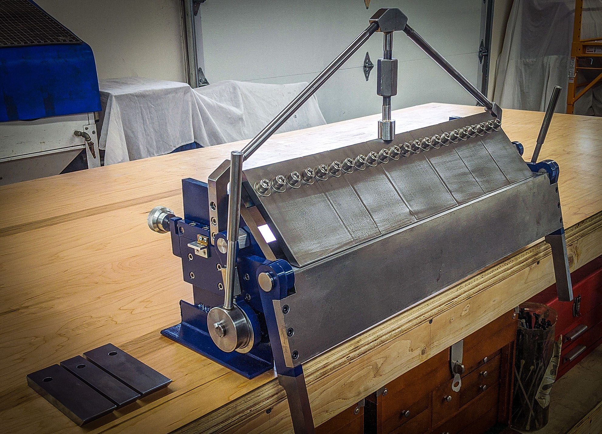

    I finally completed my build of the 24 inch brake from plans by Michael Ward and published in HSM a few years ago. So far I have bent 16ga aluminum at full width with no difficulty.

    5,338
    7,048
    I haven't seen the HSM blueprints, but it appears a solid design, certainly with all the correct features. The truss rod and respective hardware are especially nice. What is the gauge capacity at full width, and there provisions for extension handles on apron?
  16. #10
    Supporting Member Inflight's Avatar
    Dec 2018
    76
    214
    Thanked 88 Times in 40 Posts
    Inflight's Tools
    The designer wrote that the brake will handle 20 gauge steel at full width. The handles are rectangular so it would be easy to bolt on extension arms if more leverage is required. With 16 gauge aluminum, the handles were fine as is.
