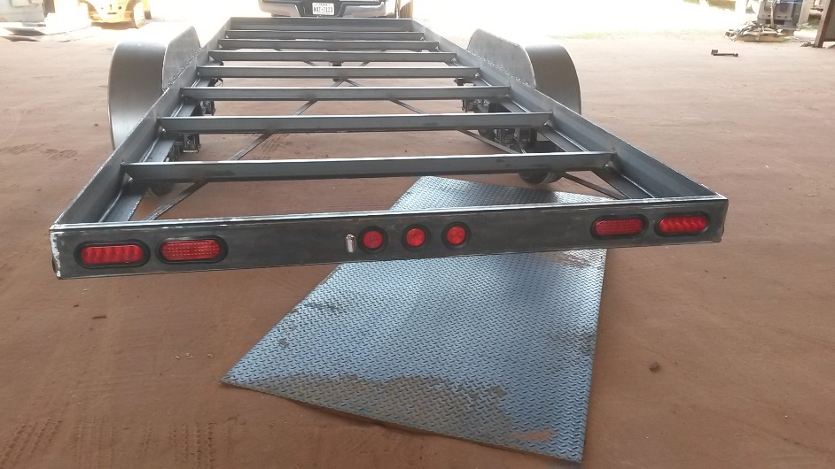

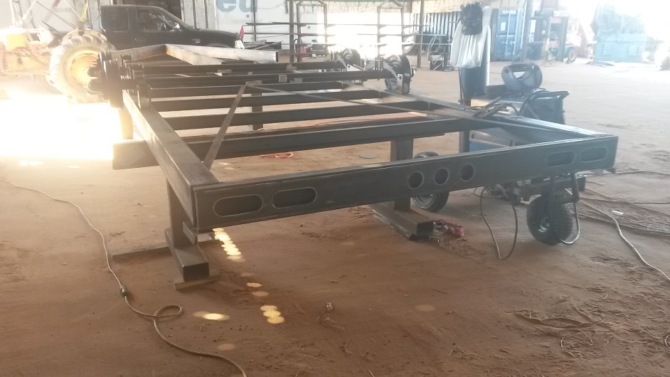

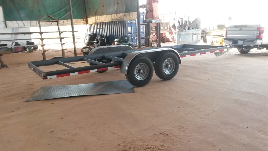

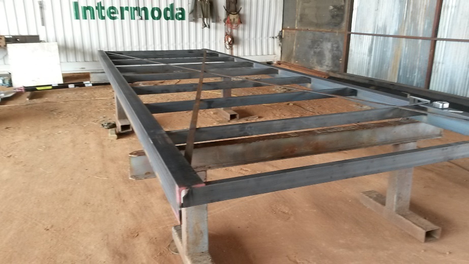

    My partner in a new venture we are entering into needed a trailer For the past few months I have been telling him we should just build one because he would never find a ready made trailer to suit him they would either be too heavy with things he didn't need or want or not have the capacity he wanted Finally after scouring 100's of trailer manufactures he agreed we should just build one. So I ordered a pair of 7,000 lb . axles with electric brakes on both a set of 6 leaf slipper springs 15,000 lb rated a 2 5/16" 15,000 lb rated coupler4 wheels rated for 105PSI tire pressure 5,000 lbs. and the steel to build the trailer. He searched and searched until he found USA made tires with a weight rating of 3640 lbs per tire
    This is what I built for him mostly while he filled a bunch of old tires with dirt for my retaining wall behind the shop.

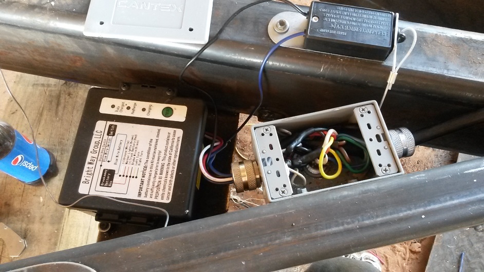

    For the wiring I ran a 7 conductor cord through the side beam of the tongue entering via a water proof electrical box where the front amber clearance lights and the breakaway battery is connected as well all connections are soldered and double wrapped in heat shrink tubing no wires are cut. the cable continues along the frame on the right hand side to the rear light bar bumper and continues across then up the left side to the front axle then the Positive and the ground wire are reversed back to the rear axle. All wiring connections for the rear lights are done inside the rear tube split twisted soldered and protected with 2 layers of heat shrink tubing every light is grounded to the white ground wire as well as grounded to the frame the lights are all LED

    My Partner asked me why I ran the wiring in the way that I did.
    For one thing 90% of all wiring problems seem to start with a faulty or failing ground and since every thing requires a ground this wire receives the heaviest current loading it also happens to be a ga. larger in diameter in most 7 conductor trailer cords. Obviously on a trailer with so few lights and being LED the amperage draw is minimal compared to a 53 ft semi trailer with dozens upon dozens of lights strung along the sides and rear. There is still no reason not to try and wire it the best way possible. I detest using crimp connectors when ever possible, even when I do use them I use the non insulated ones if I can get them or remove the plastic insulation so I can solder as well as crimp then insulate with heavy duty shrink tubing for a water proof connection. When making branch connections off of a main conductor I remove only enough insulation to be able to separate the strands then pass the branch wires through these then twist the tail of the branch wires half along one side of the split and half along the other side then fold the connection tightly so the shrink tubing will slip over it My reason for using a double layer is probably a bit anal but I feel it makes for a more factory molded looking connection. I also use only 3m or greenbrier brand tubing because it is thicker and makes for a more rubberized coating. My reasons for leaving the main cord continuous from beginning to end also insures there are no possibilities of a loose connection happening throughout the cord .

    One thing I failed to mention the trailer currently weighs only 2200 lbs by the time I add ramps and the extruded aluminum runners for the floor and a nose guard to protect the grill and headlights of his pickup for when pulling it behind his Prevost's Motor coach it will still only weigh 2600 lbs or less leaving him with a trailer capable of hauling 11,400 lbs.

    That 90% fault rate sounds about right. Totally agree with the reasoning except the solder only because I questioned the ex-Air Force avionics guy who did the electronics on the fishing boats I used to work on why he didn't use solder and he explained why I should use top quality non-insulated crimp connections with top quality crimping tools.
    When done properly the crimp creates a molecular bond between wire and terminal which minimises voltage drop. Solder also creates a hard, ridged area at the cable/solder junction which will cause a break. I use liquid tape,(different colours are handy for keeping track of things and useful for bundling as a few spots hold wire together in a loom),and heat-shrink over the top, leaves the cable flexible right up to the terminal but with extra support i that area. Totally sealed except for the bit of terminal that is being connected and I use dielectric grease there. I have just assembled a self-powered wood chipper for a friend and cleaned up and relocated all the wiring plus added a lot more support around the engine bay. Thing does vibrate in use and there was a lot of potential for problems. Still got to change the lights and add a few more markers. Nice unit but came with crappy BULB lights! Had a good downpour overnight and when I took one off to measure for L.E.D. lights one already had water in it. Added another coolant temperature sensor in the bottom radiator tank as well as if a leak occurs the normal gauges read low right up until they peg from super-heated steam just before the engine seizes.

    My connections are solid mechanical with the branch wire passing through the main cables then a few strands are laced and twisted in one direction while the rest are done in the opposite direction this makes a T connection then the T is folded in on itself tightening the connection even further the solder is really unnecessary
    but I apply just enough so none of the strands can fray by using 2 layers of the shrink tubing the protective insulation extends well beyond the connection point and is thicker than the original wiring insulation this makes for a ridged but still flexible protective coating a ways away from the connection.
    The thing I don't like about crimp terminals (and even though I don't like them I still have about every size and configuration of them ever made), is you are introducing a dissimilar metal to the conductor which can create a resistance to current. crimp connectors are a crap shoot when it comes to crimping them too much crimp and you crush and weaken the wires too little crimp and the connection will not be sound all stranded wires are different some have very fine micro hair thicknesses while others of the same gage may have fewer than 1/3 the number of wires for a given gage and be much larger in diameter.
    I like using a 10x diameter rule when making connections then lacing and twisting this insures that every wire makes contact several times with the strands in the parent cable the solder is nothing more than a binder and has nothing to do with the actual connection. it it did I would use a copper to copper fusion method similar to spot welding, but the key factor there for making those connections last forever is to have a good thick insulation covering the connection for some distance beyond the connection.
