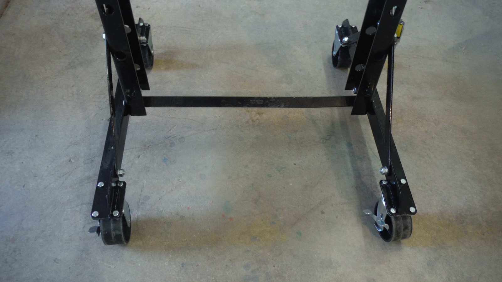

    So, some mods were in order right away. Casters (fixed in the rear, swivel in front) were bolted on after adding a small plate to the inside of the bottom rails. Surplus Center caster set p/n 1-4706

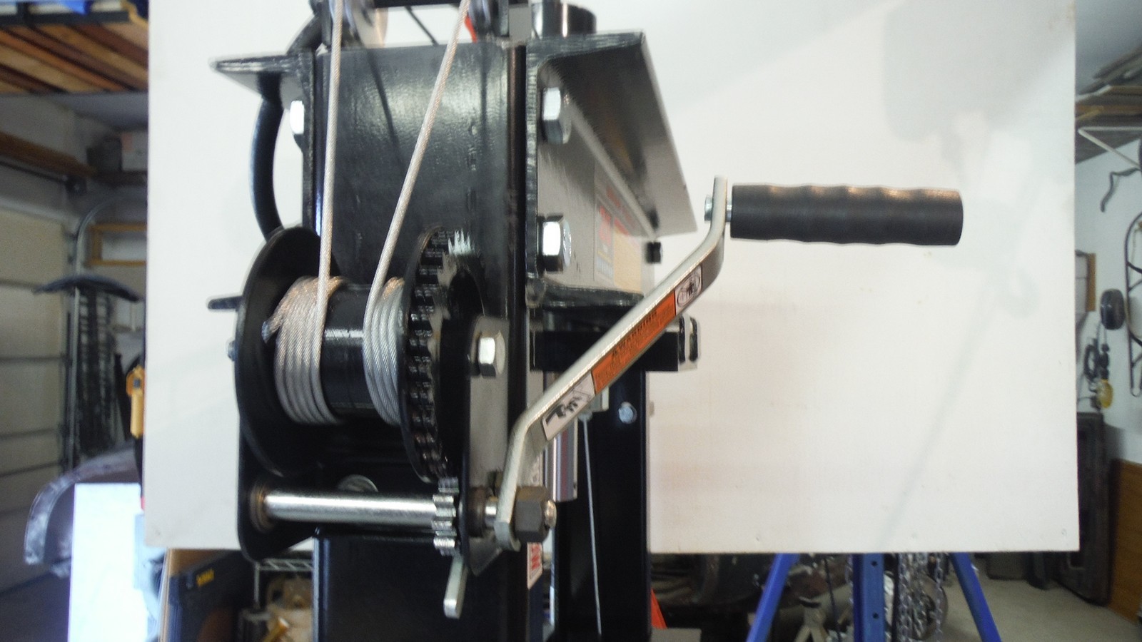

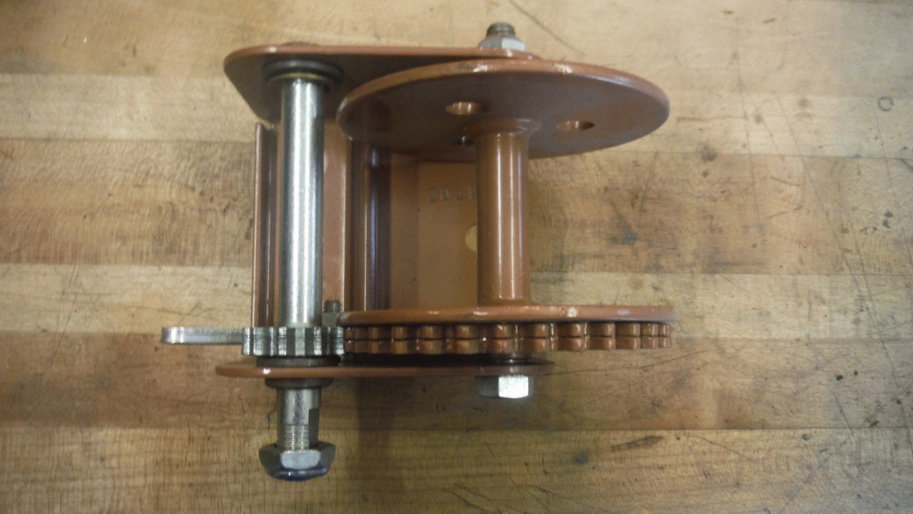

    Next was to add a small winch (boat type) to raise/lower the "work press table" as this is a Royal PITA to manually move without it falling to the floor, or worse, on one's foot.
    Even more so if you have parts or spacer blocks, aka heel blocks, on the table and need to move it up/down.
    Modified a Dutton-Lainson winch by adding a 2" diameter "spool" to the drum, so that the cables start winding faster. The stock spool was only about 5/8" diameter.

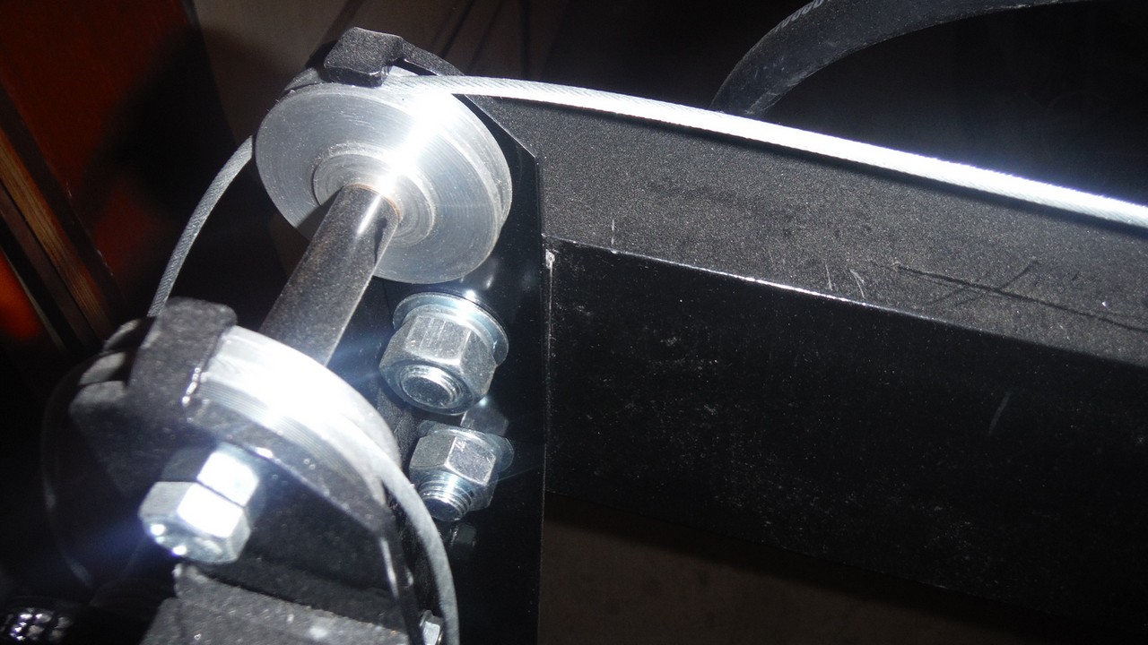

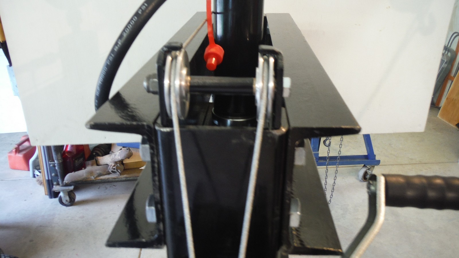

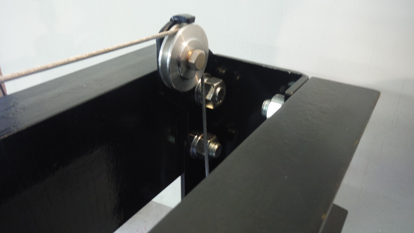

    The cables are then routed over some pulleys

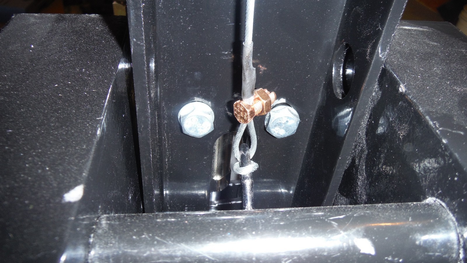

    and connected to the spacer tubes using some electrical ground wire clamps.
    .....here, short chain links welded to the spacer tubes of the table provide an anchorage for the 1/8" cables

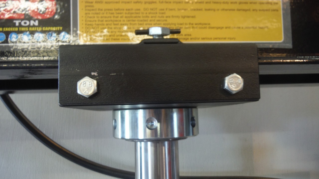

    I didn't like the way the cylinder plate fit loosely on the top beams; made things wobbly and there was wasted motion when pumping; so I modified that arrangement to allow it to slide left/right, yet have very little clearance in the vertical plane.
    Put a roll pin in the head of a 1/2-13 HexHd screw just to take up what little slack there was. 1 in front, 1 in rear.

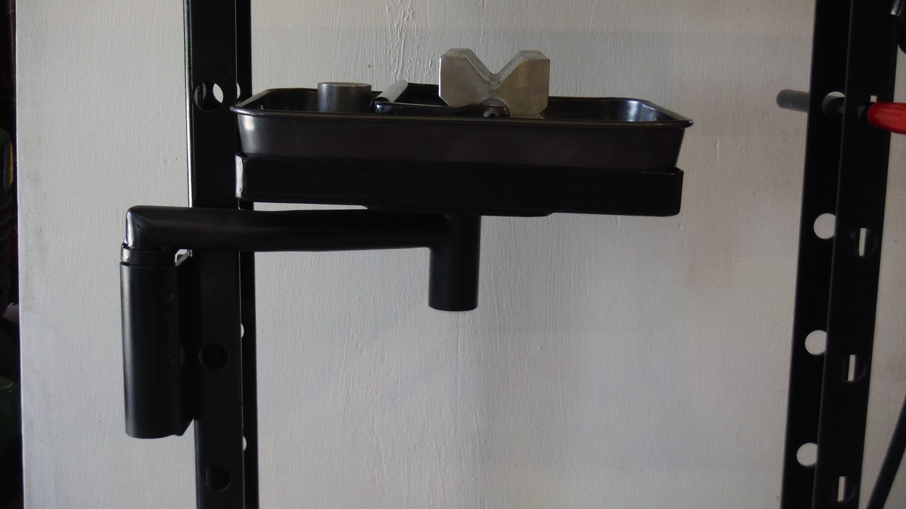

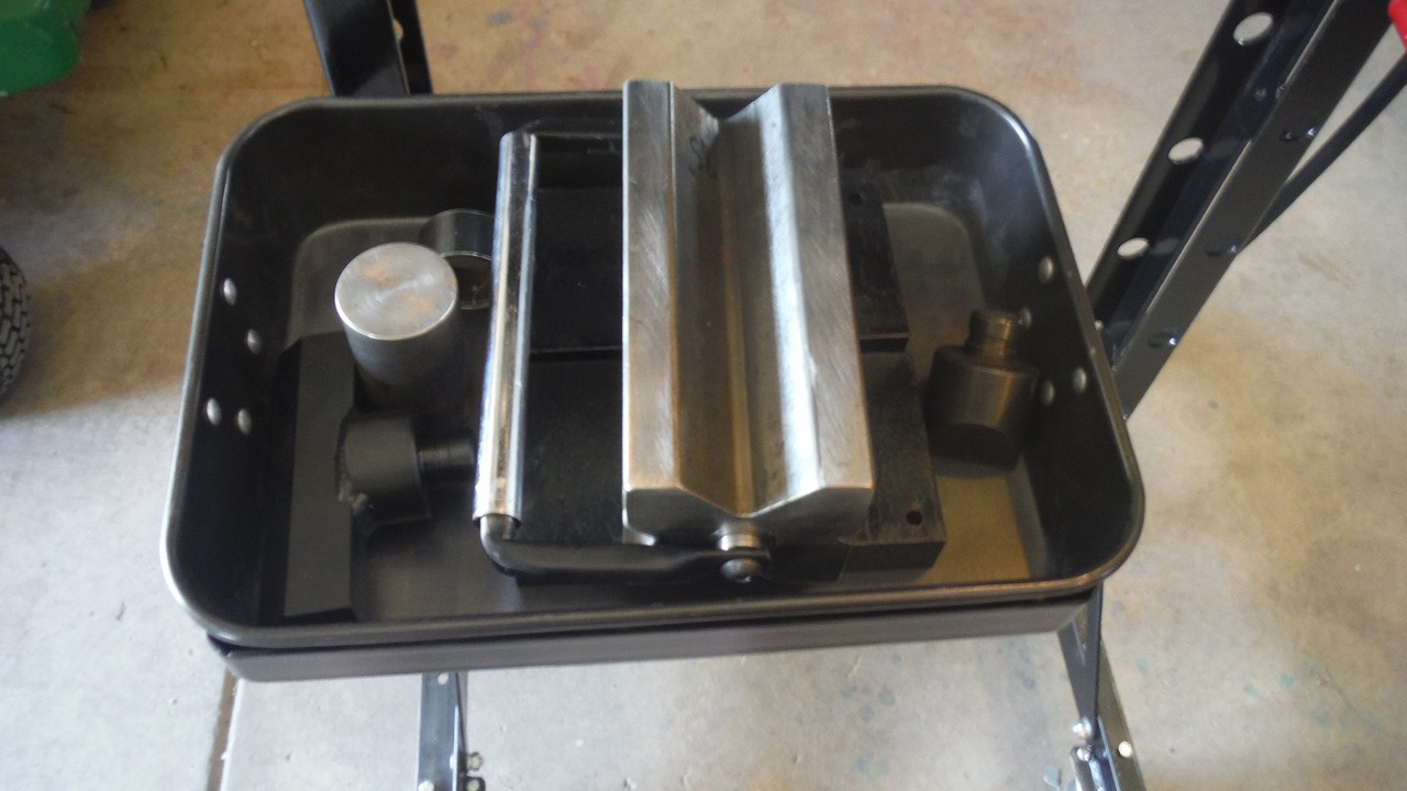

    Next, I visited the local Goodwill and got a nice alum cook pan. Made a swing-out frame and holder for all the press tools needed.
    A friend had a long piece of a 4-sided V-die and we cut off an 8" long piece. Drilled holes in the ends and made a handle for it
    (Like to keep my toes) Made a couple of V arbors for the ram. These sure come in handy for bending.
    The swing-out pivots outward to the left and allows the table to be moved to the lowest setting without getting in the way.
Name:	Casters Mounted.jpg
ID:	25353 Click image for larger version.

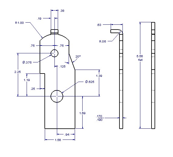

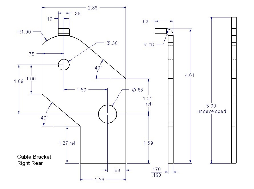

    here ya go, melbakid and any others that are interested;
    There are 2) of the Left Cable Bracket (1st dwg)
    Bend the ear as shown for the rear-most bracket.
    Bend the ear on the other one the opposite way for the front bracket. (There's only one of the Right Rear Bracket)
    The bend should not interfere with the pulley and if you make it 1 1/16" inside from the 3/8" hole, the tab can be bent over to contain the cable.
    20 ton Press and Mods-cable-brkt-left-rear.jpg 20 ton Press and Mods-cable-brkt-rt-rear.jpg
    (If these don't show up large enough, PM me and I'll send them.)
    The cable pulleys were made from 2" Alum stk with a 1/2"OD x 3/8" ID bushing.
    Winch is a Dutton-Lainson DL600A
    Spool with 5/8" center tube;
    As I mentioned, I cut a piece of 2" diameter tubing in half, then welded it into the spool.
    There are holes in the side flanges where you can weld the ends of the tube into position. (remove paint first)
    There's also enough room in one set of holes to run the 1/8" cable through, and loop back inside the flanges.
    Leave ends long enough to go over pulleys and attach at the chain link welded to the table spacers.
    It's not readily apparent, but the cable is just one piece.

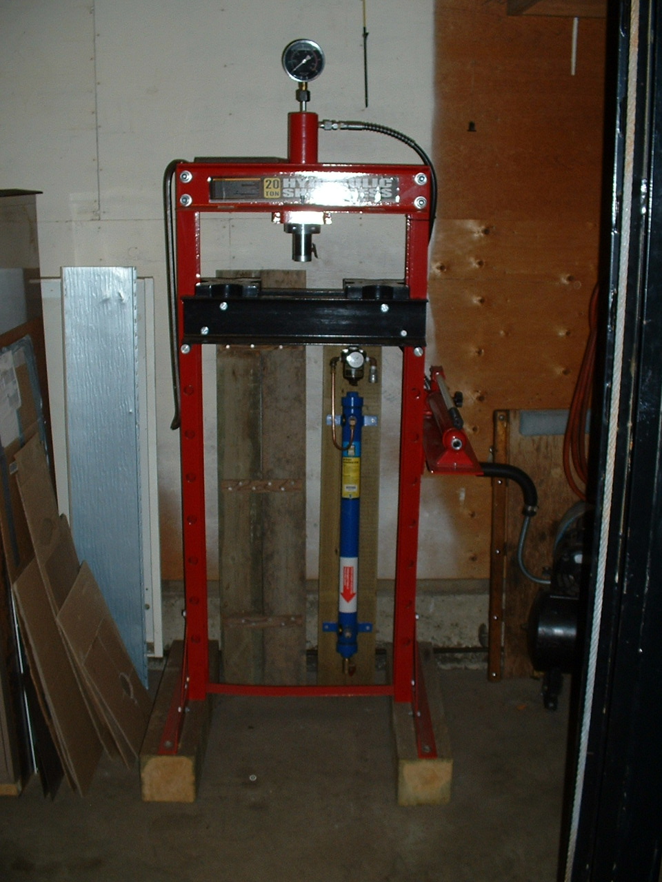

    I had a 20 ton press (sold recently) that I found the working area too low for comfortable working. I fastened 6" X 6" wood blocks under the legs on both sides to raise it for a more congenial work area.
    Attached Thumbnails Attached Thumbnails 20 ton Press and Mods-20-ton-press.jpg
    FWIW, they're known as split bolt connectors, AKA servits (Burndy)
