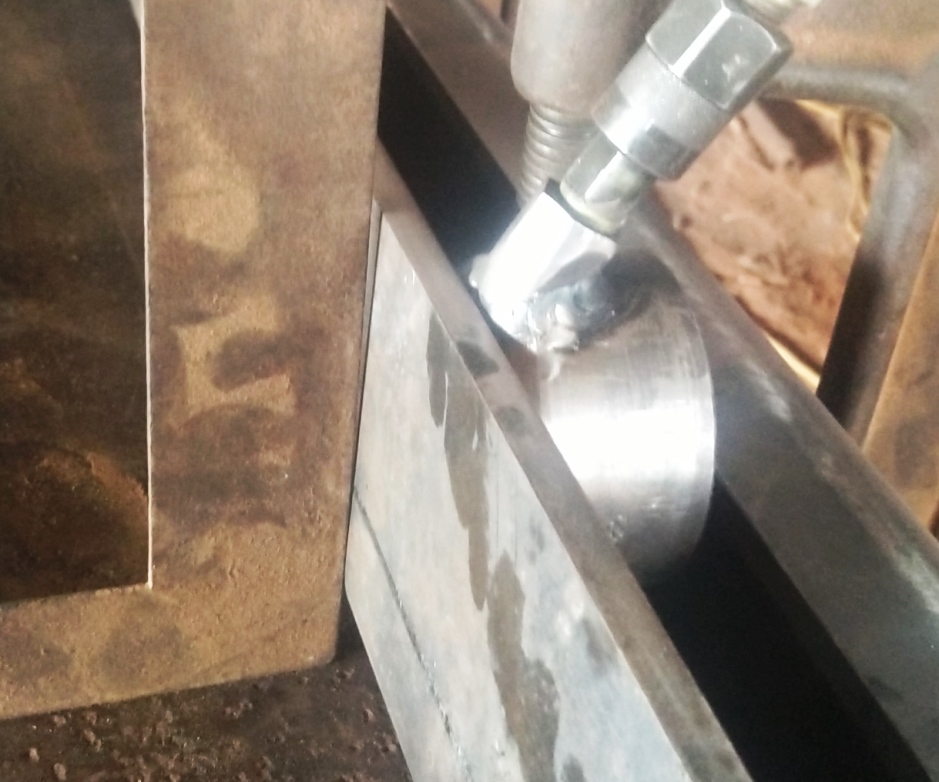

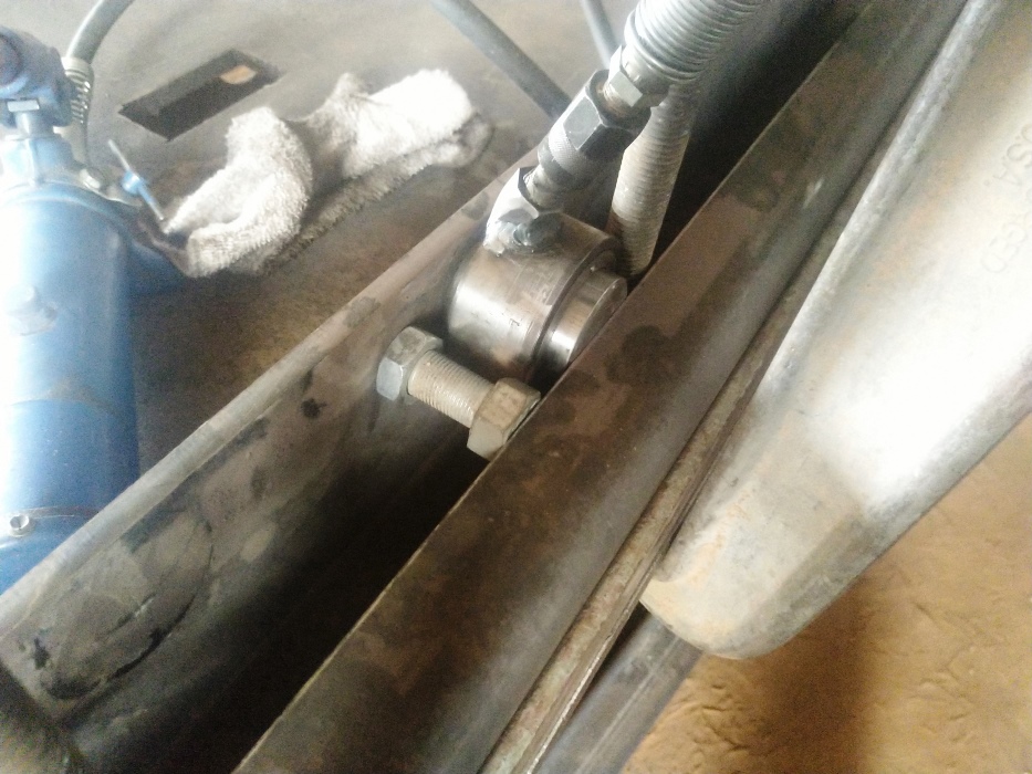

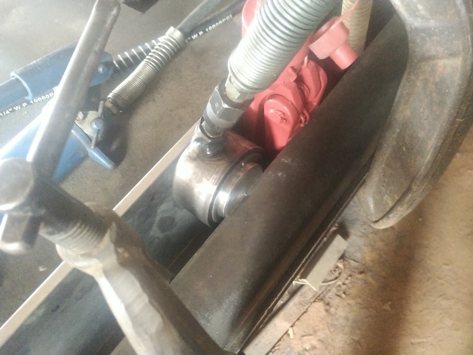

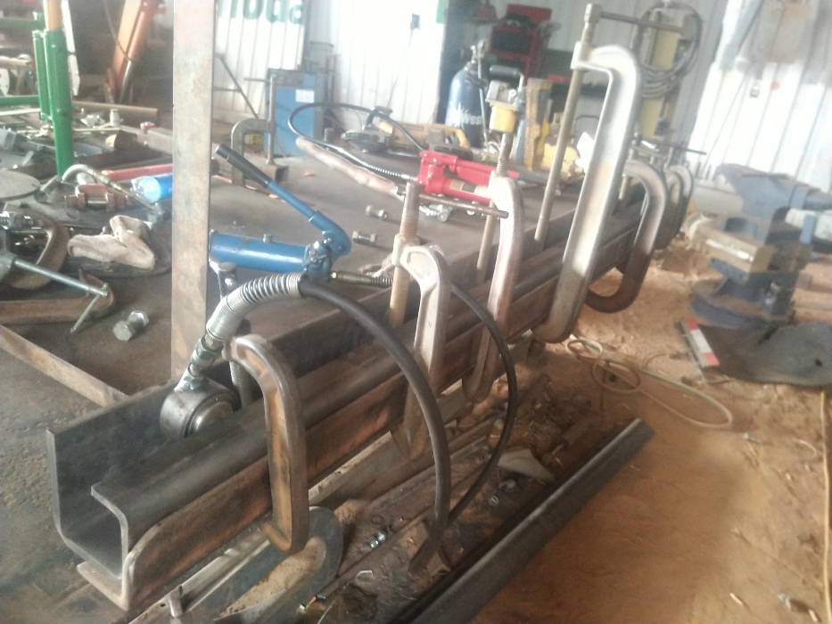

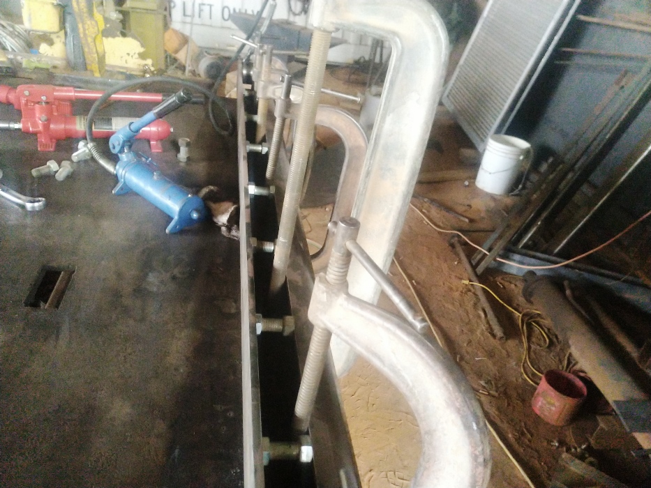

    I have a formed part that was over broke beyond true 90°. I have a few 4T and one 10 ton porter power the spreaders though only have 1/2ton of force but it takes considerably more than that to spread the bend on 3/8" grade 70 steel. What I needed was a pancake ram with enough force to spread out the bend. I made a pair of 20 ton rams for this but only used 1 and a lot of bolts as jack bolts to hold the leg of the beam spread

    I see in your 3rd photo the red painted spreader that comes with the kit of porta-power hydraulic jacks. I tried using mine to move what I though was an easy slide of a new wall I built in the basement, and the cast iron wedge piece broke. I made a new one from steel, after that fix, I've never used it again.
    I'm impressed with your home built mini jacks. You must have repurposed some seals from a hydraulic cylinder set you had around.

    Frank,
    Once you've put the jack bolts in place, I'm assuming this formed part will be welded into something that will keep the flange at it's correct 90 degree bend?
    Or did you over-bend it back so when the jack bolts are released that it springs to a perfect 90?

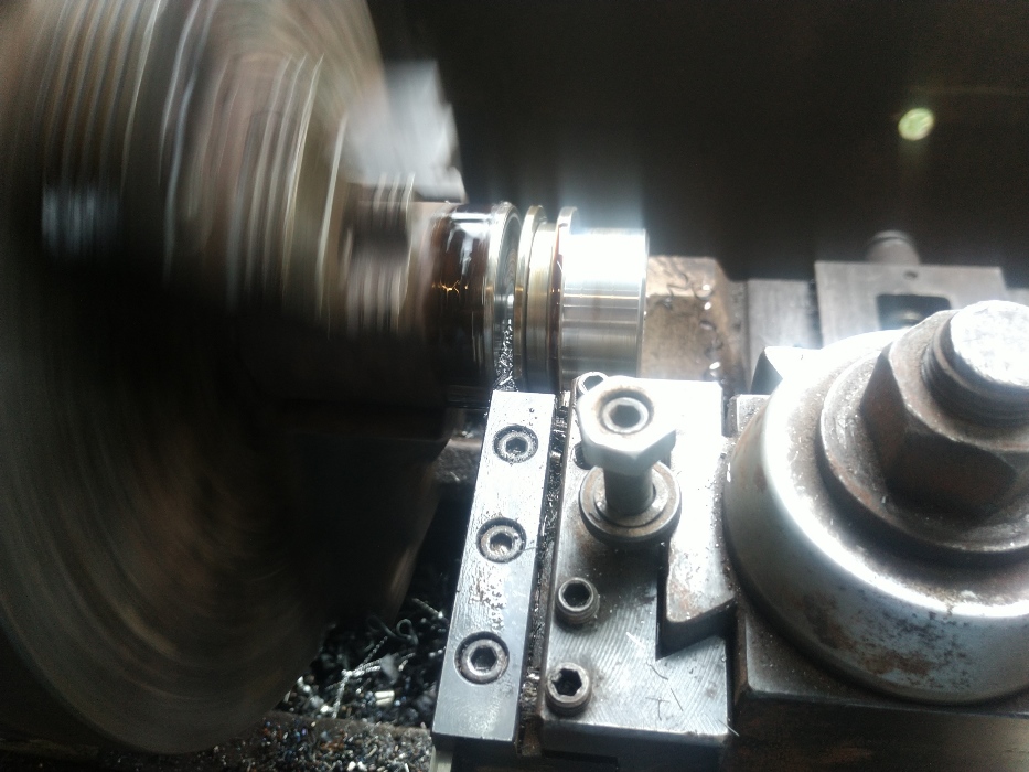

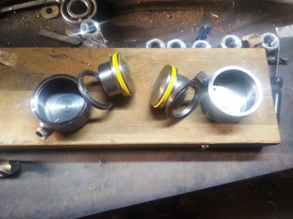

    I had a 6 ft section of new 2 1/2" ID honed cylinder tubing I bought for a previous project but hadn't used so I cut a couple short pieces off squared the ends on the lathe bored 1 end about 3/8 deep then threaded it to 2 9/16"-20 TPI machined the piston/ ram to fit the cylinder and grooved it for the seal made the head nut welded a 1/2" thick plug in the back end of the cylinder welded half of a 1/4" pipe hex coupling for the port then drilled the hole to 3/16" for flow
    The short ram gives me about 1/2" of stroke. when retracted the assembly is 1 3/4" tall

    Quote Originally Posted by KustomsbyKent View Post
    Frank,
    Nice work on the pancake jacks!
    The part was bent too far when I picked them up I has specifically specified that I required a true 90° bend on all bends but when was the last time any forming shop ever done anything to specs in this country? At first they tried to tell me they could not achieve a full 90 in as tight of a shape as I needed with the grade and thickness of the steel requested. I was prepared to have to deal with a less than 90 bend, by clamping and heating until I had a true 90, then when I saw it was bent more than 90 I thought well this will be easier to correct than not being bent enough.
    using the porter power and the ram to spread it out to between 80 and 85° the jack bolts held it in place while a gently warmed the bend to about 350 to 400° to relieve some of the stress after removing the bolts I had a very near true 90.
