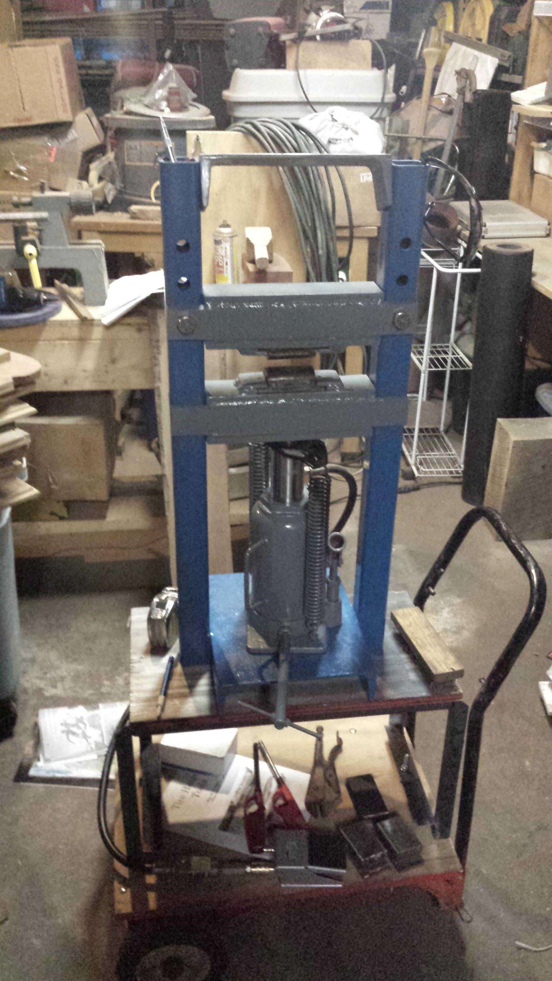

    Here is my version of the Mini Press. It took me way too long to put it all together...but it turned out well. Many used 2" square tubing for the base, but I had a piece of 10" wide channel. It has a piece of 1" plate cut to fit the channel and welded across the center to support the cylinder. Only have 2 sets of dies made up so far but will make a bunch more as I go along. The air valve for the cylinder was put into a foot operated air switch which lets me hold my hot work and operate the hydraulic release on/off.
    20 ton Air/Hydraulic Mini Press-20170425_194449.jpg
    I had it on a small steel stand but it was not easy to move. So I cut part of the off and mounted it to an old horizontal dolly that I had. Now it can be moved out of the way when not in use.
    Now that it's complete I'm thinking I want a bigger hydraulic press.

    Very good! Would like to see what kind of dies you have an are planning to make.

    I take it you are using this as a forging press? How do you find the speed of the air over hydraulic jack for this type of work?
    I was looking at this option but thought the jack might be quite slow.

    The speed is kind of slow, but it is way better than hammering by hand. At least with the foot pedal it is faster because I don't have to switch hands around. I've seen one that had an actuator to open and close the jack valve, which helped the speed, but for what I need is too involved and costly.
    To compensate for the speed I'll need to make some aggressive drawing dies. The flat dies and the slight curve don't move things fast...although I only played with some 52100 round bar.
    I can take a pic of the box that the foot pedal came in if you're interested Ralphxyz.
    Some of the other dies I want to make will be specific tooling for integral knives. The ideas have been floating around my mind, I just haven't got them figured out enough to draw them out yet.

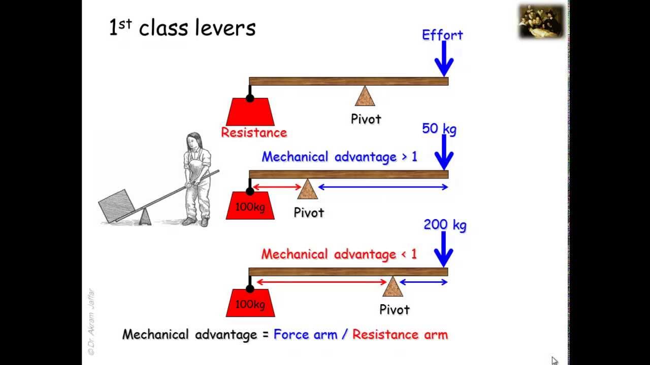

    Thanks Frank, but why would not a simple lever work? Say a 13" arm 1" off the pivot that would have to multiply the force and keep it within the
    operating parameters of the jack. The jack would not see any difference but the lever would multiply the force.
    Of course this is all coming off the top of my head I have not tried it yet but it seems like it would work.
    Ralph
  14. #10
    11,729
    2,238
    A leaver would require the use of fulcrums (pivots)to act upon the distance between work, force, and fixed point.
    If the intent is to have more force or power this is done at the expense of speed if speed is desired then power is reduced
    the only way to gain mechanical advantage is to have slower movement and vice versa
