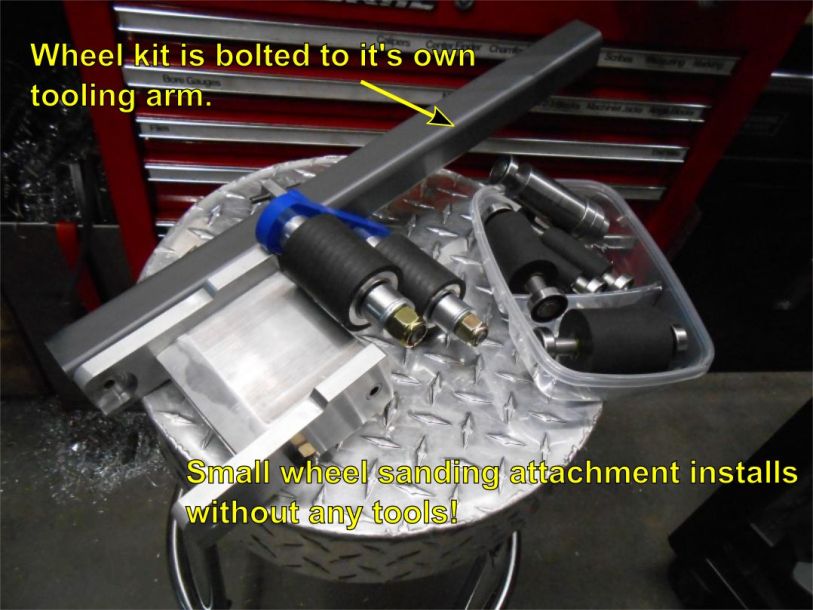

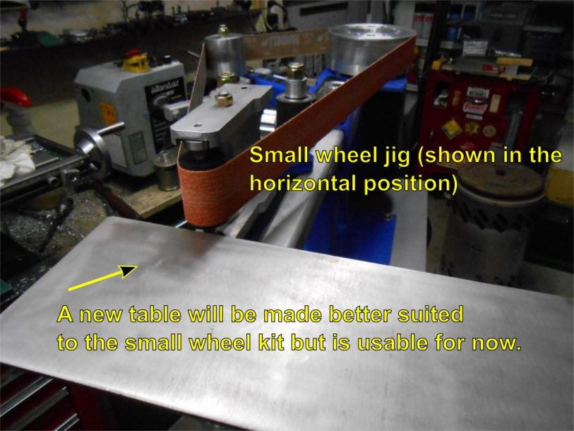

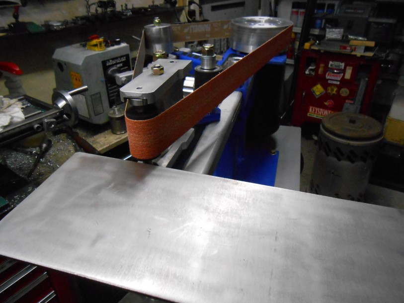

    Small Wheel sanding attachment for the 2 x 72 belt sander.
    I just finished up a small wheel sanding attachment I've been working on. You can buy these but what fun is that???

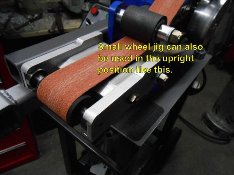

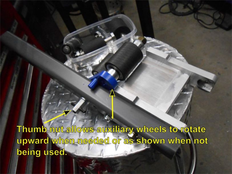

    Wheel holder body is made of aluminum and is bolted to it's own tooling arm so when needed, simply slip this attachment in and your ready to go. (no tools needed!)
    This attachment can be used in both vertical or horizontal positions.

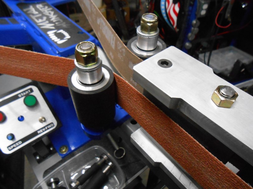

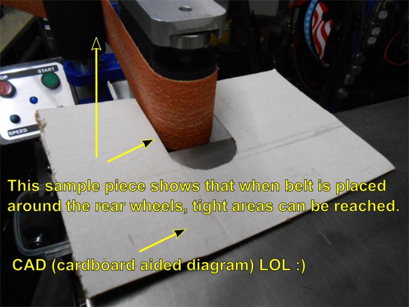

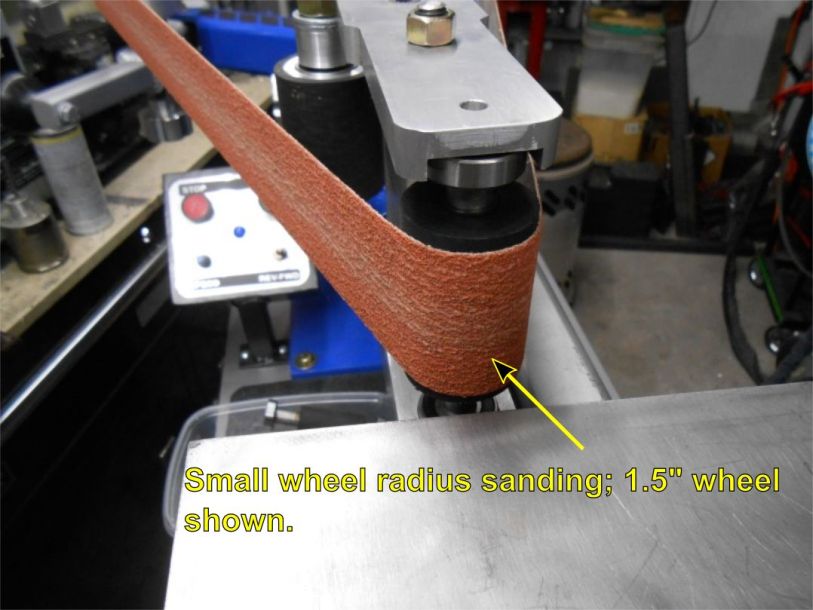

    I added (2) auxiliary rear 1.5" rubber wheels that you can use to wrap the sanding belt under to sand tighter areas. (see pics) These would only be used when needed as they would wear due to the sanding grit being in contact with the wheel surface. (pics show and describe this process better) To use, just loosen the thumb nut and rotate the wheel assembly upward, a stop pin locates it for you, then wrap belt around and under these wheels. I made these from some 1.5" aluminum round stock and the rubber portion is just an old car radiator hose! lol If they wear out, plenty more hose around here.

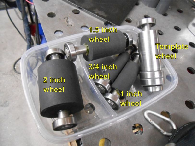

    I made up 4 diameters of wheels; 3/4", 1", 1.5" and 2" and all have a rubber sanding sleeve. Some store bought versions don't even have that added luxury! (found the sleeves on amazon after some diligent searching, link below if you want to build this) The sleeves are twice as long as needed (4.5) so cut them in half, use one set and sell the other! lol These are installed on a piece of 1/2" cold rolled steel. The ends are turned down a little to accept the 6001RS bearings. No tools needed to swap in the wheels either, just slip one in and wrap the belt around it. Done!

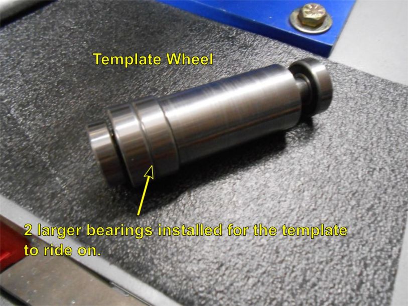

    In addition to those 4 wheels, I also made a 1 inch steel Template wheel. I don't think anything like this is available commercially, it's an idea I got from a you tube video. It has 2 larger bearings (R8) at one end for a template to ride on allowing the sanding belt to shape the part. Great for making multiple parts quickly! (sorry, no examples available yet of that process)
    One thing that is still needed is a better table build specifically for this attachment. I'm still in the planning stages on that. Something that will go around the shape of the belt. For now, the regular tilting table is usable.

    I especially like concept of the interchangeable diameter wheel assemblies. Bearings, for all their precision and useful life, are not expensive to equip as individual units. Additionally, this spreads wear among them; where oft-used sets get replaced accordingly.
    And the contour template roller....! I've not seen that idea employed with any sander. Whether blending difficult one-off shapes or production items; that is a winner!

    Thanks Toolmaker! Wish I could say the template wheel was my own idea but I saw one in a you tube video and I never take credit unless it's due. Jeremy Schmidt I think his name/channel is. His idea is based off what a wood router uses.
