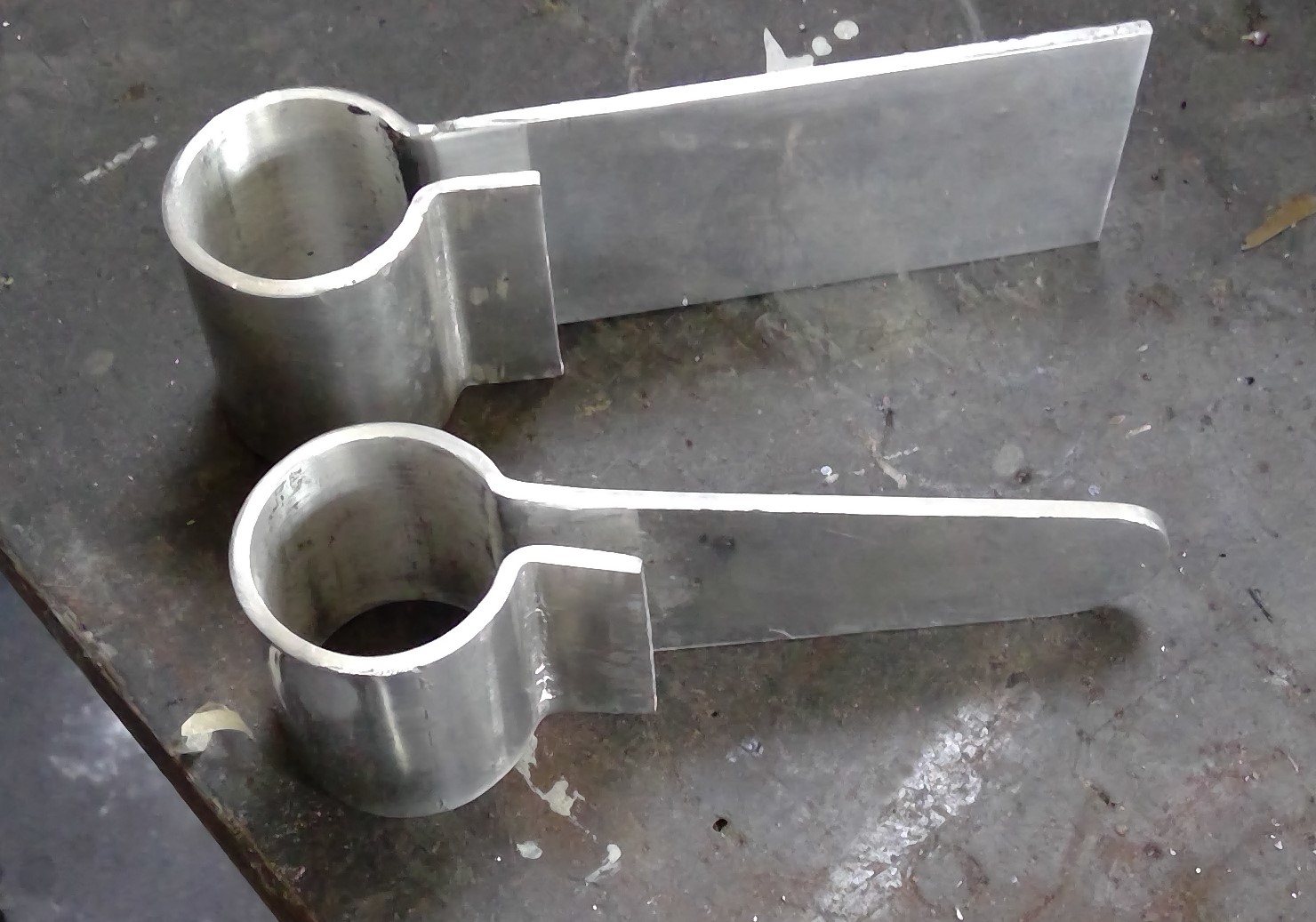

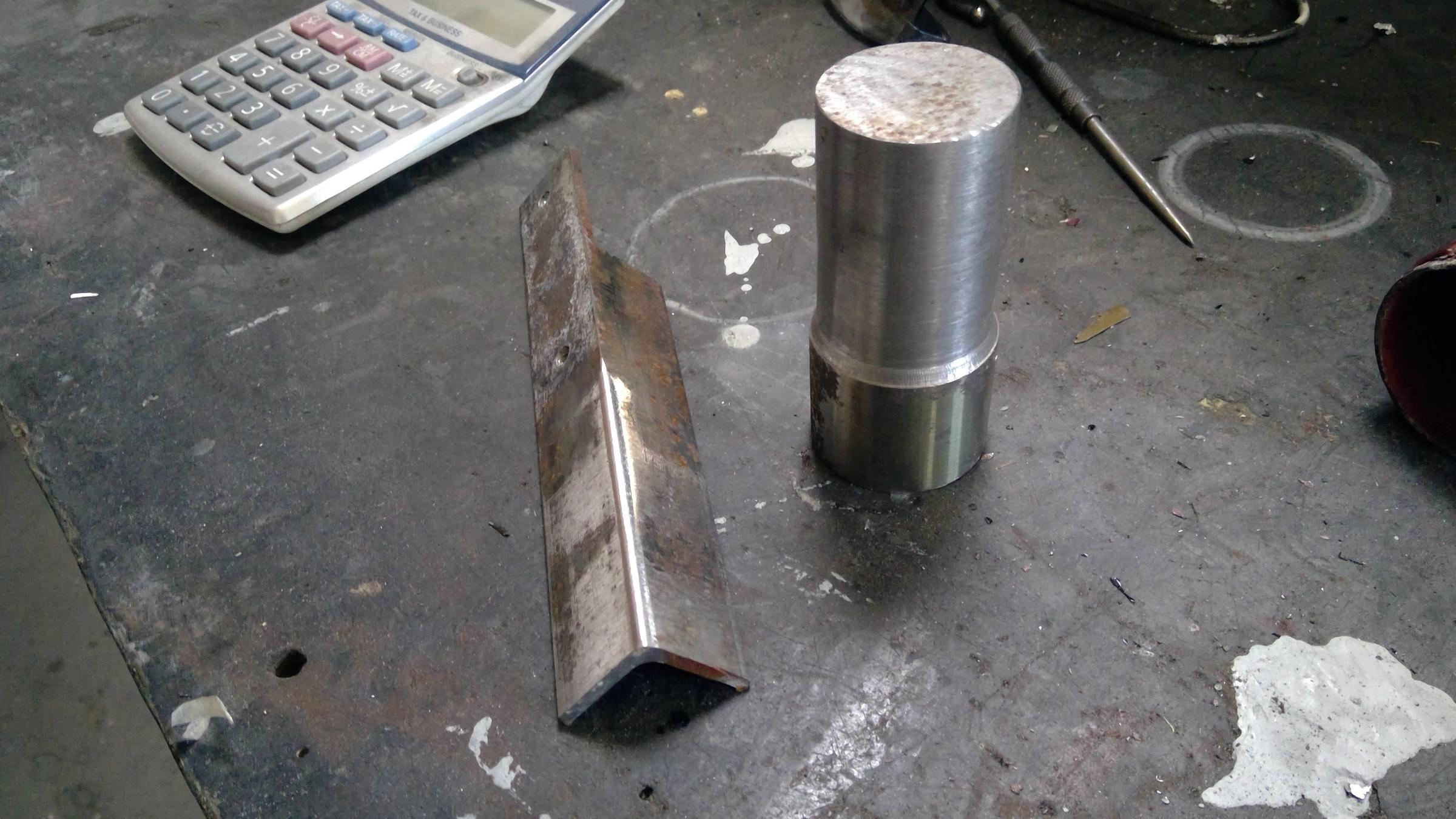

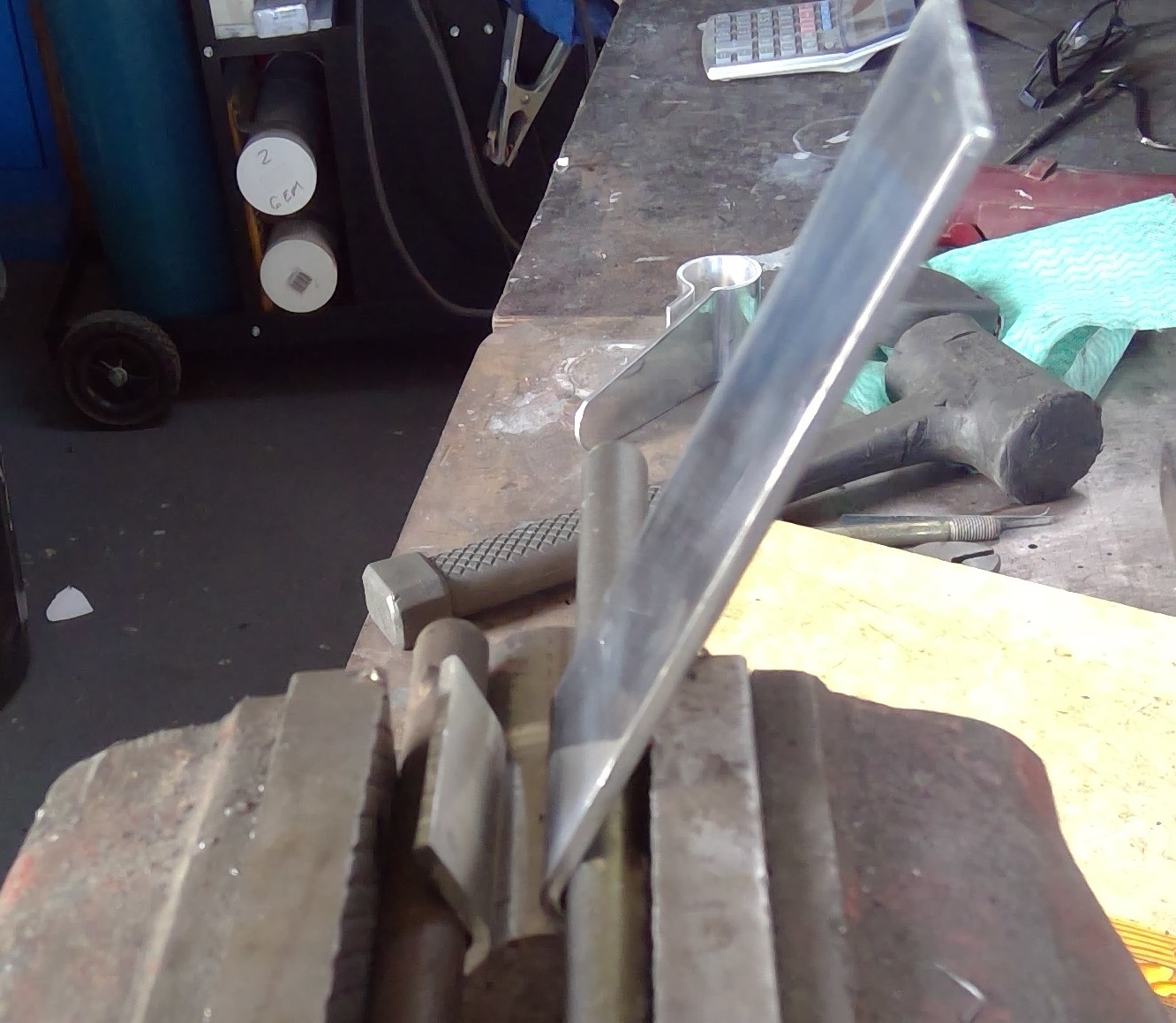

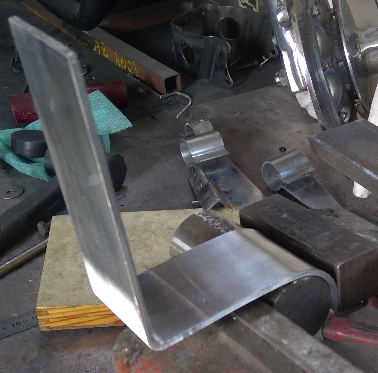

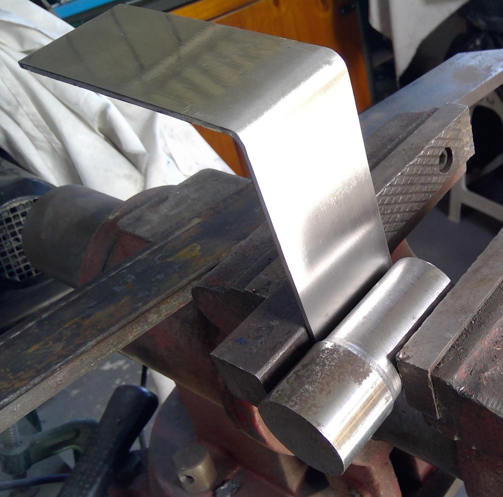

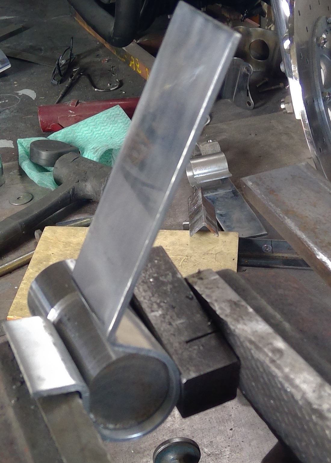

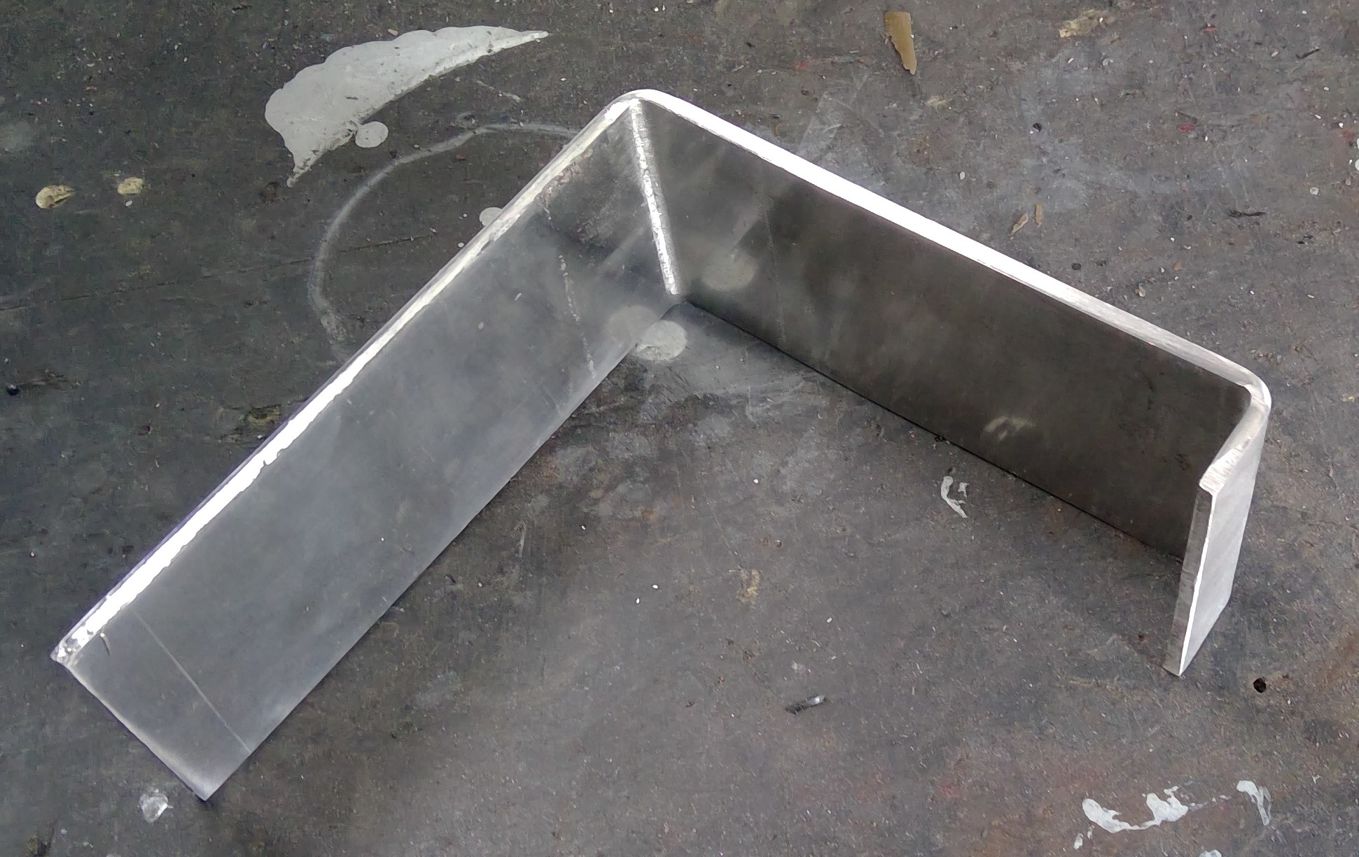

    Here's how they were made. i started with two strips of 3mm ally, 50mm x 230mm. worked out PI for 34mm fork legs and did two 90 degree bends Pi apart. I used a bit of angle iron with the edge radiused for the bends as this aluminium fractures if bent to acutely. I then bent the ally around a 34mm dolly, bringing the 90 degree bends together with a 3mm gap between when clamped tight. Of course I had to stuff it all up when I shaped it, didn't I, made two right handers instead of a right and a left. The joys of getting old. Oh well, soon as I make a lefty I'll shape, drill and polish Some polishing was done beforehand for the areas I won't be able to get to after bending.. I'll post pics of the completed brackets when finished. . i started with two strips of 3mm ally, 50mm x 230mm. worked out PI for 34mm fork legs and did two 90 degree bends Pi apart. I used a bit of angle iron with the edge radiused for the bends as this aluminium fractures if bent to acutely. I then bent the ally around a 34mm dolly, bringing the 90 degree bends together with a 3mm gap between when clamped tight. Of course I had to stuff it all up when I shaped it, didn't I, made two right handers instead of a right and a left. The joys of getting old. Oh well, soon as I make a lefty I'll shape, drill and polish Some polishing was done beforehand for the areas I won't be able to get to after bending.. I'll post pics of the completed brackets when finished.

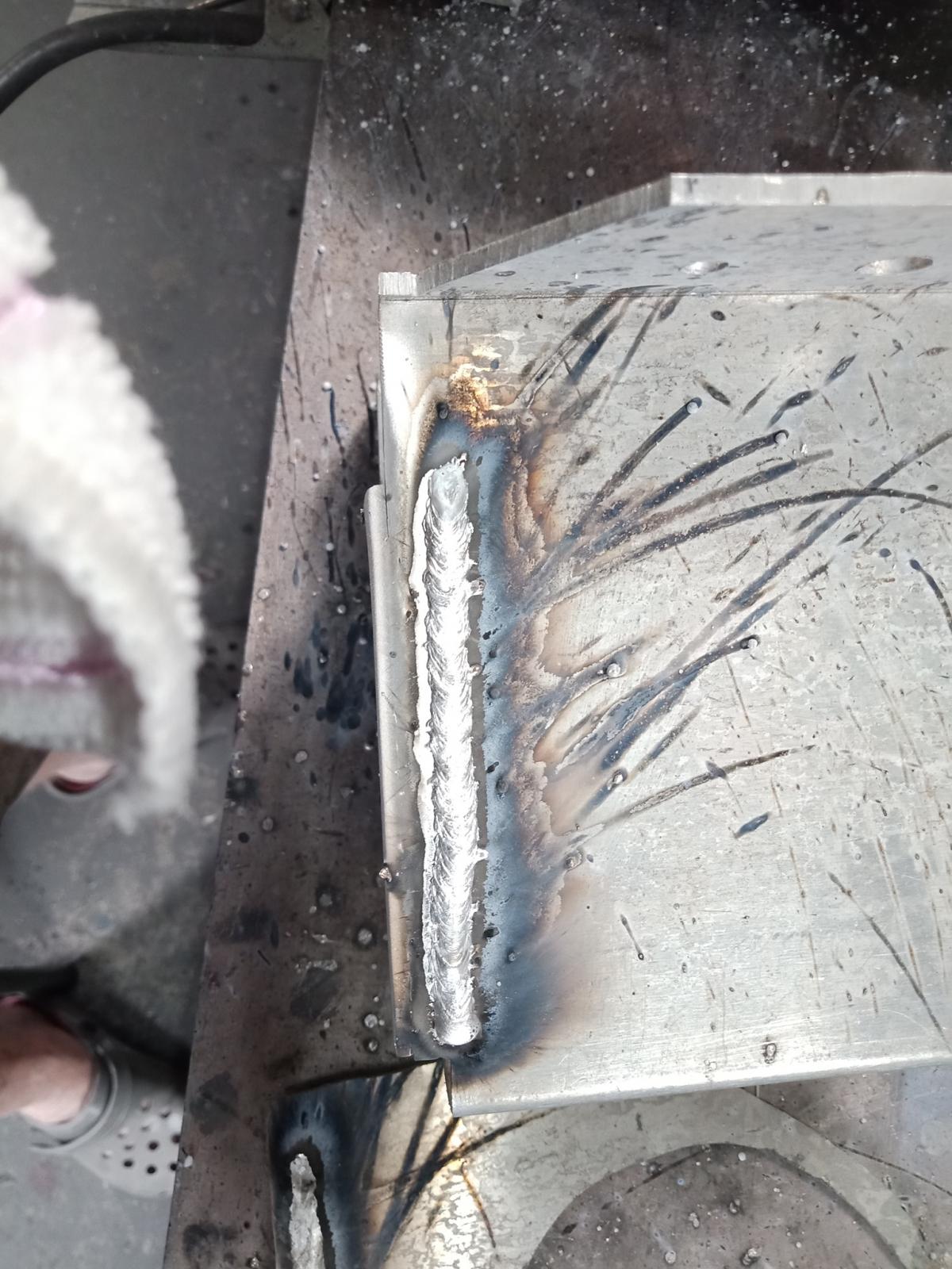

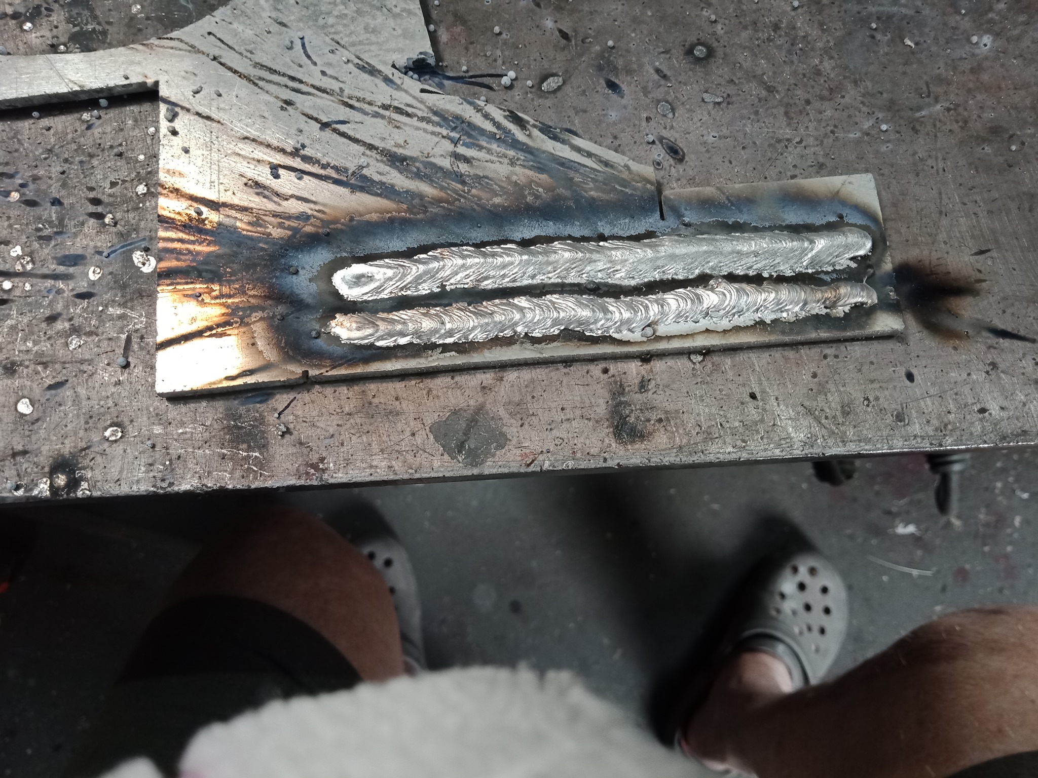

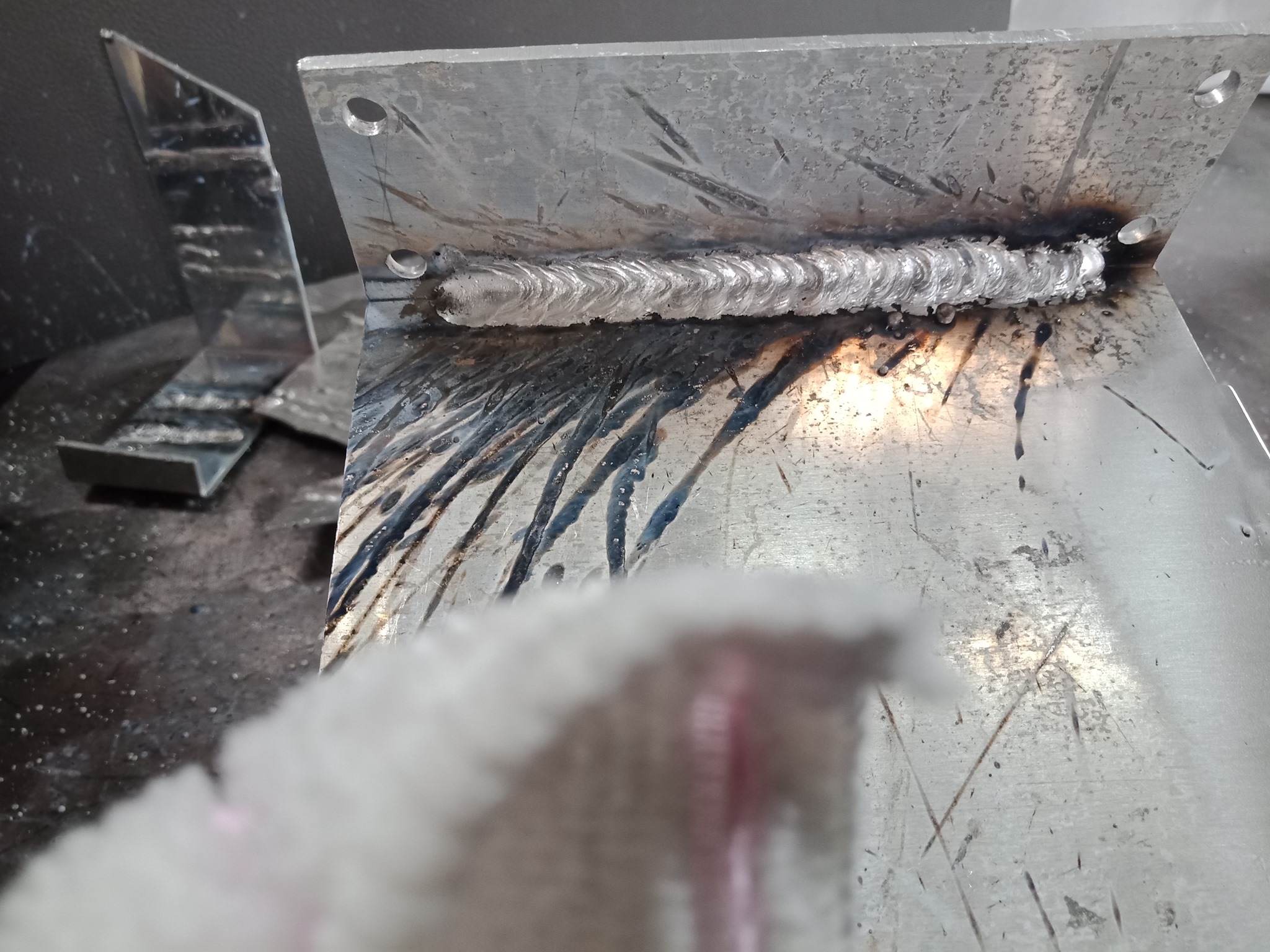

    This afternoon I taught myself to mig aluminium. The key was finding the right volts, wire feed, stick out, speed and watching the heat build up, that had me stumped for a bit, wondered why each successive run was worse than the last - heat build up!. Oh, a steady hand also helps, but that's beyond this old codger now, hence the wobbly runs. Excellent penetration too, after welding an external edge joint, I ground it down flat then belted the hell out of it trying to separate the joint. Not too bad for an hour or so practice. A whole new world of aluminium fabricating has opened up now, should have taught myself to weld aluminium year's ago. Talk about messy though, splatter everywhere. And I burnt the crap out of my arm from flash, the flash is 10 times brighter than when welding steel.

    This afternoon I taught myself to mig aluminium. ........... Not too bad for an hour or so practice. A whole new world of aluminium fabricating has opened up now, should have taught myself to weld aluminium year's ago. Talk about messy though, splatter everywhere.
    Are you using the inbuilt wire feed or do you have a spool gun?
    I am surprised at the dirty surrounds and splatter, are you using pure Argon or is Aluminium wire available with flux in wire like steel is? Although I have welded aluminium over 6 decades with Oxy/Act and TIG over 2 decades I have only used MIG for steel. I have seen some videos of Aluminium MIG but those showed a cleaner finish.
    You have done a great job with such a small amount of practice. I relate totally with your comments on wobbly runs, being fairly ancient myself I am starting to have the same problem particularly with TIG where I have to hold the gun with one hand at least with MIG I can use both hands.

    No spool gun, so I set the machine to operate properly without one: I used 5356, .8mm wire and drilled out the tip to 1mm, threw away the liner recommended for ally as too much birdnesting and used a steel liner, installed a ribbed feeder wheel and loosened off the wire reel preload.
    I have tried before using a disposable argon cartridge with dismal results - not enough pressure.

    Years ago I replaced the standard spiral type liner with a teflon version sold for Aluminium welding, I was welding steel but I thought that being teflon the wire would slide nicely. It did that OK but it only lasted about 1/2 day because the wire wore off a fine amount of teflon which formed a thin insulating layer in the tip preventing current flow. That was the second of two of life's lessons about teflon flowing.

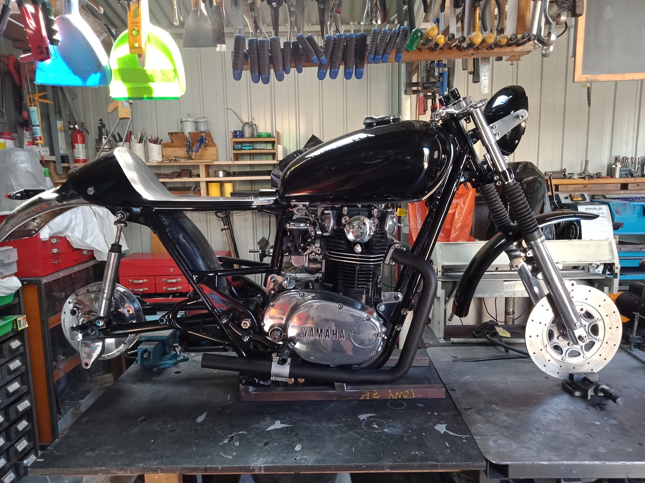

    Coming together slowly, still a lot to do, should be finished in around another 20 years at this current momentum.

    I like the vise on the front disc, I'd never thought of that.

    Saves on pads!
