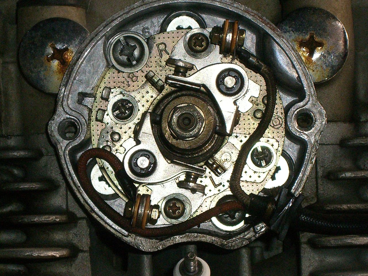

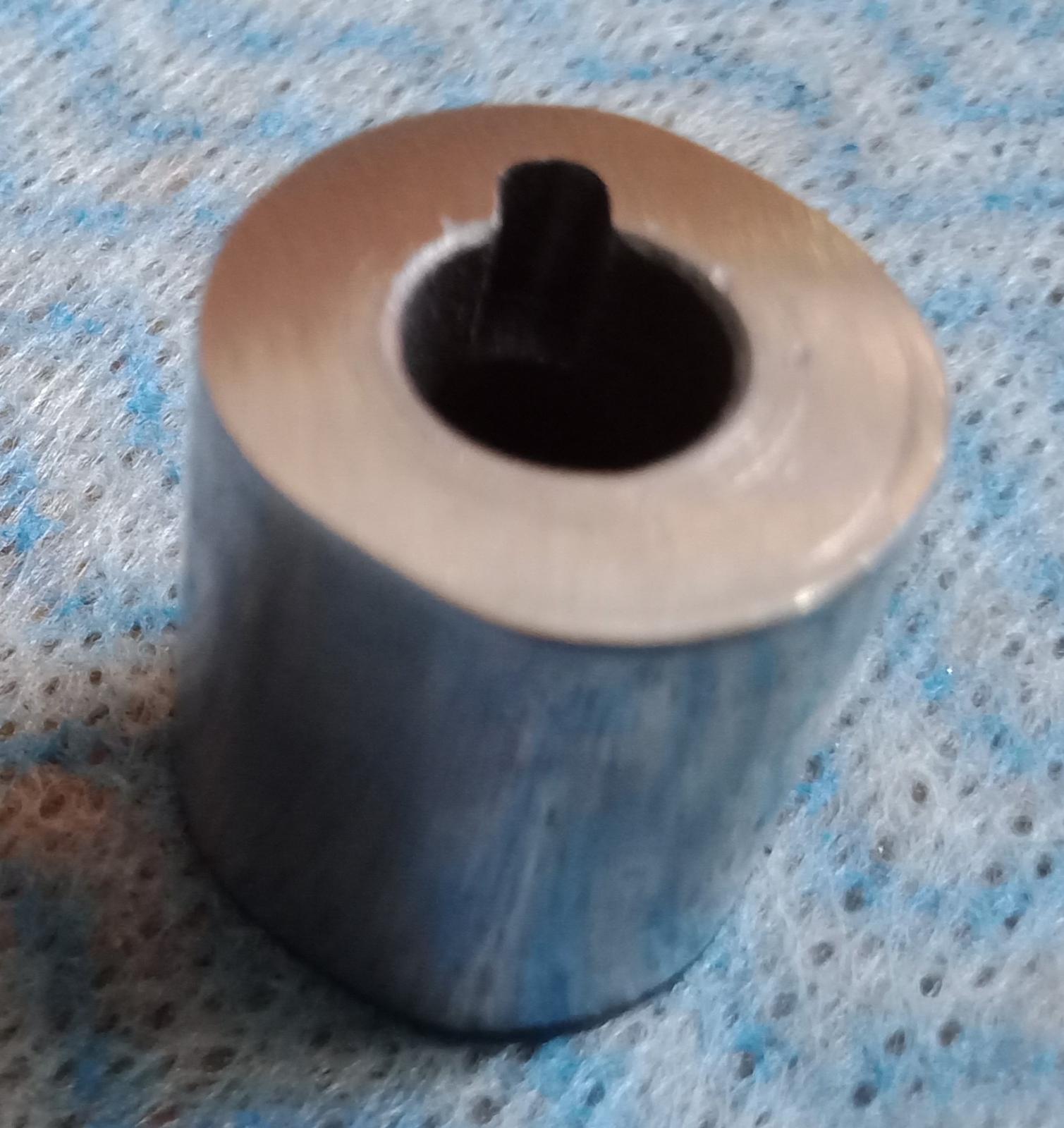

Nope, the cam doesn't. Use a woodruff, instead Yamaha used a round pin inserted through a hole in the shaft.

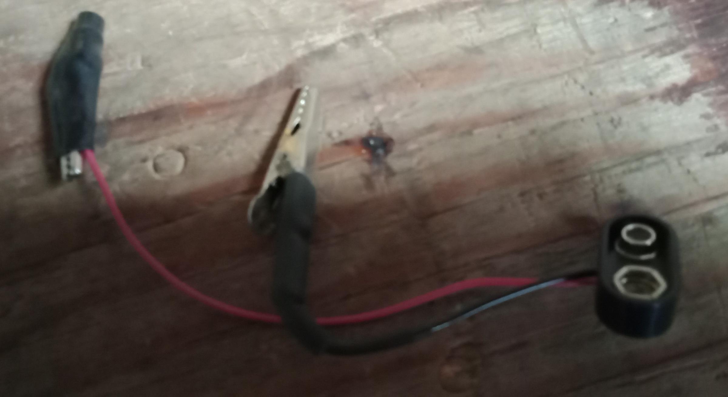

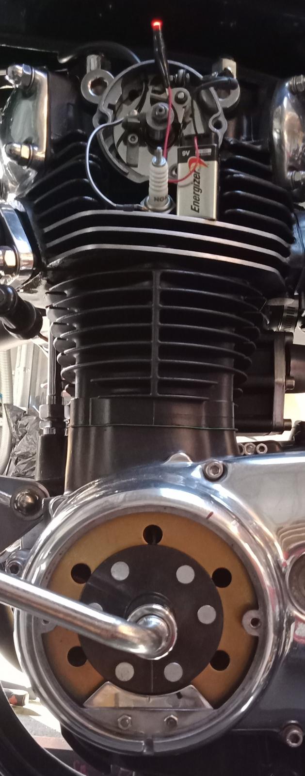

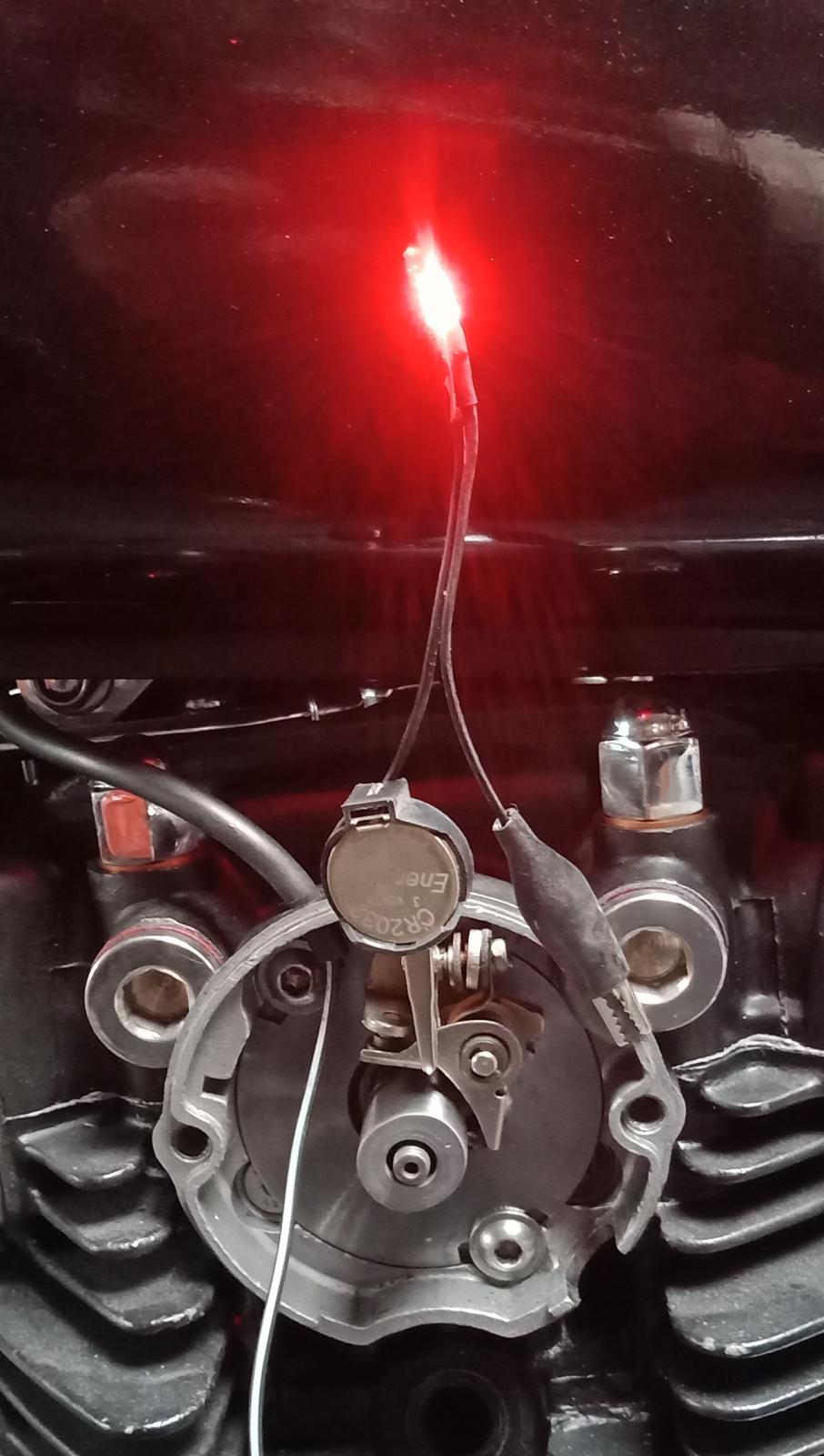

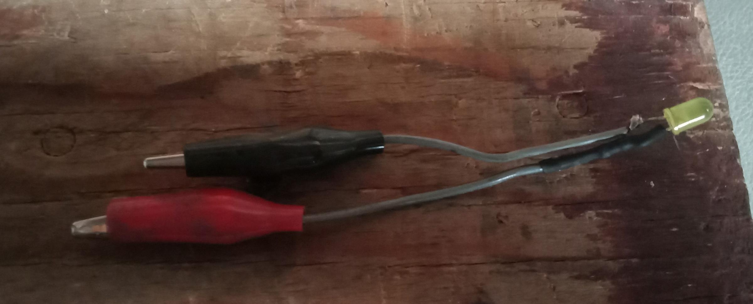

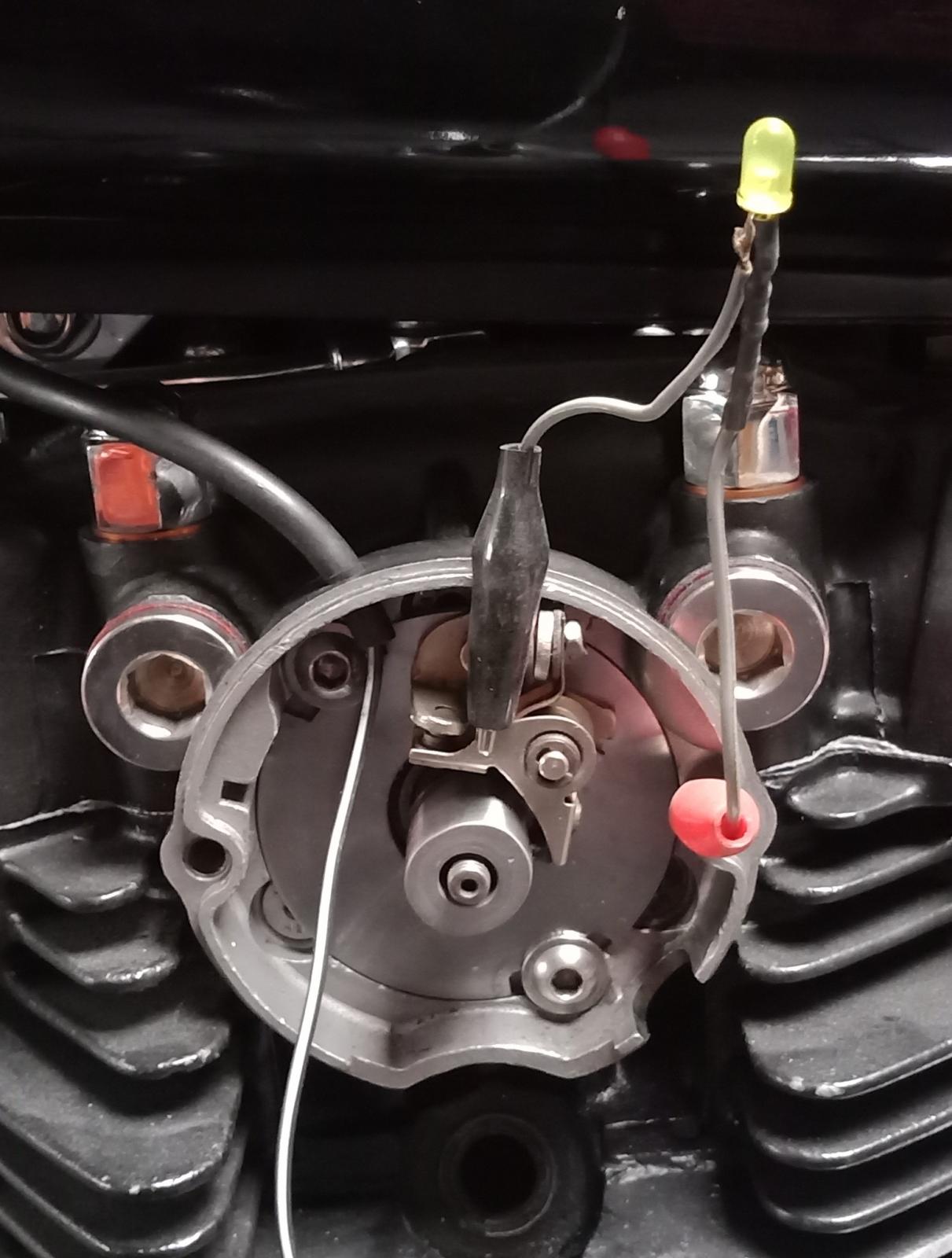

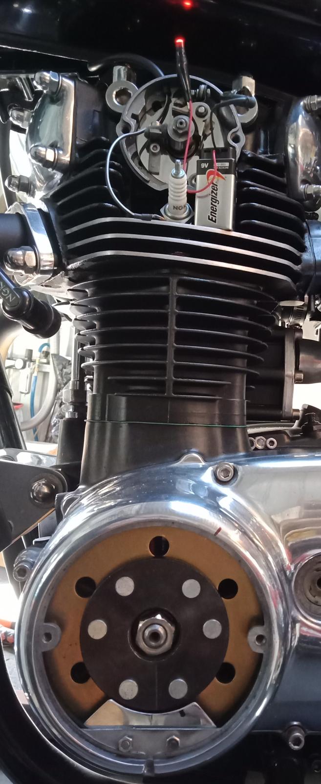

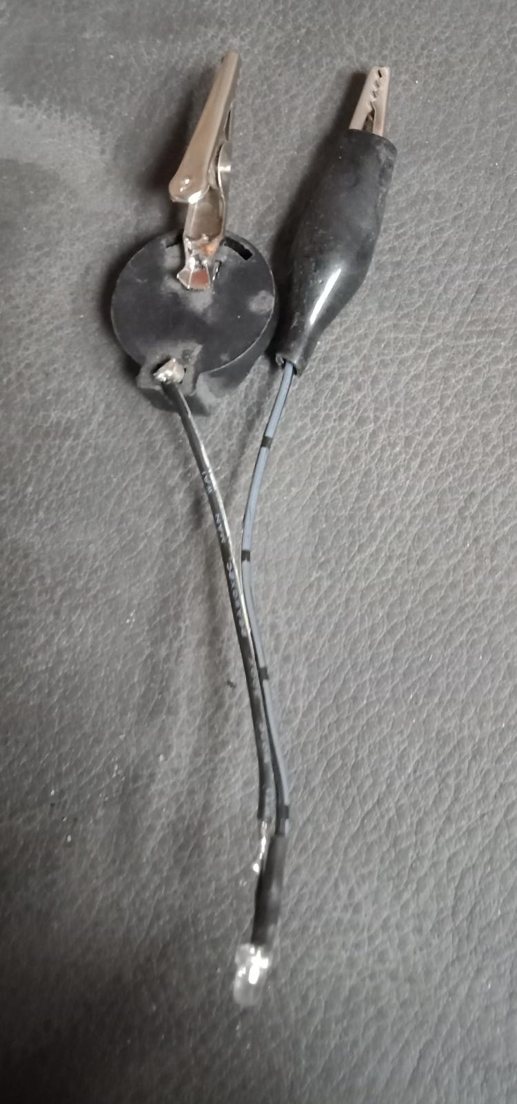

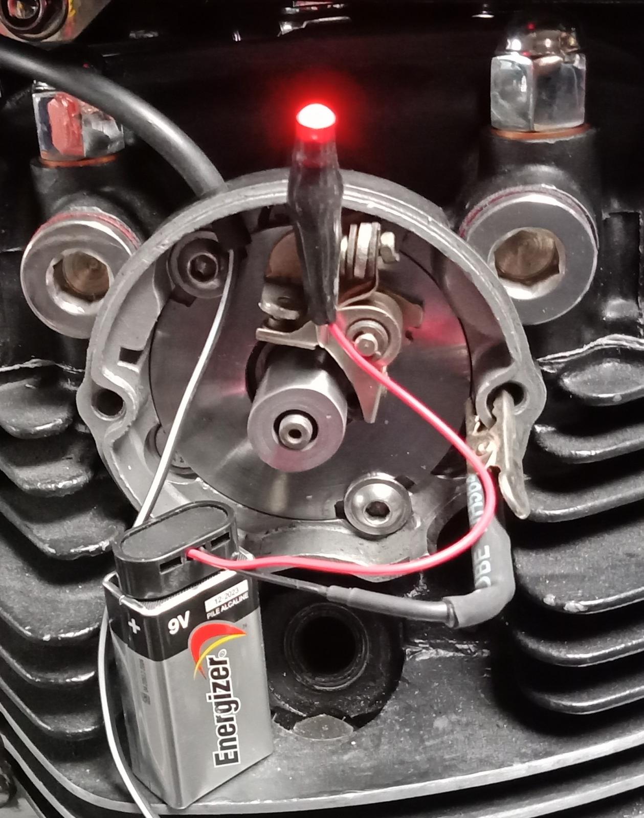

Slack day today, just made up a few static timing lights of different design. First one uses a 9 volt battery, so had to solder a resistor in the line to cut the voltage down. Second one works off the bike battery, so also had to use a resistor. Third one uses a 3 volt button battery, so, so resistor required. Why so many? I was bored!

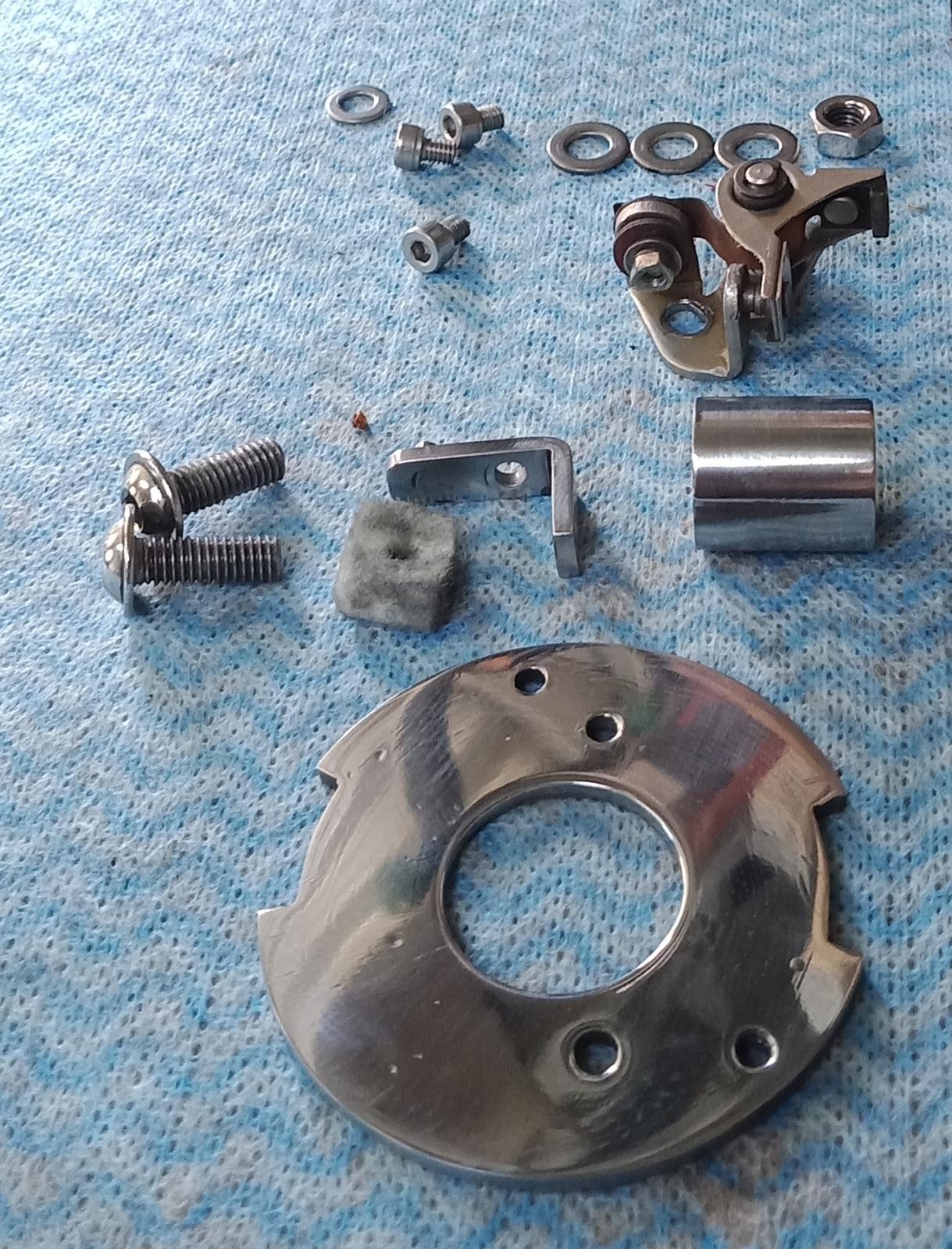

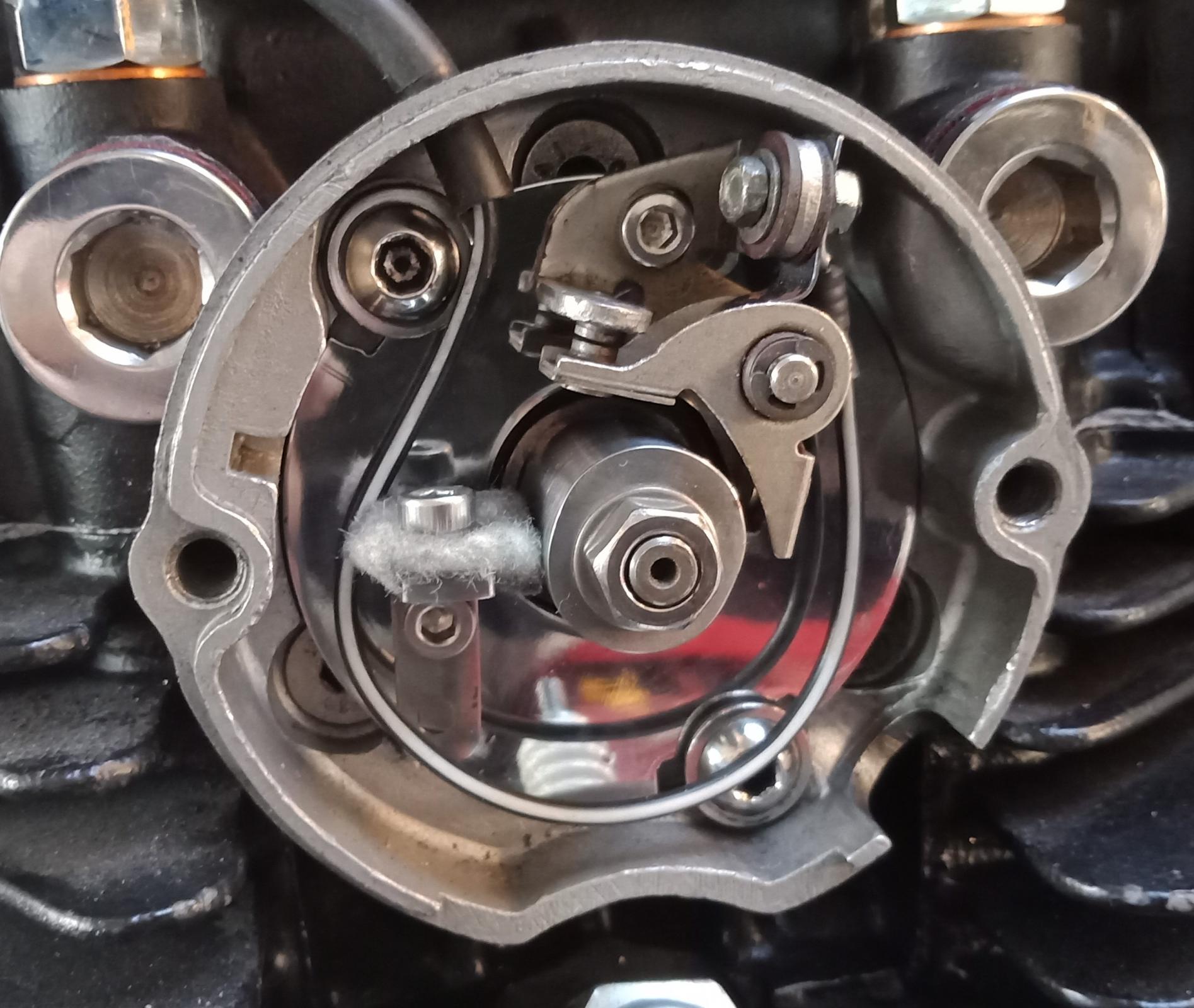

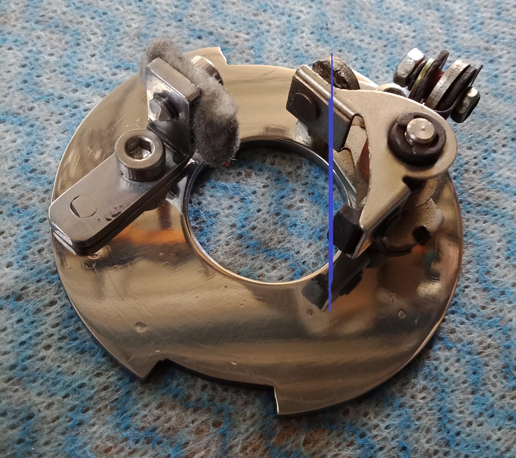

Well, another day spent on the points cam, must have made about a hundred of these bloody things before I figured out how to do it" cut the keyway first, then mark where the ramps are then file, check, file, check, ad nauseum! Finally got it right, close enough to say spot on, statically at least. I also added a felt oiler bracket to the backing plate and moved the condenser up near the coil. Looks a lot neater now, and quicker to set the points with only one set. I don't like cutting key ways on the lathe, so I used a 2mm end mill on the mil. The key is a 2.5mm round pin suck in the shaft crossways, so only had to cut the keyway down around 6mm.
