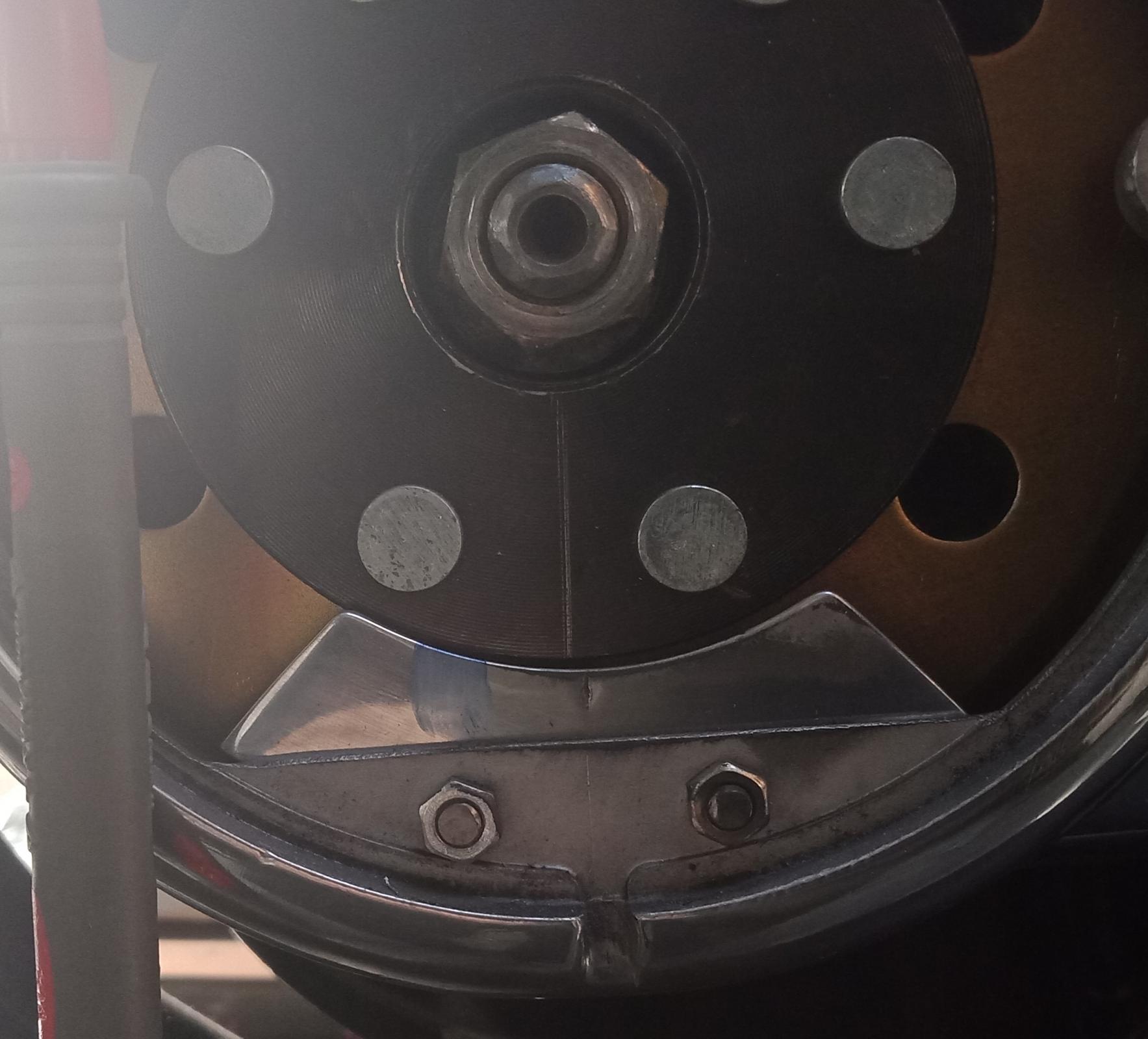

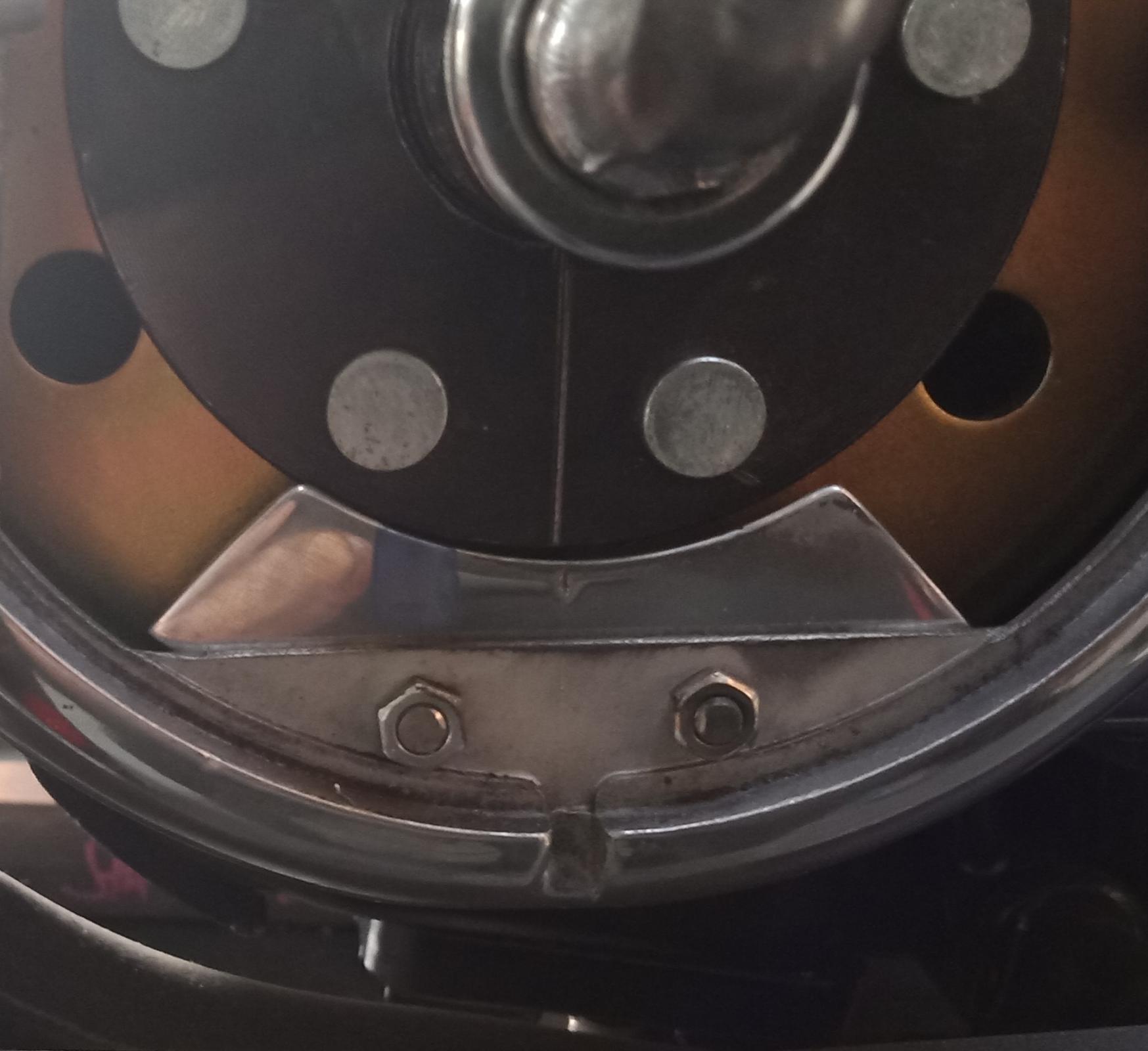

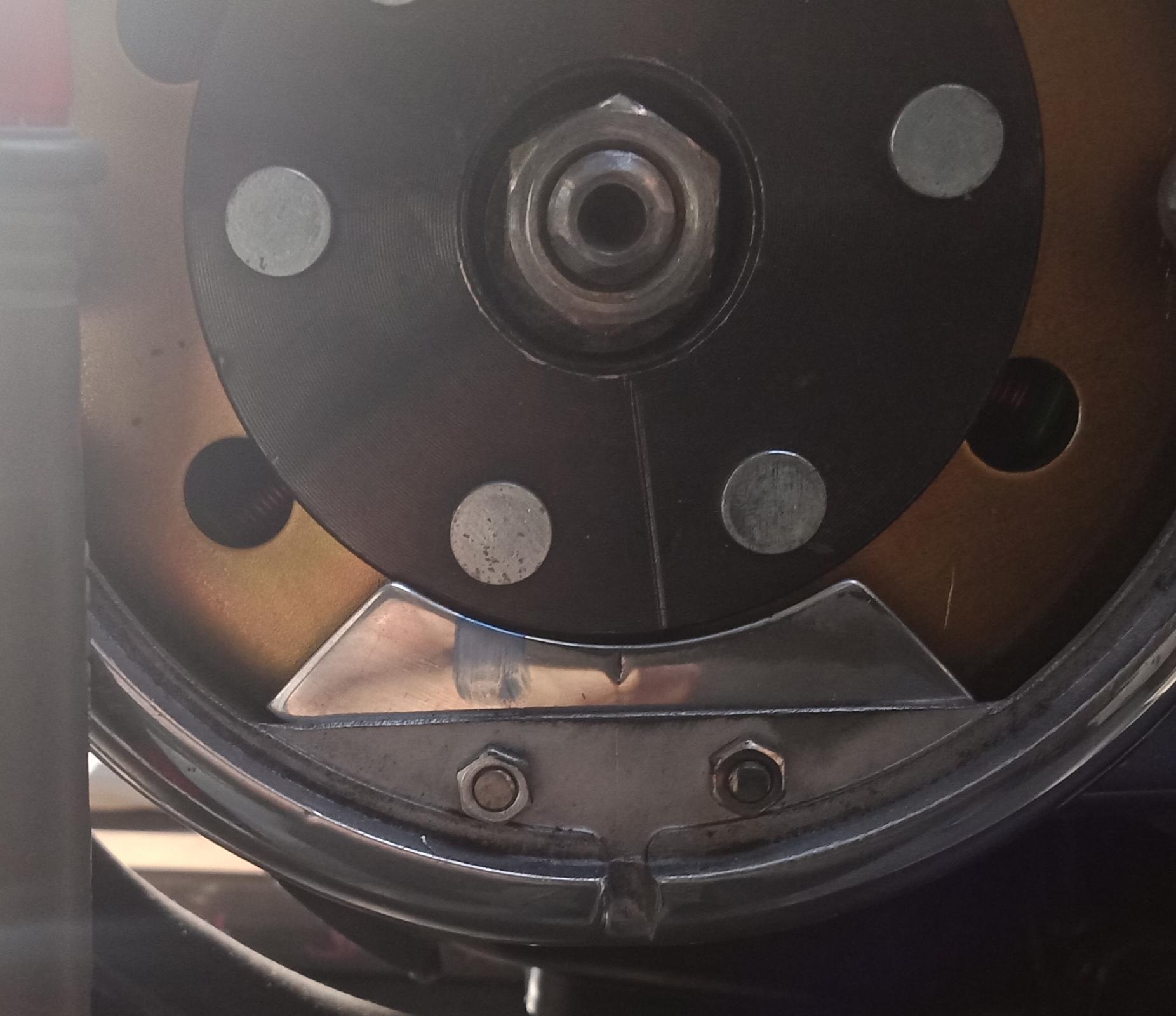

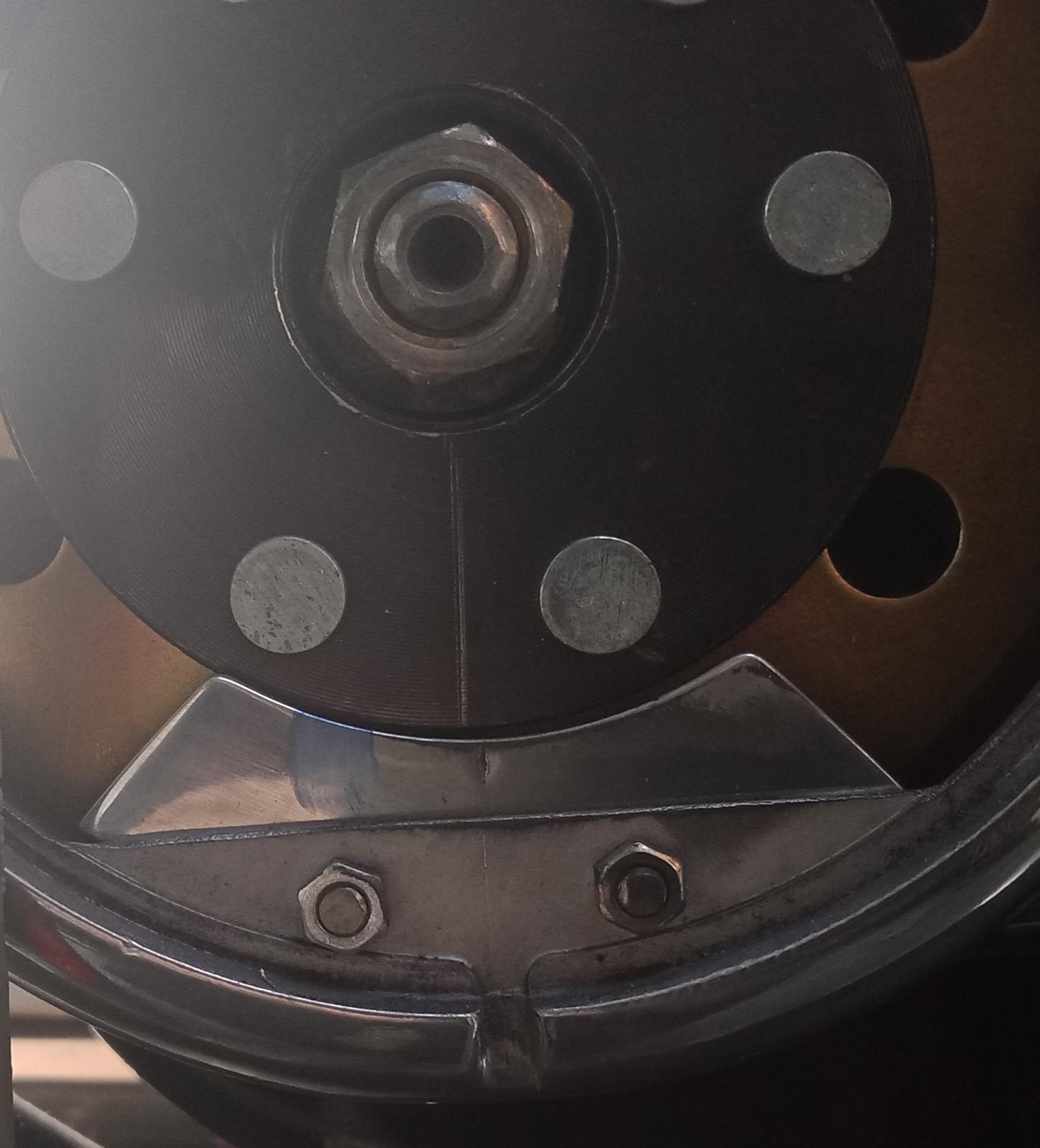

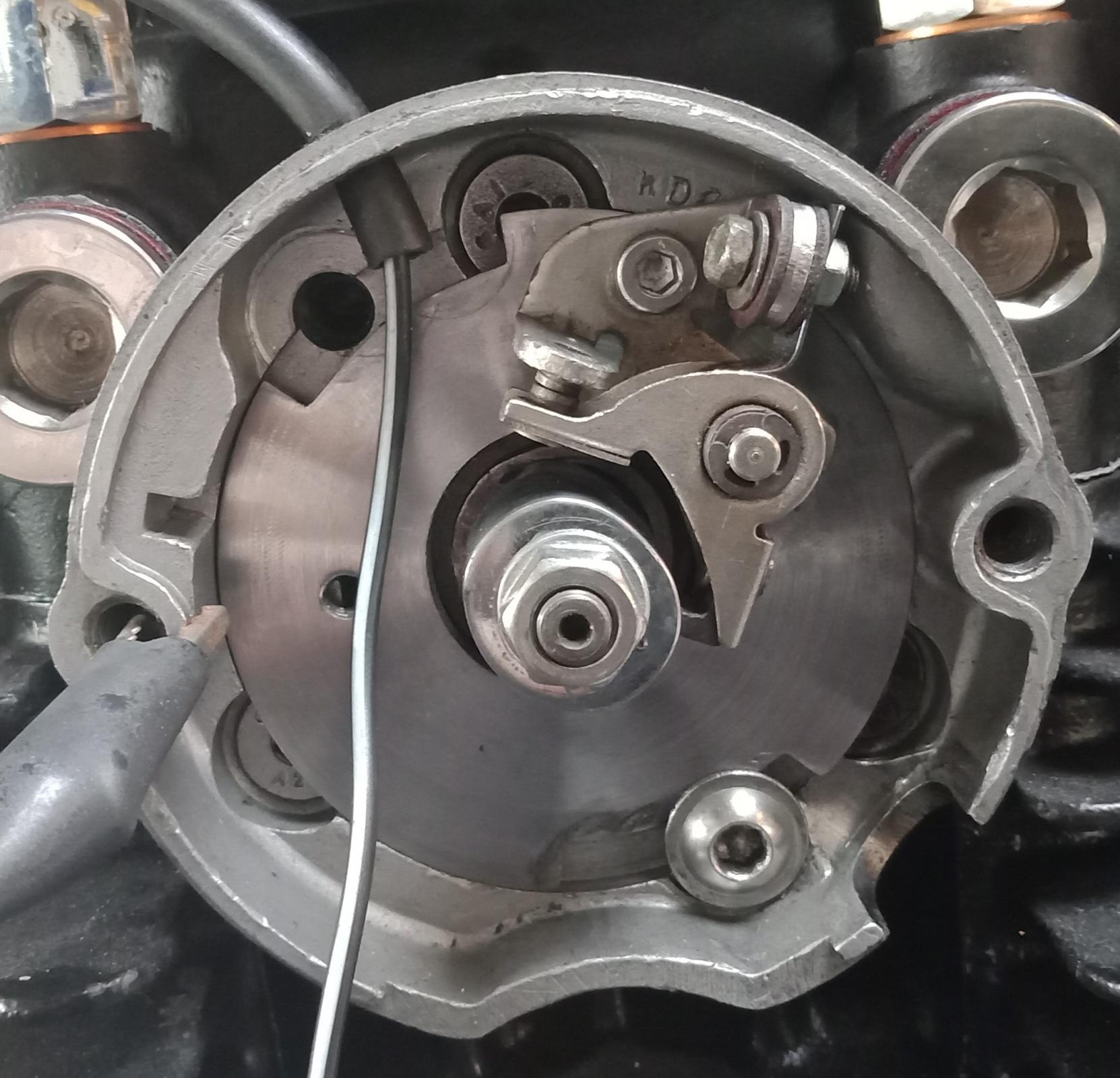

    Today I messed around with the single points cam I made a while back. As you can see in the first two pictures the lobes were slightly off: when the right hand cylinder was timed correctly the left was slightly advanced, not a great deal, split the difference and have the right a smidgin retarded and the left a smidgin advance and it would run fine, But just to satisfy myself, I decided to see how close I could get them, after all I'm working with minute measurements here, so pulled out the files. As it happened, I managed to get them spot on, statically timed anyway, with very little work. The problem now is the keyway is slightly off, so the points backing plate has to be turned fully clockwise in order the get the timing right. So, now I know it is possible to get the lobes right, harder though is the keyway: I turned the cam around and set the backing plate midway, with the cam running free (no key) on the advance shaft, I turned the cam by finger and and marked where the keyway should be cut, unfortunately, you only halve to be a smidgin out to ruin it, and you guessed it, I was that smidgin out. So, tomorrow I'll make another cam, but this time I'll try cutting the keyway first and then filing the ramps. Fingers crossed. BTW, this was the problem with the commercially available cams, the lobes weren't set 180 degrees apart, making timing difficult. Many of the XS650 shops don't stock them anymore for this reason.

    Would an offset key work...
